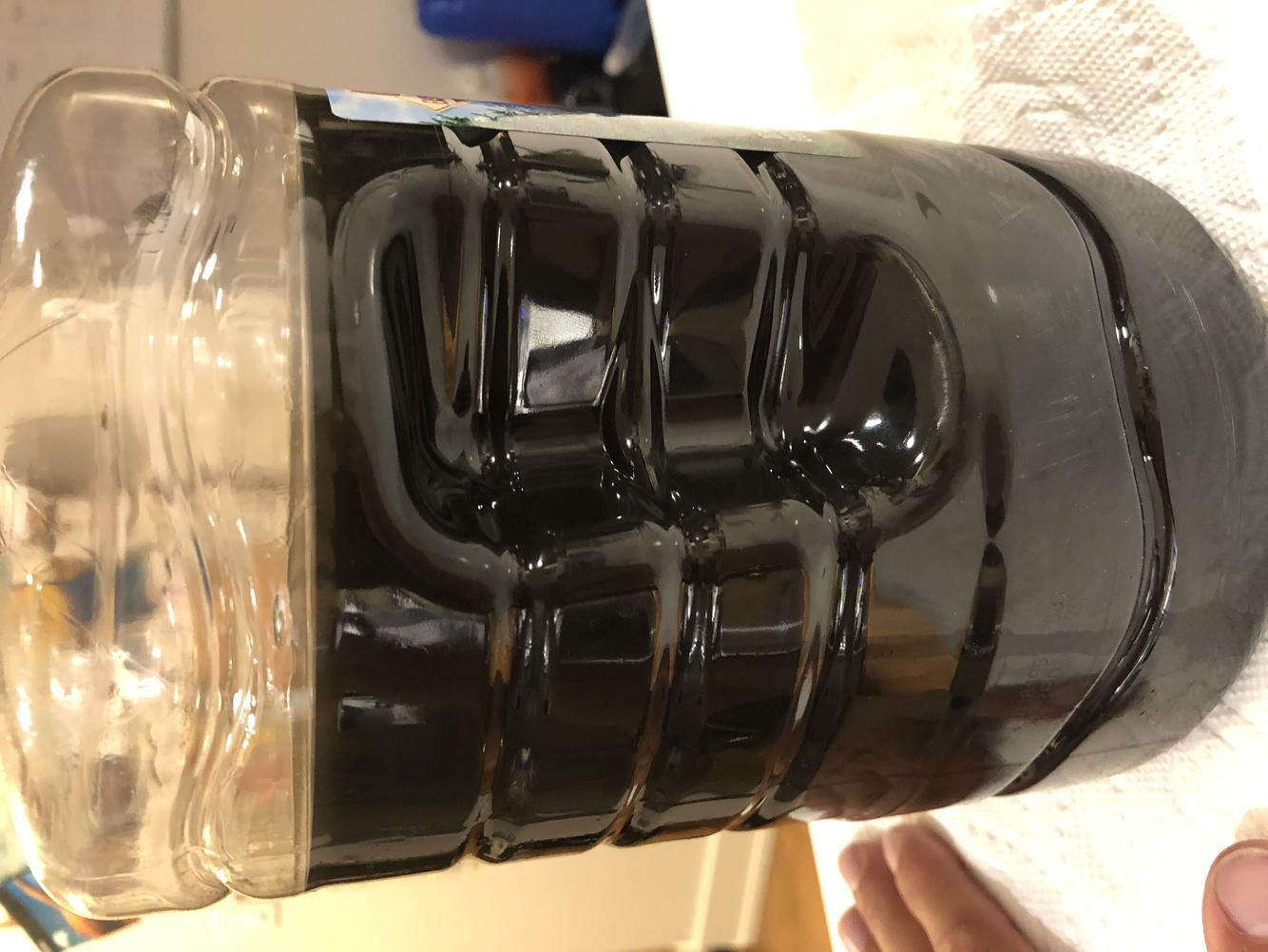

Serviced my rear diff today, 11,652 miles. Plug had quite a bit of dust on it, no chunks or chips at all. Oil was pretty dark and had a silver swirl in the drain pan. Happy to have it out of there, surprised at how dirty it was after such a short time with zero towing or off road use at all. Front diff will be some time next week, didn't feel like dropping the front skid plate off it tonight.
holy cow that's a low mileage 4runner
Brought it home January 29th 2017, left the dealer with 8 miles on it. I don't drive a lot lol Tore into it after 325 miles, this is where's it's at now.
