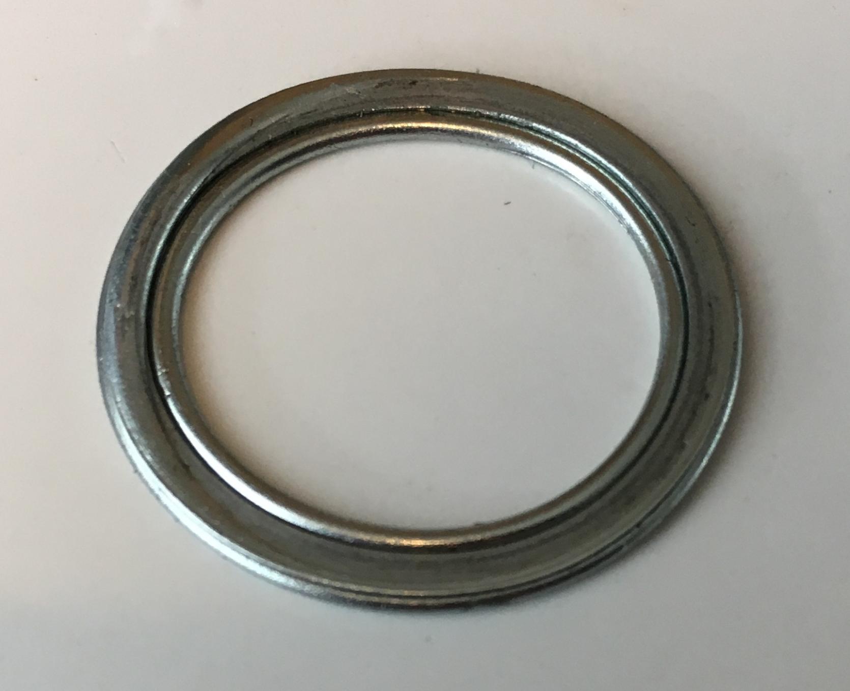

Doing my diffs this wknd. What is the orientation of the washer that has two different sides? Flat side against plug or Diff? I'd post a pic, but website AGAIN will not allow me to do so.
Flat side towards bolt. To avoid this.

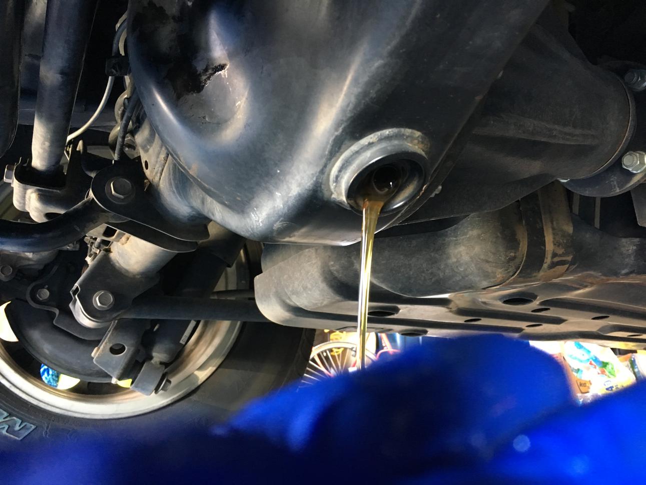

Well, I changed my rear differential fluid today, at 30,000 miles. Like everyone has been saying it was black and dirty and there were some gritty particles in the bottom of my drain pan. Replaced with Amsoil Severe 75W90.
Not a difficult job. Especially if you use the soft squeeze bottles. Unfortunately I also had to use one of the traditional bottles with a pump, and the cleanup from that took more time than any other part of the process.
Question for those who have done this multiple times:
Does the rear diff oil always look this nasty at every subsequent change?
No. Next 30k it should look clean.
Hmmmm... That must be what I saw with my rear diff fill plug. The washer was seized up tight to the bolt. I couldn’t figure out why since the drain bolt washer came right off its bolt. I had to put the fill bolt in a vise and use a thin small screwdriver blade like a chisel and pound it with a hammer on its edge to break it free.

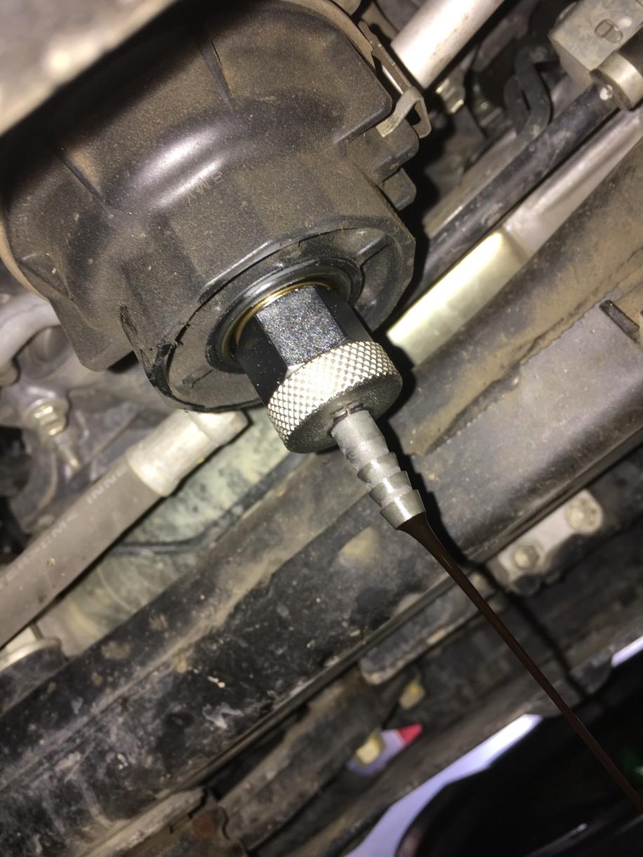

Not sure if this is something new on the market or just the first I'm seeing it. I have yet to see it anywhere on the forum though. It looks like it could be pretty useful. I picked one up so we'll see when it's oil change time.
Motivx Tools Oil Filter drain tool for Toyota, Lexus, Scion 2.5L - 5.7L Engines 851808006196 | eBay
YouTube link to a video of someone using it. Guy is long winder with extra useless info so skip to 3:40 to see it in action.
YouTube
I hadn't seen this before. Thanks for posting!
The 4Runner oil change procedure doesn't bother me unlike many people but I have always found dealing with the little plastic drain fitting to be the biggest PITA of the process.
I agree, doesn't bother me either. I actually like the canister filter better. I like that I can look at the filter media and make sure there is nothing on it besides oil. With aftermarket skids like the RCI skid, there is a window so you don't have to drop the skid to change the oil. When reaching through the window on the skid to remove that plastic thing from the filter housing, you're all but guaranteed to smash your wrist on the skid when it finally pops out lol. This should alleviate that all together.
So I just changed out my front and rear diff fluids yesterday with only 18K miles and I'm glad I did cause they were both nasty. The rear was the worse, very dark in color almost black with a minimal amount of metallic shavings on the magnet both front and rear. Replaced fluids with Mobile-1 75W-90.

Contrary to what some others have found, I was quite surprised about how clean my oil looked, especially given almost 90K miles on it. There was a bit of metal paste on the drain plug magnets, but the clarity of the oil was quite good. The T-case oil essentially looked like the new oil I put in. Diff oil was definitely a different color, but that may be because Mobil 1 75W90 is very light in color. Of course, the condition is simply a guess without a proper UOA!
