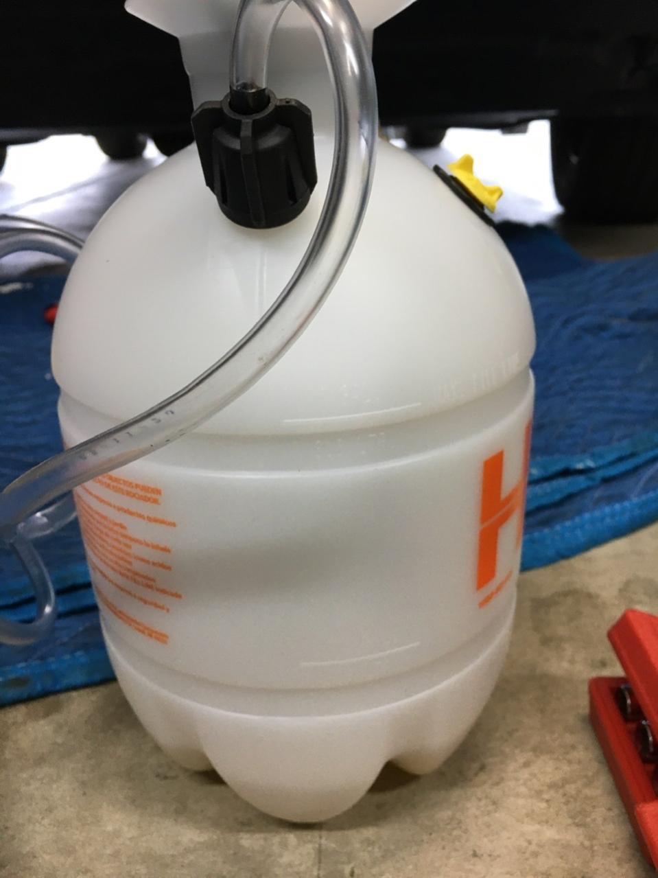

I ended up getting a one gallon sprayer at Home Depot this morning for $10. You don’t need to modify it at all to use as a fluid pump, just remove the spray nozzle for faster delivery. You can either clamp the hose or turn the relief valve to stop pumping. I replaced the black heavy duty tubing with 6ft of 1/4”ID 3/8”OD clear. Testing with water it pumped a liter in less than 30 seconds with 10 pumps.
Question: Did you run the clear hose all the way in to the bottom of the tank, or did you use the rigid plastic hose that came with it?
I used the rigid tubing inside the tank that came with it.

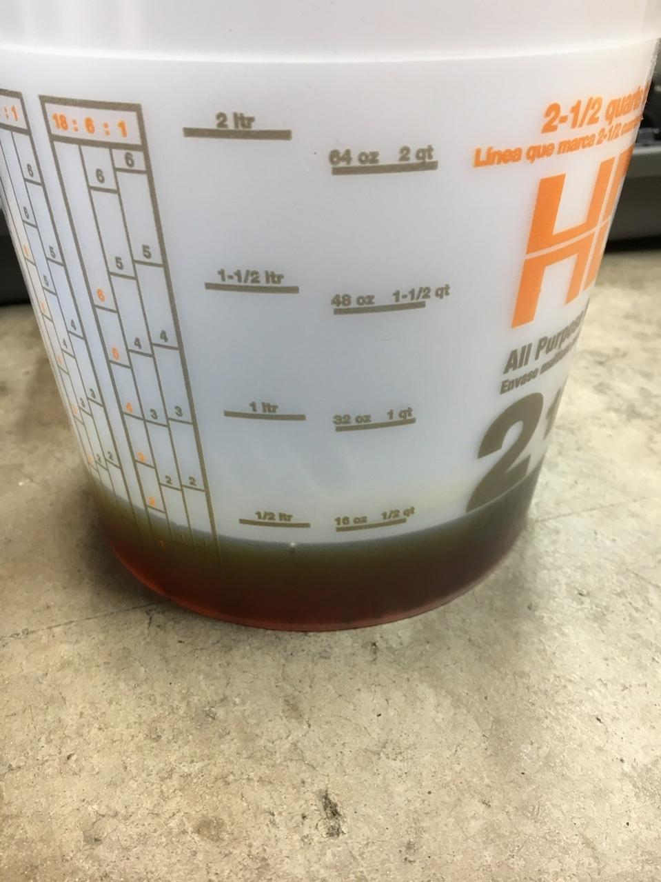

I set the “empty” level in my dispenser by filling with fluid and pumping it back into the bottle.
Then I added exactly what came out of the TC, only about 15oz.

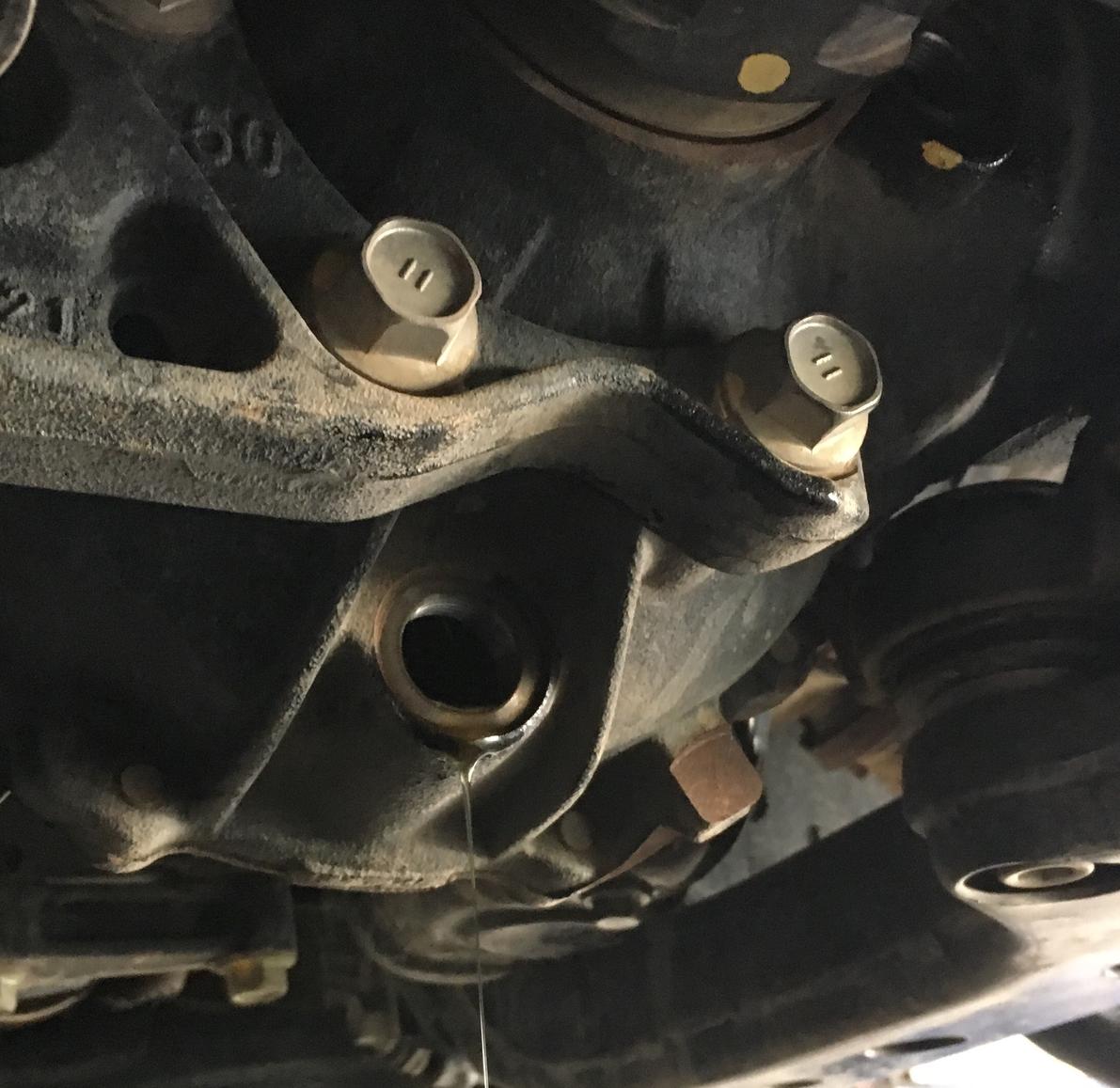

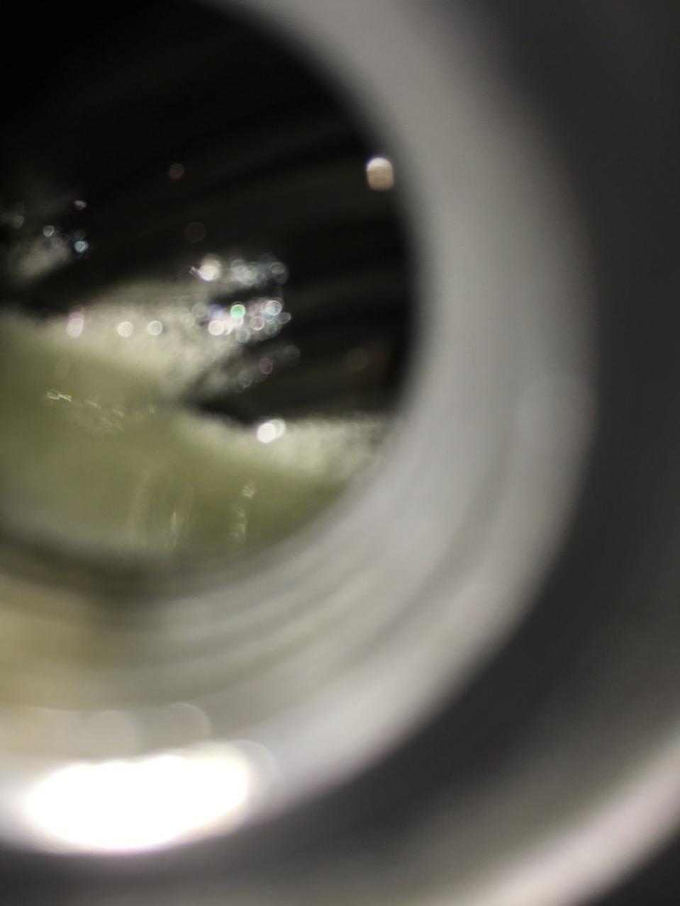

I pumped this into the TC until empty. Nothing came out of the fill hole so I took a pic. Perfect level.
The waiting is the hardest part, took about 45 seconds in the 40° garage to pump the 1/2qt of fluid.
