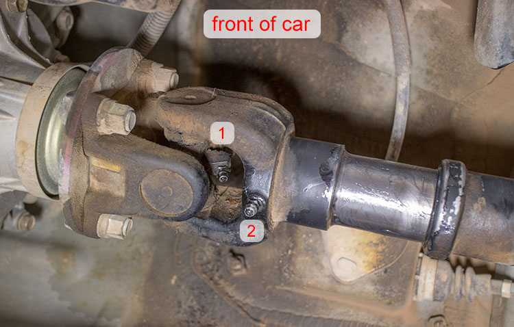

I'm planning to grease the driveshaft (propeller shaft) of my 2004 4Runner. I read this thread but it's about 3rd-generation 4Runners and my 4th gen vehicle seems different.
I also downloaded the 4th gen service manual from this thread but as far as I can see it does not provide clear information about how to grease the drive shaft and which type of grease to use.

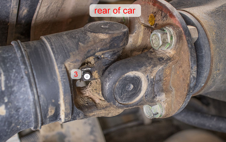

So, here are a couple of photos. My car seems to have only three grease fittings (Zerks), and I've numbered them in the photos.
It looks to me as if Zerks #1 and #3 are supplying grease to their respective u-joints (cardans), and therefore most likely require regular lithium grease. Whereas the grease that is applied via Zerk #2 is more likely for some type of metal-on-metal application and probably requires lithium grease that contains molybdenum disulphide.
Am I missing any Zerks? I can't see or feel any others. Are my guesses about which grease to use correct?
Finally, does anyone have any experience with renewing the grease? Can I just keep pumping grease in until the grease that is coming out is clean stuff? Or do I risk screwing up seals that way?

You are correct #1 and #3 take Lith No2 grease and those are Spiders and #2 is a Slider and takes MolyLith. I use Synthetic Mobil1 on spiders and regular dyno MolyLith on slider. Do not overfill slider because it can pop the dust seal at full compression (3-7 pumps is enough). As for spiders keep pumping until grease oozes out of all berings then wipe extra stuff off and it is done.

It should be obvious, but I did not make it clear in my initial post (because I was confused), that there are three grease fittings (Zerks) per drive shaft, and that my two photos at the top of this thread only show the three on the rear drive shaft. There are three more on the front drive shaft, which goes from the front diff to the transfer case.
So the six Zerks are as follows:
- Where the front drive shaft meets the front diff, there is a Zerk for the spider, requiring regular lithium grease.
- Where the front drive shaft meets the transfer case, there is a Zerk for the spider (lithium grease) and a Zerk for the slip yoke (requiring lithium grease that contains molybdenum disulphide).
- Where the rear drive shaft meets the transfer case, there is a Zerk for the spider (lithium) and a Zerk for the slip yoke (moly).
- Where the rear drive shaft meets the rear diff, there is a Zerk for the spider (lithium).
