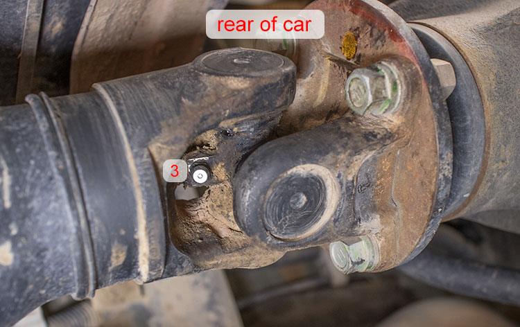

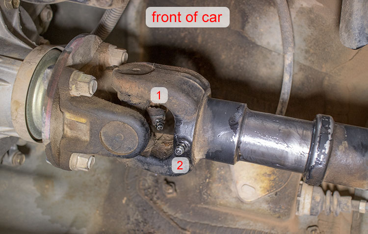

So, here are a couple of photos. My car seems to have only three grease fittings (Zerks), and I've numbered them in the photos.
It looks to me as if Zerks #1 and #3 are supplying grease to their respective u-joints (cardans), and therefore most likely require regular lithium grease. Whereas the grease that is applied via Zerk #2 is more likely for some type of metal-on-metal application and probably requires lithium grease that contains molybdenum disulphide.
Am I missing any Zerks? I can't see or feel any others. Are my guesses about which grease to use correct?
Finally, does anyone have any experience with renewing the grease? Can I just keep pumping grease in until the grease that is coming out is clean stuff? Or do I risk screwing up seals that way?

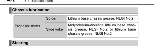

Okay just got my 2019 and was wondering if there was anything to lube. Found this thread and now I'm more confused than ever. My old 1992 little 4X4 had a ton of grease fittings and a map on the visor of where they were.
My 2019 manual states Lithium base chassis grease NLGI No.2 for the spider and the slide yoke states moly OR lithium base chassis grease No.2.
Doesn't this just mean I can use regular lithium base No.2 for both the spider and slide yoke?
Seems like I only need the one and hit em all? Something like Mystik JT-6 High-Temp No.2?

Screen Shot 2019-08-25 at 1.44.06 PM by Michael Starmer, on Flickr
Sorry if this has been beat to death, this is only my second post.
My 2019 manual says the same thing!

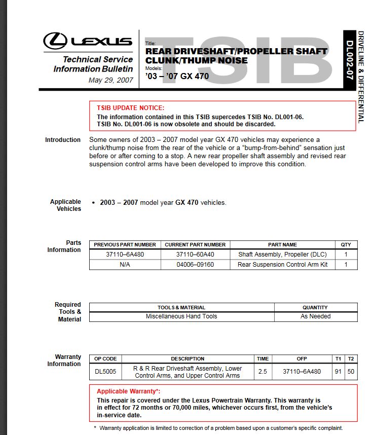

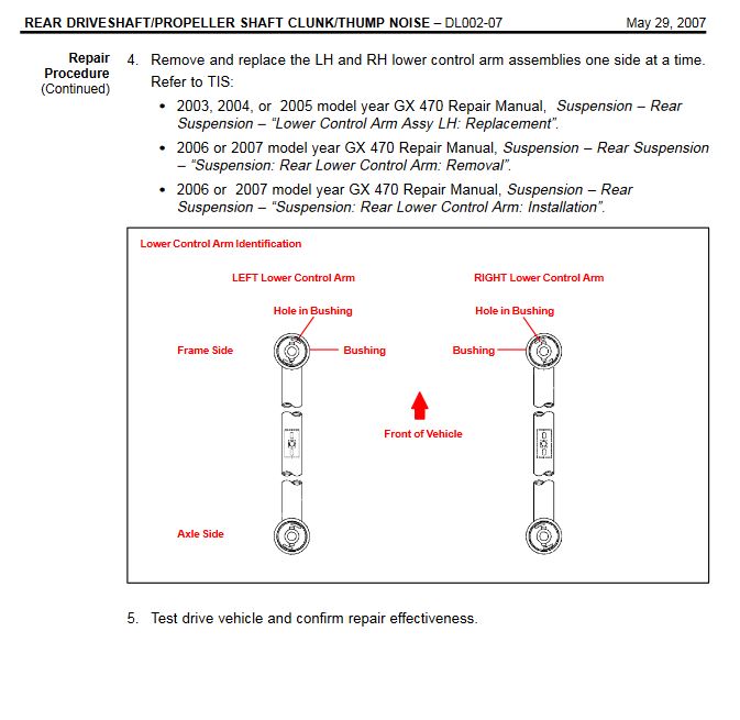

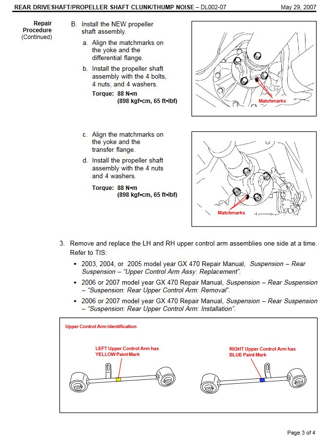

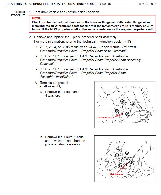

There was a TSB for Lexus.
T4R got no such love.
