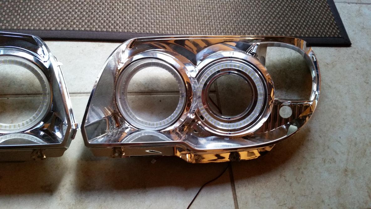

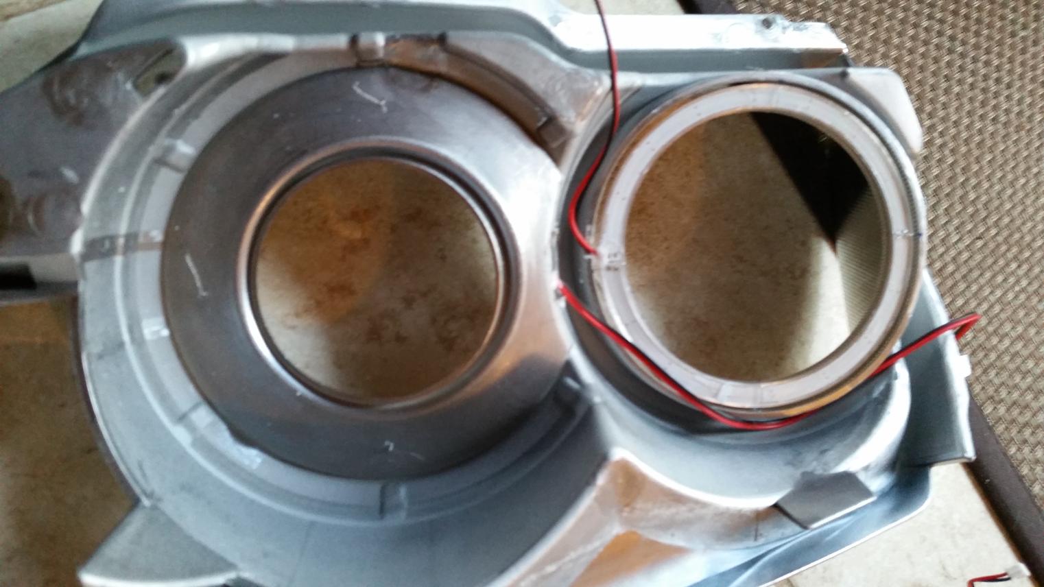

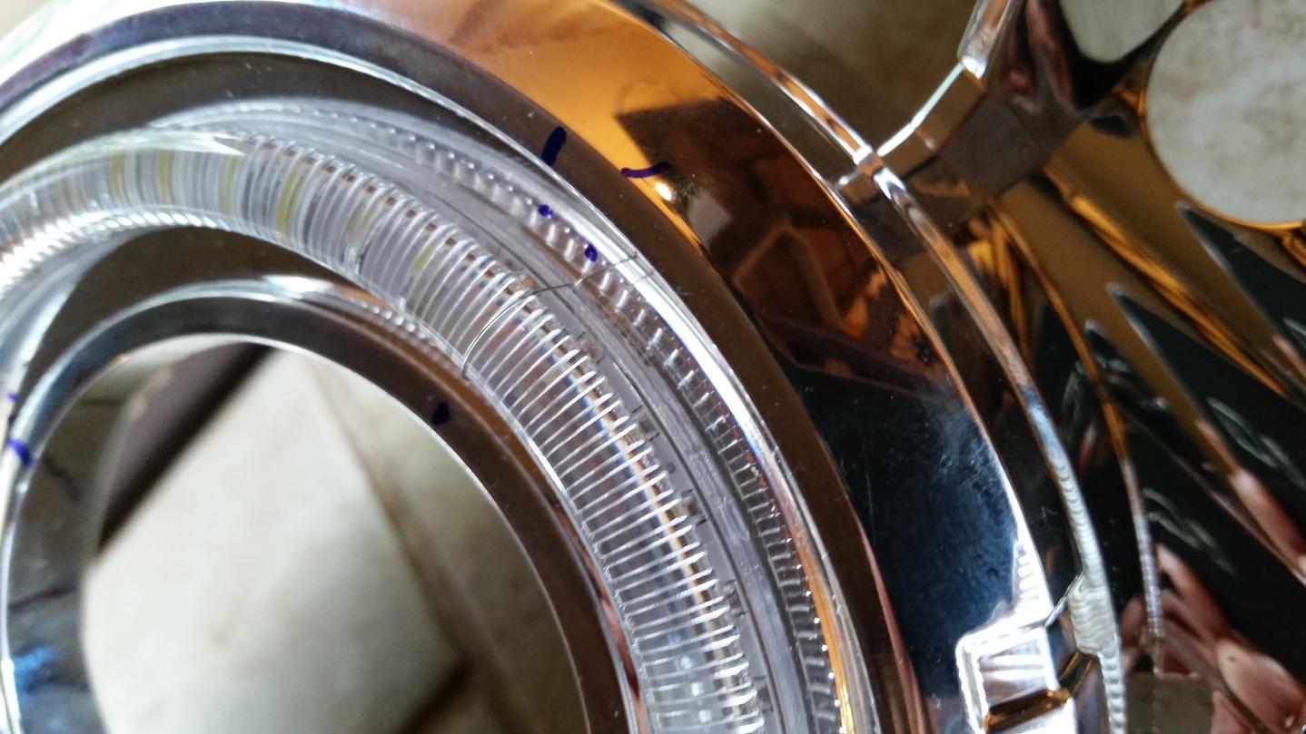

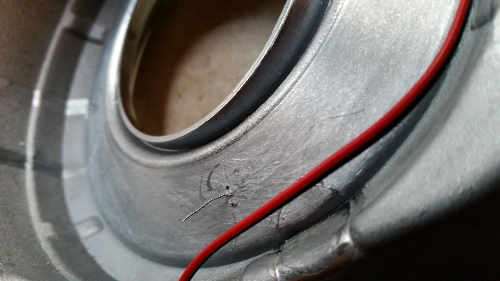

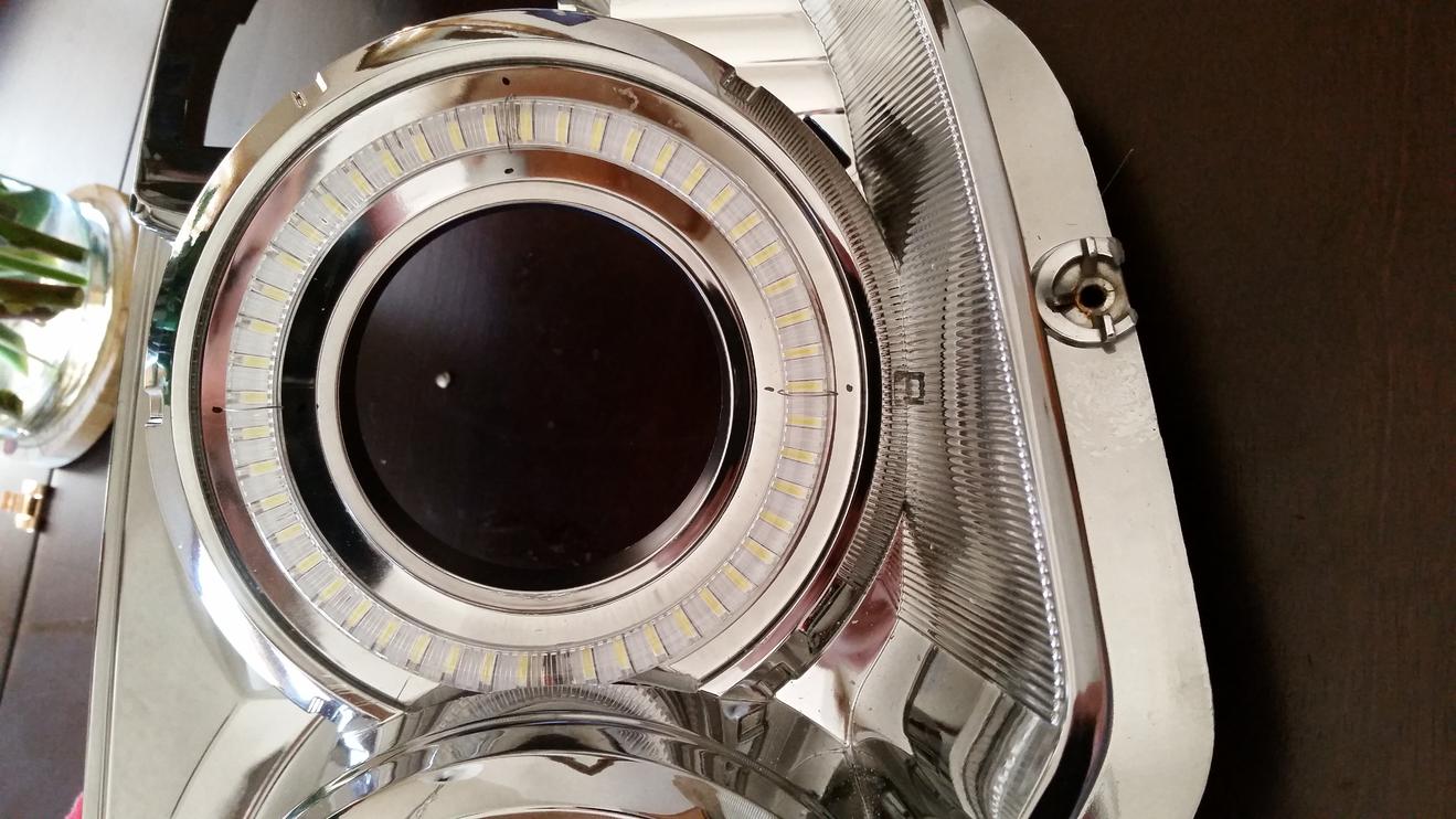

As I used my junk head light to start mocking up the halo... I realized you can't center the low beam very easily... I looked closer at the Dark Knights and his are not centered. He did notch out the highbeam housing area a bit.

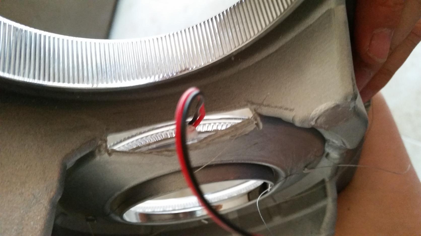

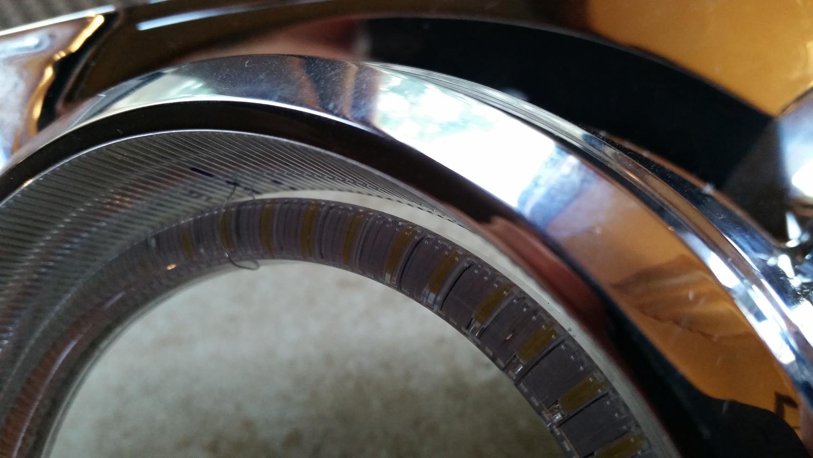

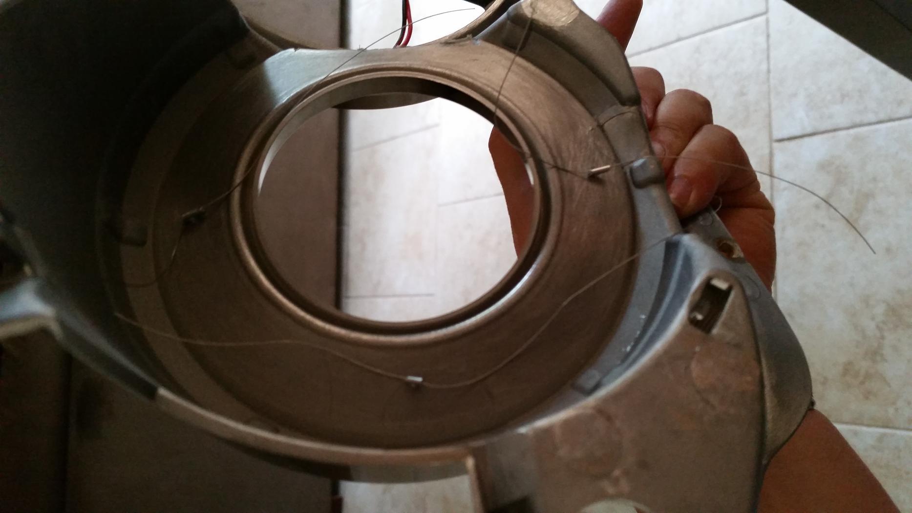

So I figured why not try to center it... This is what I have so far... As for attaching them to the light bezel/trim. I plan on using the smallest safety lock wire I can find... The wire holding them on in the pic below is from the local hobby store (very fine craft SS beading wire). I got some really small hollow alumn. tube and ran the wire through them and pulled them tight. (temporary) When I get my safety lock pliers to properly tighten the wire to the halos they will be secure. I plan on applying glue over all the finalized lock wire tube knots I made. There is a drilled hole at the 3 points where the wire is installed behind the halo.
So I cut to much of the high beam housing out but I now have an idea of how much to remove to make the halo slide over enough to center. (not much really) I was thinking maybe the halo would be covered by the high beam housing but it looks fine to me... You can barley see the wires holding the halo on. I just can't stand glue/epoxy on it's own it's a matter of when not if... When real saftey lock wire is used properly even if the glue fails the wire will not. I couldn't think of any other way of attaching them with out plastic welding or some possible way of messing up my brand new $200.00 halo kit...
I have not figured out how I am mounting the High beam halo but will keep ya'll posted.
btw I plan on painting the chrome bezels color match (dark blue)

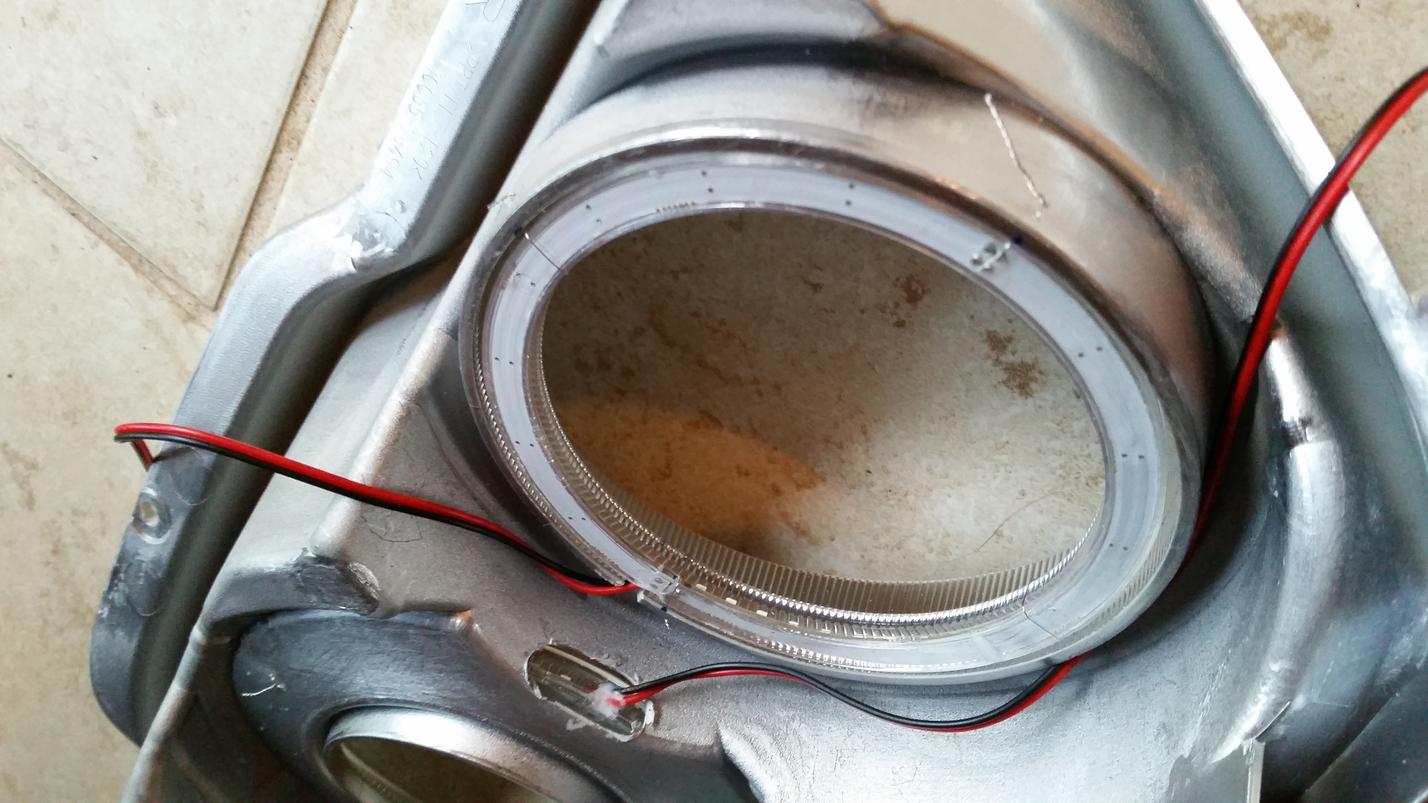

Installed the high beam
For the high beam I drilled 4 small holes and did the wire thing again.
I am waiting on some safety wire to show up then I will have a better idea of how secure .021 safety wire is for this application. (which I think will be fine)

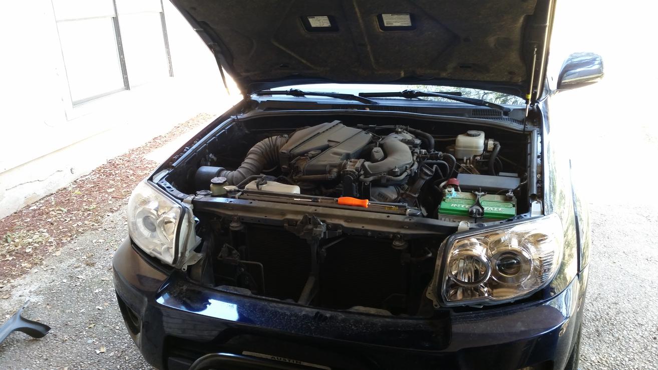

I bought a brand new sport set of head lights to install in my truck while I do the mod. to my original head lamps. I have had aftermarket lights and lets face it they are not as good as OEM. I plan on having a paint or vinyl guy help me make some eye lids... I just can't pay 200 plus for the Aura lids....

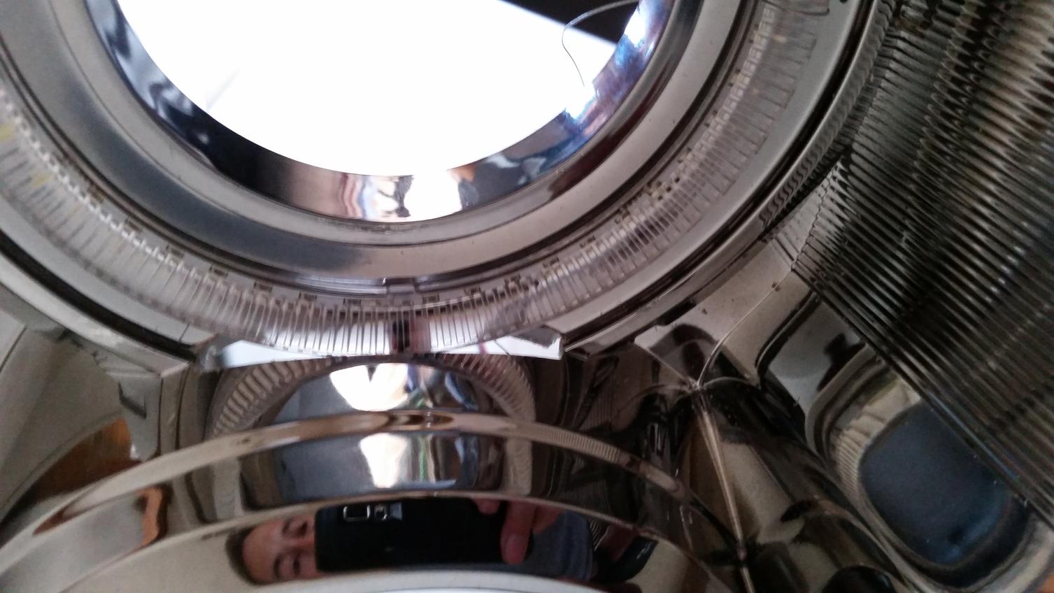

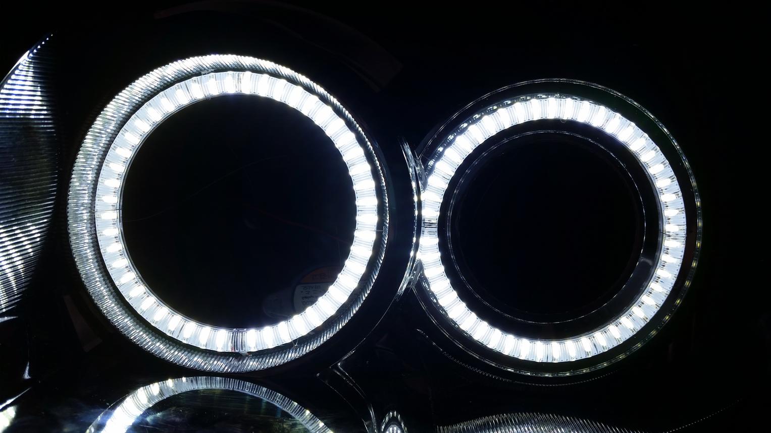

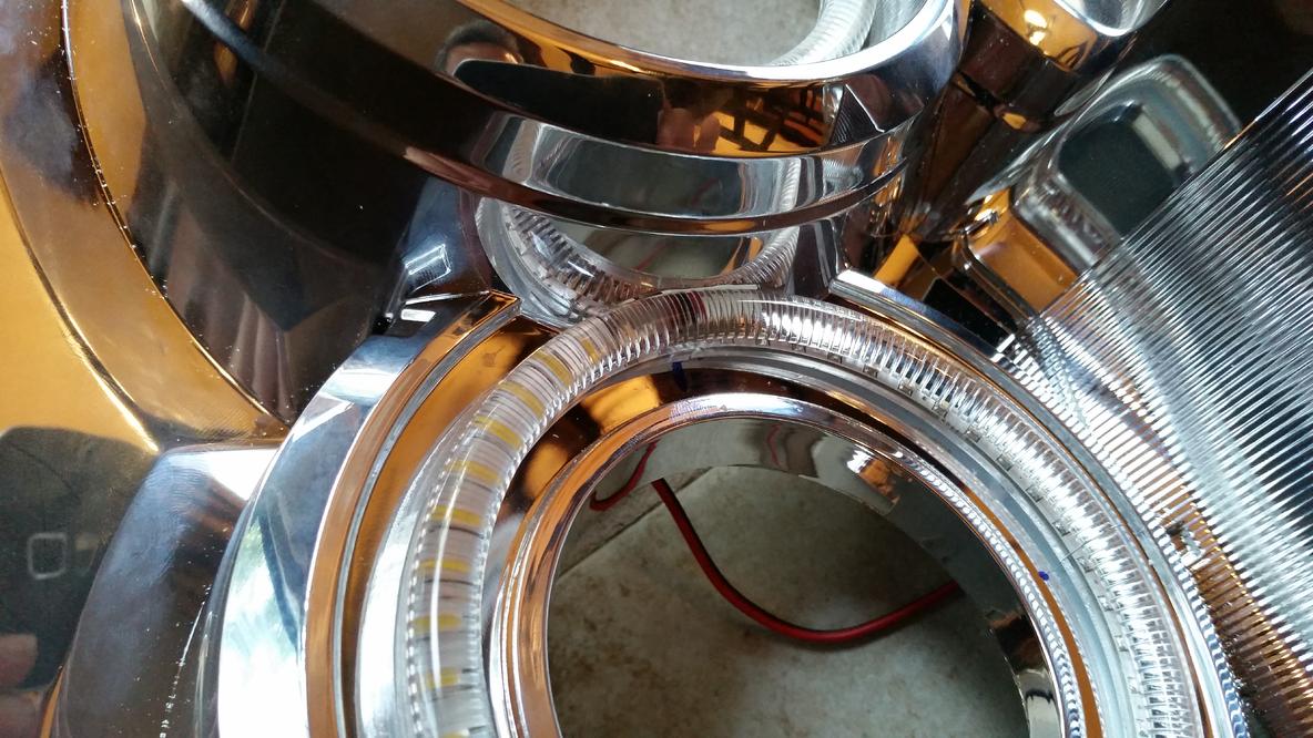

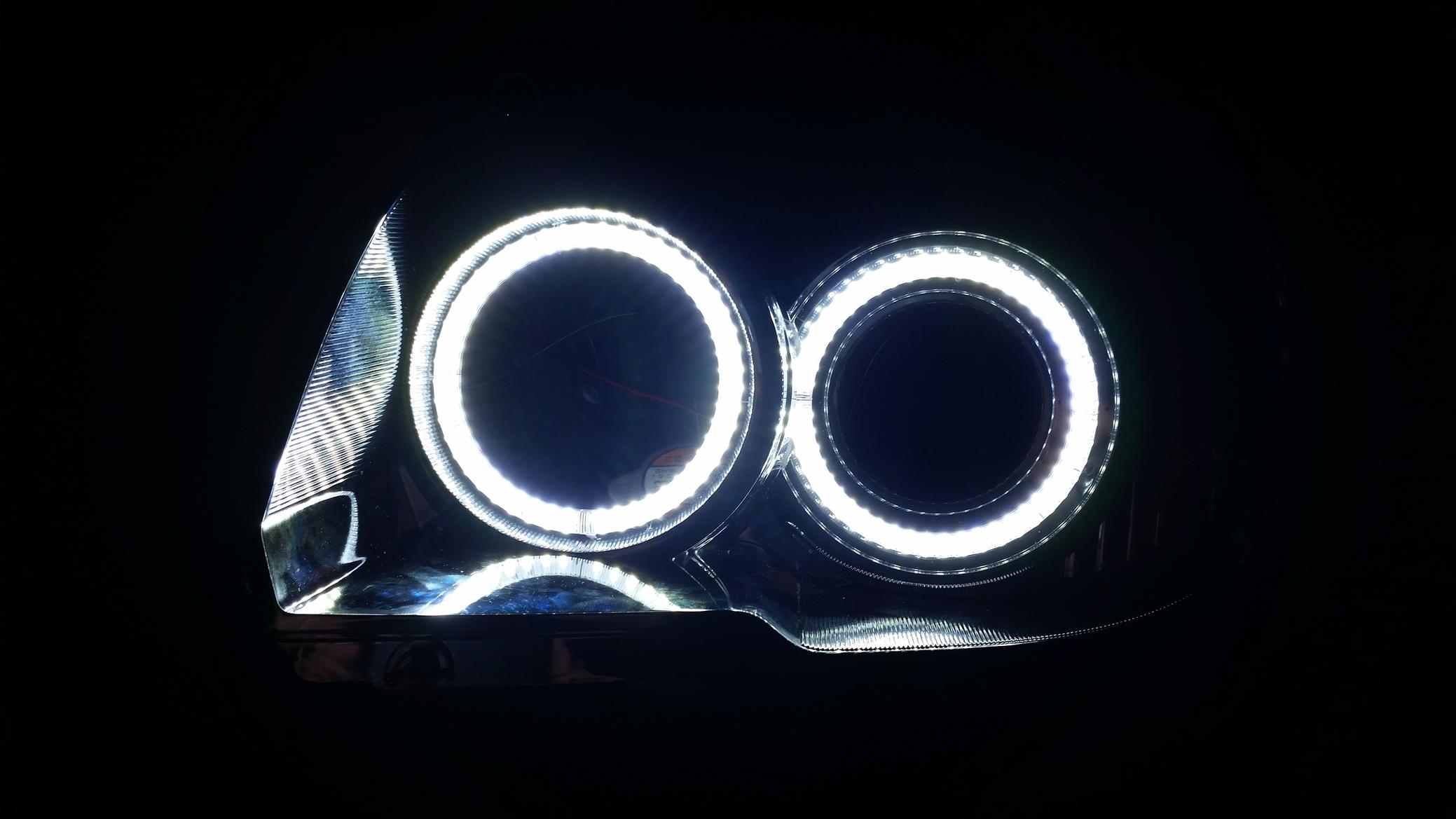

Powered-up and they are bright!!!
I did notice there is a small dead light spot where the wires come out of the Halo I think I will make the high beam dead spot match the low beams dead spot since there's already a hole (the hole I cut to let the low beam ring move over for centering)

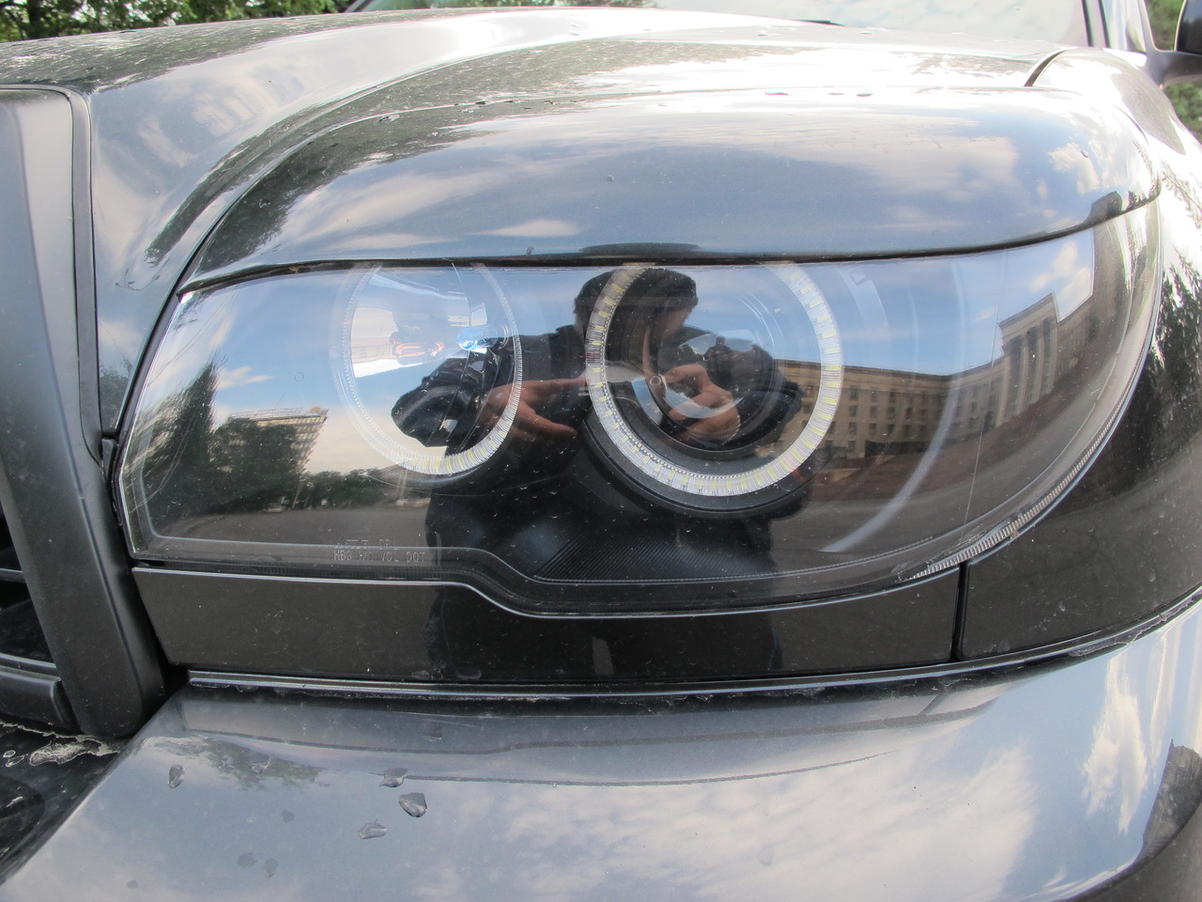

I need to correct my self on the Dark Knight statement
When I was looking at this pic of the Dark Knights post I thought it was off center but I think it is the angle of the pic that fooled me...
I would still love to know how he mounted the halos in general...

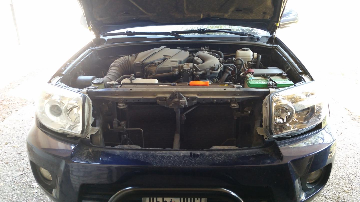

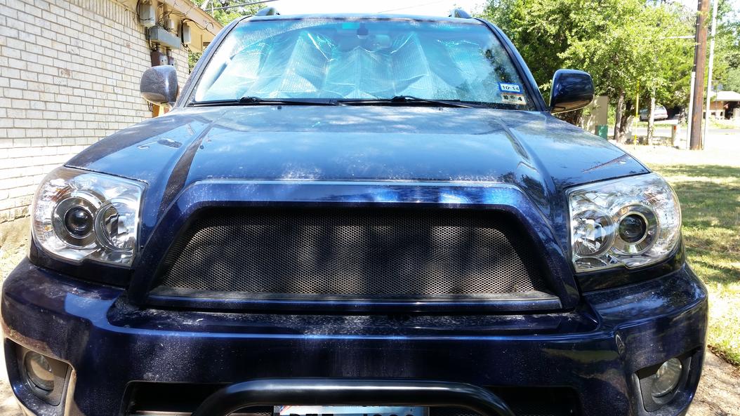

Pics Installled my loaner sport head lights
While I mod my oem head lamps bought some sport lamps off of ebay for about $200. shipped...
Hopefully they won't be installed long and I plan on selling them...
Give ya'll a couple of pics to hold over for now...
I think they look pretty good with slight tint.
Took a pic of the difference between the sport vs limited

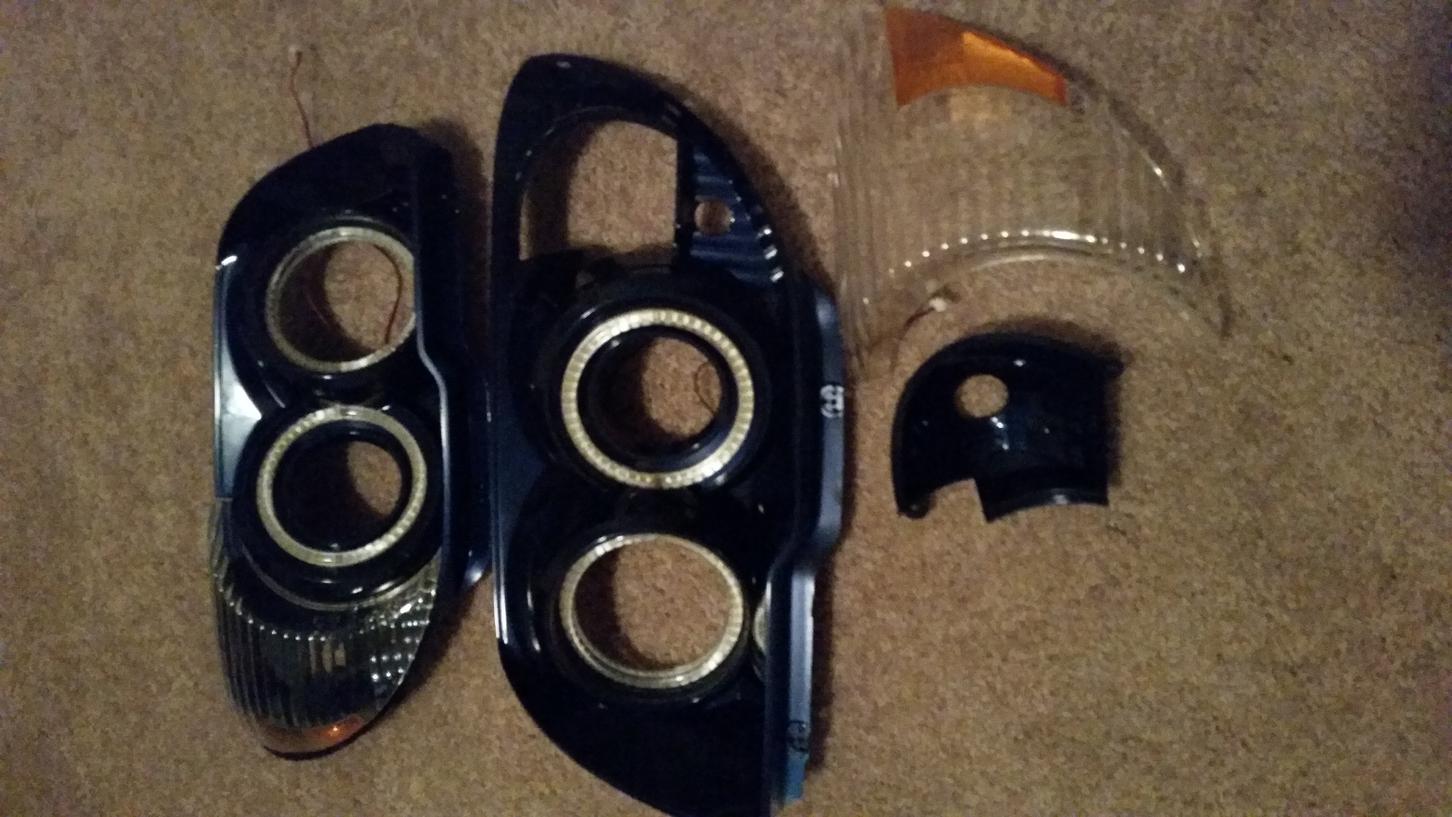

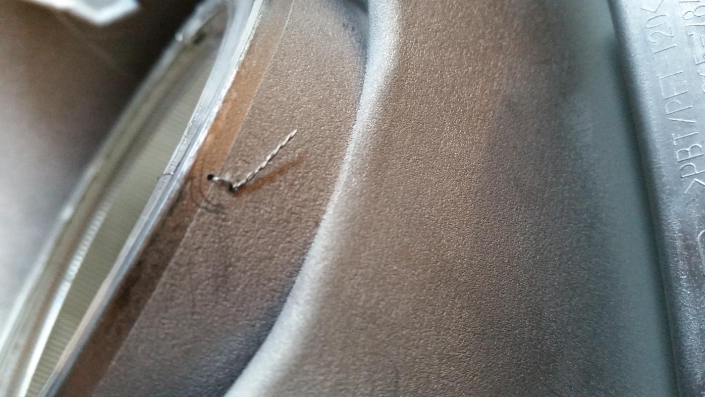

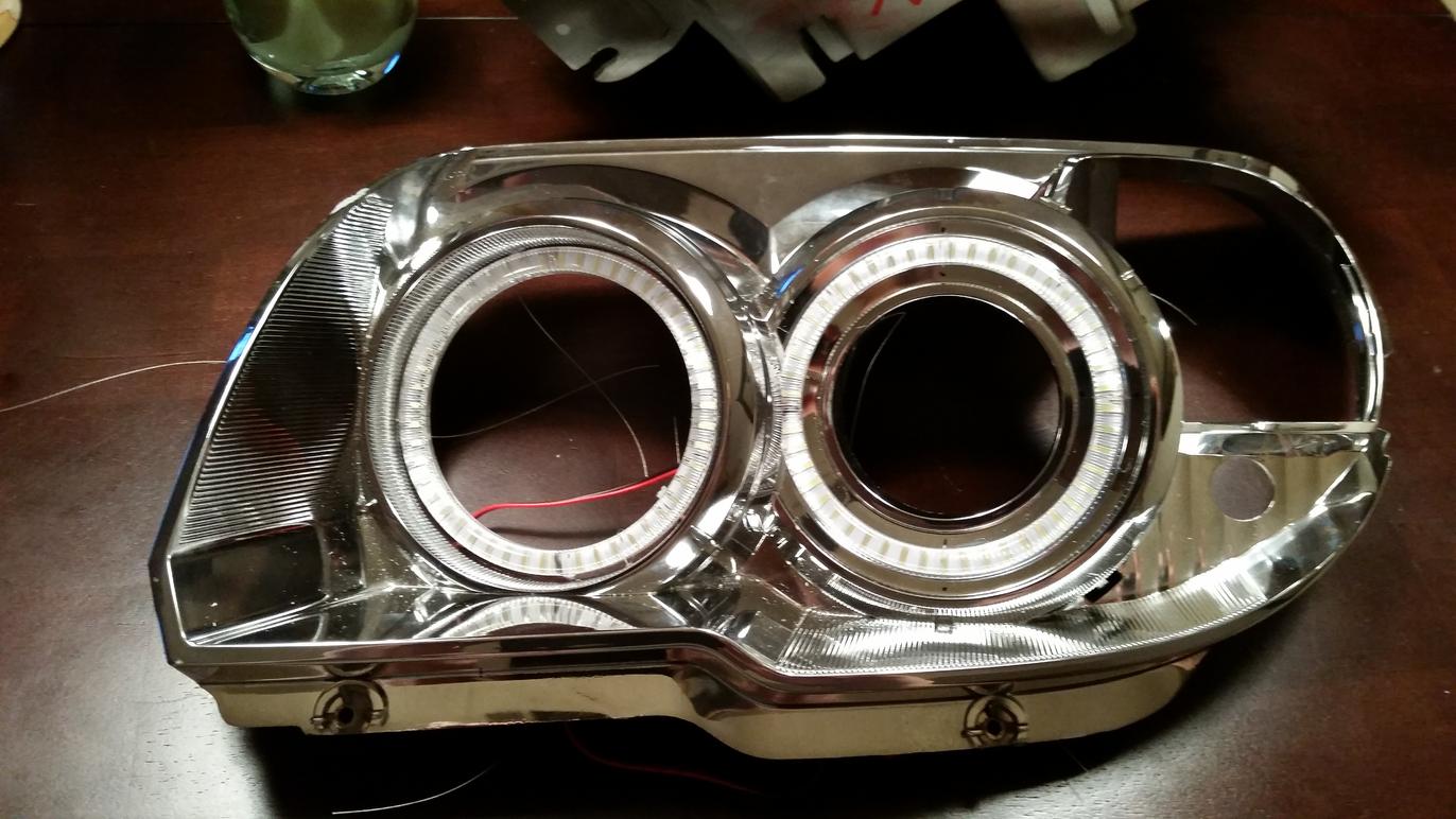

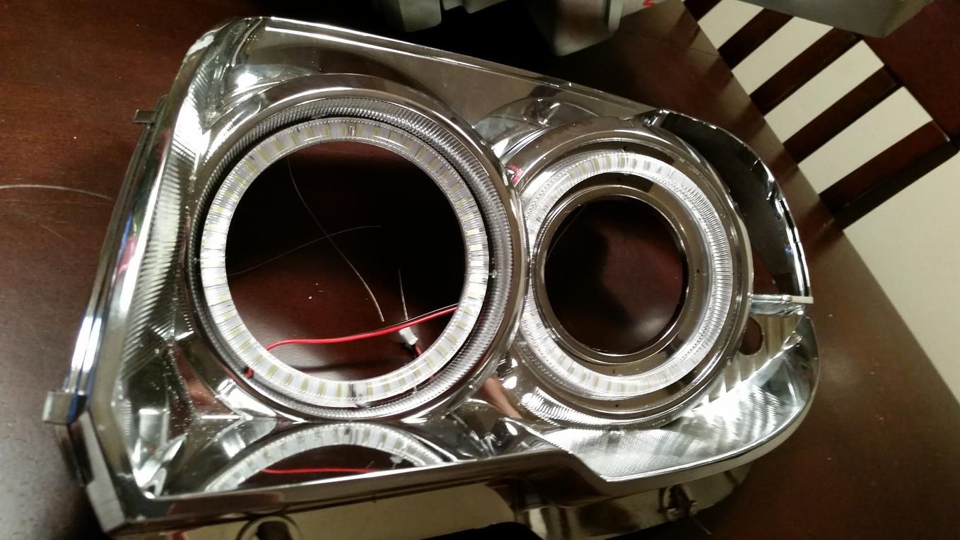

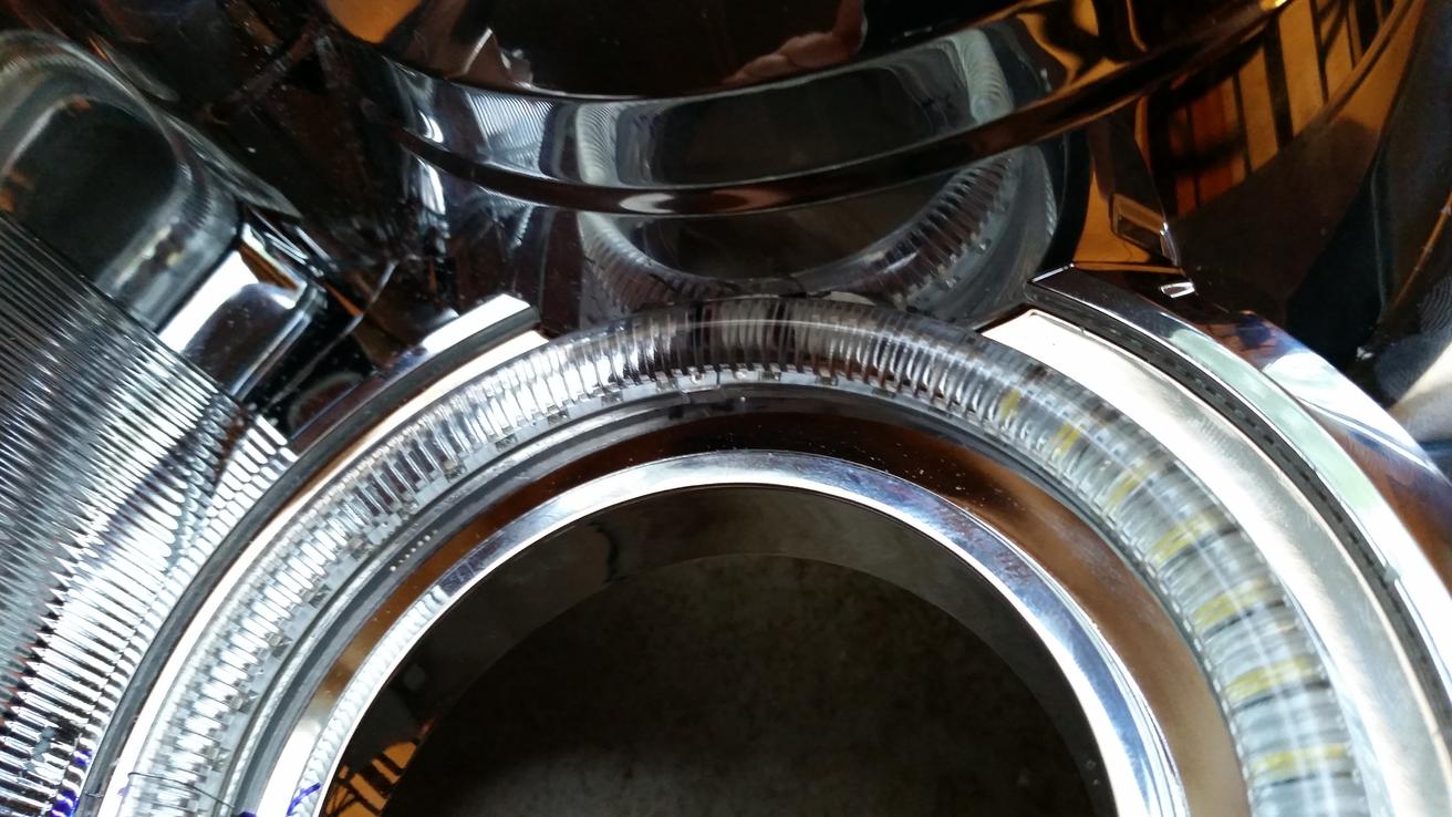

Finally making some progress with the halos

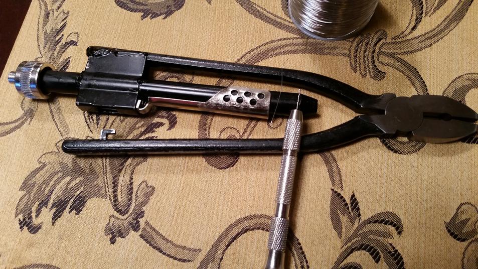

Some of the tools I have gathered... Saftey lock pliers and a little bity hand held drill bit kit. .010 stainless steel saftey wire.
The last idea of holding the halos on the light trim has changed a bit. I drilled 2 little holes(you can not see the holes) and fished the wire through them then saftey locked them pretty tight then manually tightened them little by little to center and hold them in place. I plan on using some kind of glue/silcone to put in the tiny holes and on the stainless wire too. I think this is full proof way to make sure the halos don't move/fall off... You can barley see the wire... Now that I have prepped the light trims I am going to have them painted body color and finalize the install of the halo rings...

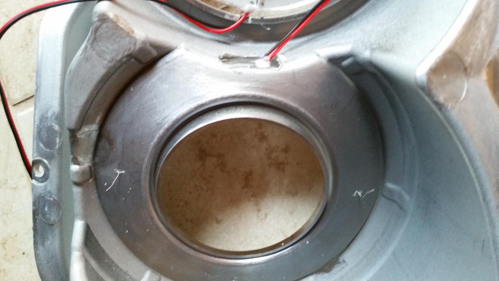

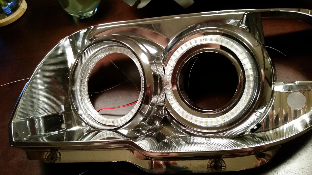

Few more pics of progress
As of now I have 4 wires holding the high beam halo but only 3 holding the low beam halo. I might add a forth to the low beam after all said and done.
Hopefully I will have more time to fudge with this stuff soon... Almost ready to send the light trims off to the paint guy.

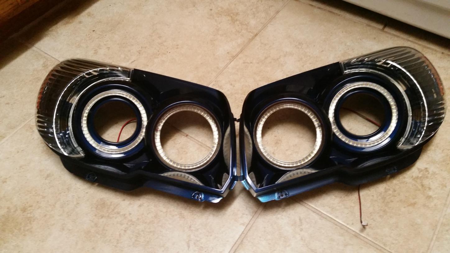

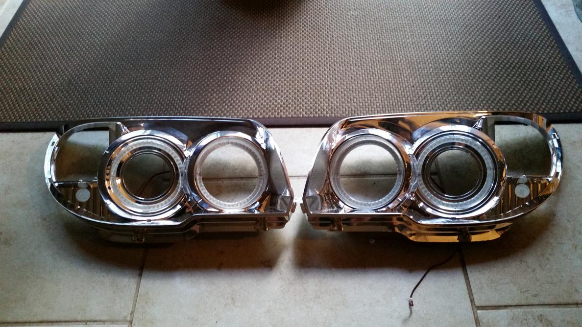

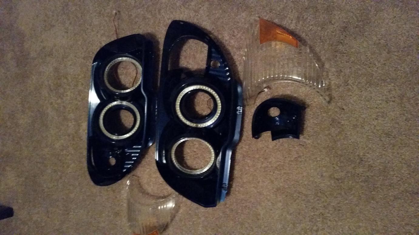

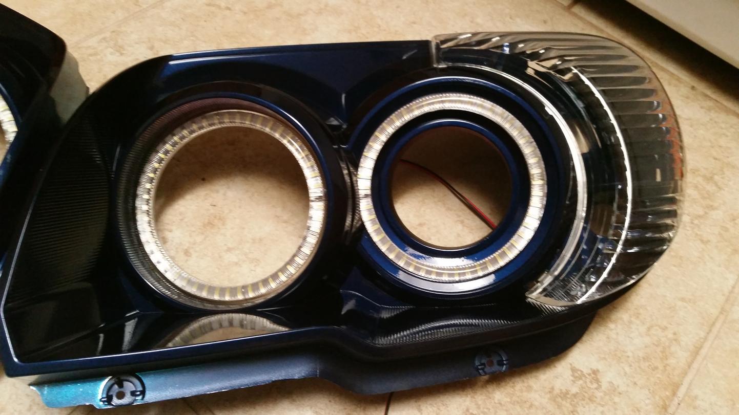

head lamp housings body color blue
Almost there kinda.... I mocked up the clear lens on the trim and body color painted the drl/turn signal too. I'm trying to remember and snap pics as I go....
