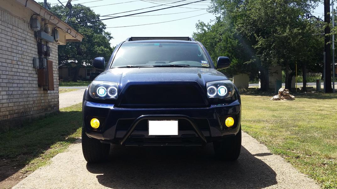

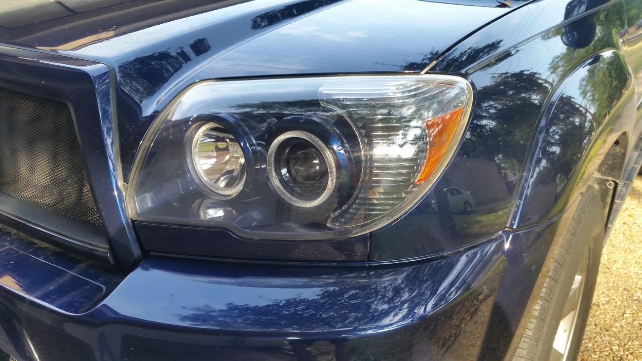

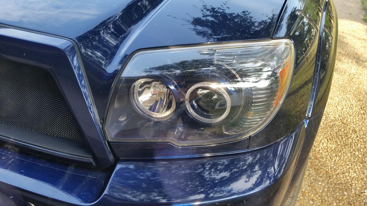

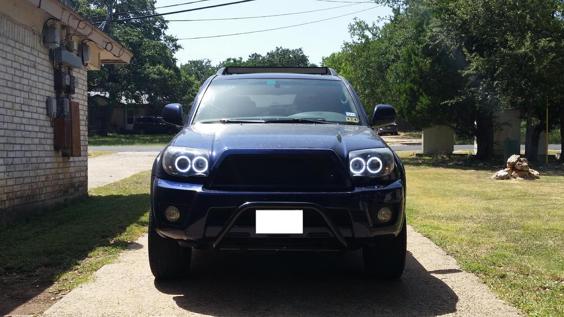

Got them installed finally.... They look great to me

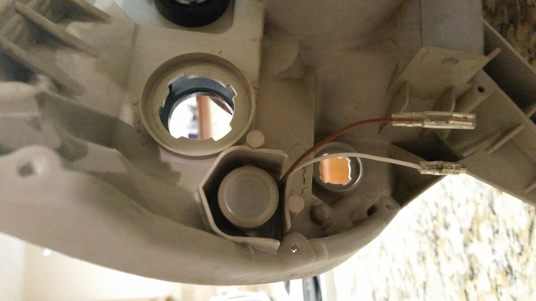

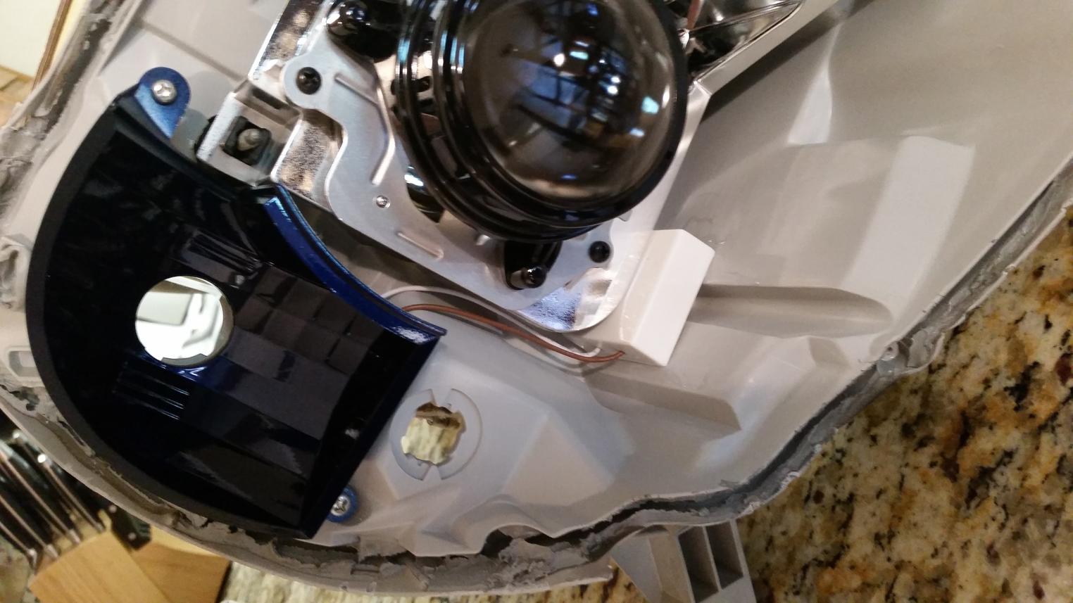

Have a few pics of the last few items I had to do with wiring...

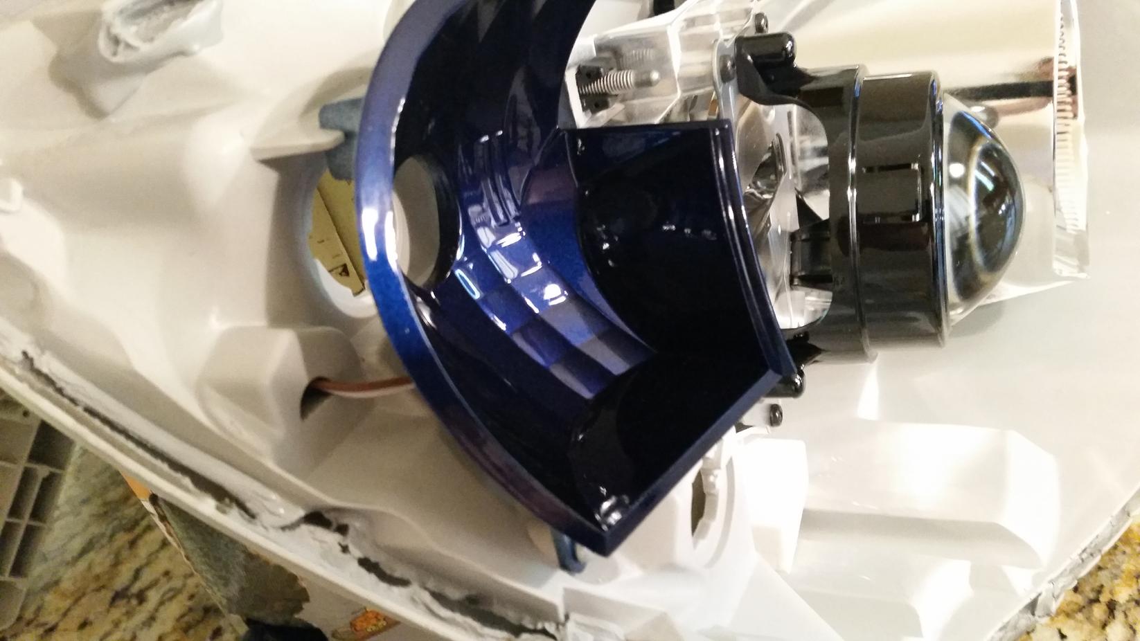

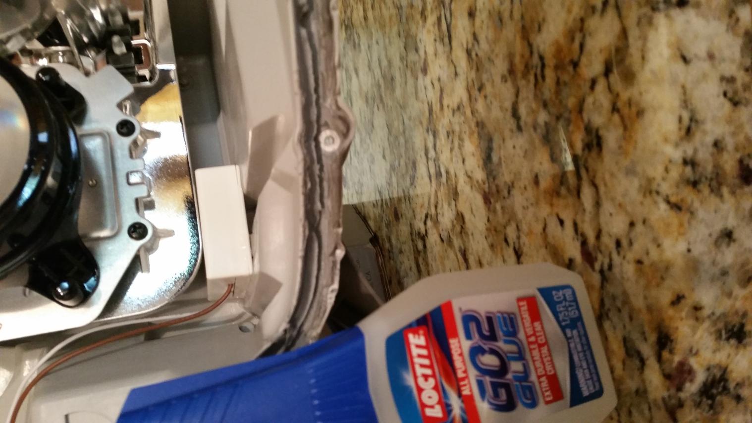

I glued and wedged the little angel eye boxes below the low beam frame work.
Ran the wire up to the vent and out then capped it back off.
I used scotch locks for now and hooked the angel eyes to the parking lights.
BAD NEWS.... Some how when I was putting the lens back on I slightly melted one of them, I am hoping it will sand and buff out. My oven sucks...
A while back I had my lights sanded and buffed... I am kind of wishing I went with new lens all that work and my lens looks just ok.... Over all I am happy need to water test them soon... I will keep ya'll posted....
Anyone know if you can buy a lens kit only???

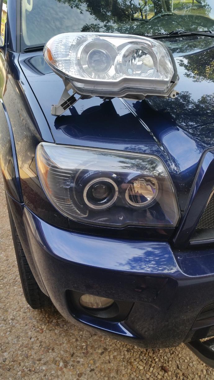

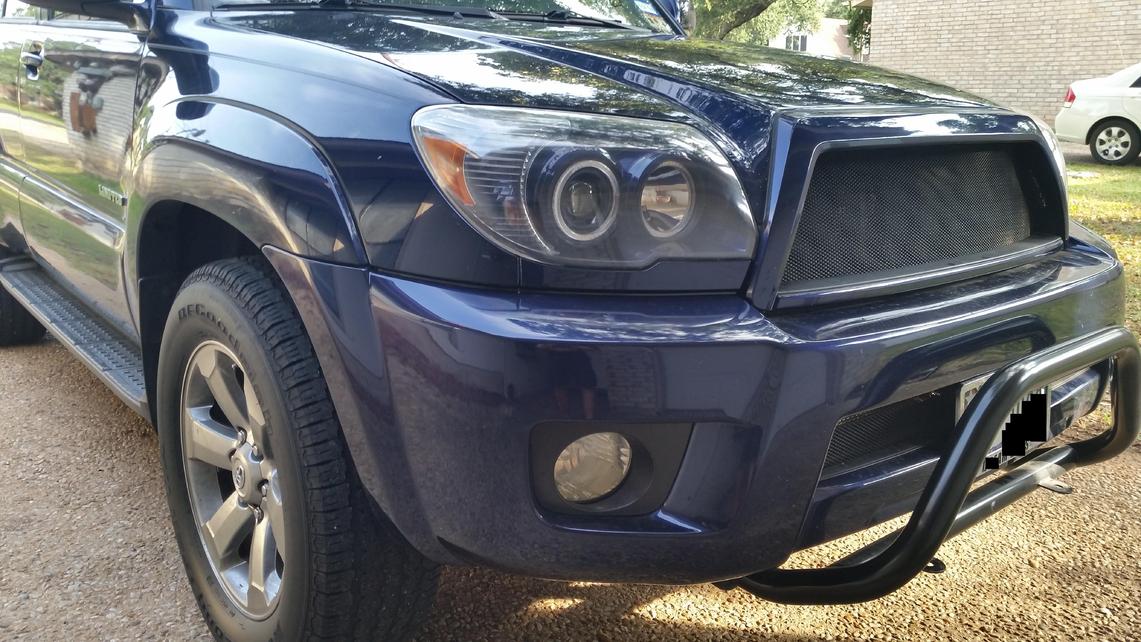

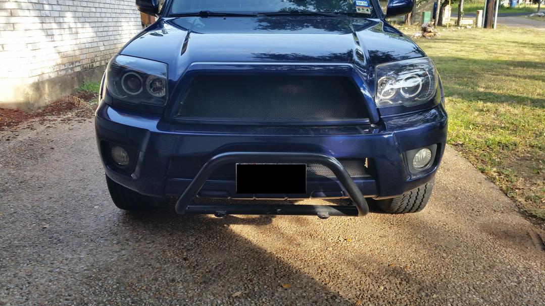

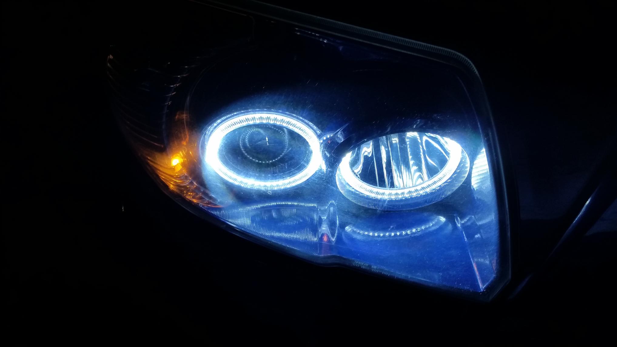

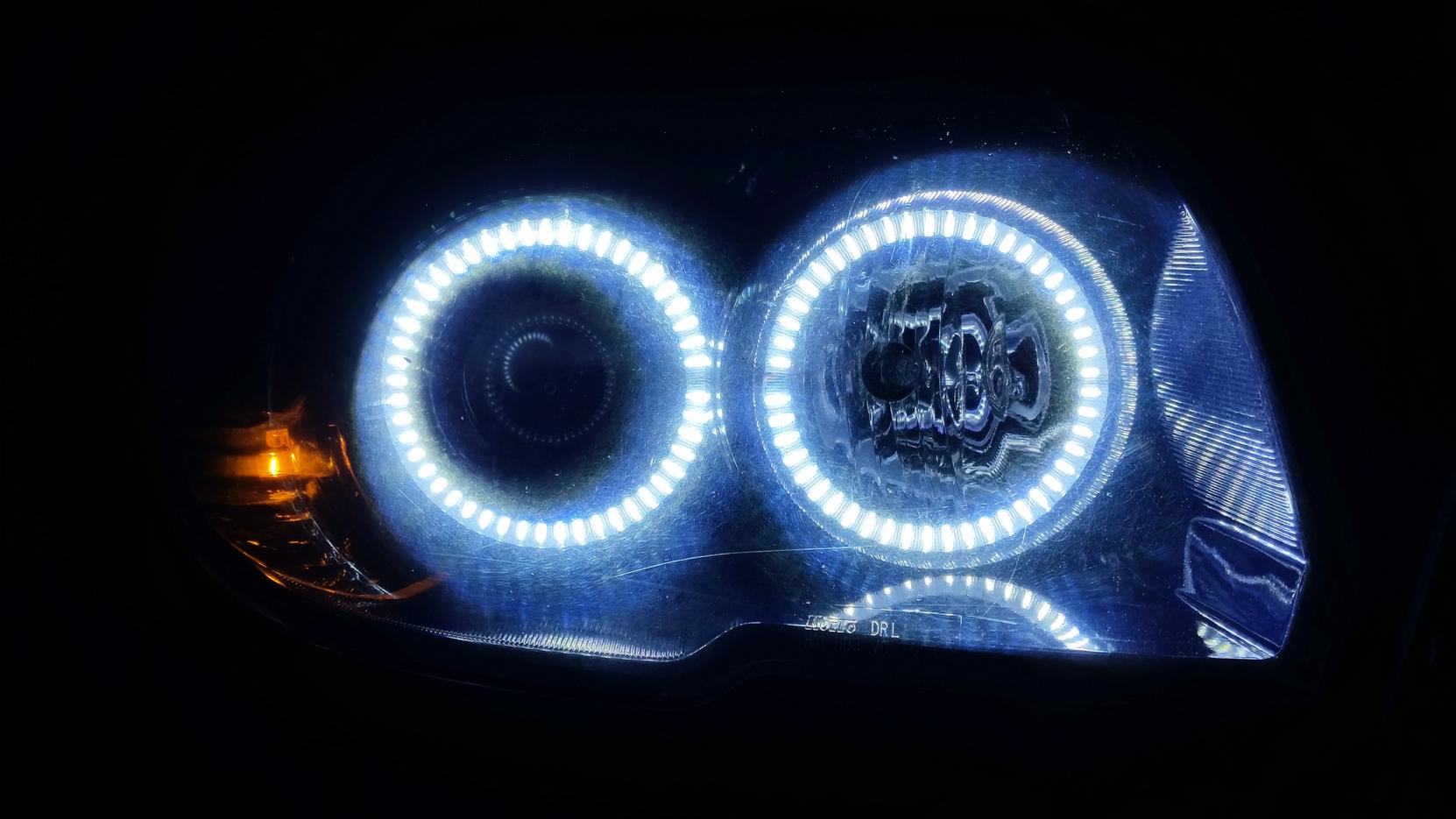

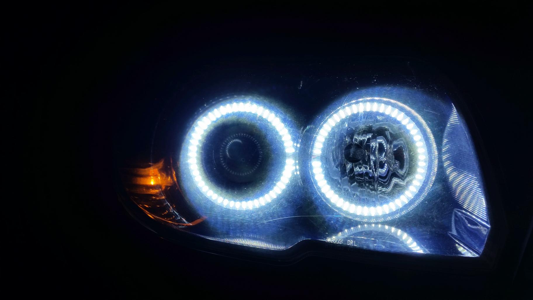

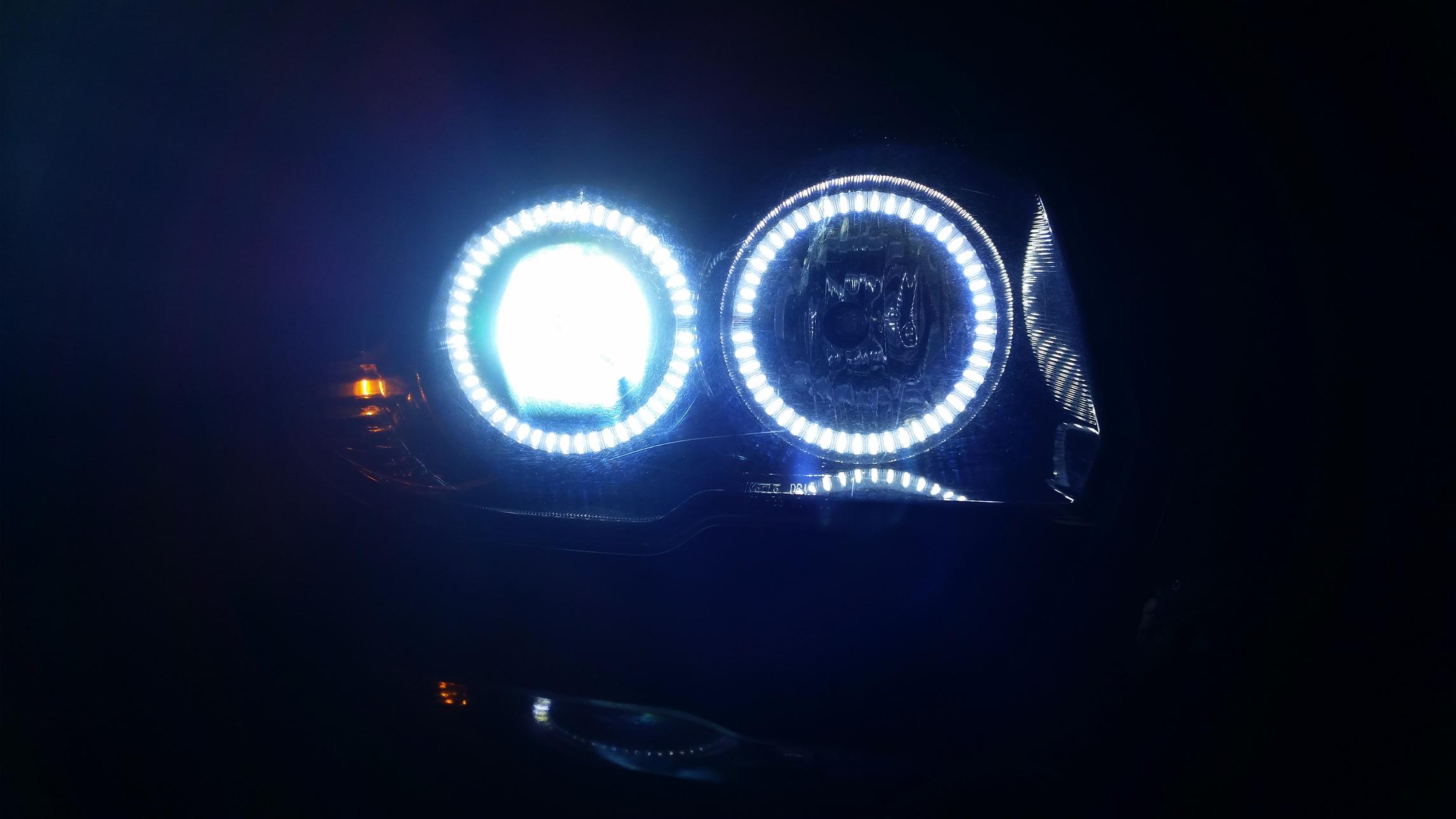

wow they are super bright. night shots with cell phone
They are so bright at night almost looks like my high beams are on. That might be a bad thing...

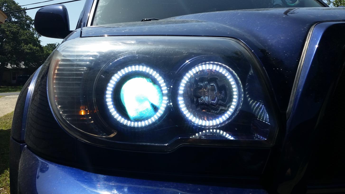

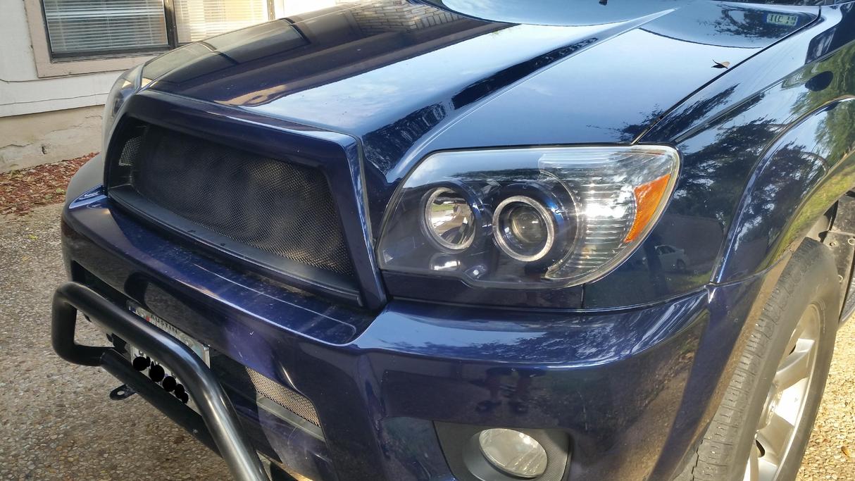

day time shot with halos off.
The guy was able to pretty much sand out the melted mark:D on the drivers side and polish both lenses pretty damn clear
it's a PITA but with time and patience, it's worth it to me....
The halos them self are 200 light werks I think is the brand or light wurks. I bought them off ebay while back. I would assume a paint person would charge 20 to 50 to paint bezel/trim. The mounting of the halos is cheap, glue and wire. The rest is having some tools and time. I bought a cheap Dremel type tool off Amazon. I bought loaner head lights off ebay too. So I could take my time. I hope to sell the brand new sport head lamps when I'm ready to sell them.

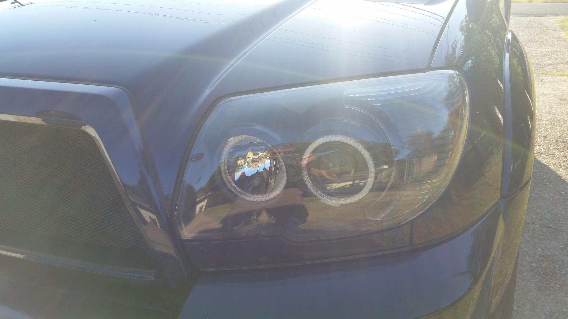

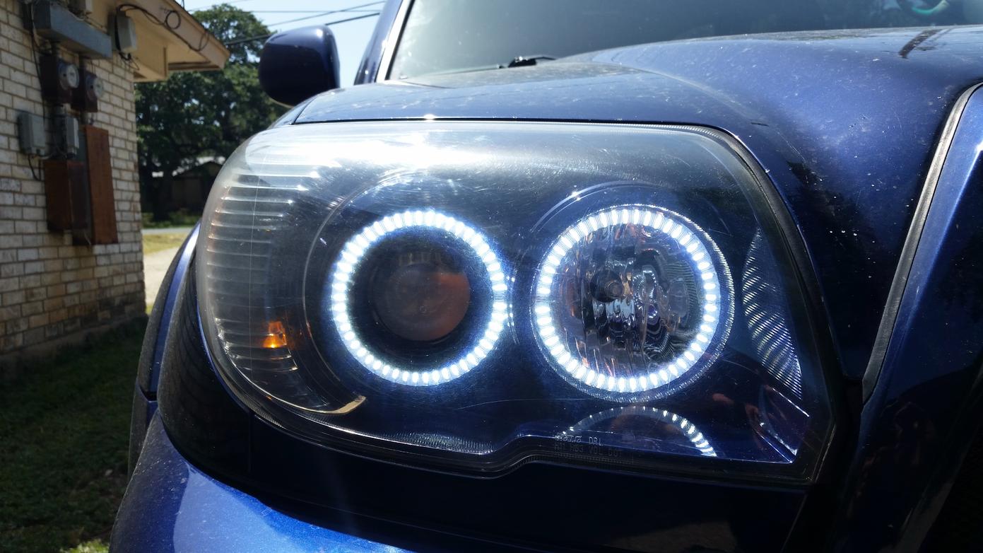

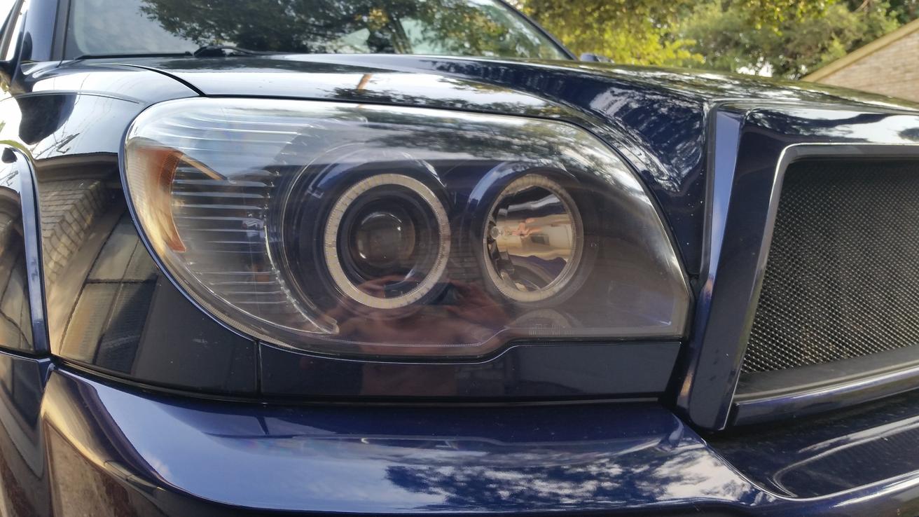

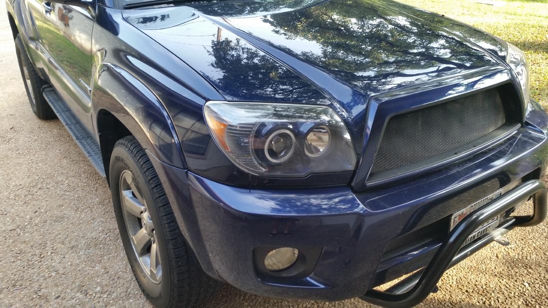

General shots after head lamp lenses cleaned up
I slightly melted the drivers side lens cause of my stupid oven, but the guy was able to get most of it out but if you look real close there is a blem you can point out for sure but over all it looks good. Who knows I may pry off the lenes from the brand new "loaner" head lamp assemblys. "Loaner" being the head lamps I bought off ebay a while back to do the this whole halo light stuff.... Overall so far so good. Still undecided If I am going to run them as DRL or both DRL and head light mode. I don't think I want to use them as blinkers....

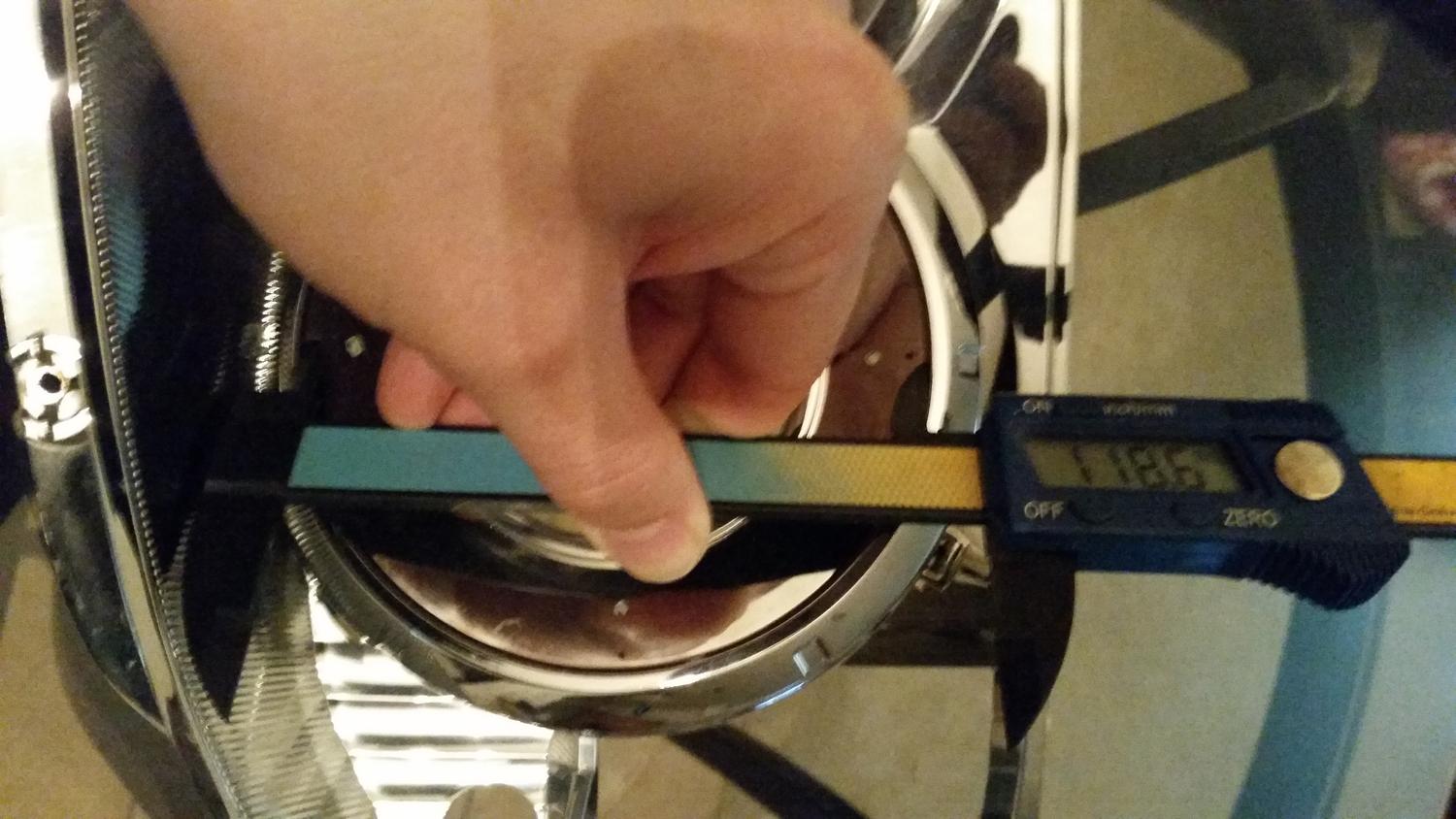

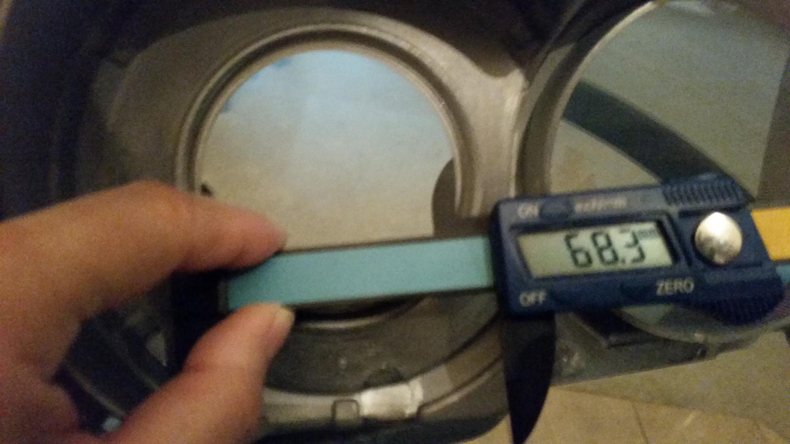

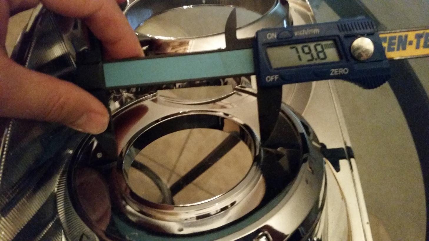

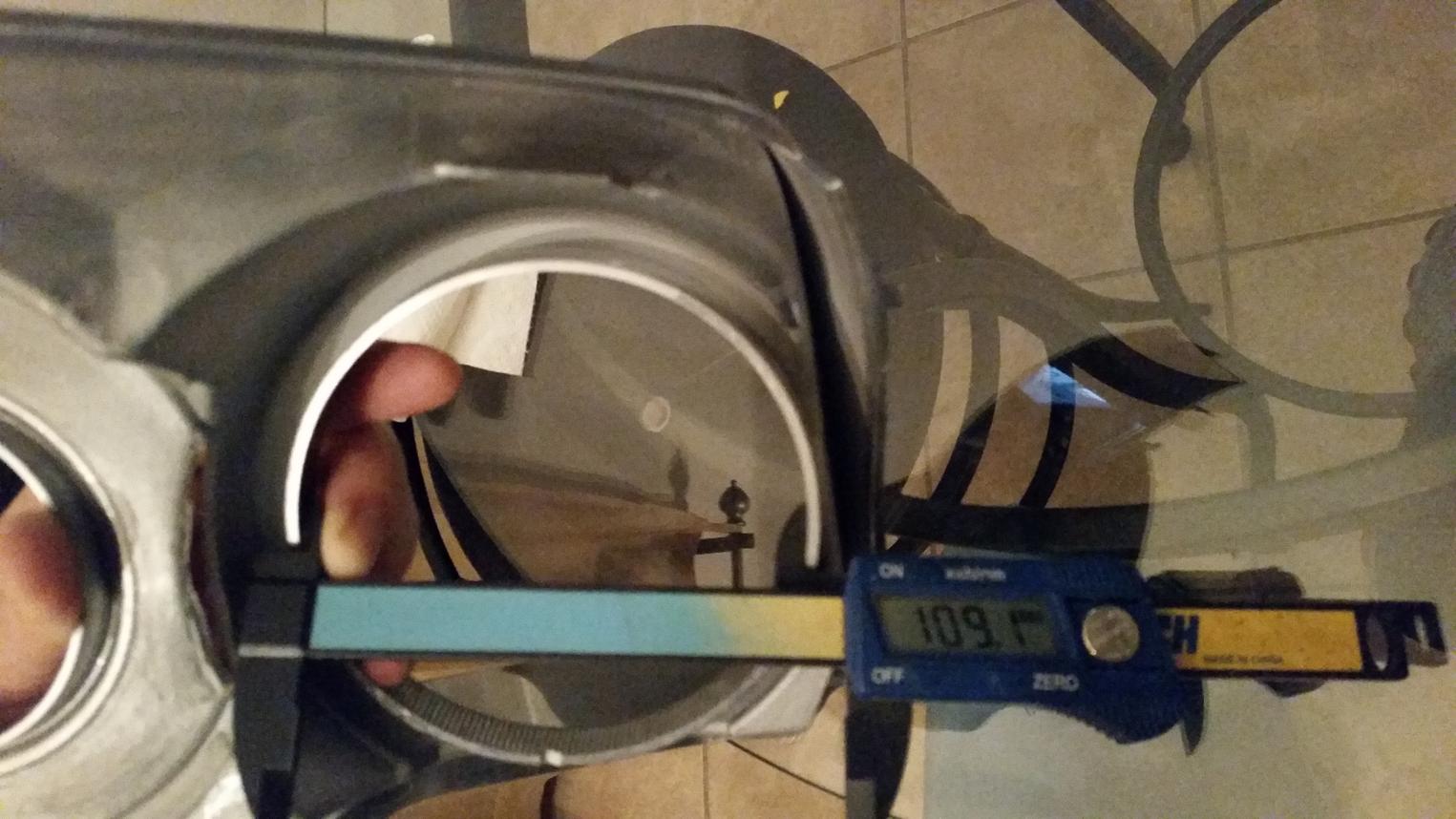

got you some measurements
any luck with the size??
The tool I am using is cheap but it's good enough...
Hope these pics help
The measurements are all in mm
I finally had a good excuse to go in the attic!!
