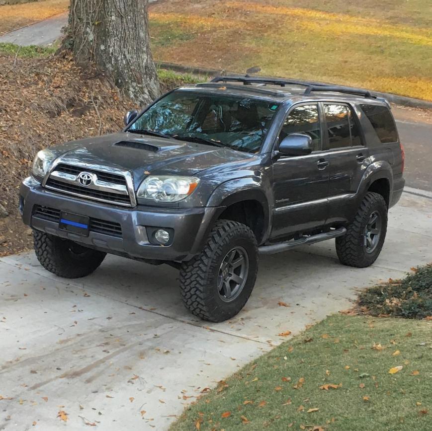

this i the Runner Im building off of.

Im guessing that's the same lift I'm going to end up with. Did you order the front end parts separately or do they come assembled from toytec? It looks like they use a spacer and reduce the shock setting down to .85 or 1.75 with their preasembled kit.

Looks good. That's the amount of lift I'm trying to see.
