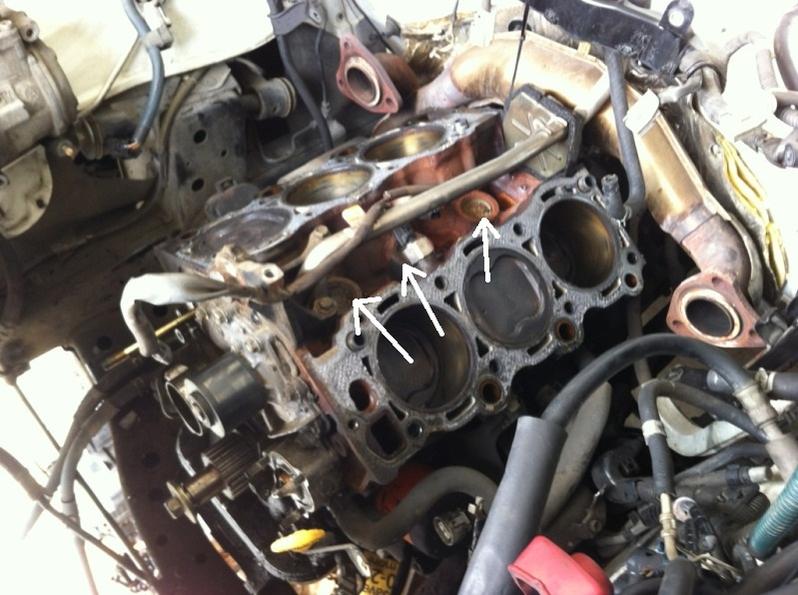

Also have you or anyone else got the actual name/description for those seals that go in the valley of the engine for those coolant lines under the intake? Mine are leaking so I'll be replacing them as well, but I'm having a hard time finding them online.
I haven't found the seals that were recommended by Charlie as well. Charlie, can you shed some light on where these seals are? I'm wondering if i'm leaking from that hose too due to all of that rust in the valley. Could be the lower intake manifold gasket too though..
Where in the valley?
3cf9f75e.jpg~original
498b5a00.jpg~original
I added 3 arrows to one of the pictures posted showing where these seals are.
I have the receipts but can't find them right now. Did a search and found this link: PLUG, TIGHT, NO.1(FOR CYLINDER BLOCK). CYLINDER BLOCK for 1999 TOYOTA 4RUNNER3400CC EFI, AUTOMATIC 4-SPEEDLUXURY(-0008),LIMITED(0008-) (9033135005)
It does not specifically shows those three seals on the engine valley, but if I'm not wrong all of the seals on the engine are the same. If that is the case, then part number should be 11431A - PLUG, TIGHT, NO.1(FOR CYLINDER BLOCK).
Will do a search on a file I have to see if I can confirm the part number.
Found the receipt!
Part No. 90331-35005 PLUG, TIGHT $8.49 each
Don't know if part numbers change depending on the dealer location (don't think so). Anyway they should show you an exploded view of the engine so you can confirm you're getting the right part :)
Another pestering question i have is how did you take the old ones out? I'll have to go to the garage tomorrow to take a look but if i recall correctly, i felt around those three rings and they were solid (not rubbery). Should those be pried out?
thanks !!:thanks:
Hit them with a small drive pin at any spot close to the edge. You'll notice they'll start to rotate in place. Once in vertical position, pry them out.
I applied a small amount of silicone around the new caps prior to installation and hit them with a piece of wood to avoid deformations and eventual leaks.
