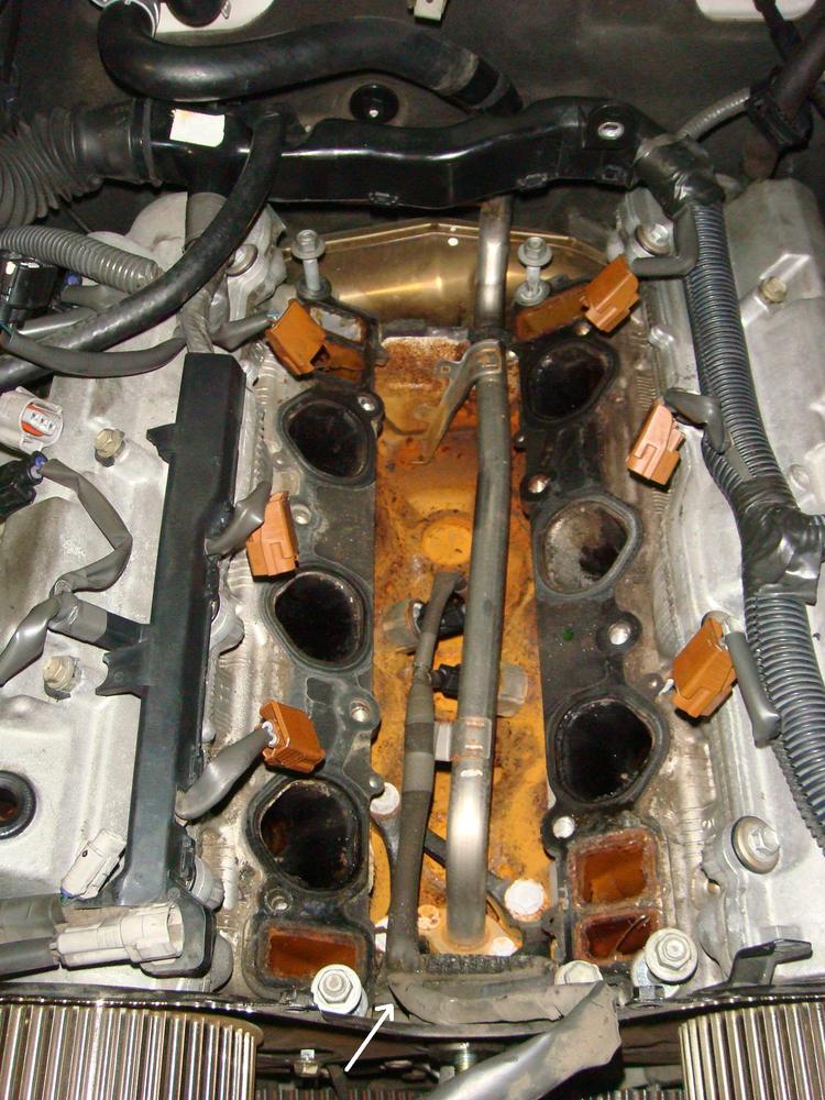

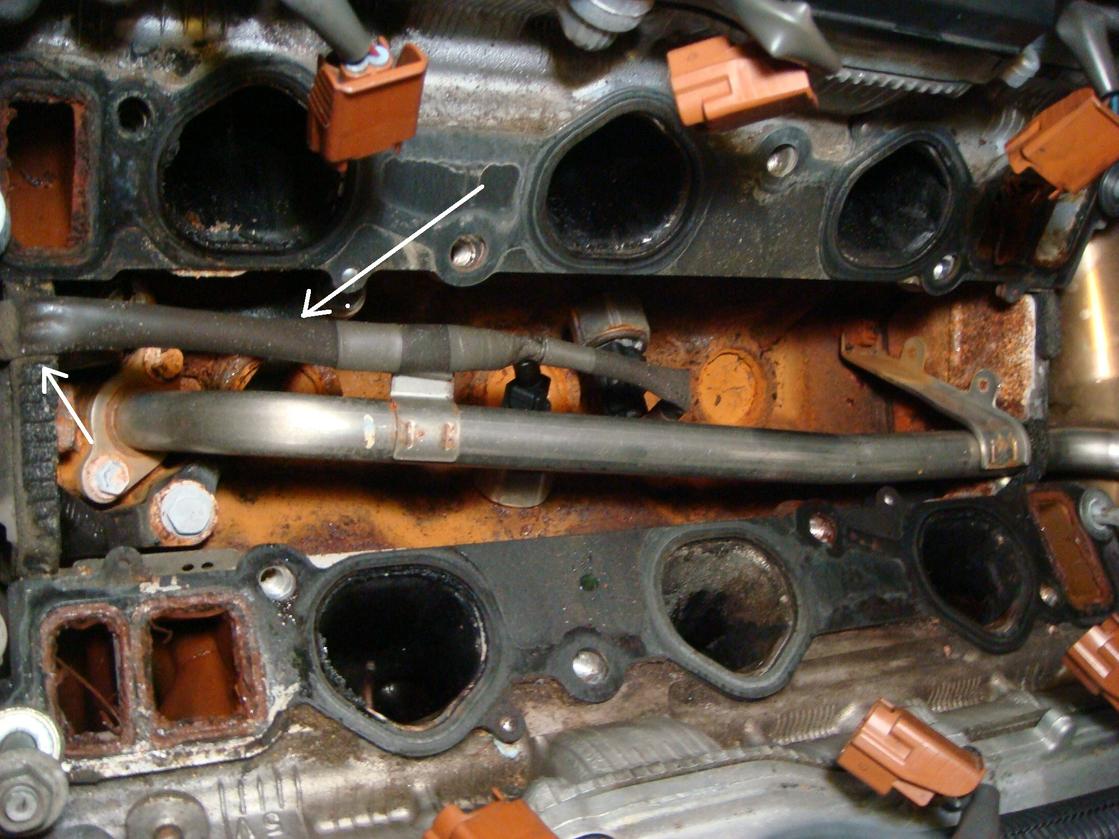

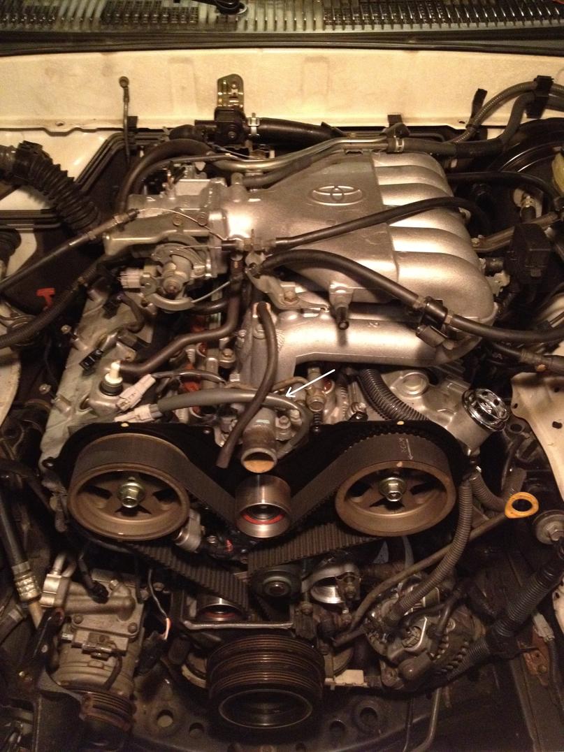

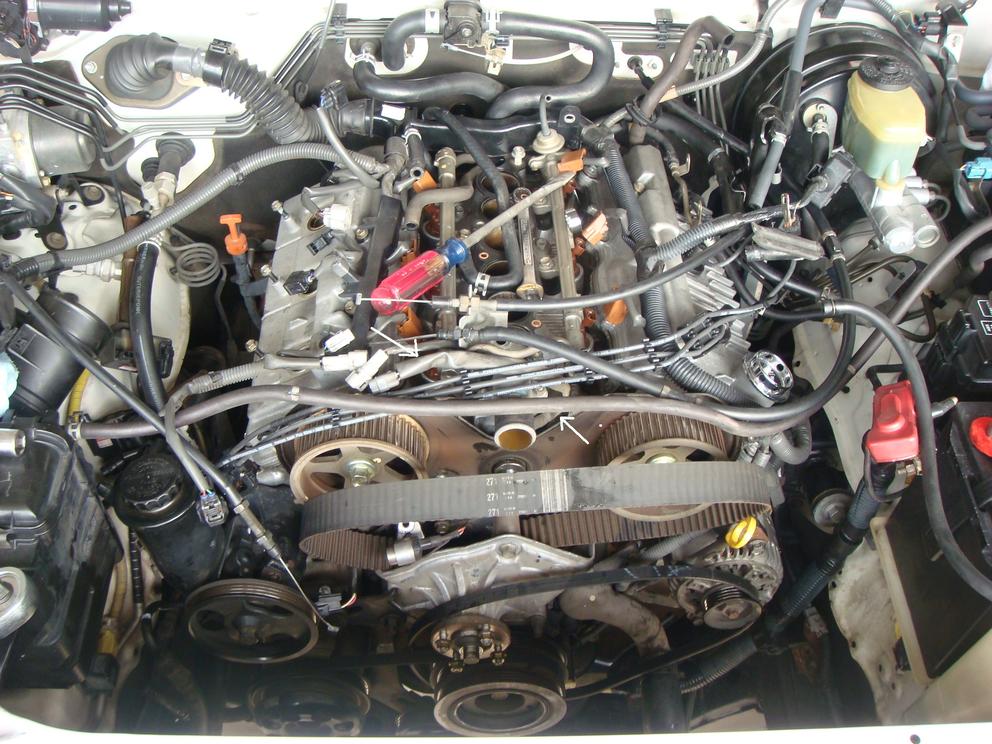

Also does this cable from the valley hang in front or behind the motor? =)
I forgot and curious before i bolt the manifold down.

Regarding spark plug tubes, no idea as I did not replace my heads. Not so sure they can be removed/replaced. Maybe you should try bringing them to a Machine Shop so they can be cut precisely at the same height of the original ones, but be sure there are no other differences other than that. I guess contacting the seller is the best idea.
I included some of my pics regarding the knock sensors harness. Hope that helps :thumb3:
