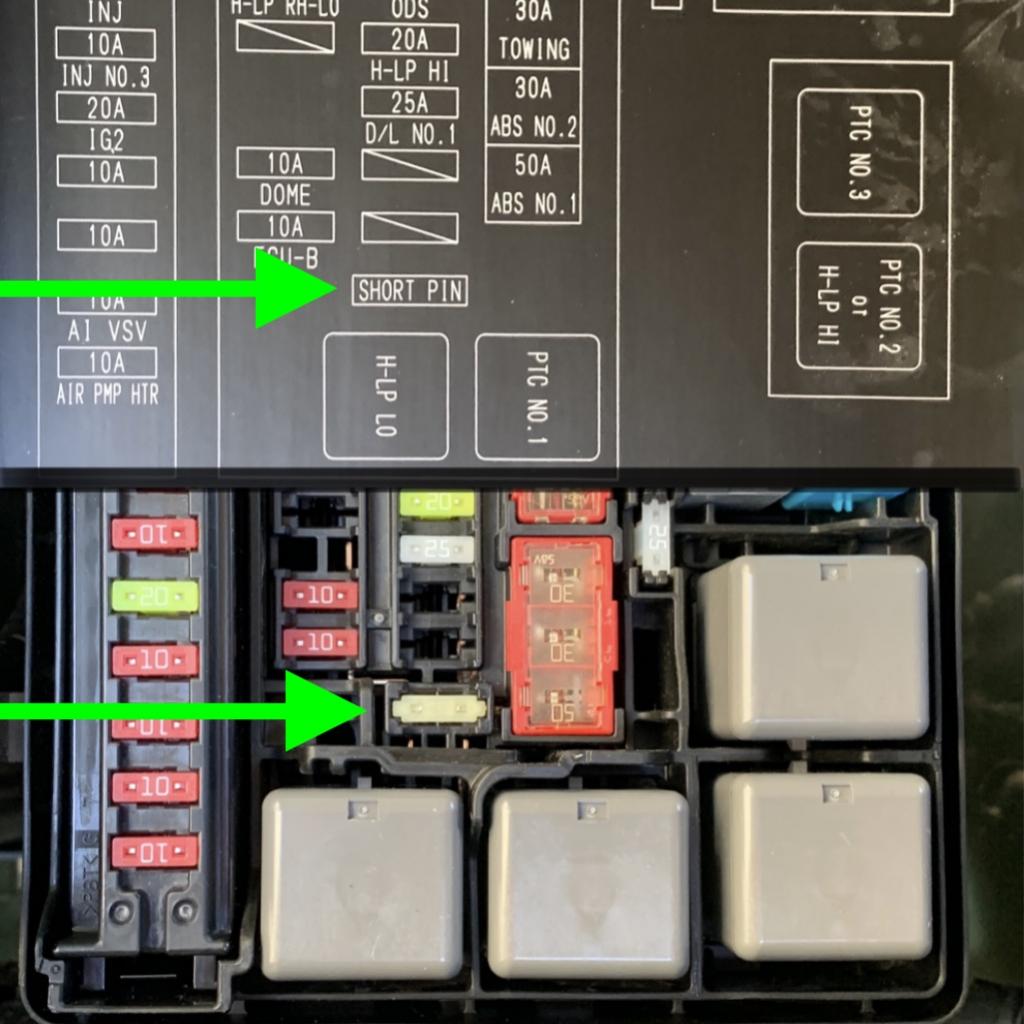

*** I am going to break in here and add something that has come up after posting the info below. According to the plastic lid to my under hood fuse box, the short pin is actually missing! Am I mistaken or is this potentially an act of sabotage on two women fishing in the mountains? Online it seems the short pin should be a grey plastic rectangle type thing. But the fuse box lid shows it was being immediately next to the 30A starter relay— which is correct? And where can I get a short pin? Can I just use a regular fuse?***

Edit to add photos showing the short pin (or lack thereof) in my fuse box…
Apparently I’m too old and/or not savvy enough to figure out how to post photos!
The short pin looks like a fuse with no number on it.
Edited to add: this photo shows the fuse box/lid for a 2022 and the location of the short pin may differ from your 2014. But I suspect the short pin is the same for both vehicles.
If you were thinking of substituting a fuse, better make it a 25 amp, and don’t use any accessories while using it.
One more thing: if you suspect a prank or vandalism, look around in the fuse box to see if the culprit might have just moved the short pin to another location in the fuse box.

Ok, I checked the engine compartment carefully with a flashlight and the pin was found sitting in a crevice down the side of the fuse box. I put it back in and now the vehicle starts and drives once more, but we are back to the same electrical issues. Checked more grounds but I’m out of time for today.
That is very odd. The short pin didn’t just jump out of its slot in the fuse panel.
