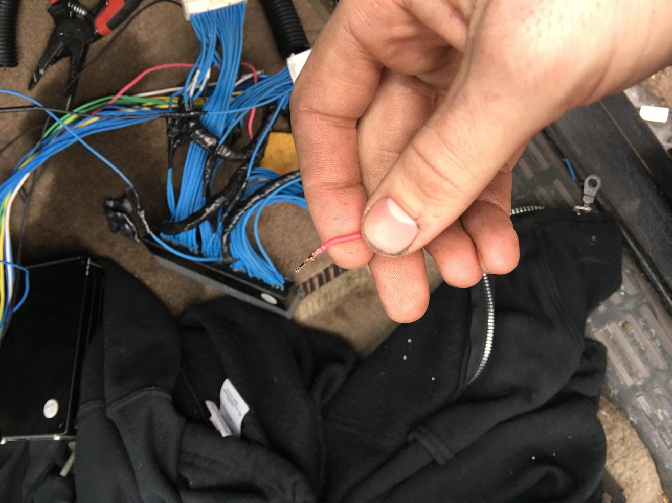

I'm guessing since no one else has mentioned it, I may be the first with this issue. Alright, I originally wired the fic up without using the maf sensor wires, and it ran perfectly fine for several days. I have a Supra maf sensor, so I realized I should go ahead and wired the maf wires in since I'm getting more air and need to accommodate for it. After wiring everything together correctly (blue input maf wire from sensor and black maf output to ECU, intercepted on the VG wire as stated in the table) the truck will only run if the fic is plugged into the laptop. (After googling I found out this is one of the 'neat' features of the fic) The Aem software does not need to be open, the laptop just needs to be on. I've checked the power tap and it is fine. Tomorrow I will be unwrapping the rest of the harness and checking the three grounds, but other than that, I'm at a loss. I've been googling, and I found some Lexus guy with the same issue, but it was a dead thread. I've also re-flashed both the software and firmware and I have also kept the voltage clamp to AEM's default 5v.

I did not have this problem but I also am running or stock maf. I am wondering if is a sensor ground like you suggested. Otherwise have you tired any of the other aem firmware? I doubt it is a software issue but it could be.

The AEM is capable of running from the 5V USB power supplied by the laptop. If the AEM computer doesn't work without the laptop, it means 1 of two things: 1) The +12V or ground wiring to the AEM needs to be corrected, or 2) The AEM computer has a bad power supply inside.
I'm leaning towards 2) if you think everything else works correctly, as the AEM computer would need that power and ground to operate the rest of the internals and signals to the vehicle. Troubleshoot a bit, then call AEM.

Sorry, I forgot to update guys! After resoldering the power wire, and all grounds I still had the same problem. So then, I tore all the electrical tape I wrapped the harnesses with to clean it up the crazy wires and protect it. After that I found out that the Ign Pwr wire pin had backed itself out. Of course I found this out AFTER redoing those wires and taking off my tape! haha
No issues since and I actually just installed my supercharger last Friday, so I'm working on getting the tuning dialed in! Thank you for this thread, MTD. It has been an enormous help!
