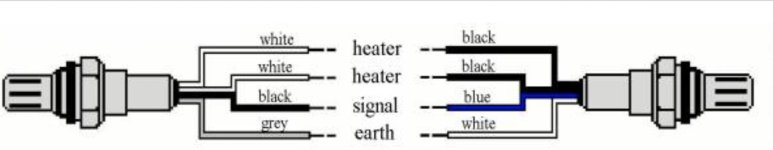

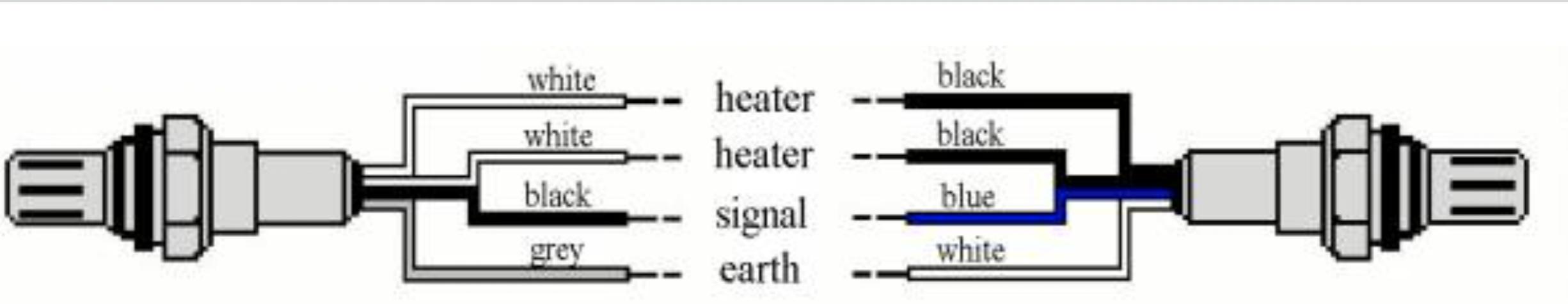

Hey, so I went to complete this setup and when I pulled my down stream O2 sensor, the colors don’t match. I have two whites, a black, and a grey wire. Has anyone found this on their Toyota? Running a 1997 Tacoma. Thanks!
According to the image here the corresponding values should be:
Black = Blue
Grey = White
Just double check to make sure that both the heater wires are white! Else maybe its another configuration
