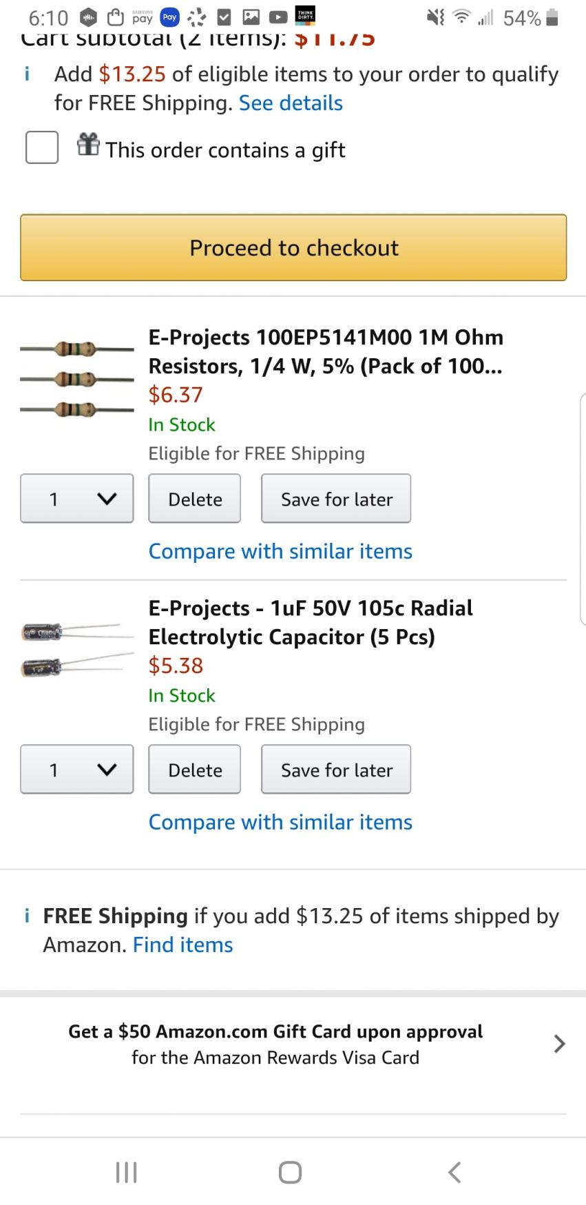

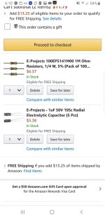

Anyone know if this will work?

Good evening, i know its a old post but i met a huge issue on my 4th gen srv5 2005 petrol 4 runner. And am going to attempt this hack to recover it, hope it works.
my issue is lead. The place where i am we still use LEAD fuel, of course catalyst are not happy with that and i get Bank 1 P0420 and bank 2 P0430, of course the catalyst is ****ed up, therefore i need to remove it completely and will try this resistor/condenser hack, hope what i found is suitable, its not exactly what OP is recommending as my capacitor is a 50 volt capacitor while radioshack's is 250 volt, but the 250 is not available. its still 1 microfarad though, fingercrossed till tomorrow i guess
Didnt work for me, after placing the sensors back ( i have 2 of them) i get a P0138 code and a P0158 code, and in addition i get a P0606 Code ( voltage issues the first 2 and ECM failure the third one) need to look for another way round
