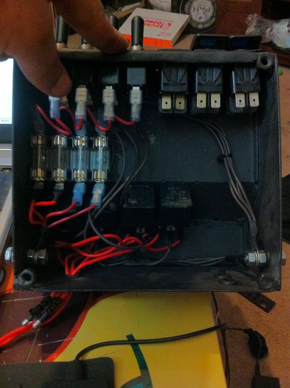

Why not just do something similar to what I did?
I put a gound and power stud on each side of the box, so that way there's only two wires going to and leaving.
All my power wires go to one stud, all the ground to another.
You would've only had to take two wires instead of six then.
Just a thought.
I have 5 different sets of lights that I want to be able to turn on independently of each other, so they all had to go to a separate terminal on the aux fuse block. The 6th wire is the power wire for the rock lights, so that had to get through somehow too. All of the grounds are going to be grounded to one spot though.

Dammit. That's genius. Why didn't I see that before? If anyone is thinking about following this as a guide in the future, do that ^ instead of what I did haha.

So are mine. Each switch is run to a 35 amp fuze, which is run to the power stud. each relay is run to the power stud for power. Each switch is then run to each relay, and each relay is then run out the back of the box. Like so:

That's a really good idea. Just make sure you use some big ass wire when you make the run from the battery to the box. If you go too small and turn all the circuits on at the same time it could burn some stuff up. I would also put a fuse on the wire run from the battery to the box.

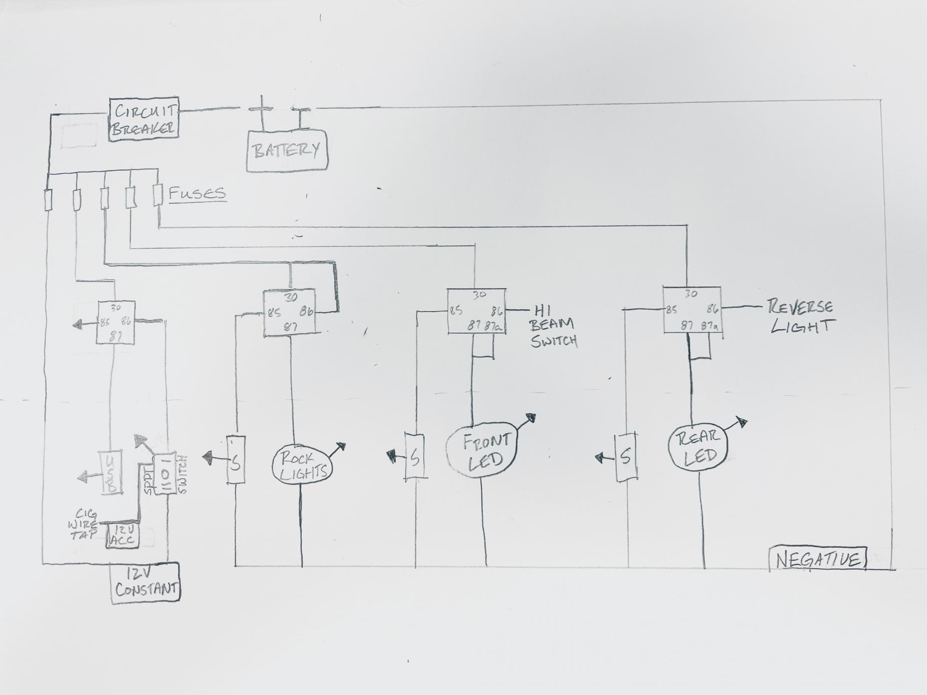

Accessory wiring help
Is there anything wrong with this wiring diagram? I’d take any help on locating the hi beam and the reverse wires to tap into.
