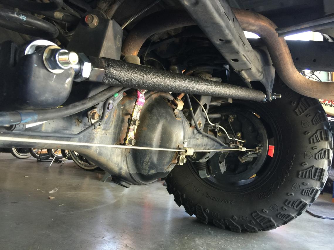

Lateral Control Rod
Finally put on the lateral control rod (aka panhard bar) with 7/8" heims from RuffStuff specialties on that was line-x'd.
Thank you [MENTION=120071]mtbtim[/MENTION] for your tool time and expertise !!

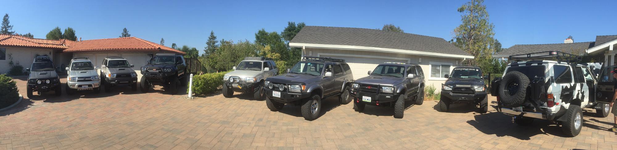

Sick Mods BRA! I was the odd man out with a stock truck. It was cool to see all the different things the other dudes have done with their trucks. A lot of time and money has been spent on some of these rigs.
Allgood man, aside from a lift and bigger tires, my 4runner is pretty much stock. I actually like the stock look.

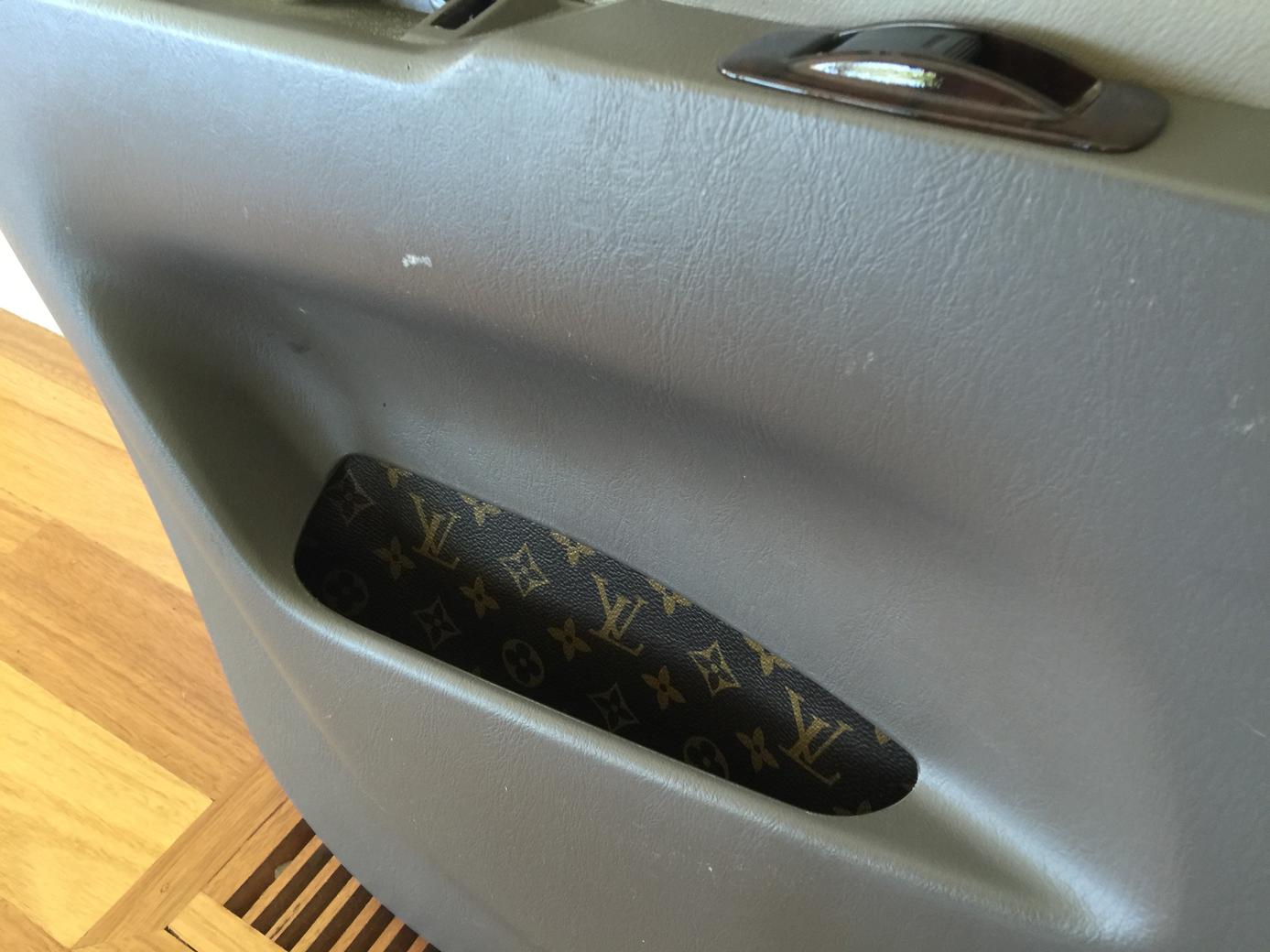

Had to add a little Luxury
woodgrain grippin' louis V sittin'
grabbed a Lexus wheel from [MENTION=105773]busmup808[/MENTION] & took apart my door to add dynamat and some Louis Vuitton in the door cubbies. [MENTION=133963]GGFerrier[/MENTION] knows. . .

Sup bruh. It was good meeting you today! After reading through your build thread i can definitely say pictures doesnt do justice for this beast! I wish i had more time to check out your rig...mine didnt even look lifted compated to yours. I shouldve taken a pic of them side by side and i actually wanted to crawl underneath it to see all the things youve done haha. Love the attention to detail on the mods youve done and maintenance videos with [MENTION=120071]mtbtim[/MENTION] as well.
When i have time ill be using your videos for reference and hopefully i can meet up with everyone during the next meet!!

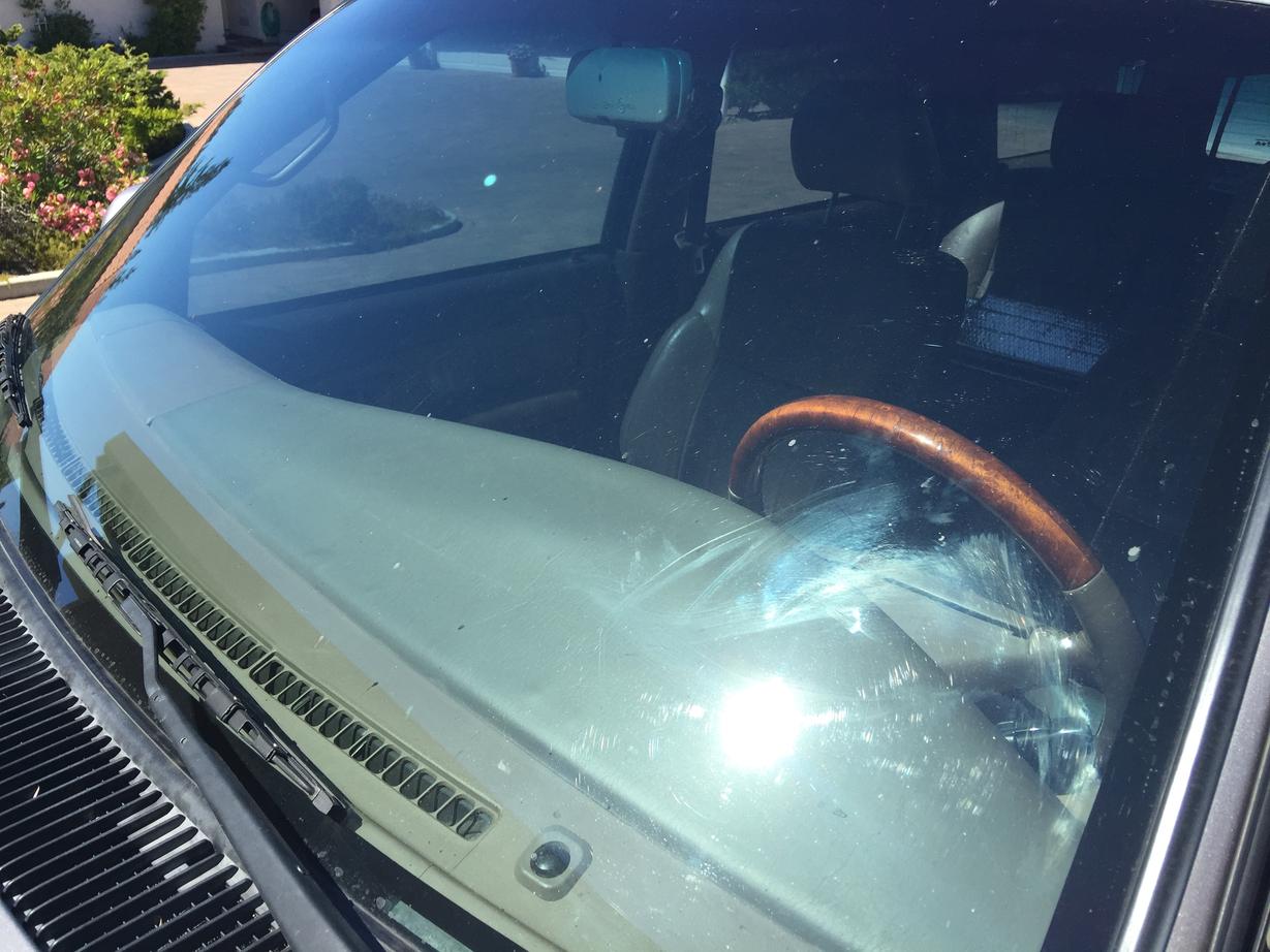

Did you find out how to run the cruise control?
It worked on my 98 with no issues. It was a plug and play for my truck. Being yours is a newer truck, the plug might be different
Sent from my SM-G900V using Tapatalk
I totally forgot about that... Does it work?
It doesn't work but I believe it is a fuse that has blown since we have swapped my wheel multiple times...
I just haven't looked to see where the cruise control fuse is to see if it's blown...
Because there has been no response since the swaps...
