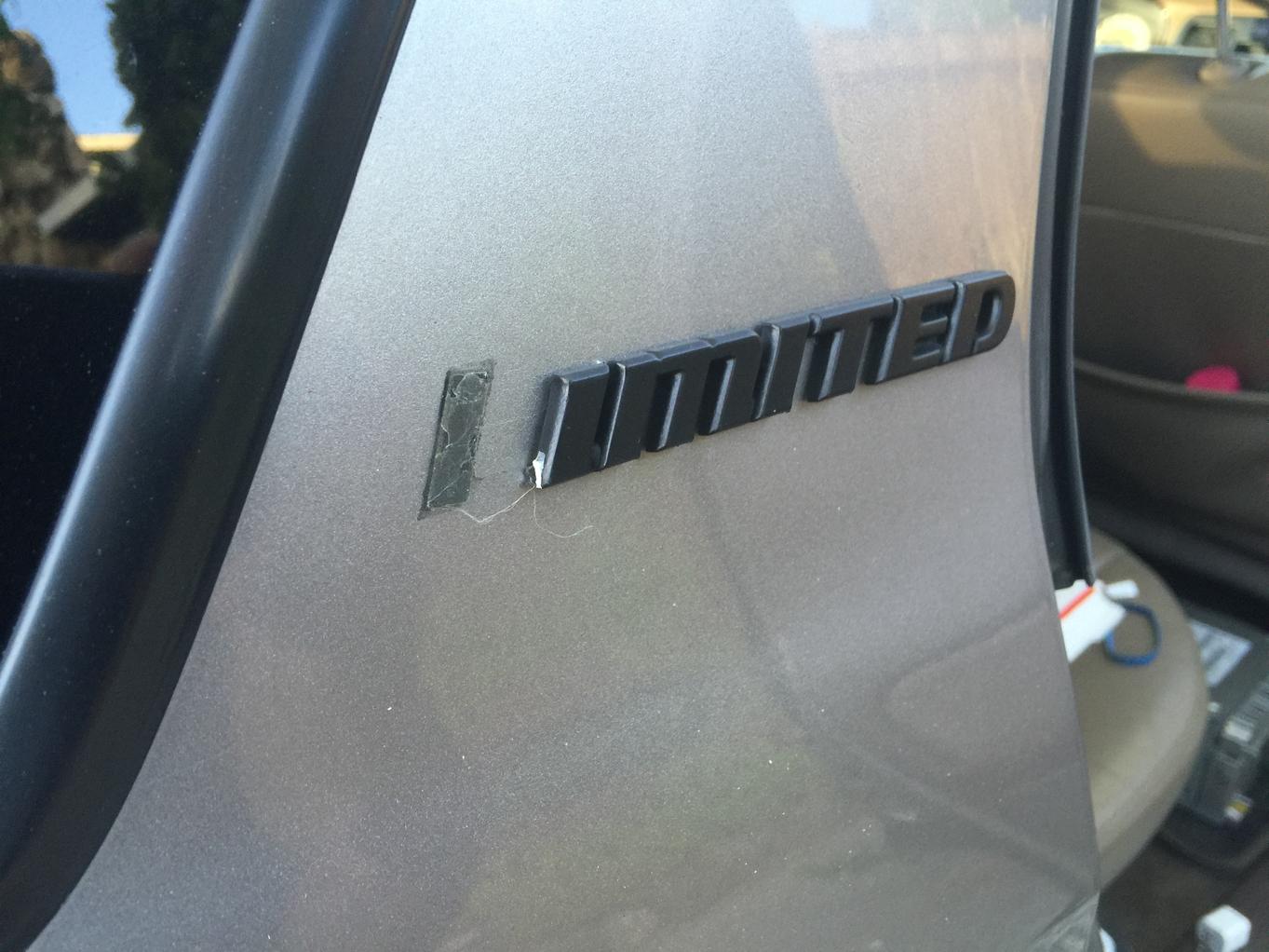

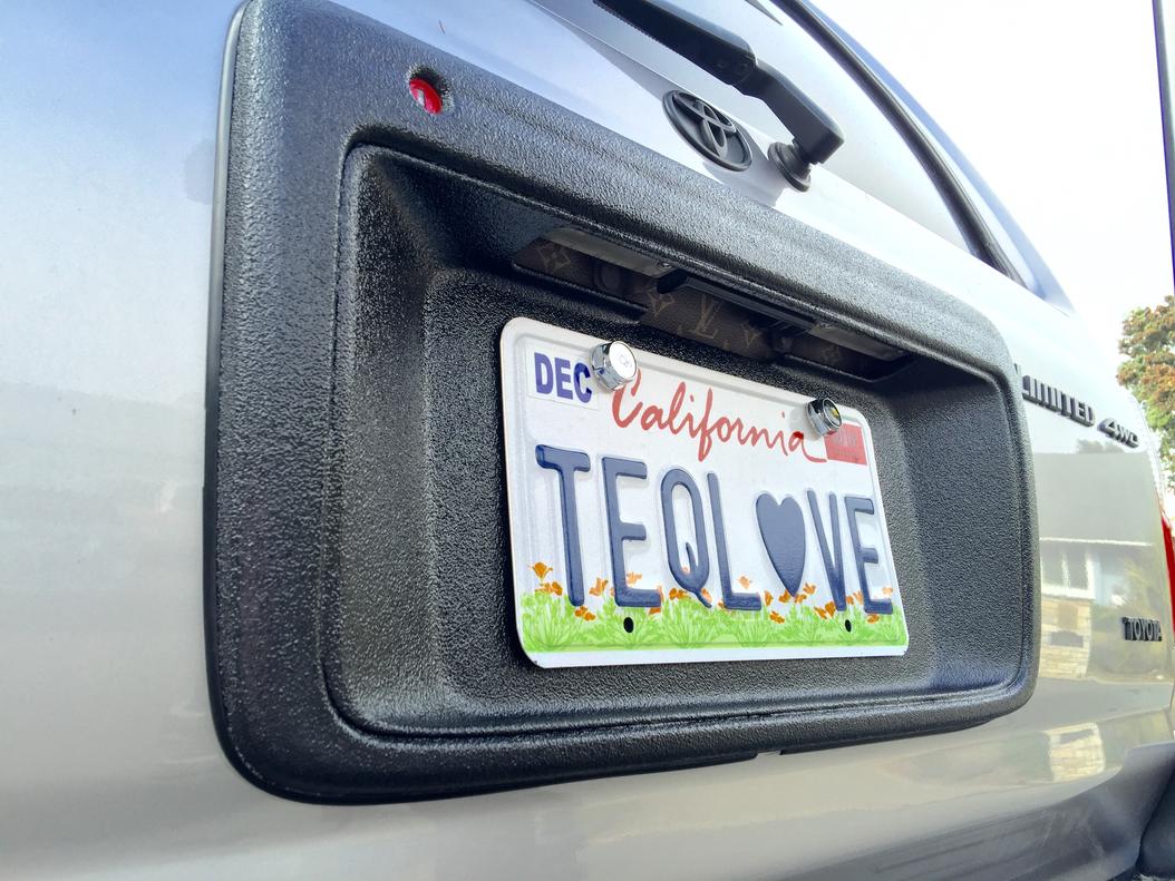

Got a little overzealous with my car washing and the soaped up sponge ripped off my "L" to my limited badging...
I guess I have the worlds first "imited" lol.

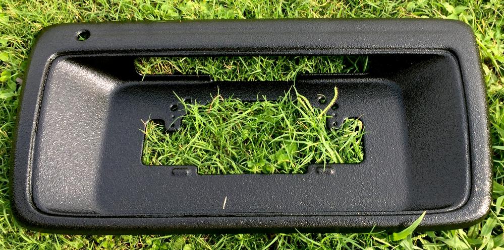

This should be there on Sat! Looking forward to seeing your install pics bro!!
So it is partially installed... Far from perfect and very frustrated
It's not sitting flush against the rear hatch...
Plan B is to JB Weld some bolts in place of the push pin clips ...
That way I can tighten down down a nut, instead of a flimsy plastic clip pushing through a hole

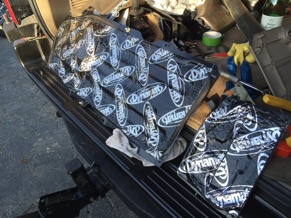

Added some dynamat to the rear hatch
I put some Dynamat on the rear hatch metal panels while I had them off.

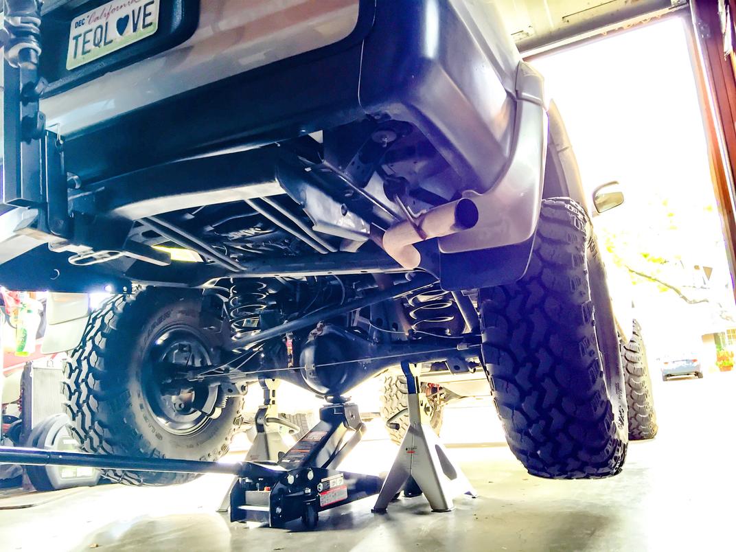

Kicked it with [MENTION=120071]mtbtim[/MENTION] and check out my rear drum brakes. Inspected & cleaned
Also, I gained another 6" of lift!!!! (Temporarily)
Neither of us had much experience with drum brakes, but I did remember something from my Chevron Gas Station days. Sean's drums wouldn't come off so we had to pull the rubber grommets of the backing plates and turn the adjuster to get the drums off. Like usual, we turned it the wrong way the first time and tightened the brakes even more. Loosening them was problematic but I finally remembered you need to push the adjuster plate away from the adjuster wheel with a screwdriver so you can turn the wheel with another screwdriver or actual brake adjuster tool and loosen the brakes.
I think I'll be investing in some drum brake tools now.
