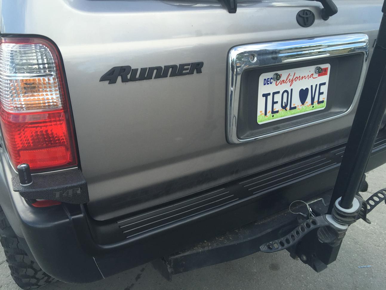

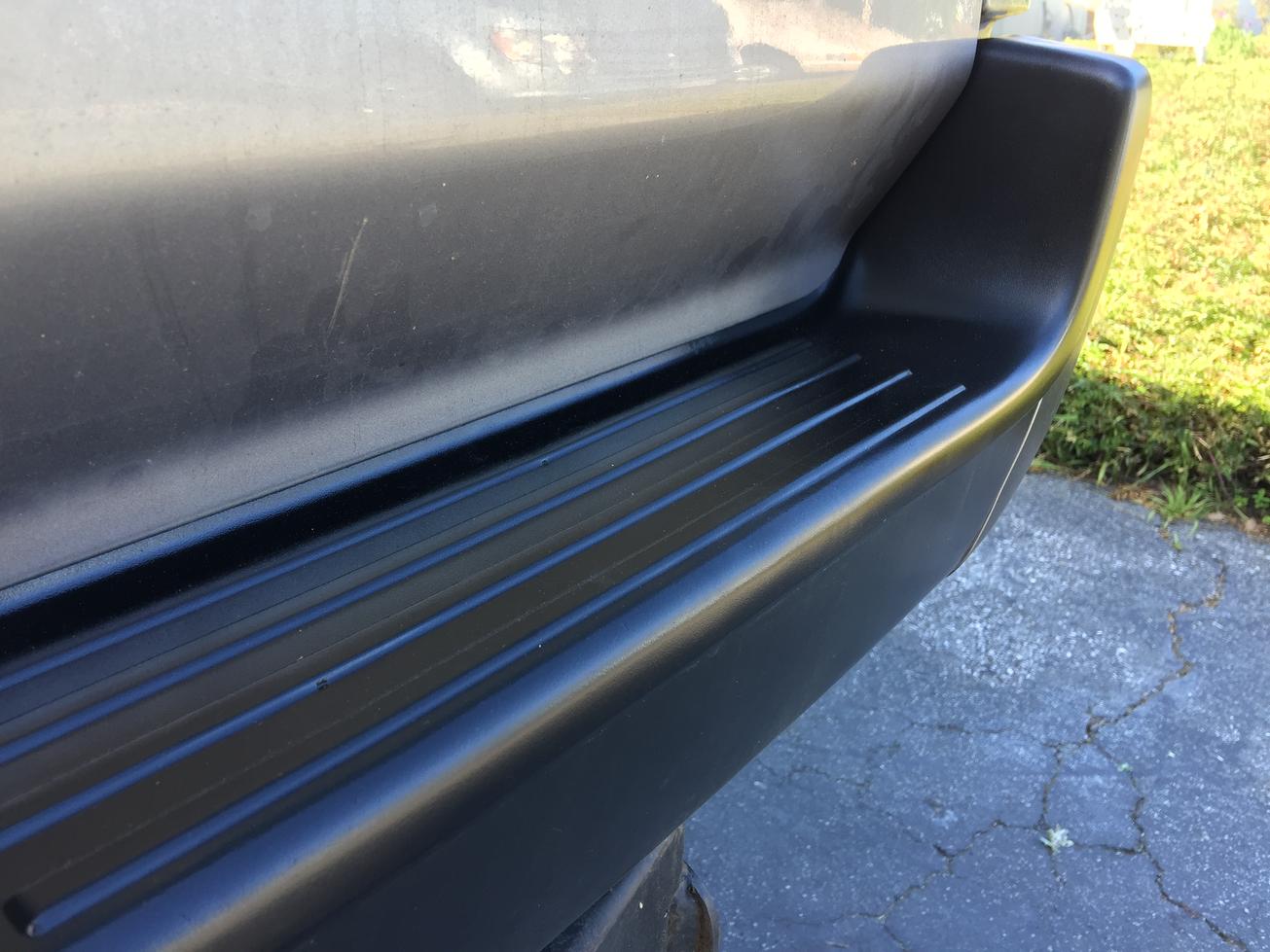

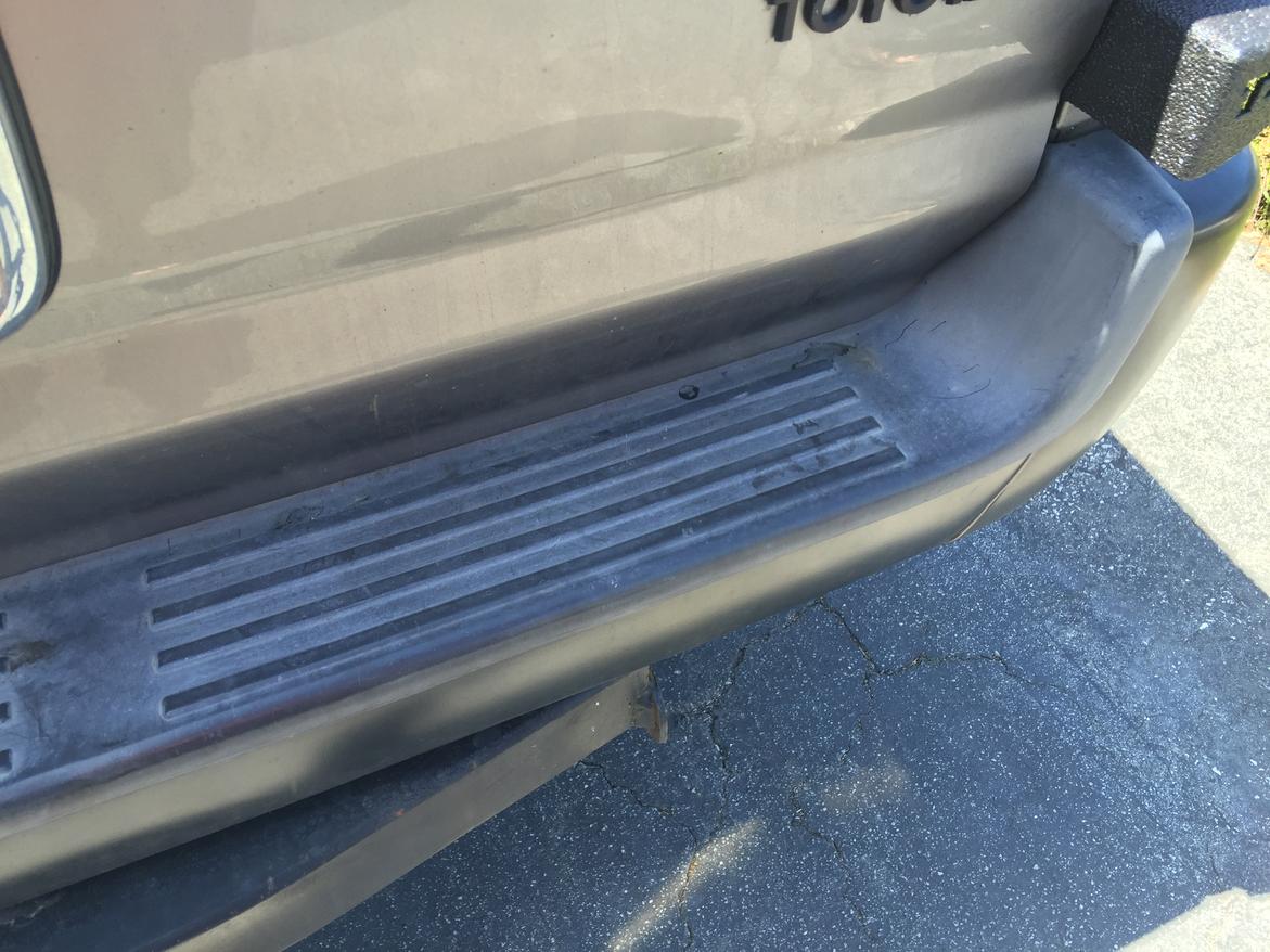

I bought some Rustoleum® Trim Paint for my rear bumper valence.
In my opinion, it is a little too glossy for my liking, but for now its a nice refresh for such a faded piece of plastic.
I have an extra one that i will try the heat gun approach to compare since i prefer a more OEM type look.
I passed over it at different angles approximately 6-7 times, starting with light coats then laying it on a little heavier as I got closer to the last couple coats

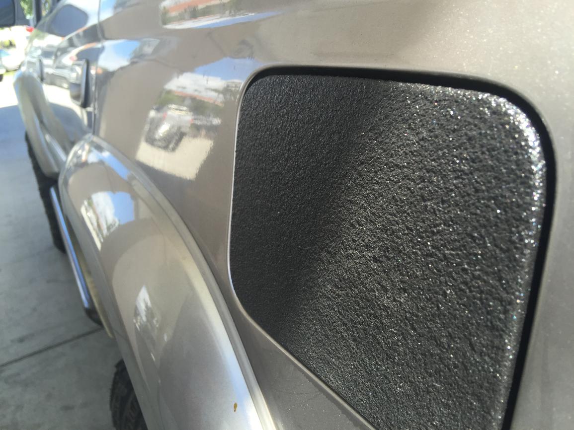

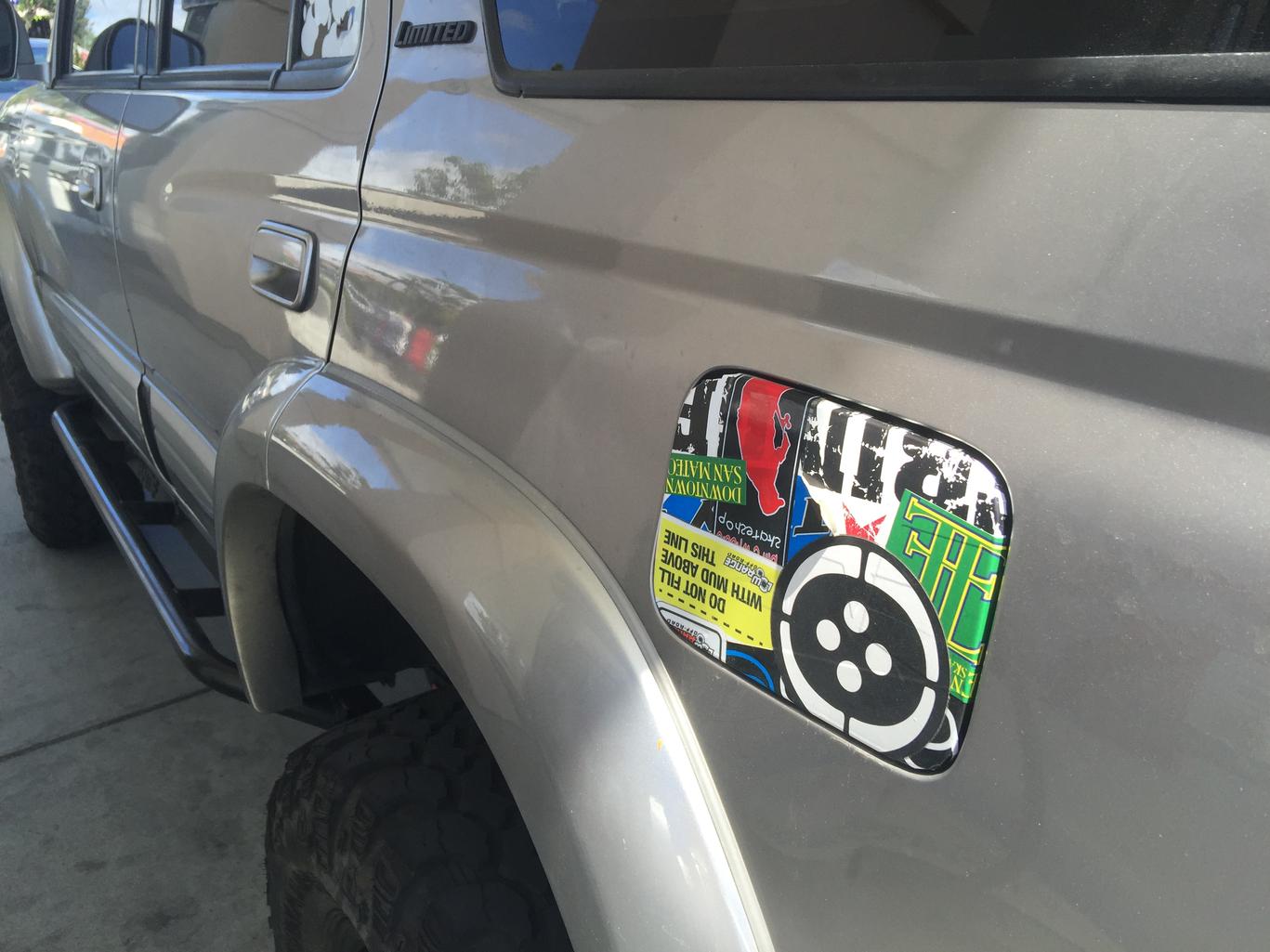

Well done on the gas door, I am a big fan! But I admittedly am addicted to line-x...finally installed my license plate bezel (love it!)...if you want, I can get my old one sprayed for you if you are interested.
soooooo unbelievably interested its not even funny...
every time i bring an item to my guy that does line-x in my area, he constantly is telling me about he's not going to be able to do it & blah blah blah... especially on plastic...
so a big YES PLEASE!!!!
is it a 99+ bezel?
is it a 99+ bezel?
Sure is...came off my '99. I will drop by Line-X in the next week and get a quote for you and let you know.
