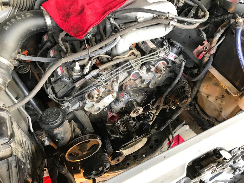

[MENTION=120071]mtbtim[/MENTION] & I started to Tackle the timing belt the other day...
Timing belt & water pump replacement - 169,000 miles
I went with the aircabinman kit from eBay.
Many here have had success with that OE replacement kit.
I bought a crankshaft pulley bolt from my local dealer for $11 as Toyota states that this part is a NON replaceable bolt.
We ran into a bunch of snags like having the right SST to remove the crankshaft itself, a stripped bolt hole in the aluminum where one of the pulleys secures too, & even getting the belt back on without turning everything was hard because it was so taught!
In true Timmy the Toolman & sean fashion, a video will soon follow after the appropriates edits are completed so stay tuned for that.
It was apparent when we ripped everything off the front of the engine that the water pump would need replacing in the near future due to the dried coolant crust around gasket however the belt seemed to be in "like new" condition with no signs of cracking. These belts are pretty robust. But whatever shop worked on this truck before I owed it ruined & stripped a stud & one of the pulley mounting locations. Just another reason I H8 auto shops in general because at the end of the day it's not their truck, & they want to get it done as fast as possible which leads to them just zipping things on quickly & ruin threads with their fancy air tools & lack of patience to make sure the threads are going on correctly.

The only reason these belts normally fail is the water pump starts leaking and coolant gets onto the belt and degrades it.
I used the same kit and it's good stuff. TB/WP isn't a bad job on these trucks at all. You'll probably notice how much quieter it will run afterwards with all new pulleys. It just sounds smoother. That was the first thing I noticed when I started mine up after doing the job.

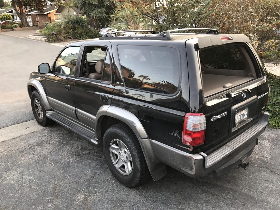

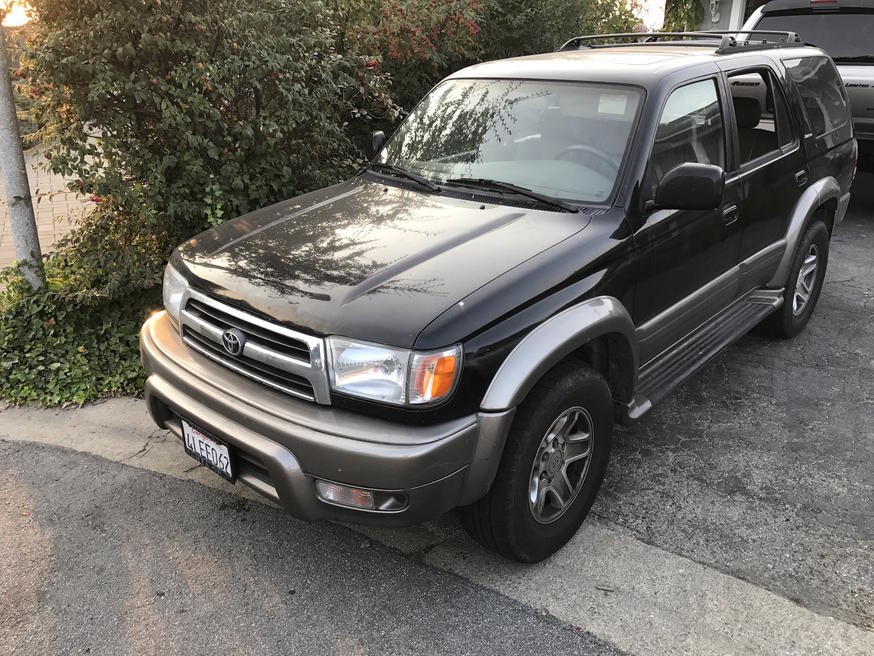

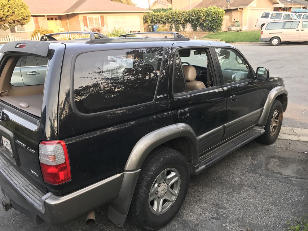

Adopted a 17 year old
I recently passed by a co-worker in the parking garage getting out of his 4runner I saw often & I was like whoa! "I didn't know this was yours!"
He said it was his girlfriends mom's & he has just been driving it for the past year & that they are wanting a newer car so they are selling it...
Immediately I was like, "wanna sell it to me?"
Well, one month later, I bought it from him for a super duper fair price.
Yeah, it had a couple of things it needed. The worst being the ignition cylinder (it had to be drilled out by him to get it to start), but i figured with my experience with 4Runner's & having this wonderful community I am proud to be a part of, i thought anything was possible...
So to make a long story short, I am now the proud new owner of a 2000 4x4 Limited, factory e-locked 4runner...
Fun Fact: I have only owned 3 automobiles in my entire life & all 3 have been 3rd gens... a 99, a 2002 & now a 2000.
so this new to me 4runner with 190k on the clock is technically my third 3rd gen. HAHA!!! pretty cool IMO!
everything works pretty much, all windows, AC blows cold, 4x4 works etc with a little body scuff damage on the drivers side.
But what i liked best when i was test driving it was how smoothly the transmission shifted, especially with my recent experience with how my current 4runner had the transmission explode at 160k.
I am one happy camper.

Nice job Seth. So I take it this 4runner is now going to be the one being worked on in Tim's garage for some time then?
I spy an Aerostar......
Nice congrats on the new rig! What are the plans for it? DD?
My DUDE!!! well, its not as in good condition cosmetically as my main bae (my 2002 thundercloud) so i won't be able to keep this one stock for long....
i've already gave it a little TLC... build thread will come soon.
Nice job Sean. So I take it this 4runner is now going to be the one being worked on in Tim's garage for some time then?
hahahah, well now that i have 2 4runners, we will be able to do more videos of #sickmods for quite some time....
as for the aerostar, this has been my mom's favorite car.... at one point she had 2!
they are a classic car/van & has been a great car as well..... you know, they just don't make things like they use to... & this is why i hope to have a 3rd generation 4runner for as long as i can.

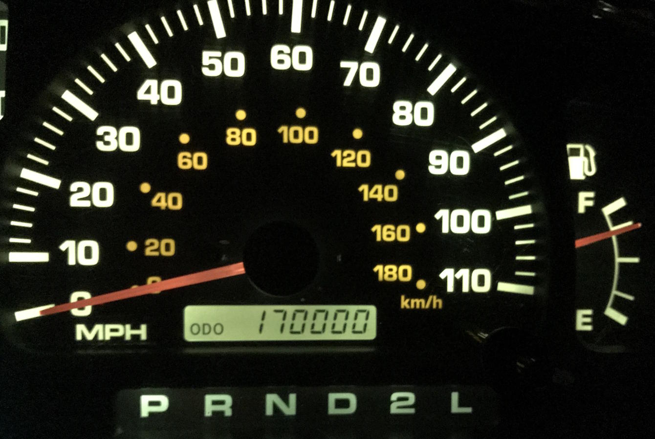

In other news, my main chick just hit 170k..... they grow up so fast!
