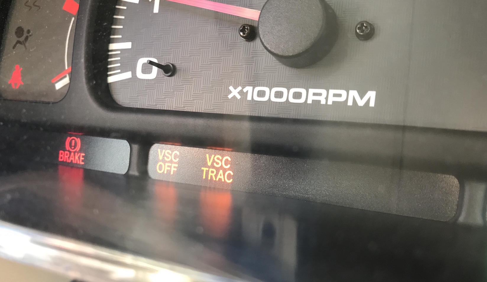

today I swapped my front seats with a set i got from a buddy & replaced my "D" light in the dash cluster in hopes to get rid of the VSC OFF/ VSC TRAC lights that have been on ever since i got an alignment a couple years ago...could it be a defective wheel sensor?
I read on some thread a while back that when a light is out on the cluster or the shifter it could cause this...
I have tried many attempts at the zero point calibration with no success.
Having lights on my dash is just plain annoying & it just sucks i haven't been able to solve this issue.

Have you ever done the andy mod 2.0 yet? If so, maybe a short in the wiring? Thats what ended being my problem when the lights came on.
I have not done the Andy mod 2.0 yet because I wanted to solve this issue before I put it a switch which will disable this safety feature... it says funny how I want to fix it before I just go ahead & disable it again...
It's just really curious that this happened during/right after an alignment had been done.. this is why I'm curious if a wheel sensor is involved here... it could have been knocked by the tech & done something to that effect.

I believe you might be referring to my thread. Here's the link to the thread: http://www.toyota-4runner.org/3rd-gen-t4rs/220998-vsc-trac-lights-no-cel-no-codes.html#post2385983
Go ahead and run a jumper and count the number of your flashes.
In my case it was due to the LED's. (Apparently, [MENTION=115590]StreetCreeper[/MENTION] found LED's that actually work in our combo meters without throwing the codes. Curious to see what the fix turns out to be.

Ok cool. Thanks for responding with a link to your thread.. I don't have any LED's in my dash cluster. They are all OEM bulbs & again it was curious it happened after an alignment...
Anyways I will have to try the zero point calibration & YAW sensor calibration again..
Every time I went to do it though it never flashed the way it was suppose to. It would always flash the check engine light & it never worked :cry:

One of my buddies had the same issue on his fj after an alignment. I believe one of his abs sensors were loose and the wire connecting it was pinched
Sean, I had those lights in my 02 and it turned out to be ABS sensor/wiring and got a code of PO500. Bet the alignment tech knocked loose a sensor or two. Does your speedometer not work, right?

I don't think that was me – or I'm way too lit to remember :D But I don't think it was me as I don't have any of that fancy VSC TRAC stuff in my 97. So I only replaced the three main gauge bulbs to LED. If I recall though, I attempted to switch some of the peripheral bulbs to LED and the truck told me to fuk off by going on the fritz. So I took them back out and just stayed with regular bulbs.
My speedometer works fine.... I just wonder if I should go on some dirt roads & try to get the ABS to kick on.. I don't recall ever getting my ABS to engage with this truck... my last one that was a green SR5 had overactive ABS... The lights are annoying & I think it's a nice safety feature to have, so it's a bummer it's disabled

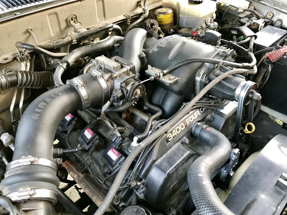

Congrats! Youtube video of supercharger install in works?
Would you expect anything less from Timmy The Toolman &sean?...
#sicmods
<iframe width="560" height="315" src="https://www.youtube.com/embed/7RmHXvEQwXs" frameborder="0" allow="autoplay; encrypted-media" allowfullscreen></iframe>
It’s pretty significant! It really has some serious pep if you step on the gas..
I can’t wait to see what a smaller pulley & the 7th injector does!
Did you already buy a smaller pulley? My 2.1 just came in the mail...hoping to install soon! Looking forward to seeing your progress. Congrats on the BOOST!
I felt the same way when I installed my supercharger, but I knew it was a bad idea buying one because I’d want more boost.
Sure enough I do. More than likely what I’m going to purchase with some tax return money is the 7th and a smaller pulley.
