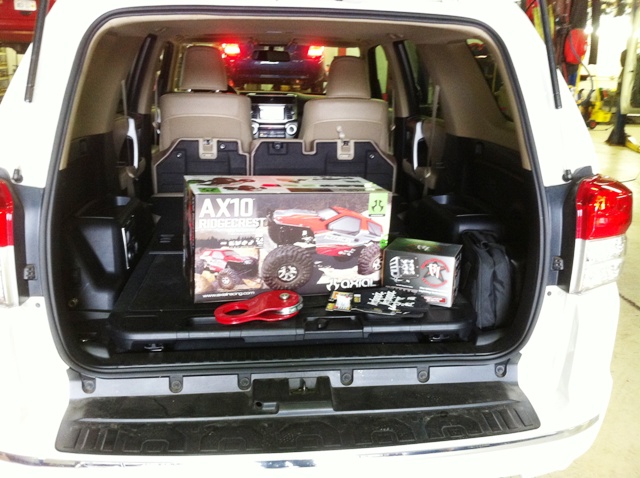

I shouldn't have pushed that switch that said "prizes"!!!
Sorry guys, I'm not gonna have much to bring this weekend.
