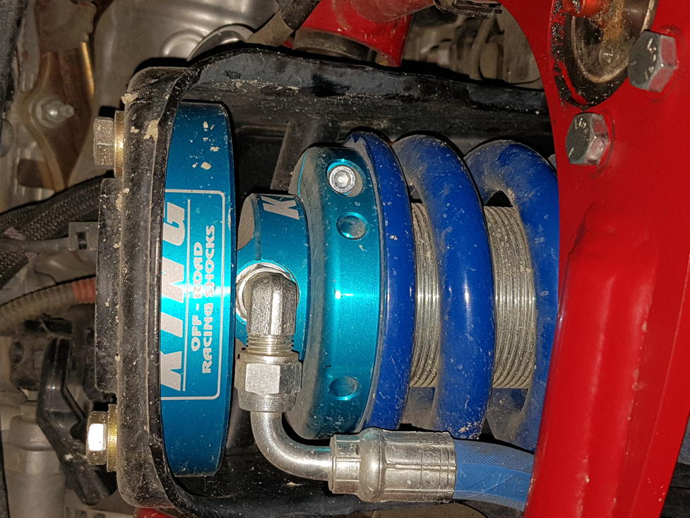

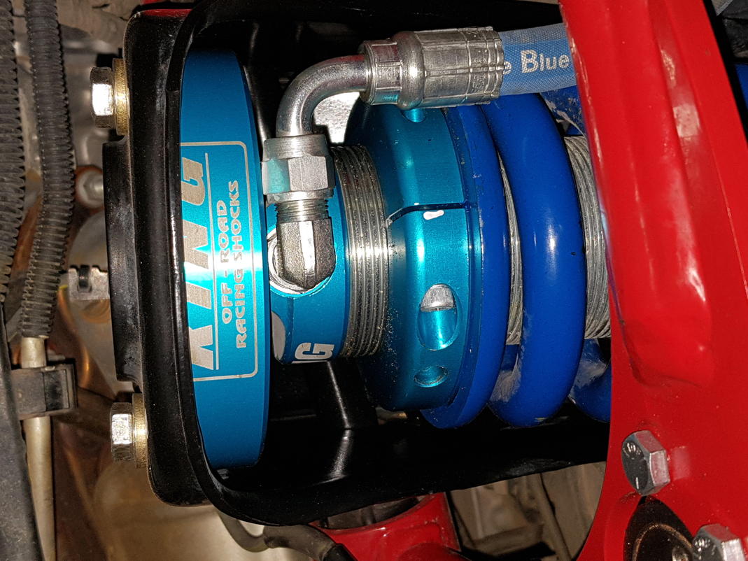

I didn't need to crank the fronts at all (except a few threads on passenger side to fix the lean) so essentially my fronts are at the lowest setting height wise.
As for rears, the ICON 3" overland coil is a dual rate coil.. so with a constant load such as my bumper they end up closer to a 2.25" to 2.5" lift vs stock. You'll only get 3" rear lift from them on a stock 4Runner without any rear load.
So in the end I got lucky the stance turned out alnost perfect out of the box
Correction: I'm on 650lb springs up front.. added thread pics too

Sorry man, I haven't had a chance to measure but got these photos:
Drivers
Passengers
*keep in mind that i am running a 1" rear coil so this wouldn't help much with your 2" Icon coils.
