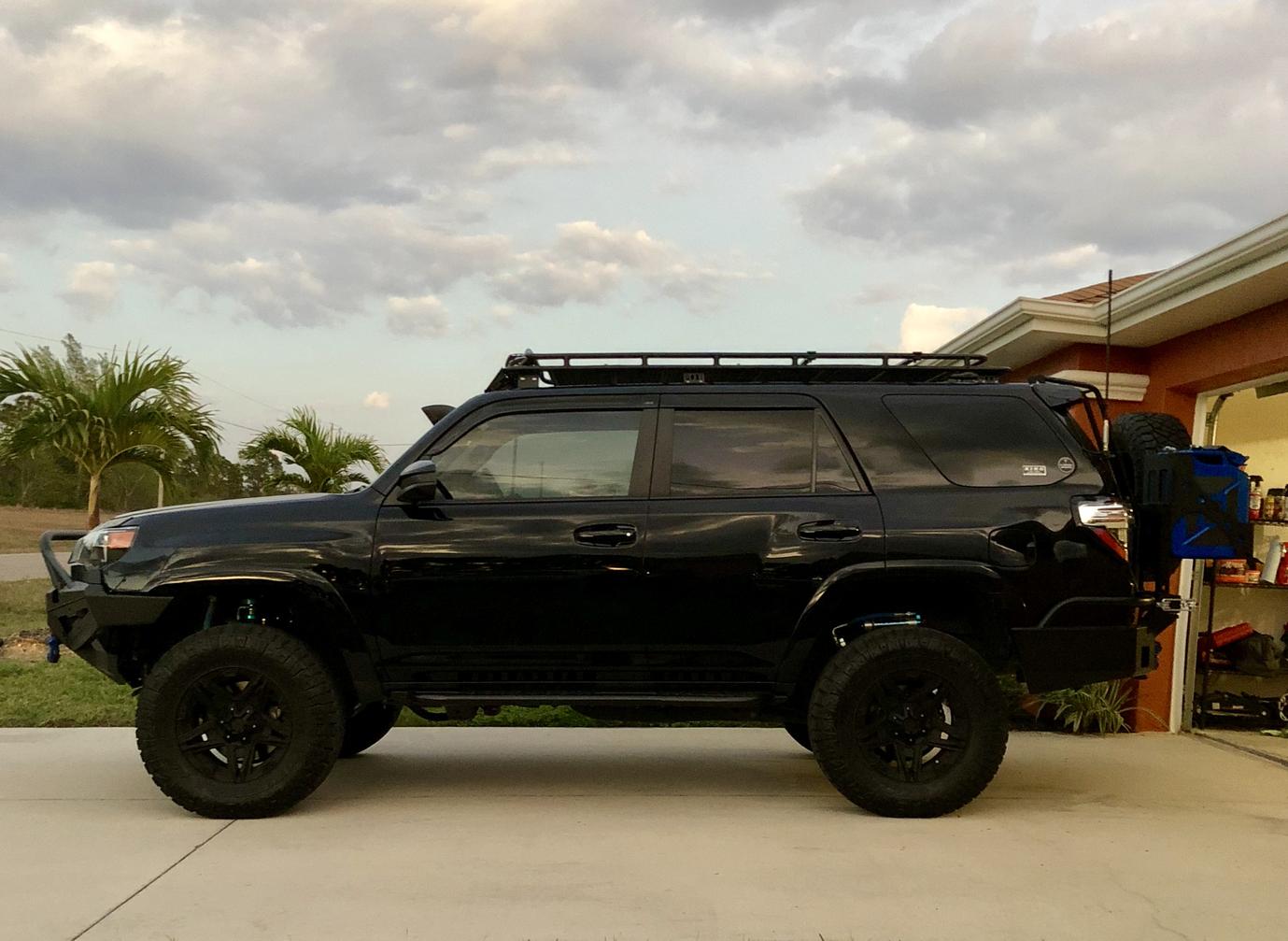

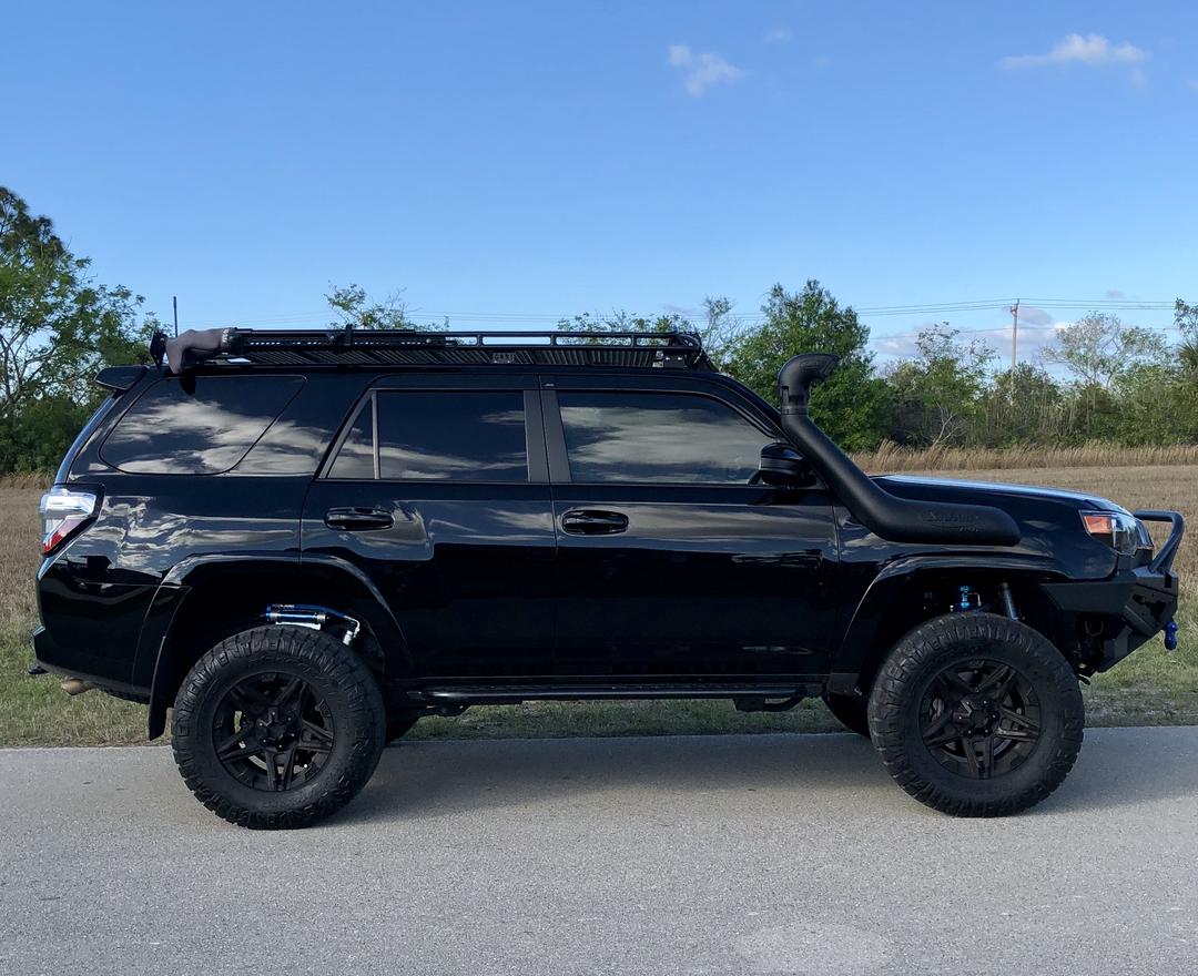

I went with dobinsons 2” rear lift. Small rake until I added rear bumper. Came out perfectly level with rear bumper and front preload at 6 threads. Pictures show before bumper and after.

Right but what shocks for the rear? Extended or just regular for 2” of lift?
That's my hold up currently, I know you don't want to pre load the front much more than 7 or so, but I reallly want the variable spring rate 3" rears from dobinson, but I don't think you can get the frontbhigh enough...
650lb guys how much pre-load/tread count are you running. My kings are suppose to ship next week. Would like to gauge how much pre-load to get 2.5 of lift.
I went extended travel with the 3" ICON Overland coils to carry the rear bumper + spare tire..
Personally, I'd go extended travel for anything 2" and above not because you have to, but rather why not. All it gives is more downtravel (by removing an internal spacer) and your coils are long enough to not worry about them falling off
