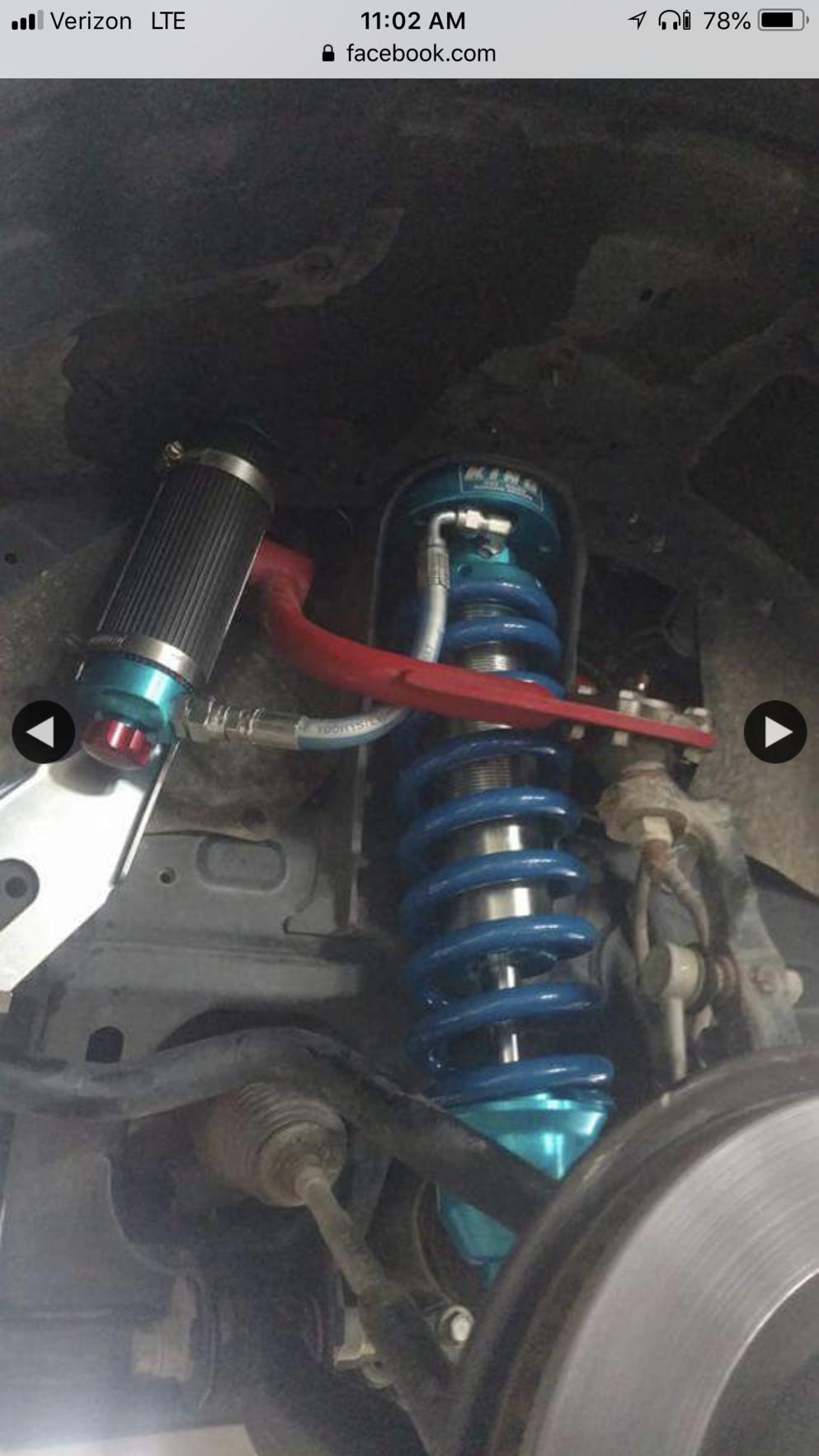

Took the wheels off to get new tires installed and noticed something a bit concerning... Have any of you guys had this problem? The rear resi hose is rubbing against the resi itself. A friend who has a similar setup said he bent the elbow coming from the shock to give a bit more clearance. We tried to push the resi closer to the shock (forward, to the right in the image) to maybe give the hose some slack. But it wouldnt really budge.
If you are worried, just toss a small piece of hose around the resi hose area that is rubbing.
Hey [MENTION=152509]ayeyothisiskyle[/MENTION], you can loosen off the band clamps, and rotate the reservoir toward you while pushing it toward the front of the truck. Once you have some slack, you can twist the shock body easily by hand to align the hose.
I’d skip the crowbar personally. When you have the shock rebuilt and the nitrogen pressure is released, you can reposition the 90 degree fitting if you find that your reservoir is sitting too far forward.
Mine clear both resi's. I'd us a crowbar to carefully bend the elbow slightly.
I guess I shouldnt take my friend's word. lol I just went out and muscled it forward. Theres more clearance, but I think I have to keep that elbow angle in mind when I rebuild.

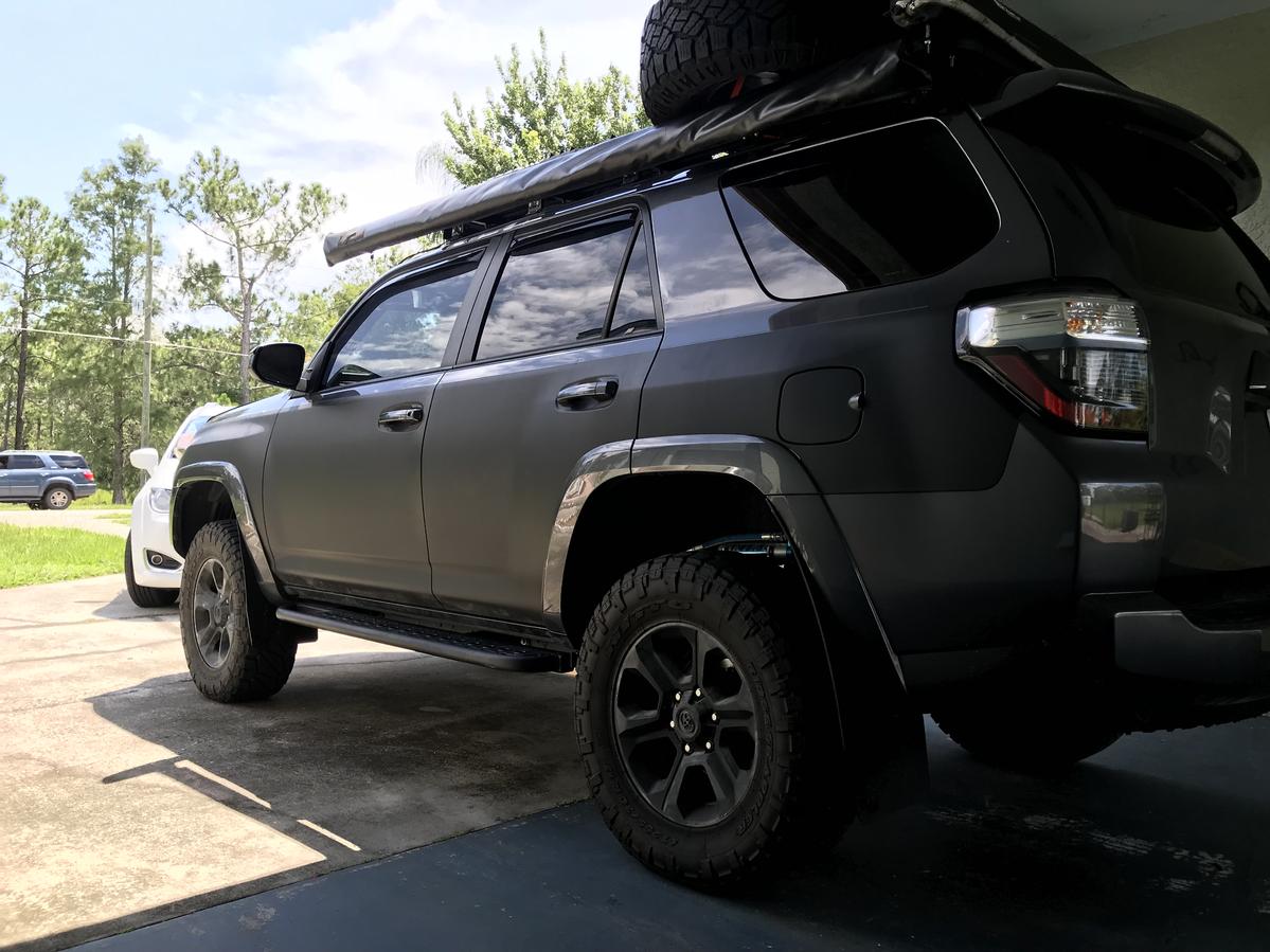

Got the Kings on a few weeks ago. JBA uppers. Extended front and rear, reservoir with adjusters blah blah. Running Dobinson 3” med progressive rear springs. With us loaded for camping and pulling the off-road trailer she sits just right. Had to adjust driver front about 5 turns up to get it level. Doesn’t like that Group 31 sitting right above it. But the Bilstiens didn’t either. What a fantastic ride. No I don’t normally carry two spares on the roof, those are for the trailer I just got them balanced and rostered had to transport them somehow.
