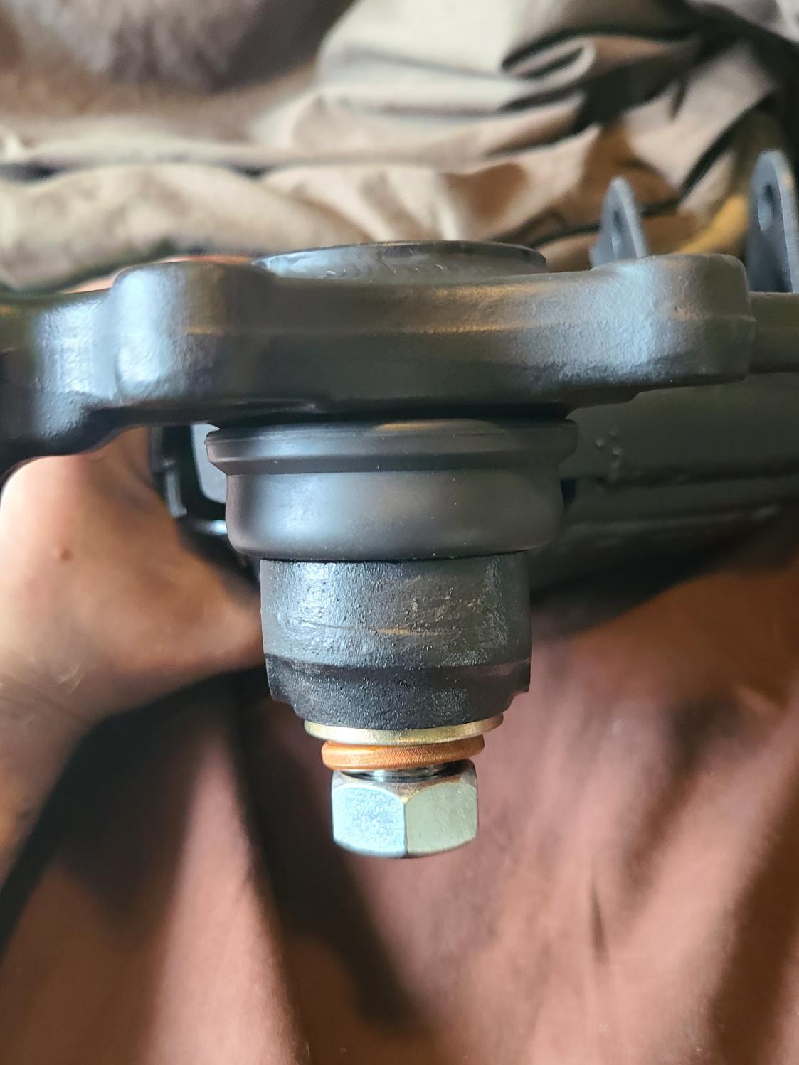

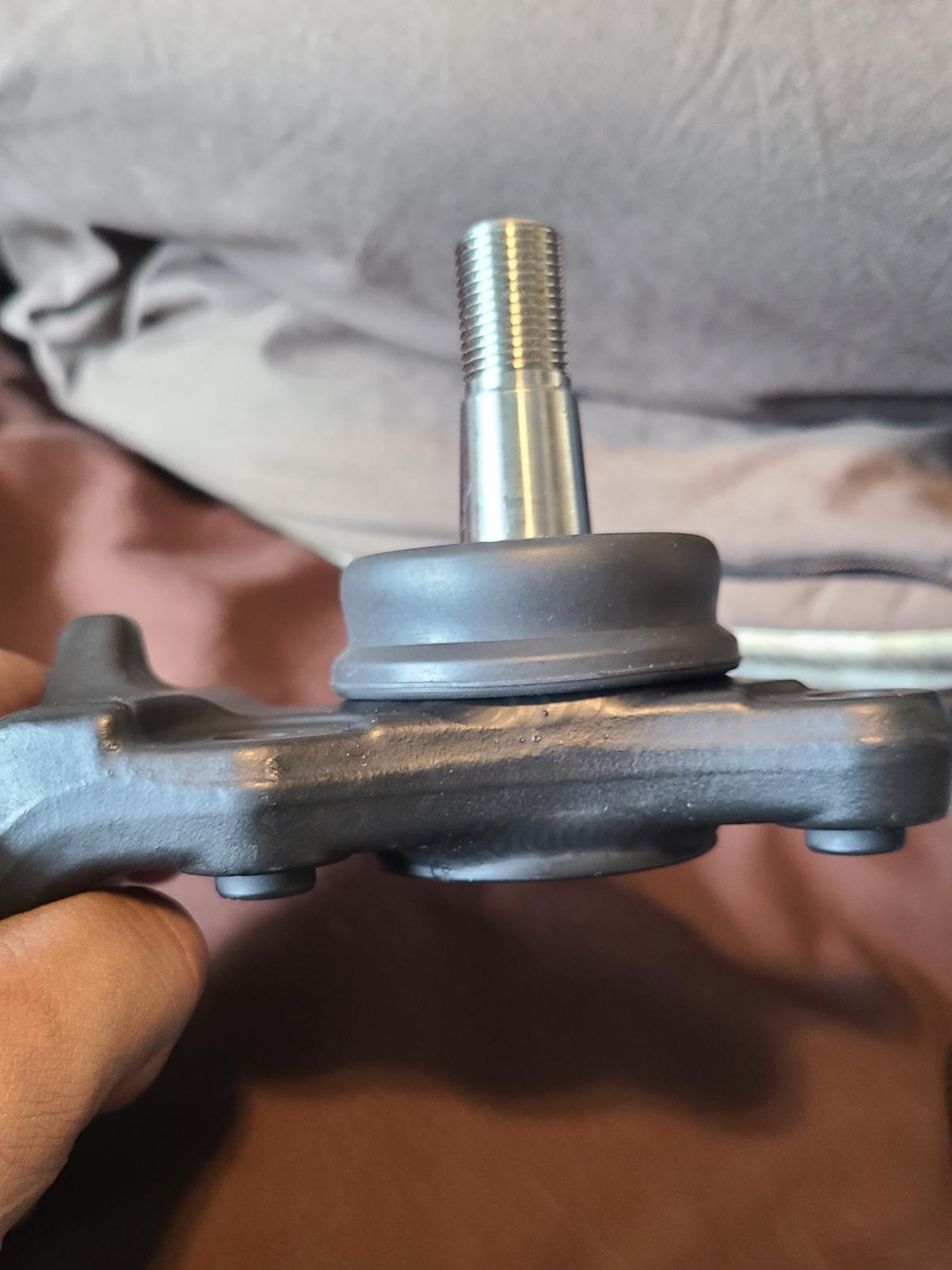

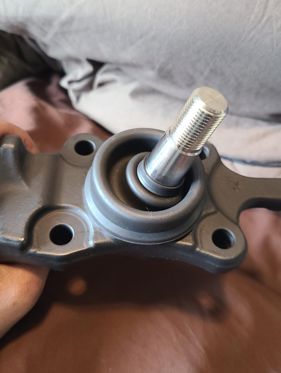

Boot update
I have found a viable boot option.
Howe Racing p/n 22399V. You MUST get the larger boots with p/n 22399V. The boots with p/n 223991 are slightly smaller and will not work.
I initially came across these while looking at shifter boots for tractors and forklifts; someone on some forum mentioned how these worked for his unit, yadda yadda. Ironically enough when these arrived from summit they even had a little sticker on them that straight up said "shifter boot"
It fits PERFECTLY around both the cup and the stud, fits perfectly between the LBJ and lower control arm, and allows for the ball joint to articulate fully in both directions without being yanked out of position. With a little bead of silicone around the bottom edge this would be absolutely water tight. Hell, maybe a zip tie would do the trick
Pics below. :reddance:
