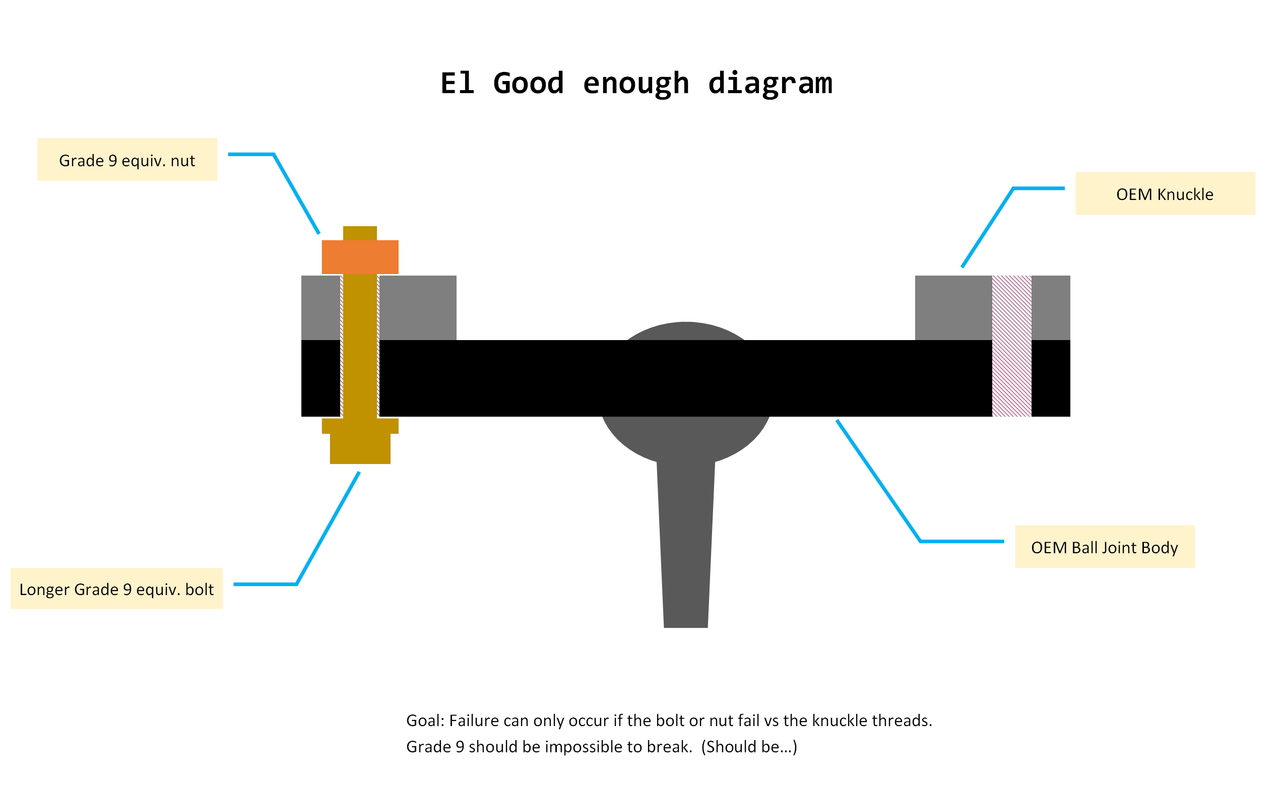

As others have said the top surface of the knuckle (where the nut sits) is not flat though. Maybe if you made a small spacer that would make it a flat surface that would work..
Ah I see, I wonder if it would be possible to forge some kind of mini adapter, something that would fit the top curve of the knuckle and then provide a flat top?
We should convert from bolts to high strength studs. Is there an ARP equivalent?
Oh so you're thinking just skip the threads of the knuckle entirely?
The outboard holes are blind, the end of the bolts don't protrude
A bolt head provides more protection than exposed thread and a fastener, plus, lifting a spindle loaded with brakes, axle, etc and aligning it into 4 holes while not damaging the threads on 4 studs is impractical. I like bolts I can replace.
Sent from my Pixel 4 XL using Tapatalk
The outboard holes are blind, the end of the bolts don't protrudek
You beat me to it, I was under the truck this morning to look into this :). As you said, the outer holes are blind. And the upper side of the knuckle is sloped/curved, not flat. You wouldn't want to use a nut on that surface without machining it:
Not realistically - if you look at the rear bolt in the first picture (just to the left of the crimp on the axle boot clamp), you can see that the upper surface is not just a flat slope, it's some kind of a curved slope. We'd need some kind of a multi-faceted adapter, not just a wedge - way too hard to design and build, and likely to end up putting the bolt into bending, which is the last thing we'd want.
As discussed earlier, it'd be extremely unusual for a properly threaded and preloaded bolt to shear out of steel threads. I suspect that in the cases that it happened, the threads might have been damaged by cross-treading or wear.

Yeah the only thing that I worry about is if you're adding a stronger bolt, and torquing it to the same amount as the standard bolt, since torquing has to do with stretch and creating a blocking connection, isn't the difference of stretch due to different tensile strength going to affect the threads on the knuckle?
That was why I originally was asking if we were sure it was safe, and also why I came up with the idea of taking the stress away from the threads of the knuckle with a bolt.
Beyond that, the only other idea I can come up with, which may not be possible, would be if somebody designed some kind of a clamp that mechanically holds the body of the ball joint to the knuckle. Like if you imagine a clamp on each side. But whether there's enough room or not or any way to attach something that will be strong enough to actually help I'm not sure...
