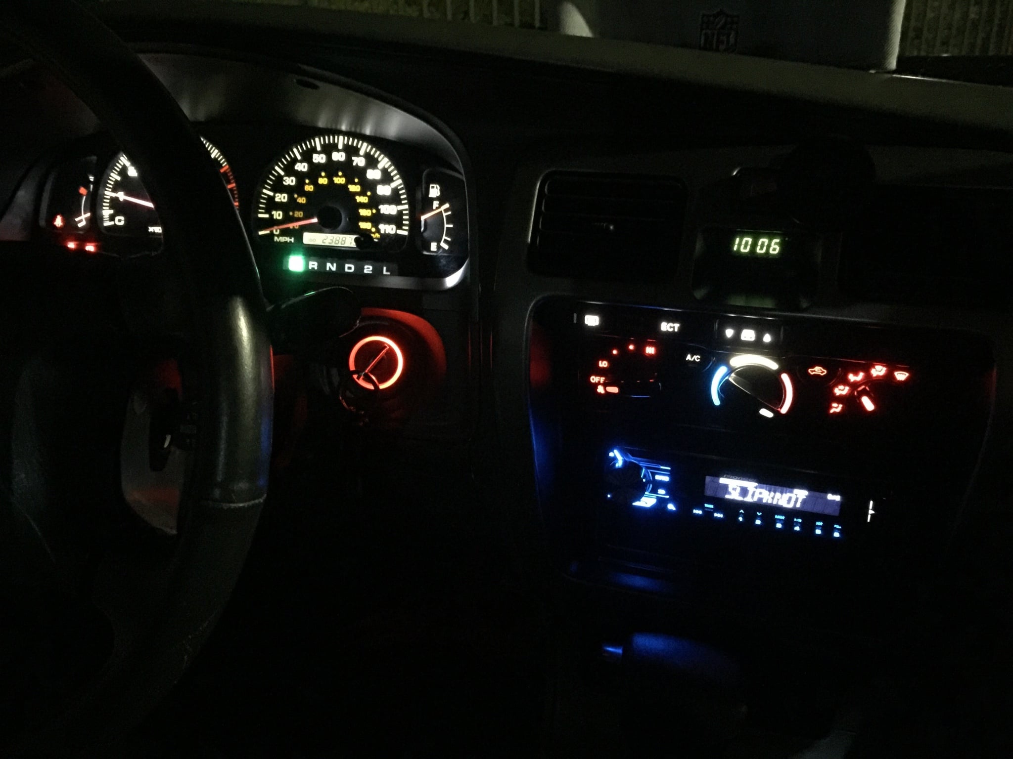

This is a awesome thread for these lights, I have the D light on my dash that is currently out. I figure while i have it apart i am going to replace the D with the regular light and I only want to change the Speedo, Tach, climate controls and ECT/RR windows lights.
Here is my main question though, the pictures of the white LED look really bright at night. I read earlier that the dimmer works until there is not enough power, I am not 100% positive what that means? Can you dim the lights down some and keep it there?

The dimmer works the same as before. Brightness should not be a concern.

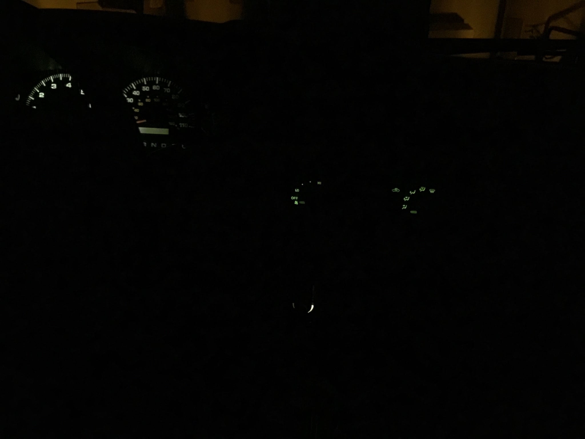

Going to order some LED's for my 2000 limited...
Here it is stock, is the climate control area supposed to light up more? i.e. I can't see any of the dials or buttons in the dark. Only the air recirculation, defrost.

Yes, the buttons are lit up on mine but the display is unfortunately not. I need to fix it as well.
