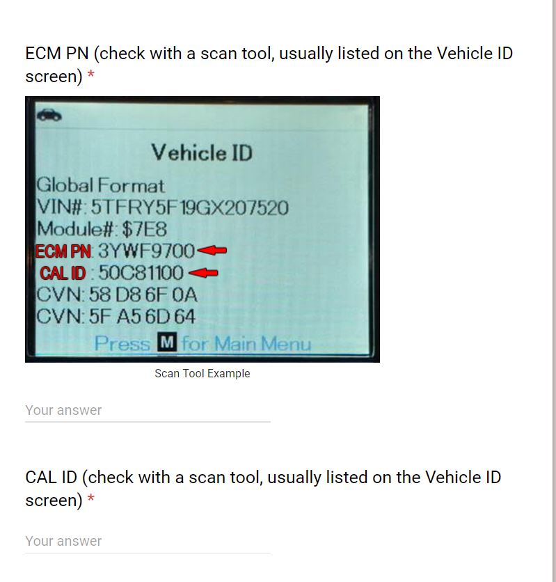

Yea, if anyone knows an elm327 compatible scanner that can read it let me know... I tried the trial of odb auto doctor. It showed a calibration ID and verification number (as not available in trial) but it showed no part number info available. It's really confusing what exactly they want and how to read it since its not something the Toyota factory scanner provides..
Anyway, below is a pic of what they are asking for.
Latest email says over 400 people applied. I doubt they all provided this info LOL and I also doubt I have much of a chance, but worth a try.... I think they are surprised by the response overall. That is a ton of people interested in a pilot... but I bet 70% won't follow through when they ask for a credit card...

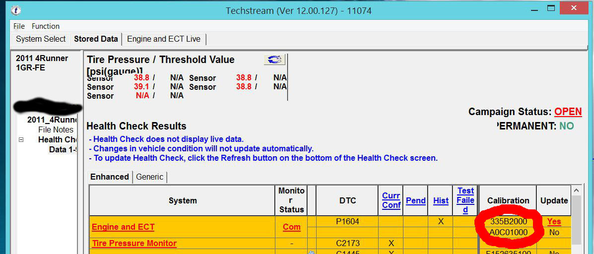

FYI... After much digging into the OBD spec... the data is available via TIS and there is just possibly some mislabeling in their instructions...
There are two common calibration ID segments and they are referring to the first one as the ECM p/n.. (that is the part that really confused me)
Anyway, In TIS.. If you run a health check. You will get a display like the one attached... The first ID is what they are calling the ECM PN and the second one the Calibration ID.
Technically, they are both part of the calibration ID PID under mode 9 in the OBD spec. The command is 0904... That was about 5hrs of my time wasted...Hopefully this will save others time. Pic of TIS screen attached.

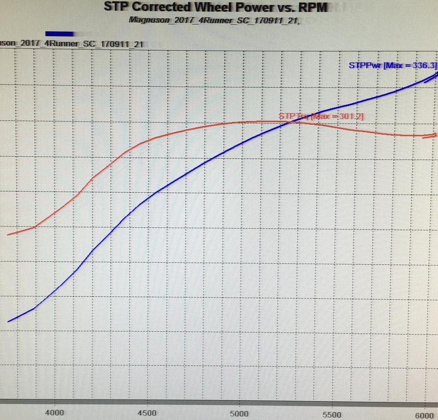

Dyno Numbers
Pulled 336whp/301 ft lbs. may have a little more to go. Stay tuned and keep an eye on your inboxes.
