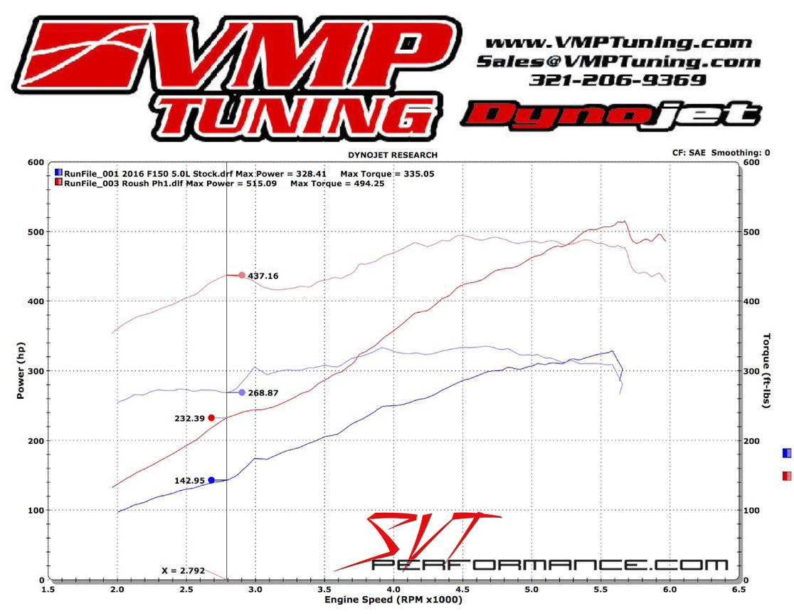

It's hard to tell what the stock vs supercharged dyno graph may be by guessing at this point (I haven't seen one anyway...) But with a supercharger I've always thought you do get a decent boost at the lower RPMs too. Check out this F150 dyno run. +30hp and +100tq at 2000rpm. If the 4Runner graph resembles this trend, it might be closer to +15hp and +40tq so maybe not much, but like I said, IMO the OEM diff can't really handle stock power on the rocks with 34s-35s and extra weight, let alone adding a supercharger on top of things.
It all depends on the tune and a comparison to a V8 with a supercharger and a v6 isnt a fair comparison. You also dont want too much immediate tq or you will start breaking things especially if your stock. The curve on the tune currently being ran is very smooth and has power when you need it.
