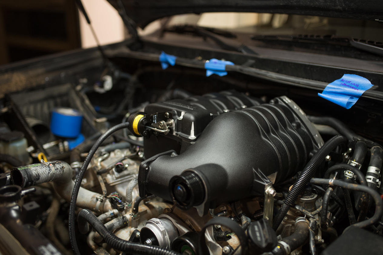

More to come. I installed 80% of this kit solo. I was fortunate to have been able to have the guys from Magnuson provide me with some help along the way as well as some help from AJ [MENTION=148173]FOTORNR[/MENTION] and Bernie [MENTION=154966]MilkTeacoma[/MENTION] I am not the most mechanically inclined but I know my general way with forced induction from the car scene. All in all it took us 11hrs total to install. The instructions are extremely thorough and everything you need is in the kit. Outside of just the internally intercooled SC, you have your belt, pulleys, pulley bracket, spark plugs, heat exchanger, heat exchanger pump, coolant lines and other brackets. May be forgetting something's but I will post the parts list in a bit. An actual mechanic should be able to knock this out in 8 hours. The reason I installed it was I wanted to prove that mostly anyone with general knowledge, help from friends and patience can knock this out and save some money. More pics to come. Still trying to figure video out on this but some videos are being posted on Magnusons page @magnusonsuperchargers and my page [MENTION=4159]travis[/MENTION]hess_
