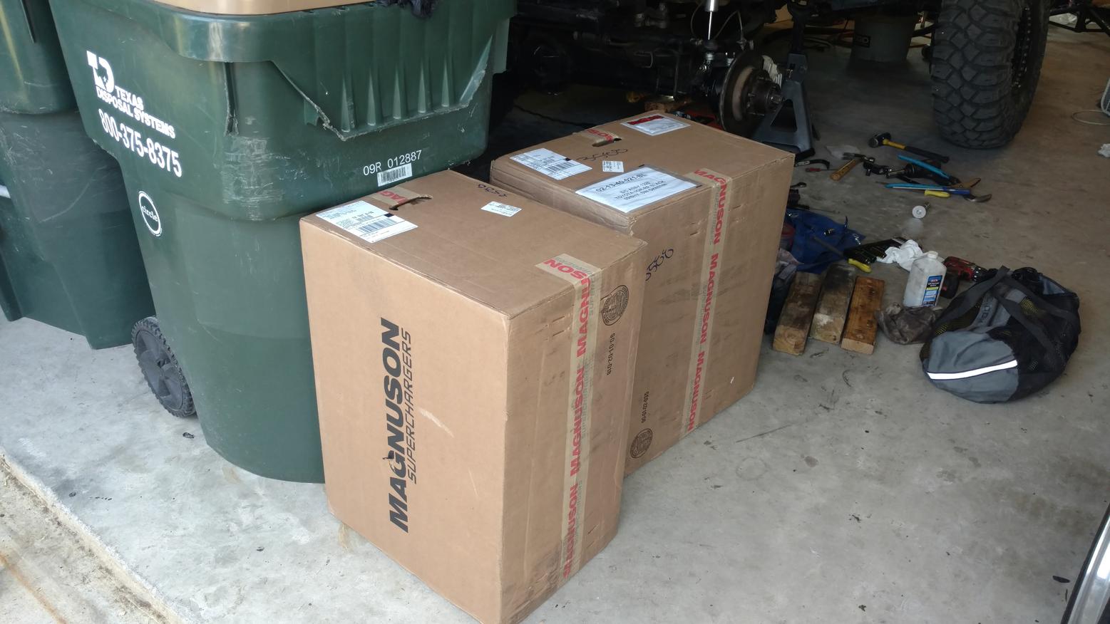

Some boxes showed up today. I have two other small projects to finish up first before I can start on this.. Man, I want to open them up. Hopefully tomorrow evening if the wife is cool with dinner in the garage LOL.

BTW, it looks like the regular kit will come with a hand held programmer. At least that is what the instructions describe.
I can tell you this so far...
Packaging is amazing and very well organized. Everything is vacuum sealed... Very professional and organized.
Instructions look detailed enough that pretty much anyone could follow. There are about 80 pages with almost 300 steps. Very detailed with a picture for every step.
They obviously expect you to run premium fuel 91 octane or better. So I've been trying to burn out the crap gas I had in it. I actually normally ran premium... but we had that stupid gas shortage and that was all I could find around here for a while.

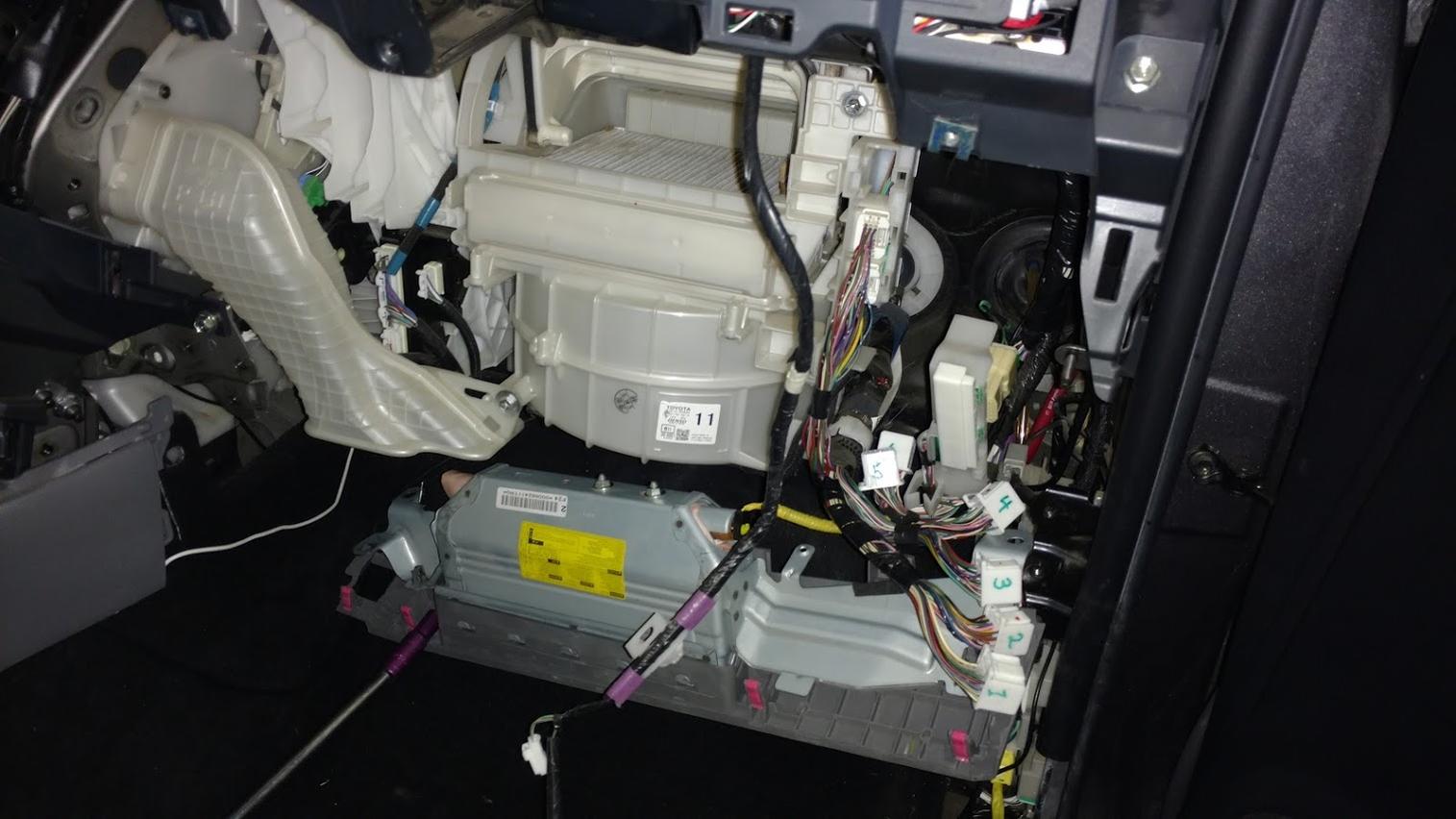

ECU out and shipping off tomorrow. Not difficult, but I don't think released kit buyers will need to deal with it. I've got a question sent off to find out if they want any feedback on that part of the install.
It sits in passenger foot-well area near the blower motor behind the glove box. not a place you want water... but if your knees are still dry... probably still OK in a water crossing gone bad scenario LOL
It has 6 connectors going into it...
