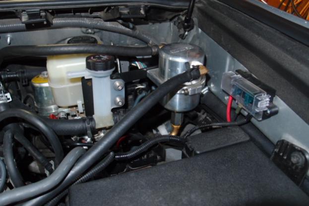

Where id you mount your catch can? I am pretty slim on extra space lol. Also, did you change your radiator when you did your URD install? or see any real need for a radiator upgrade?
I had the catch can mounted to the engine fender area by the brake. When the supercharger was installed, I had a conflict so I mounted it to the supercharger intercooler fill bracket. I can easily empty it by loosening the clamp, lifting it up and twisting off the bottom. There are threaded holes in the fender area that I used to mount it originally. The fused distribution block was also added when the supercharger was installed.
The supercharger intercooler is a separate sub system from the radiator. It has its own radiator and pump that mounts in front of the regular radiator. I have not had a chance to evaluate the temps yet. I have considered a larger radiator...... we will see what happens this summer. :shrug:
Thanks. unfortunately that spot is occupied for me since I have a switchpros there. I guess I will have to wait till I install the supercharger, then see if I have space for a catch can anywhere.
