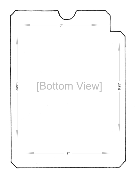

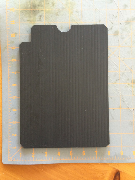

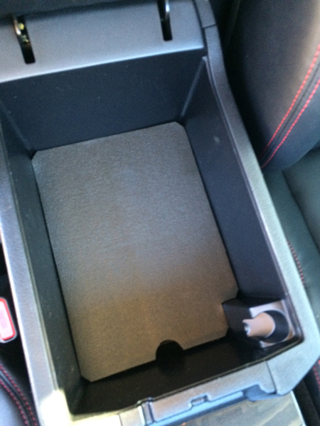

Having looked at all the others, I just wanted something simple to separate the things I leave in the vehicle from that which I regularly carry.
Supplies List
Corrugated Plastic Sheet
24 in. x 36 in. x 0.157 in. Black Twin Wall Plastic Sheet-COR3624BK - The Home Depot
Black Drawer/Shelf Liner
http://www.homedepot.com/p/Con-Tact-Solid-Grip-48-in-x-18-in-Black-Drawer-Shelf-Liner-04F-C6U51-06/100388906

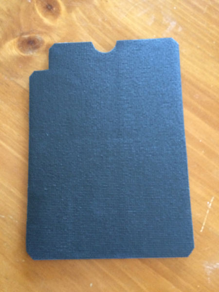

Max Grip Carpet Installation Tape (Used to mount grip liner to corrugated plastic)
Roberts 1-7/8 in. x 75 ft. Roll of Max Grip Carpet Installation Tape-50-550 - The Home Depot
Scotch Mounting Tape (Used to mount rear support lip)
3M Scotch 1 in. x 1.66 yds. Extreme Mounting Tape-414DC-SF - The Home Depot
mudpie-albums-console+organizer-picture38325-organizer-grip-liner-applied-plastic.jpg
