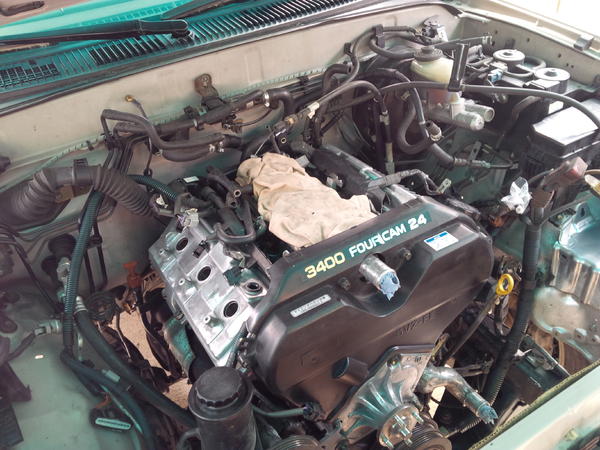

I moved the unions around, got the oil strainer and pan placed also helped the young one with homework!! Looks like I'll have to deal with the starter before I get the engine replaced... Tomorrow, oil cooler, mounts, ac bracket...

getting there
This weekend I serviced the ALT, replaced all the wiring brackets, installed the power steering pump, AC, flex plate bolts (weird-- they're 9mm- 1.25mm-- extremely odd size) and installed the starter--- what a PITA! There's no bloody room-- I had to cut a piece of wood to rest on the frame and lever the starter in place to get the bolts in--- god help me, if I ever need to replace the thing! As I broke the tab on the plug, I used 2 zips to fix it in place-- worked like a charm. As soon as I get the plenum etc cleaned, I'll get the rest assembled....

Darn it! I'm ready to drop my replacement engine back in the truck but the sky opened up and the rain fell!! Hopefully, I'll get the time to do it tomorrow... Once I get the engine in, my next decision will be which throttle body to use. Some reseacrh will be required.

She's running again!
Well, yesterday I got sidetracked, but I did get everything else placed. I had to make a run down to the parts store to return the upper rad hose, as the one they sold me last week, was too short. They didn't have a replacement, so I'm forced to use my old one, which isn't in bad shape.
I dropped the battery in but discovered that the battery was pretty much dead. I'm probably going to replace it, as I charged it when I removed from the truck at Christmas. I did note a fuel drip at the compression fitting--- gave it an eighth of a turn --- gone! So I set the battery to charge, and went to bed.
This morning, dropped the battery back in and the engine started on the 5th turn! Wow, is it ever quiet! idles like a big sewing machine, What a difference! not 100% happy however, I have some investigating to do---- its running a bit rough, shakes a bit at idle and shakes a bit on acceleration-- almost like its running on 5 cylinders.
Before I installed the injectors I measured them and the DC resistance were all between 14.0 and 14.4 ohms. I thoroughly cleaned the throttle body, MAF, installed new plugs (examined the old ones- all normal wear), new wires, PCV valve, TB (I was very careful to align the marks and I turned the crank multiple turns to ensure they continued to align) so I will have to go over everything again.:dammit: I've not had any codes. Overall, things went well over the entire job. I'm not overly concerned at this point, as it is much smoother than my old engine, even when I first bought it. I'm hopeful I'll identify this inconsistency quickly.... I'll check the timing tonight if I can find my timing light... hopefully not an injector, maybe a coil? I've already triple checked all connectors ie cam and crank pos sensors etc...... maybe an O2 sensor bad? I'm going to start investigating tonight. Any suggests are welcome!
