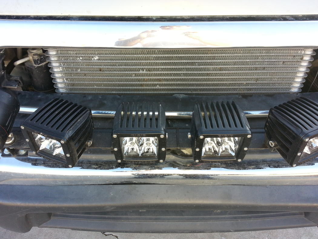

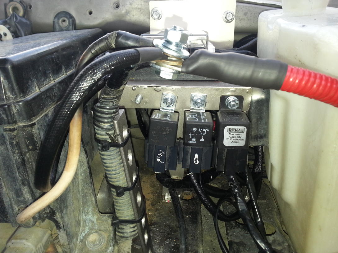

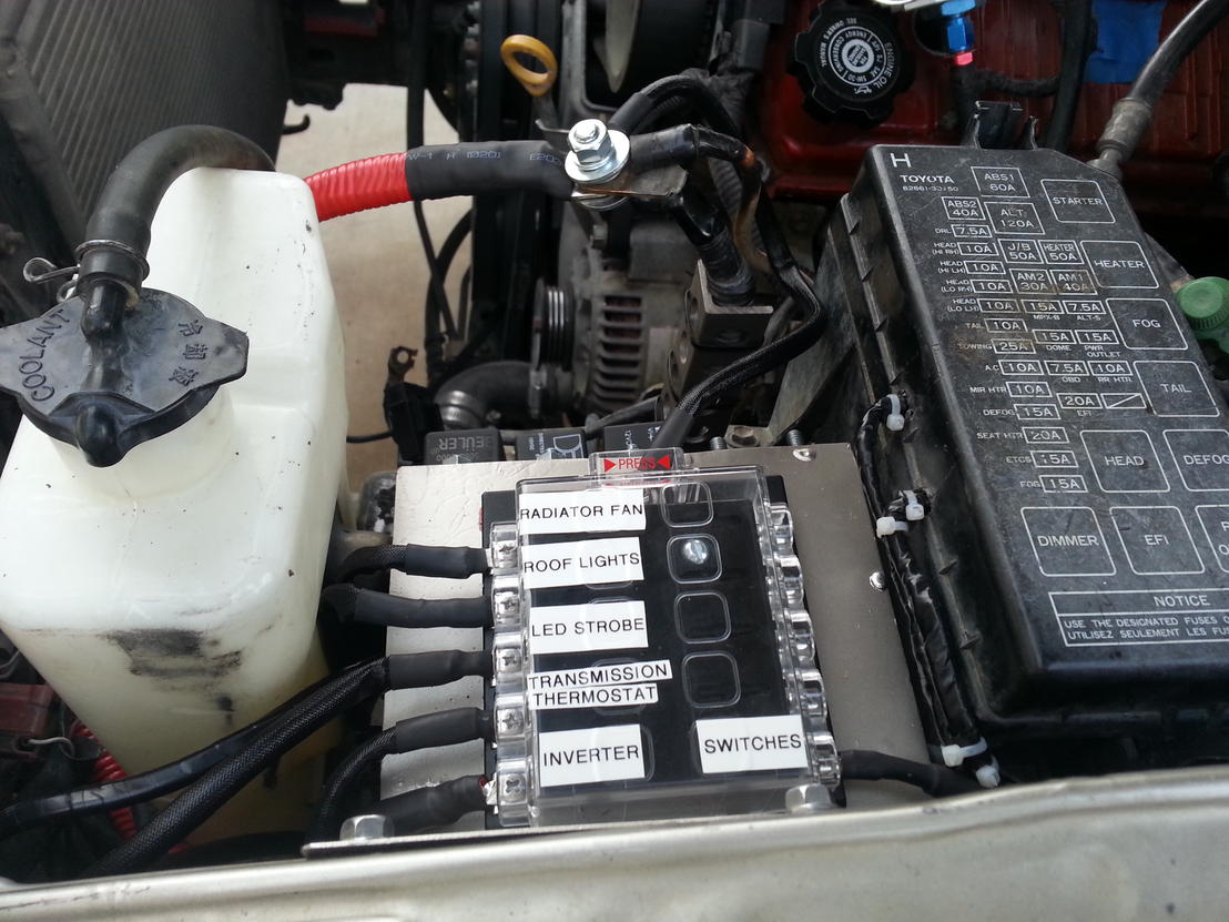

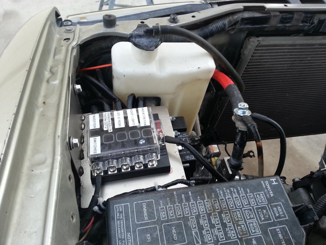

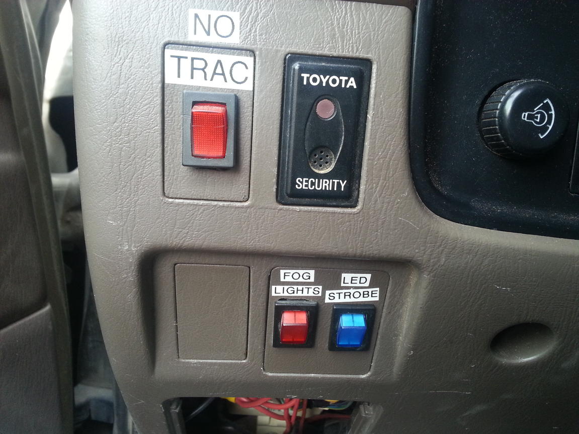

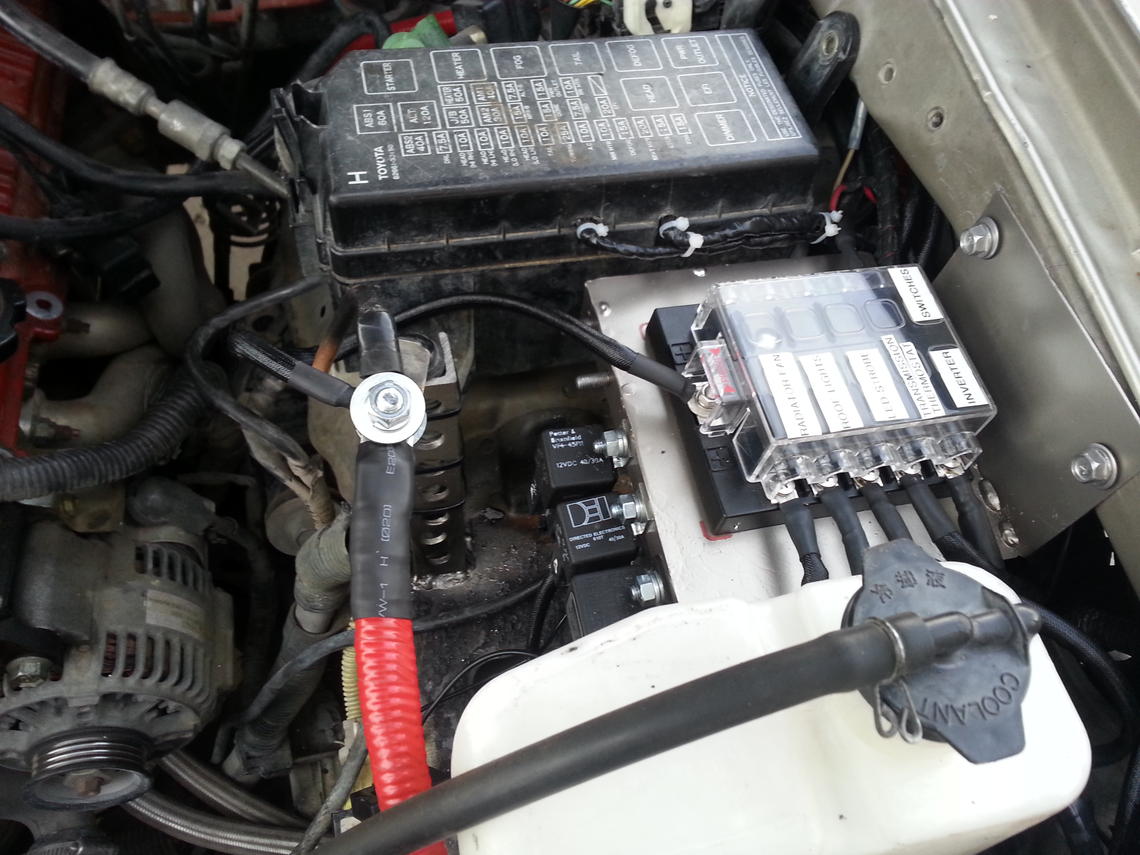

All my wiring is completely done fuze box and relays. I even added a led strobe that will strobe my rigid industries duallys when I run the hazards. I tapped into the wire that controls the driver side turn signal and that goes to a relay that powers the duallys. I have the relay ground switched so my duallys will not strobe when I use my left turn signal.

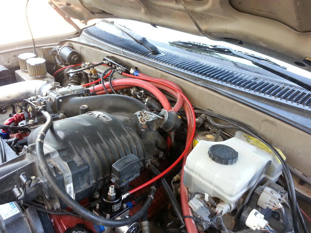

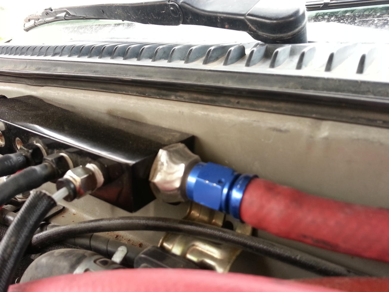

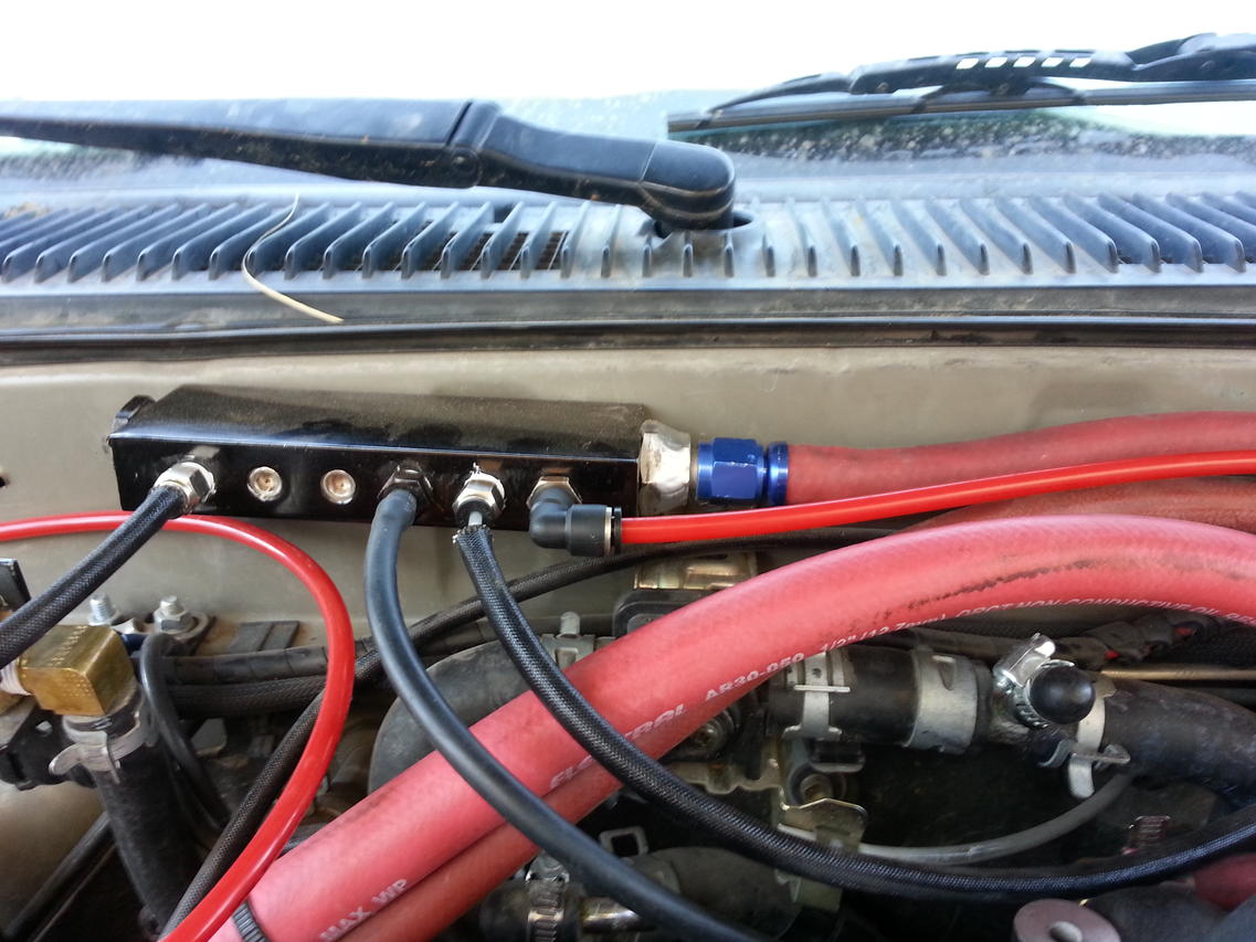

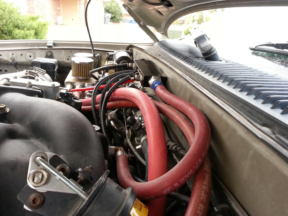

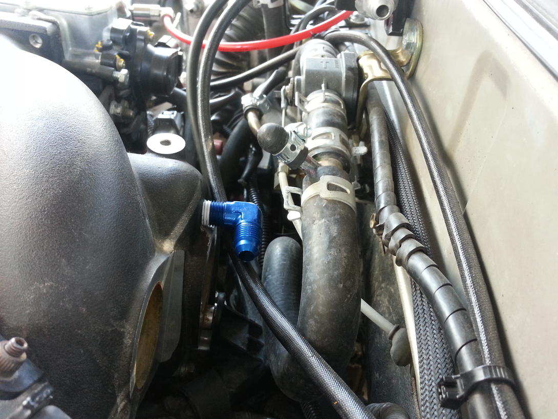

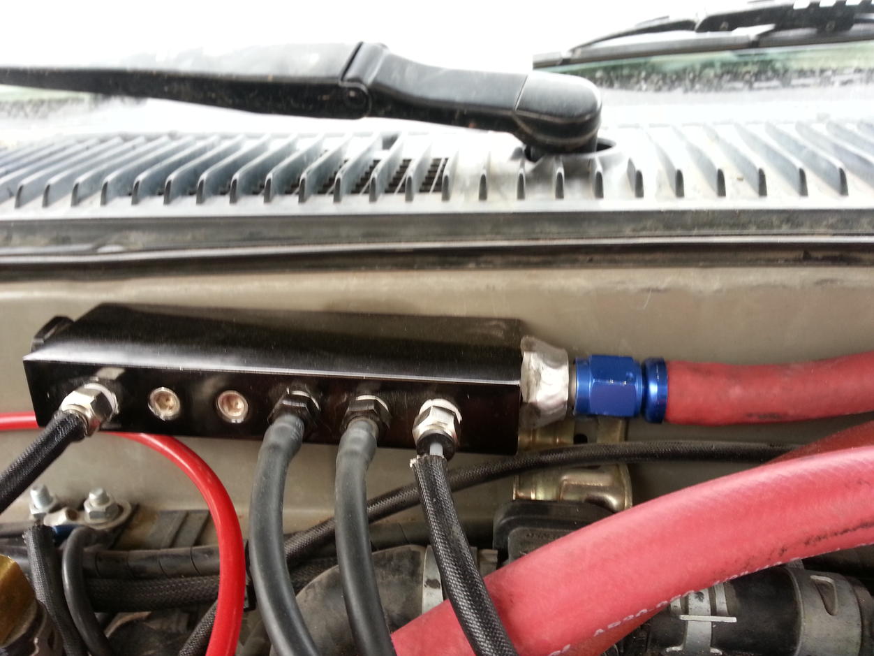

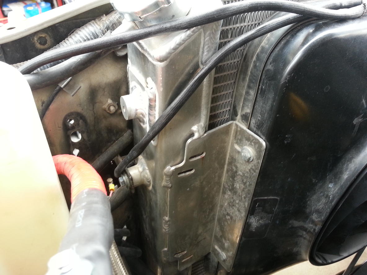

Some little things I have done recently. I added a push lock AN fitting to my boost/vacuum manifold since I'm always constantly having to remove my supercharged for maintenance and mods. I always kept have to cut the hose to remove it from the barb fittings. I also had 2 more mounting bungs welded to my radiator they will be used later on down the road for more support. And here's a pic of the intake my running now it's a 20$ intake from eBay.

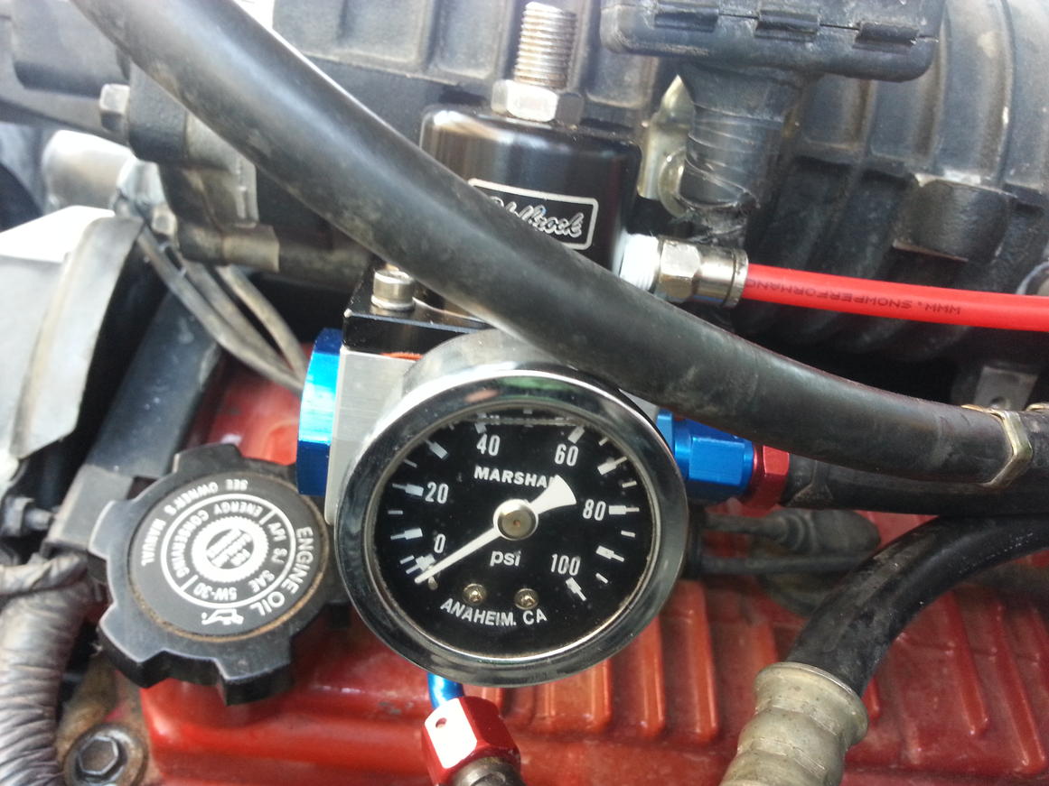

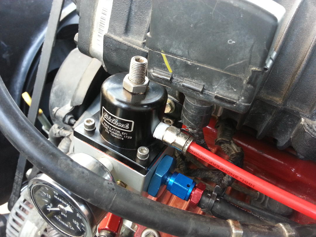

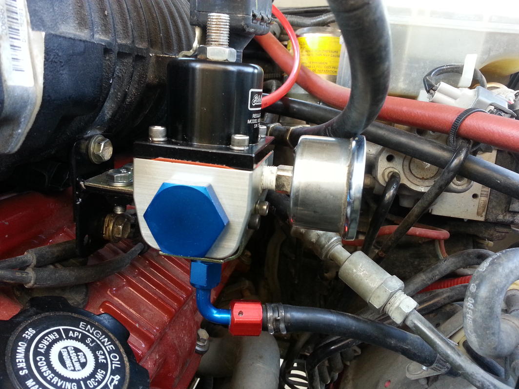

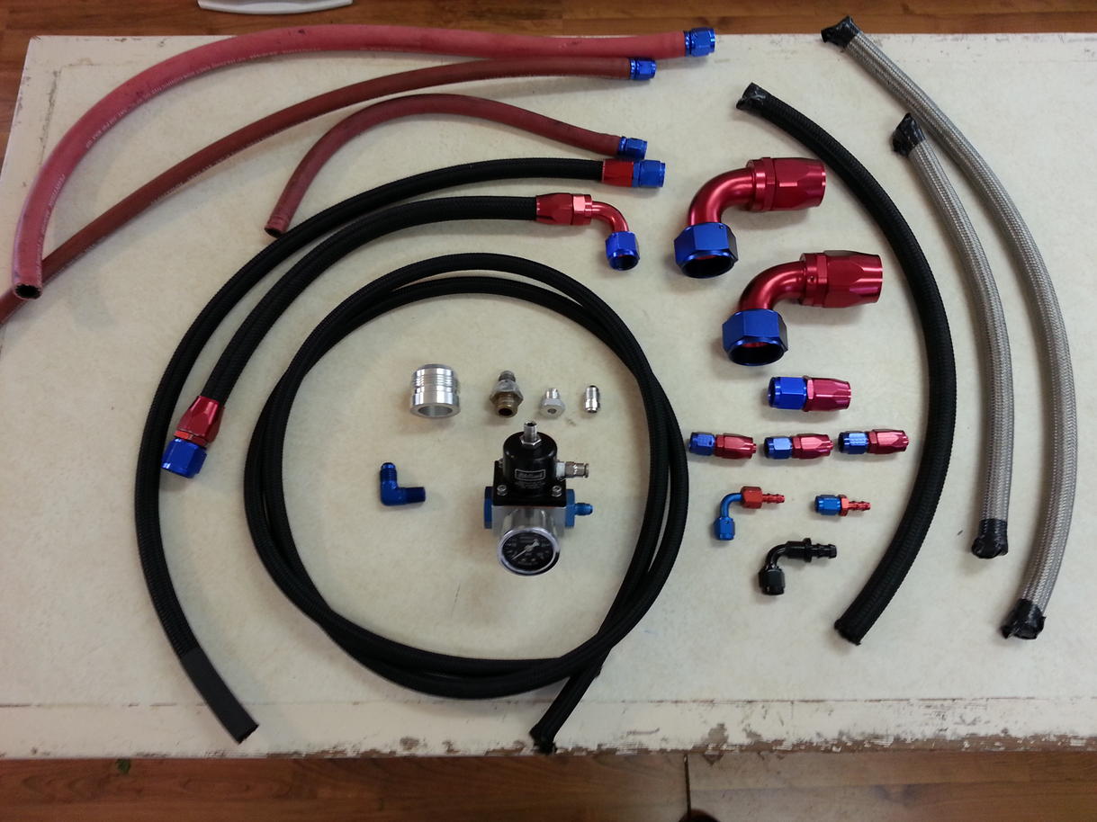

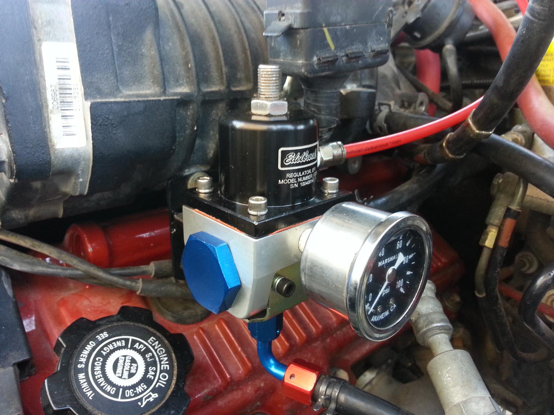

So I relocated my fuel pressure regulator today, while I was at it I decided to convert the rubber vacuum line connections to a quick disconnect hard plastic line for a cleaner look and easier removal maintenance.

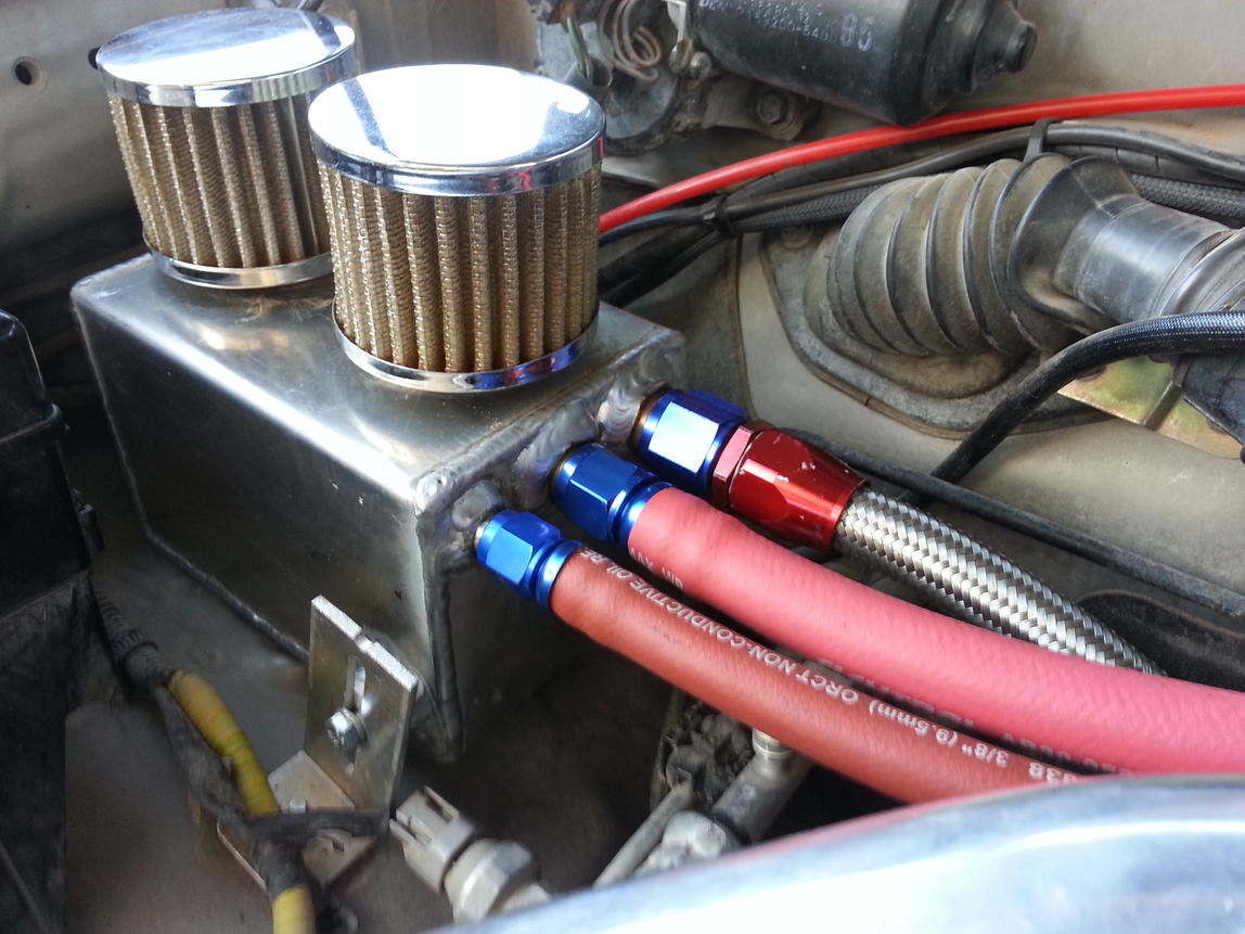

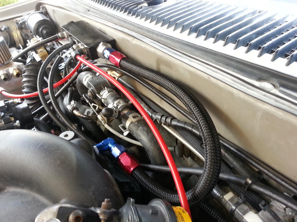

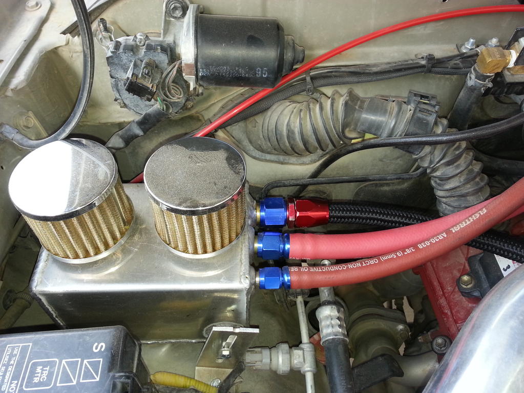

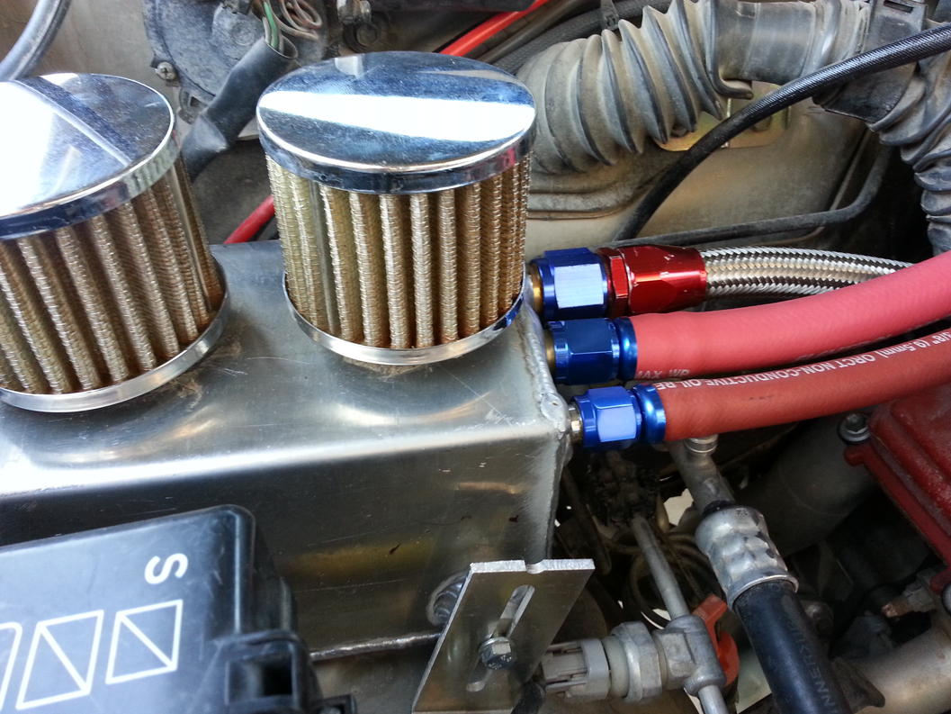

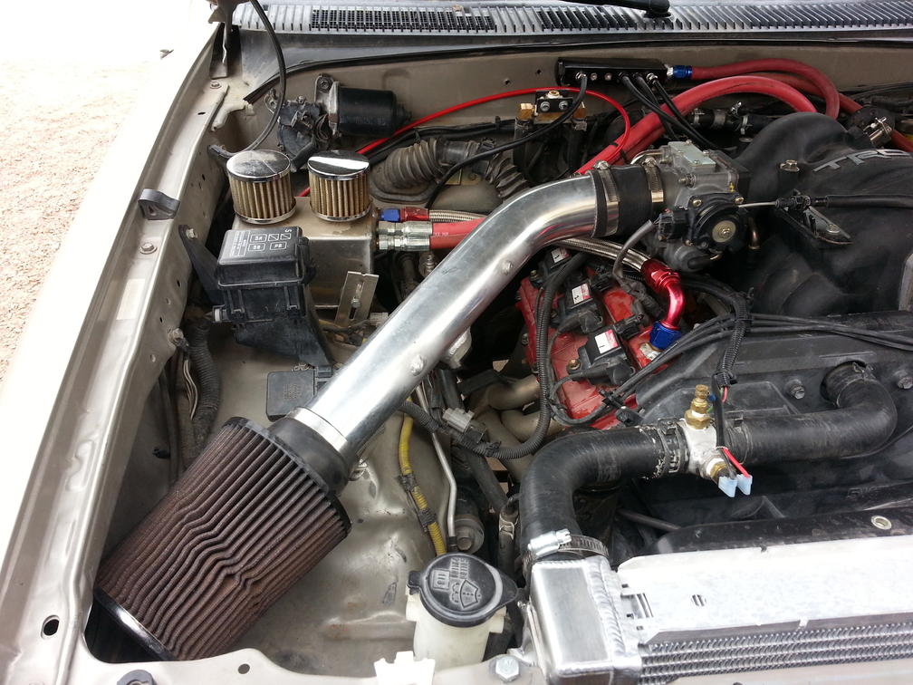

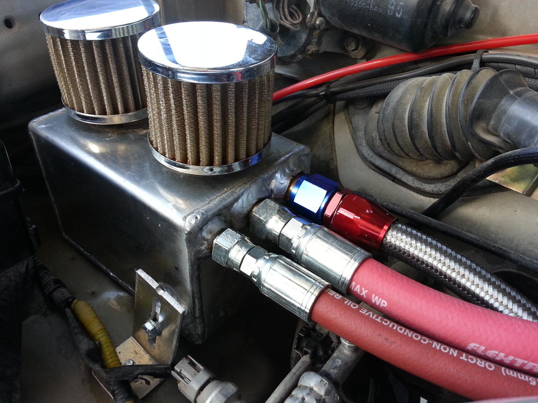

Bought 2 an push lock fittings today for the catch can still working on all the little tid bits to clean up the engine bay. Here's a after and before pic.

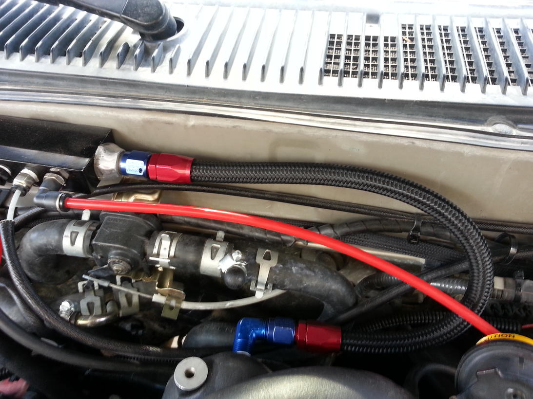

Well since the 4runner is broken and I have tried everything to fix the knock sensor problems but no luck. I have nothing else to work on so I'm still cleaning up the look of the engine bay. I switched out the stainless steal braided hose for a black nylon braided hose I think this blackoone looks much cleaner.

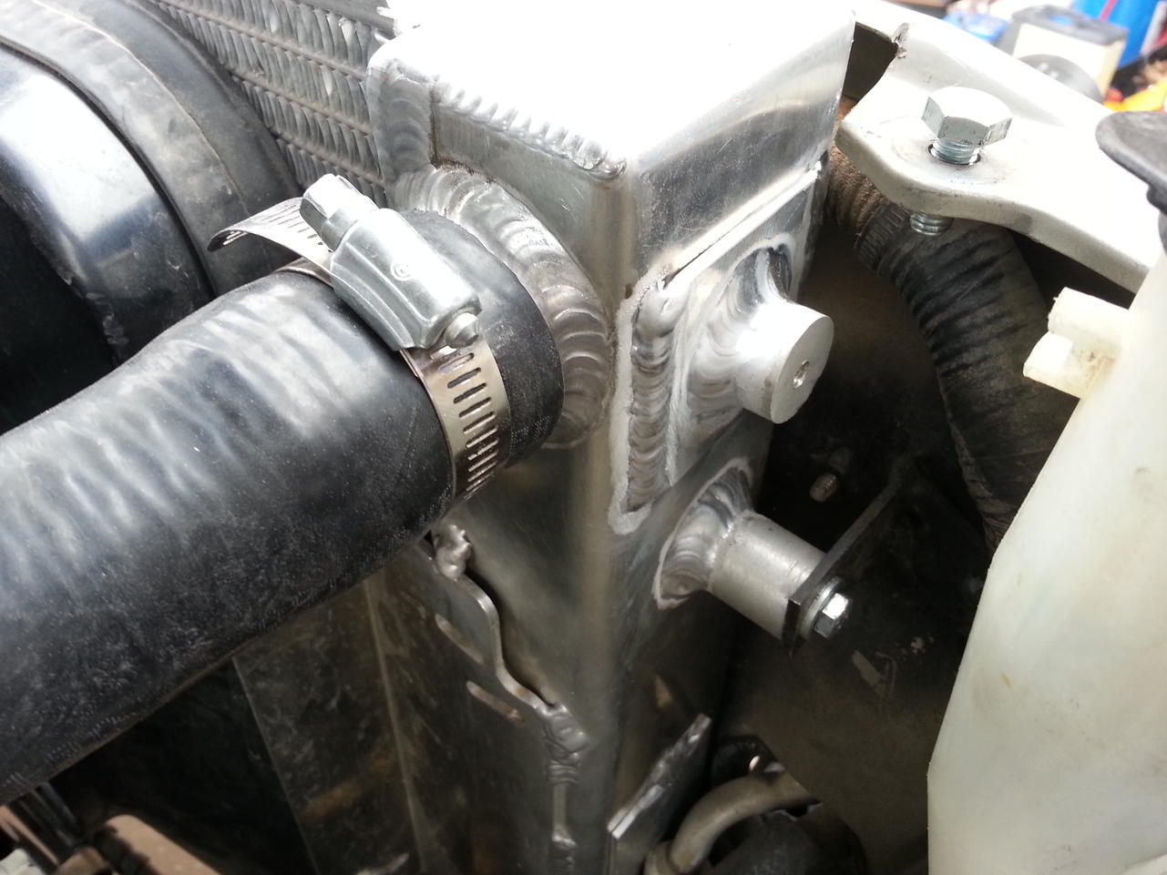

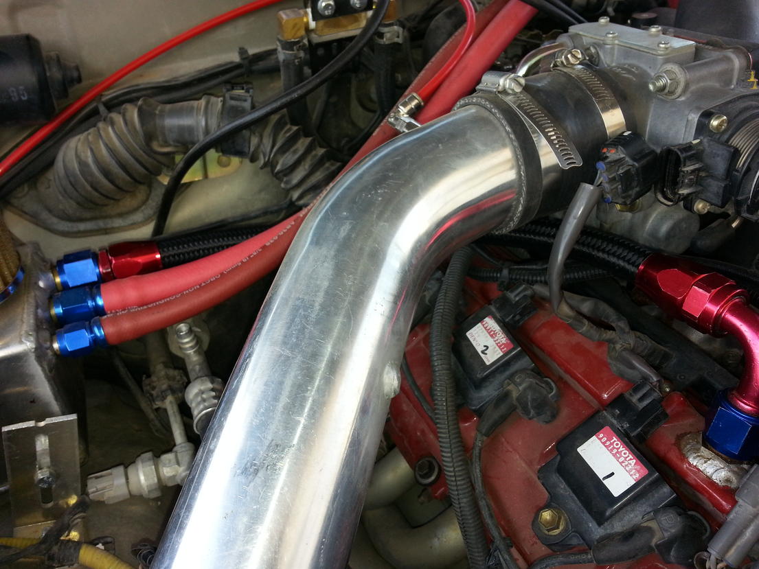

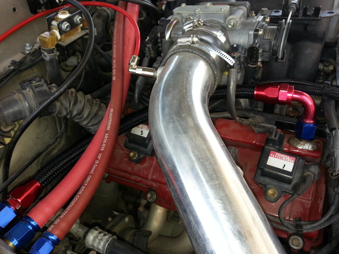

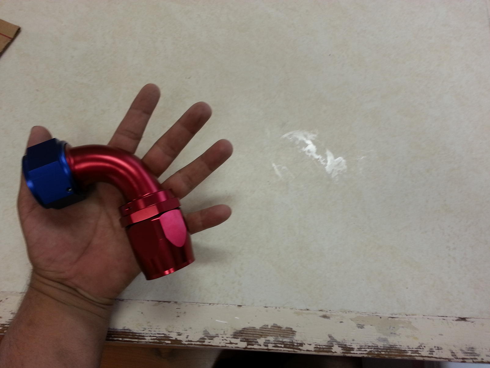

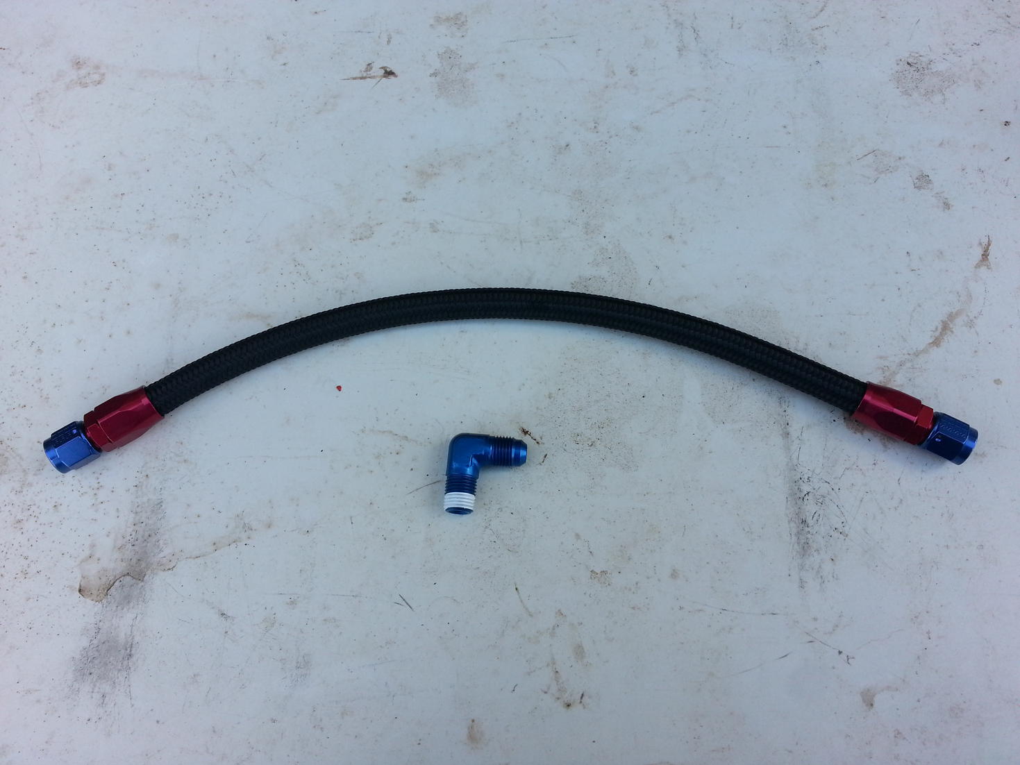

I am addicted to AN fittings! !! Lol those huge AN fittings are -20 AN fittings to replace the top radiator hose. I will post some more pics when I make the hoses and some pics of them installed.

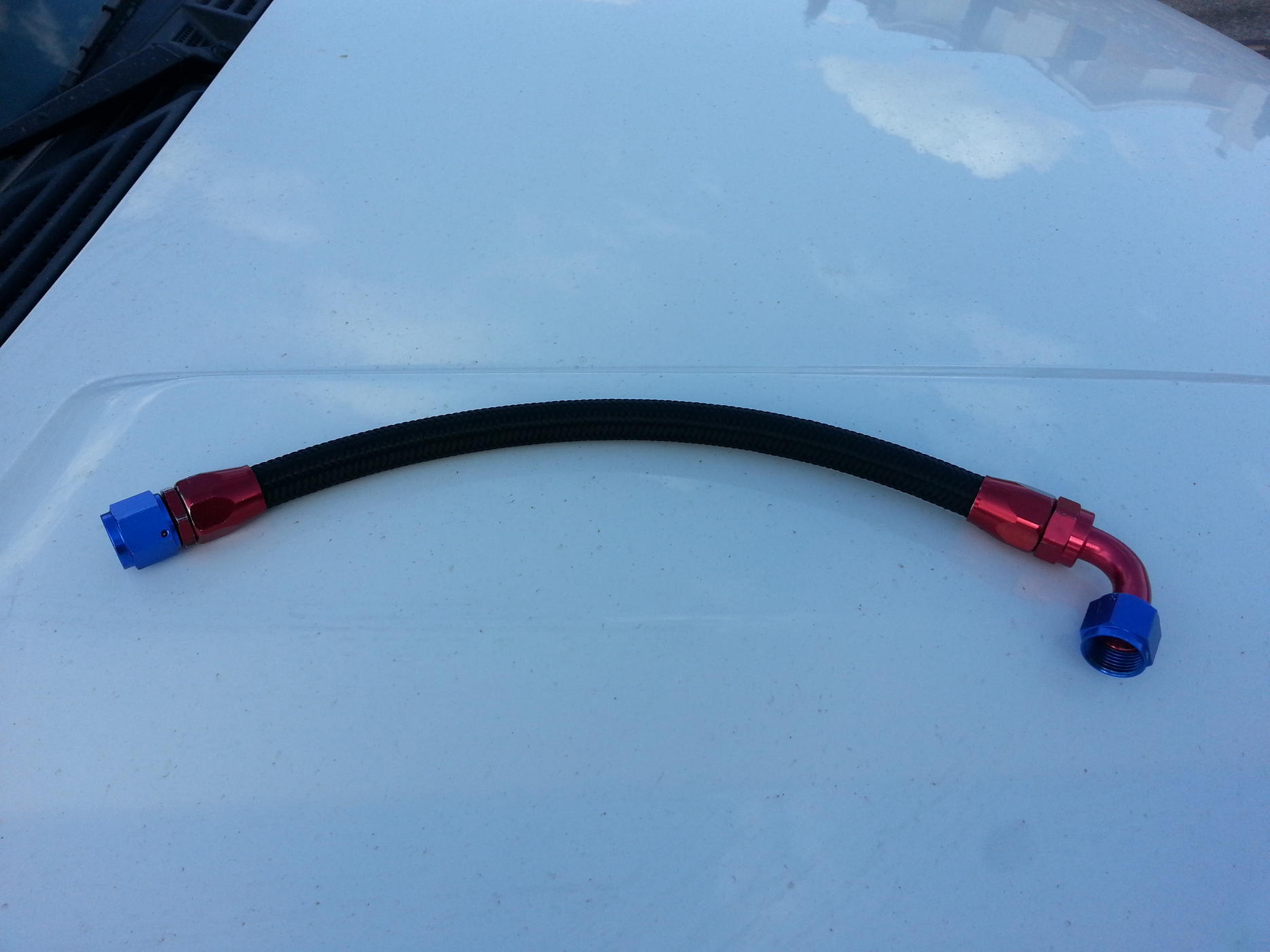

Made a hose today I think it looks way better than the red hose I was using before!

I see you like upgrading hoses but did you get this thing running?
yes i did i got some oem knock sensors off a 4runner at the junk yard and now it runs perfect. But when i was changing the knock sensors i also found out my aftermarket fuel pressure regulator was throwing fuel into the vacuum line. So i dont know if it was the knock sensors or the fuel pressure regulator causing the problems.
Sounds like it was the FPR. If its leaking into vacuum then it cant see the pressure so it dont raise fuel pressure 1:1 with manifold pressure causing a lean AFR and detonation. Glad you got her going.

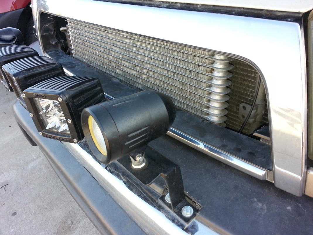

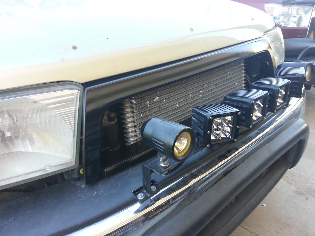

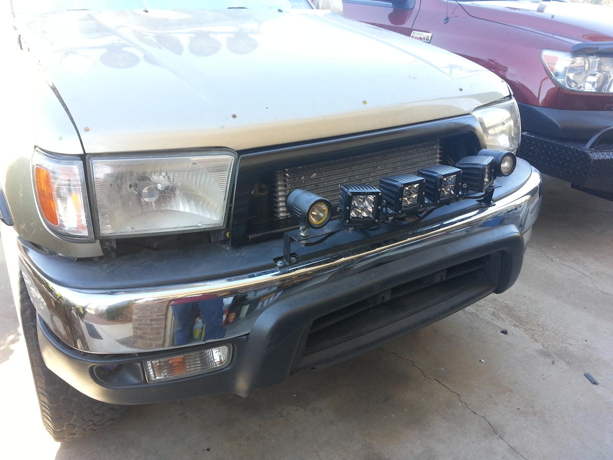

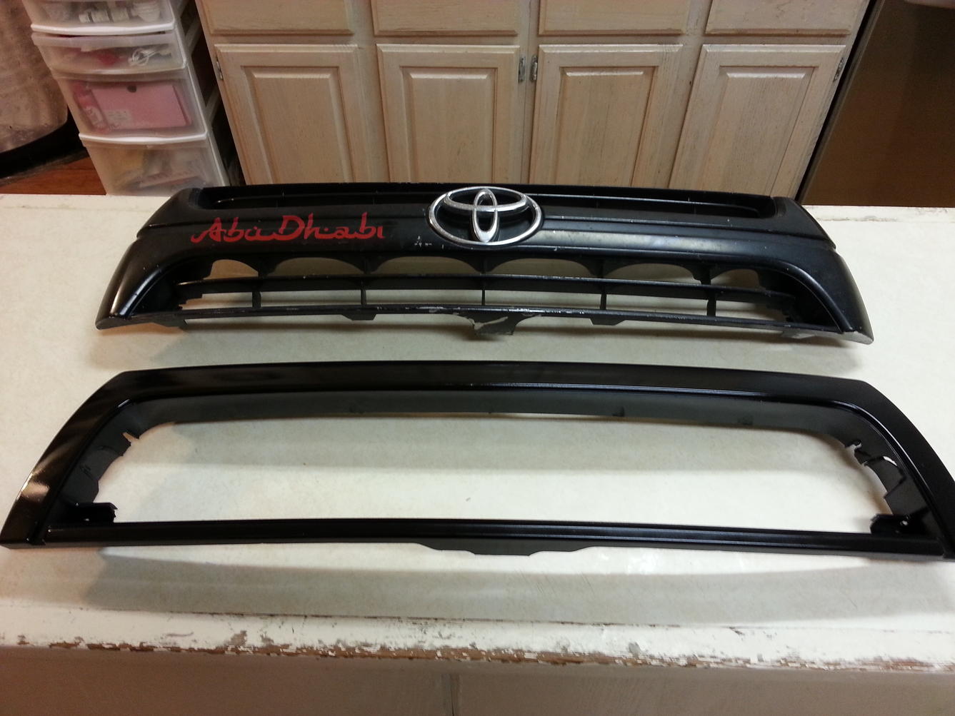

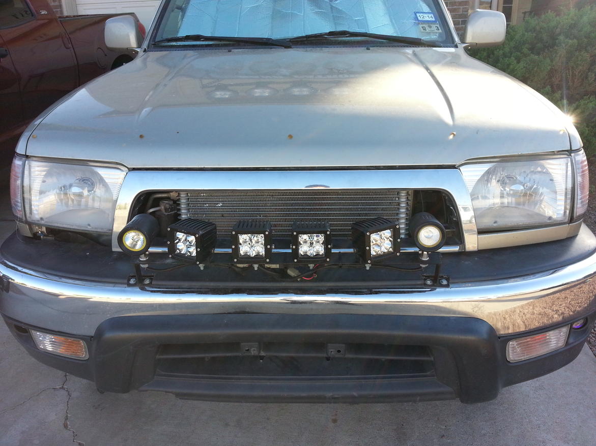

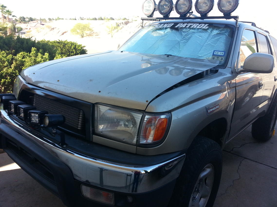

So its barley June and it's already in the hundreds today it was 108 as always I'm modifying thing's to help reduce heat. Here is my high flow grill it came off a 2001 4runner from the junk yard. I cut out the inside portion of the grill with some wire cutters it was pretty easy. I'm still going to make a stencil of the Toyota emblem and paint it on my transmission cooler the one seen in the pics. I will post some pics soon off the painted Toyota emblem.

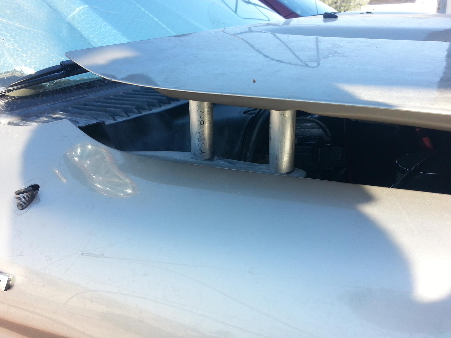

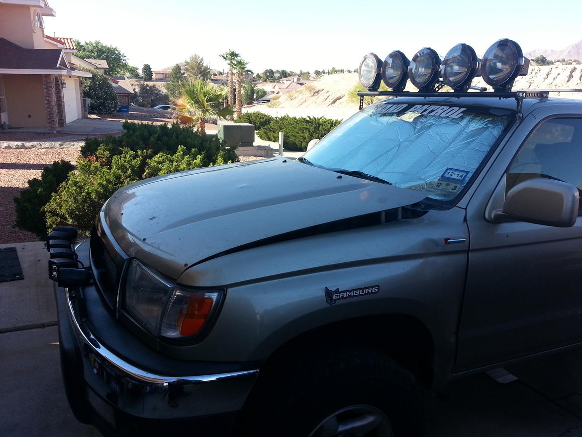

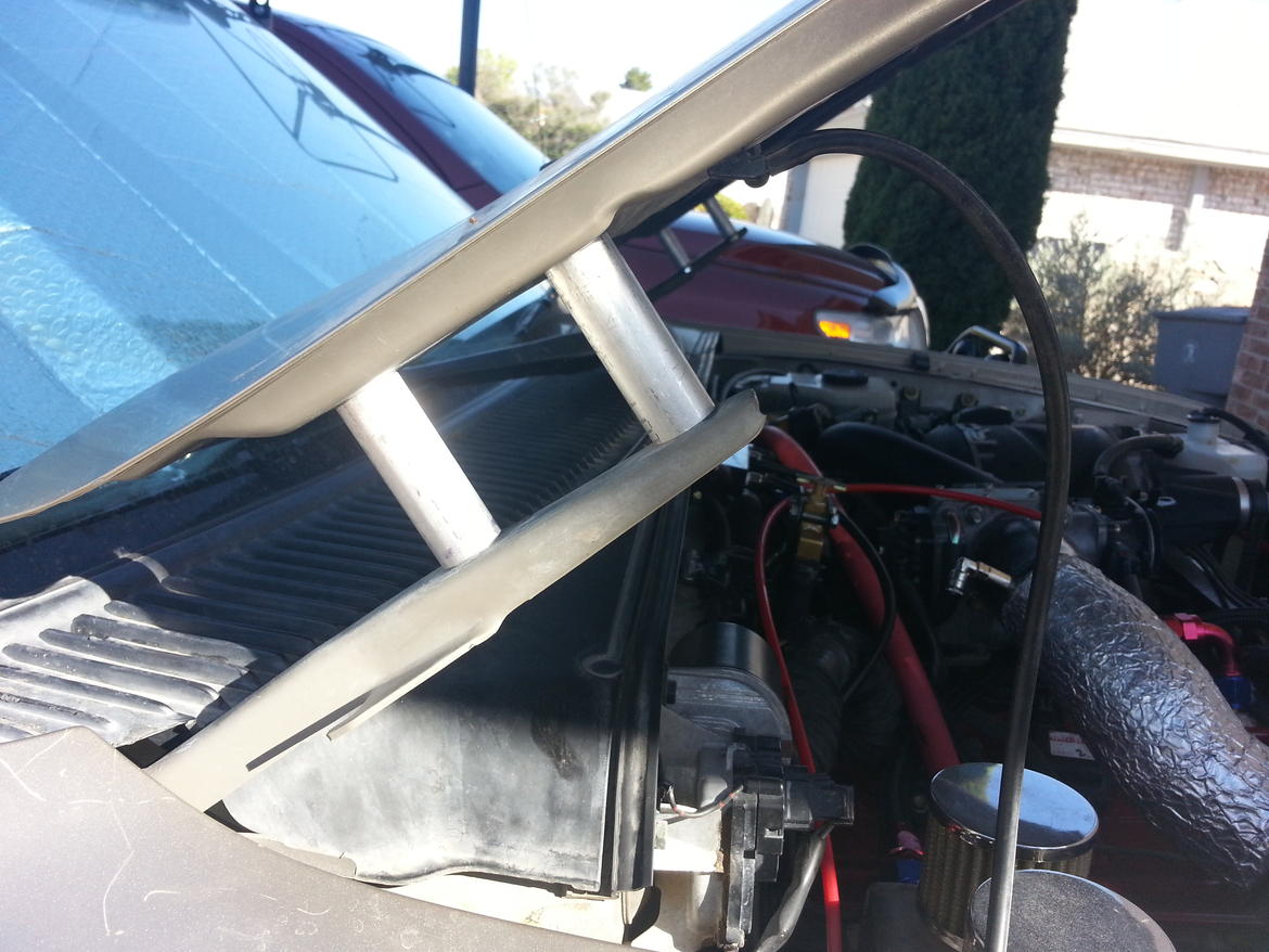

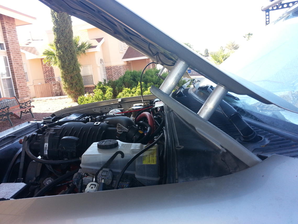

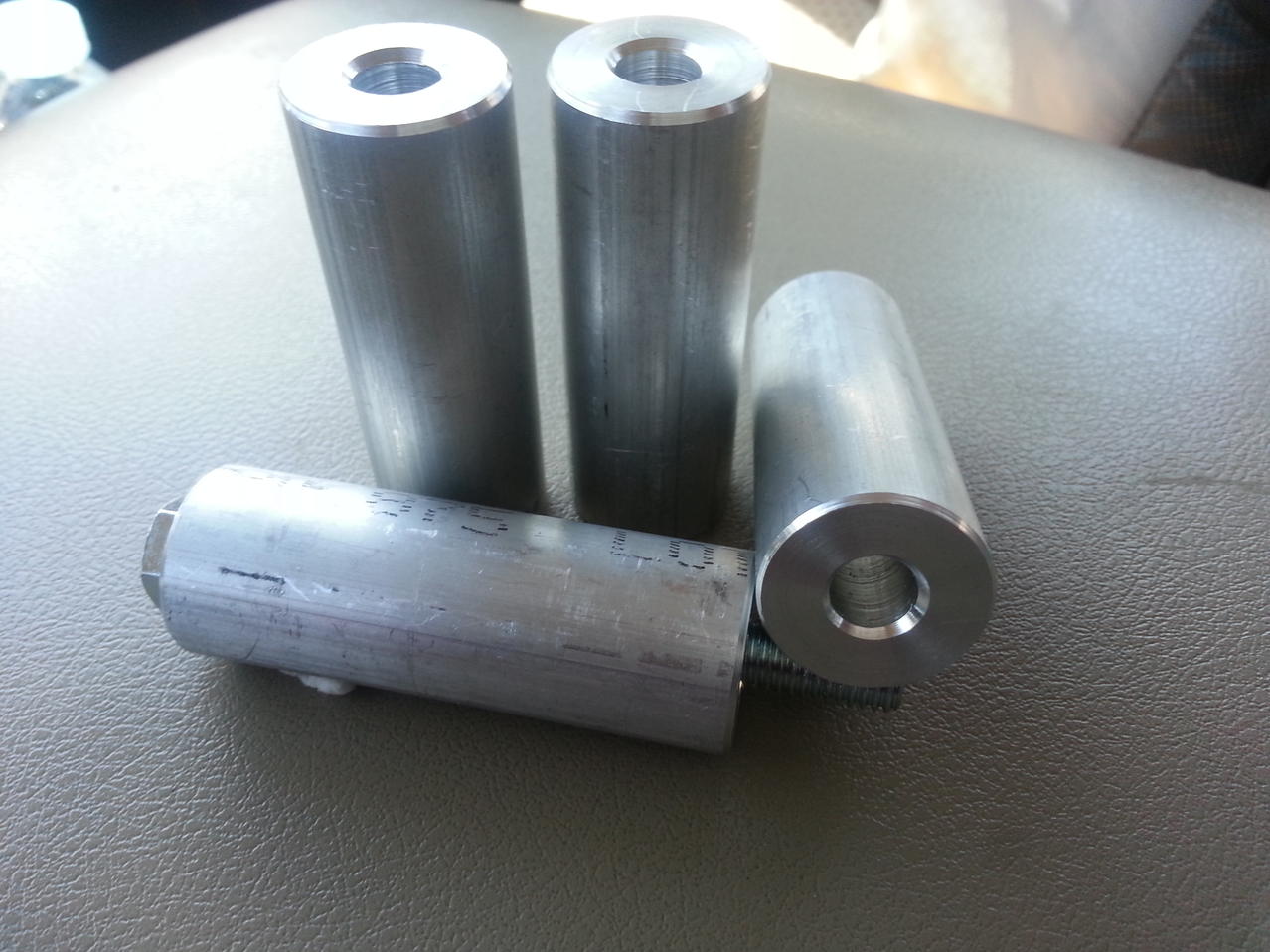

Some crazy big hood spacers I made at work today. It took about an hour on the lathe I'm still going to polish them later. The hood sticks up so much it looks like I was in a car accident lol. I can't wait to test it out and see how much heat vents out. Also some pics of the new grill painted black.
