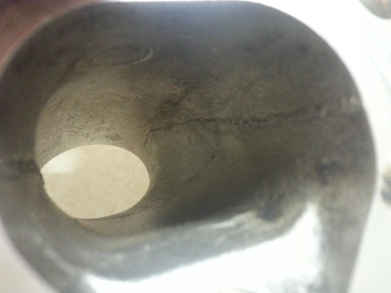

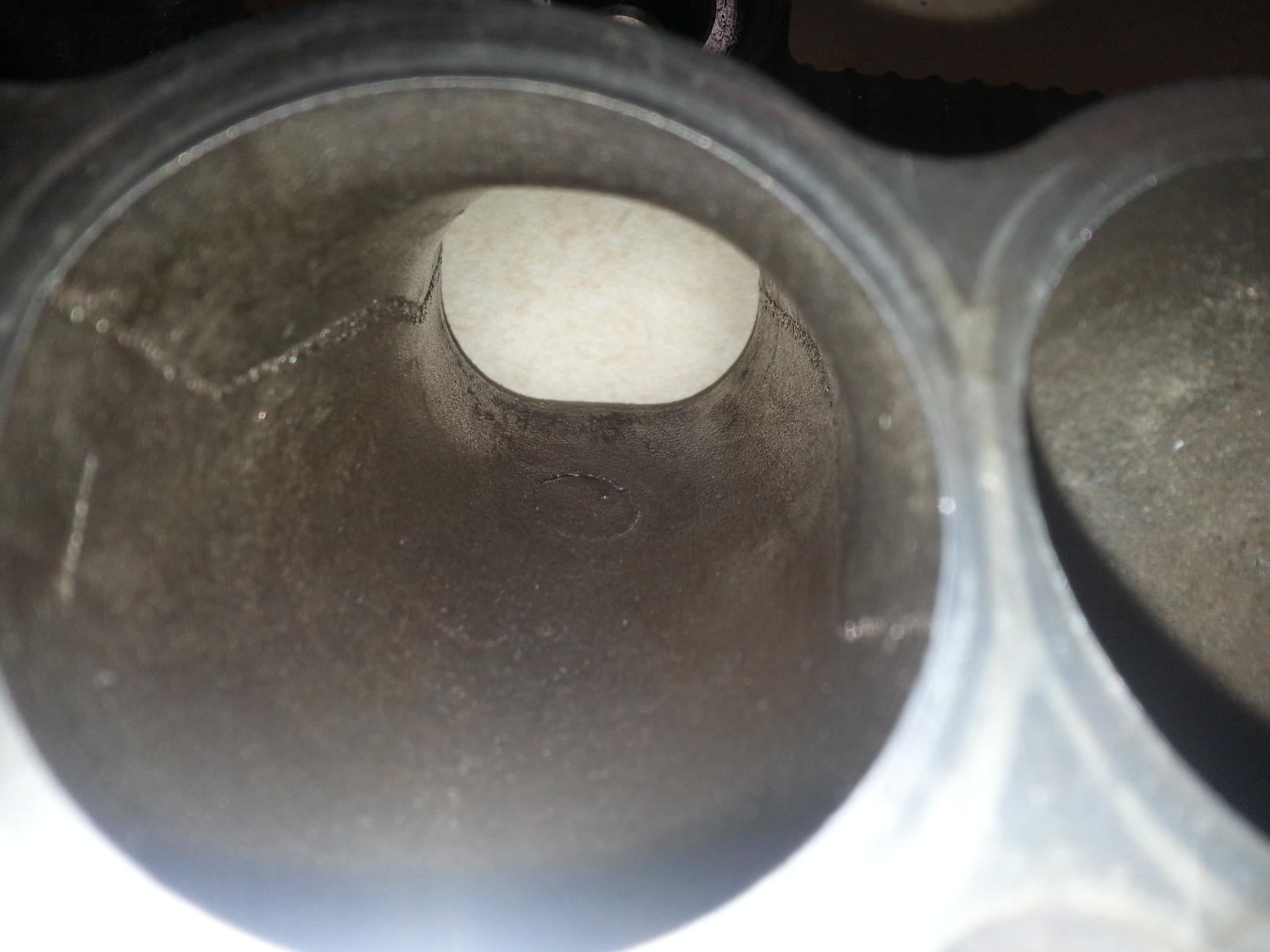

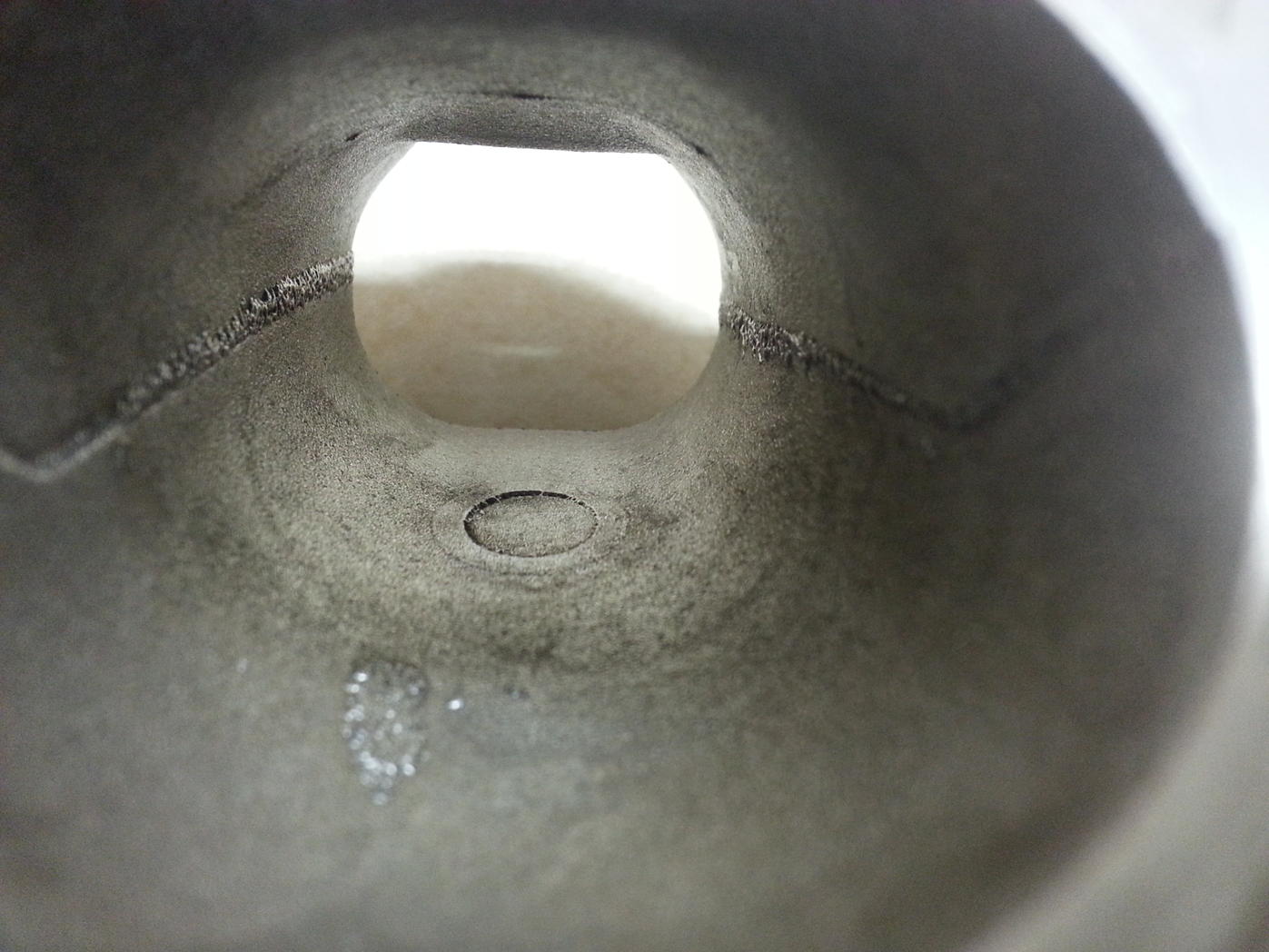

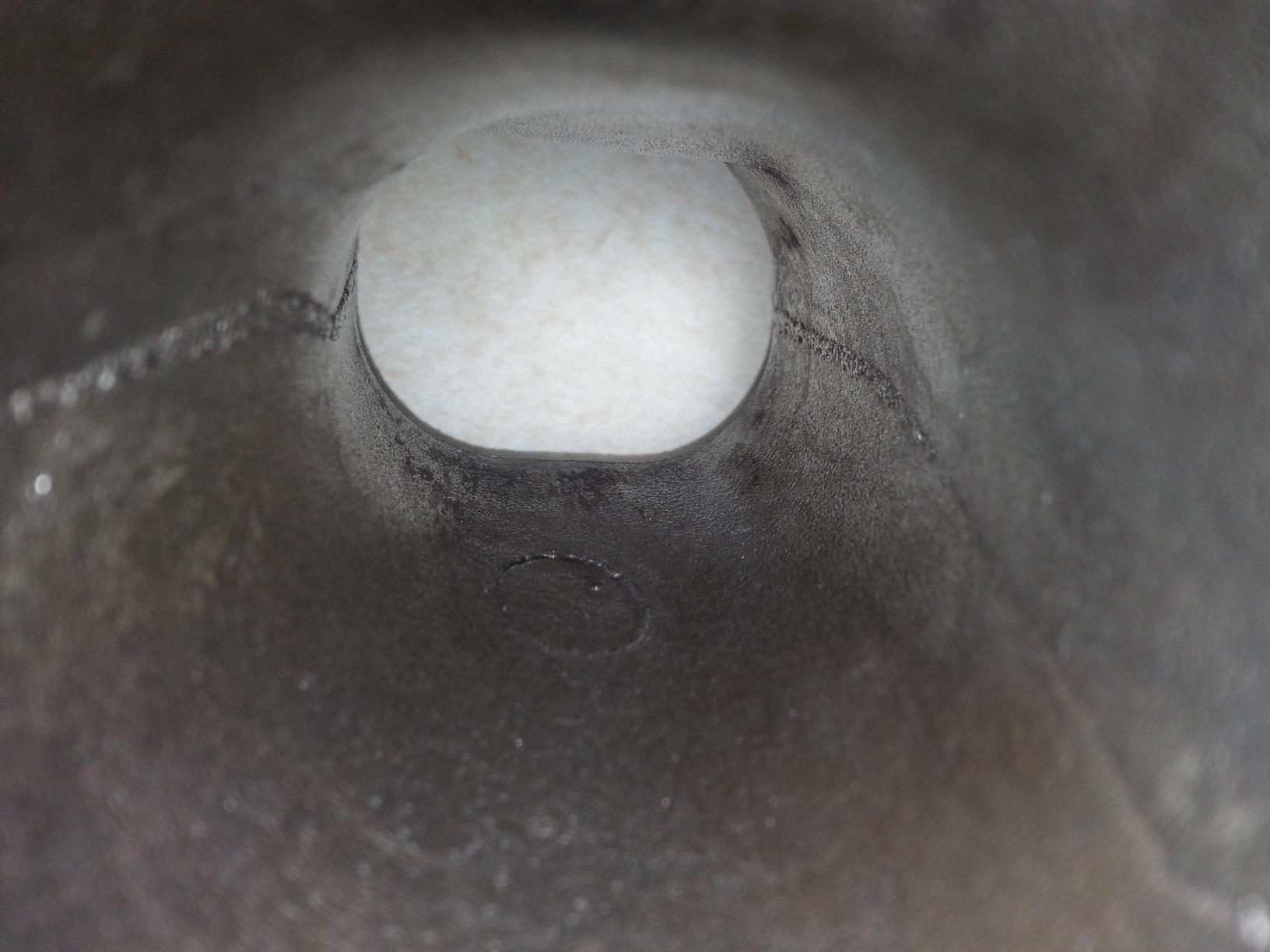

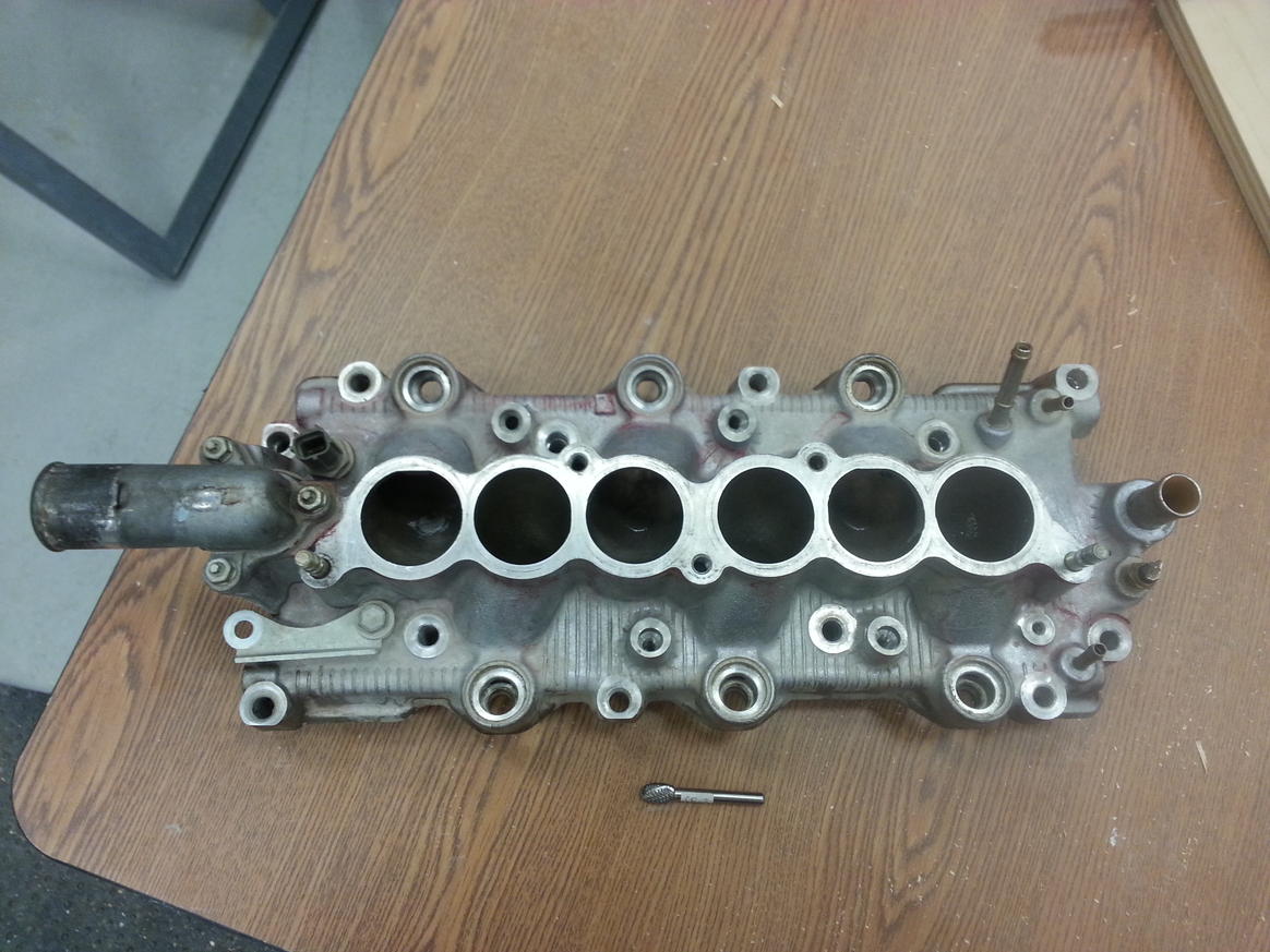

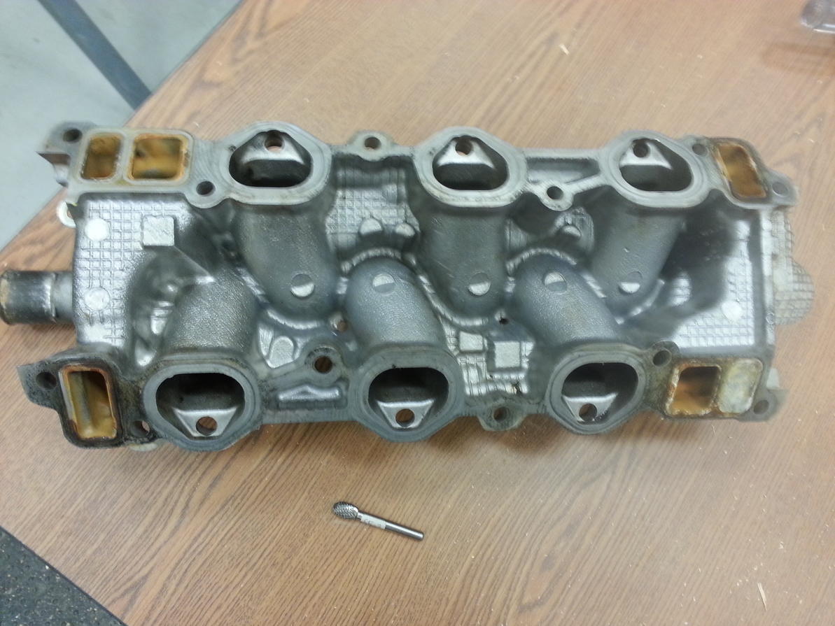

Here's a update I have removed my lower intake manifold because I will be ordering forged pistons stock compression .040 over. Im going to port the manifold myself wish me luck! The intake runners were super gummed up with oil from the stock valve cover breathers routed into the intake and 11 years of build. It took a lot of cleaning with carb cleaner but That's exactly why I have a catch can now so it won't happen again.

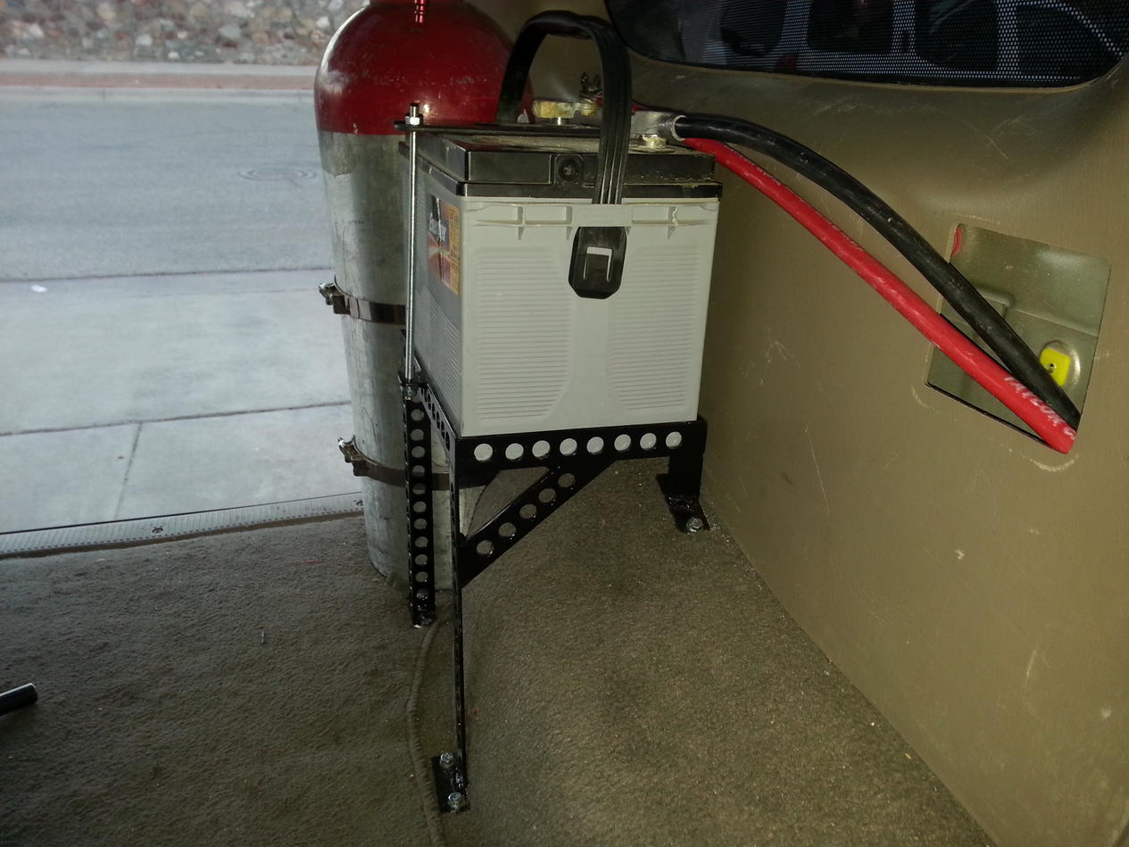

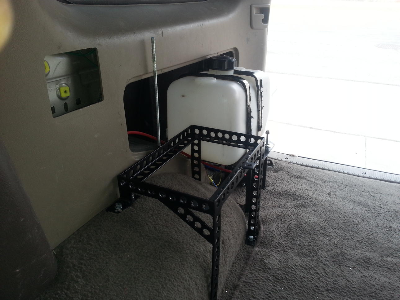

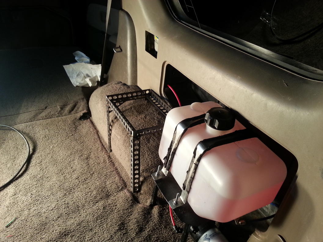

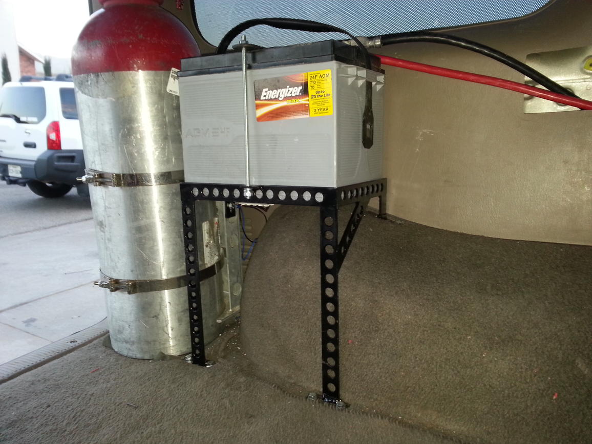

Na oil light never came on. Ok update just been working on my battery relocation finally got the battery mounted and wired. Also have been working on my led interior lighting. Since the 4runner is broken down just been taking care of all the little things.

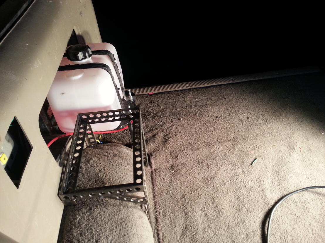

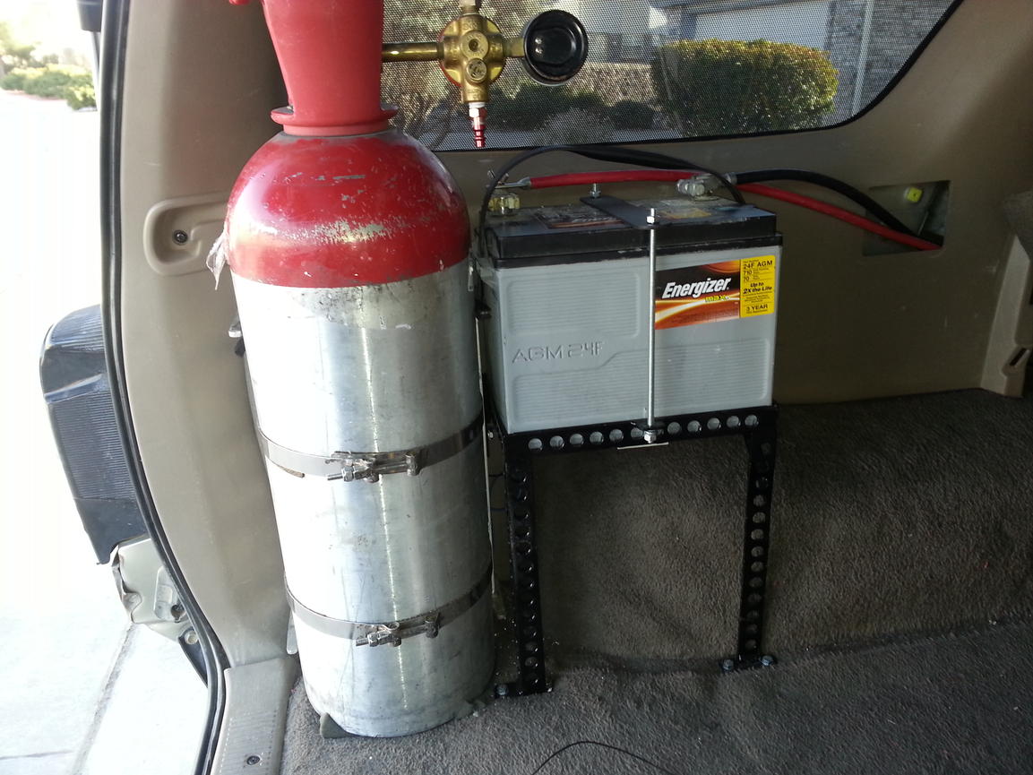

Here's some different angles of the battery tray its tucked up nice out of the way for when I go camping and sleep in the back.

Its just some aluminum sheet metal welded together there's not to much to it just 2 breather filters on it on the can and some hoses ran to it. The reason for doing it is so I don't keep sucking up oil into the intake from the blow back. You should see the intakes on my head and the lower manifold super gummed up with oil from 11 years of sucking blow back oil.

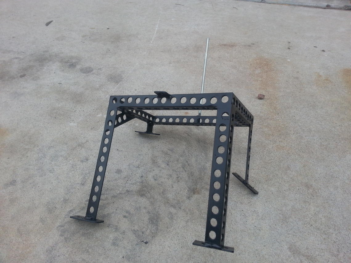

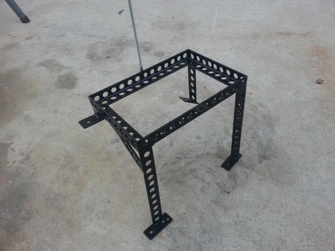

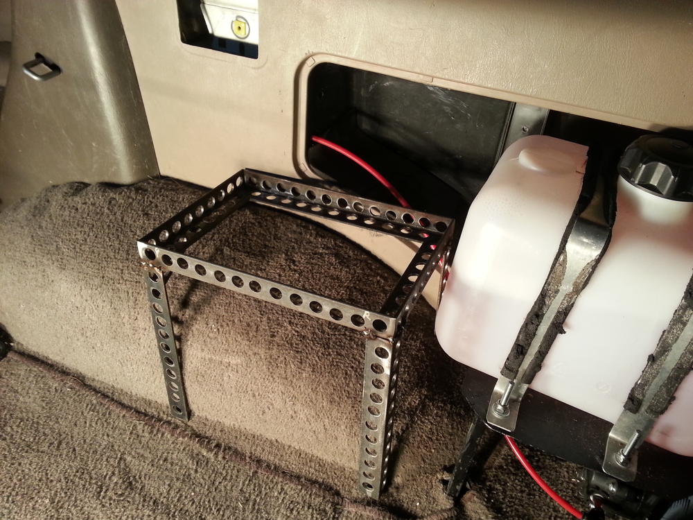

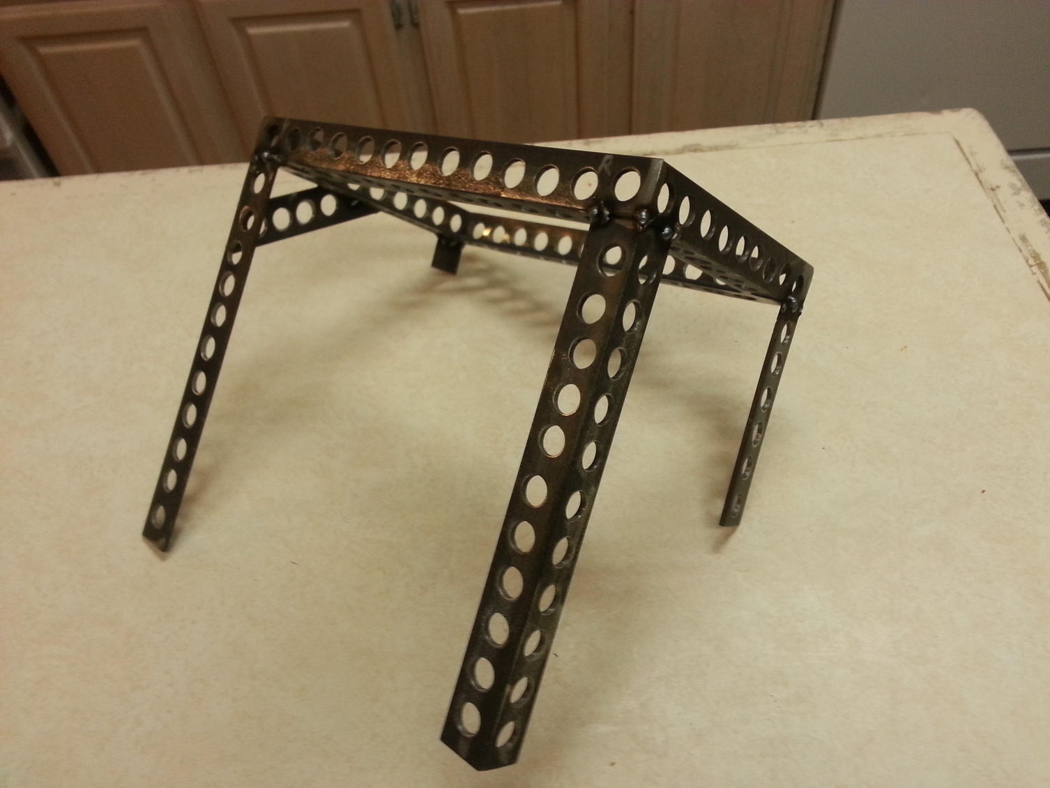

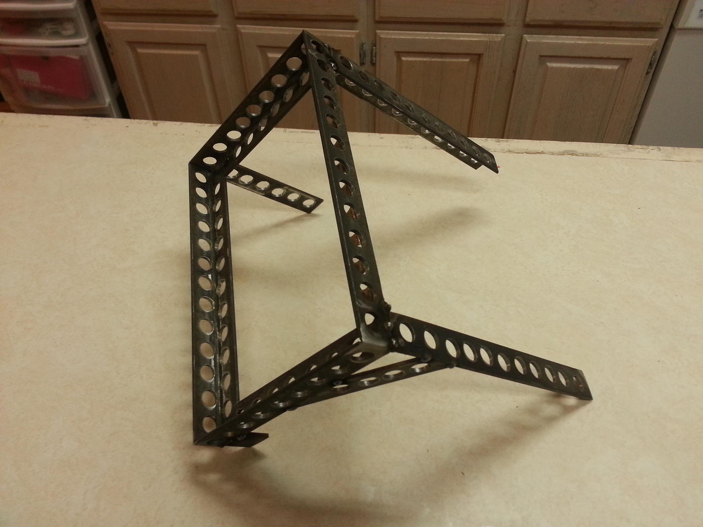

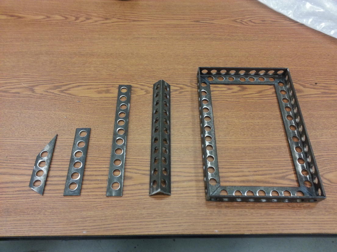

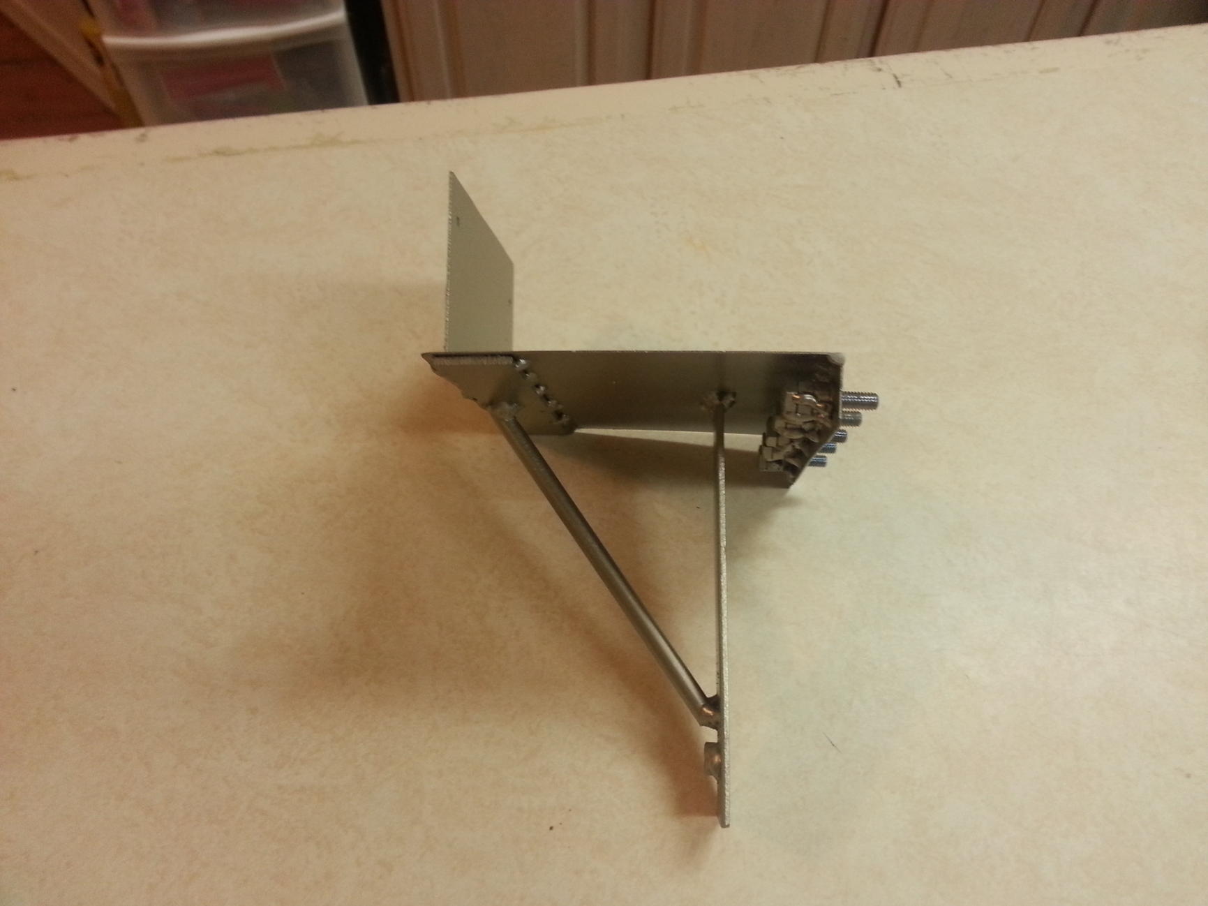

Started working on my second battery tray for a dual battery setup so far I just have the tray im working on the kegs for it right now no super bowl for me.

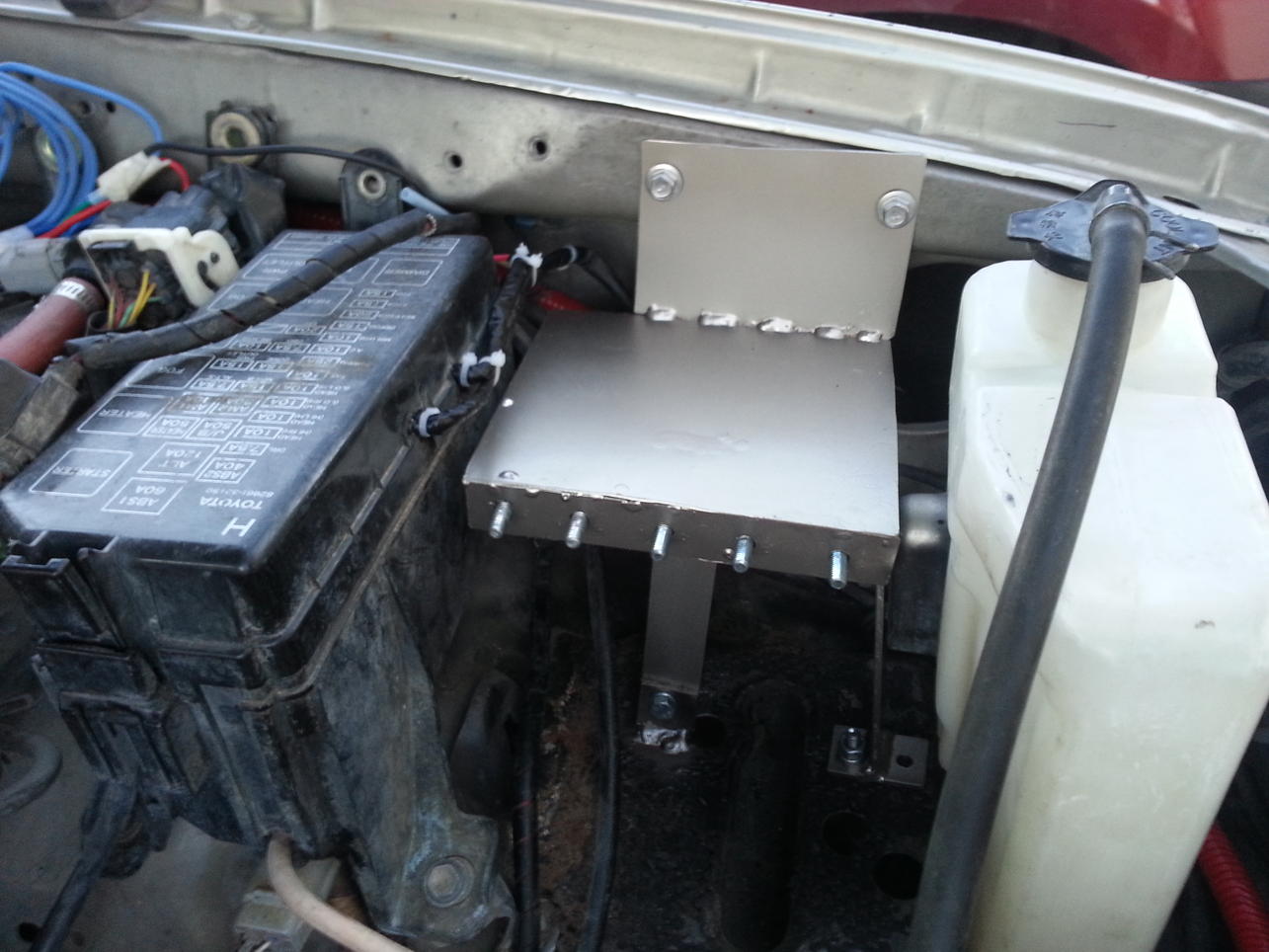

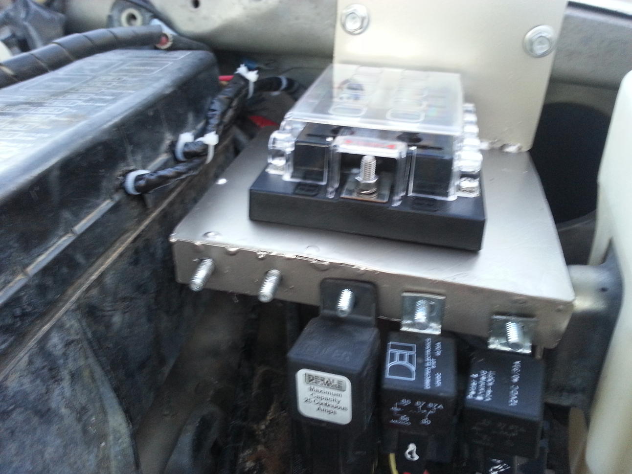

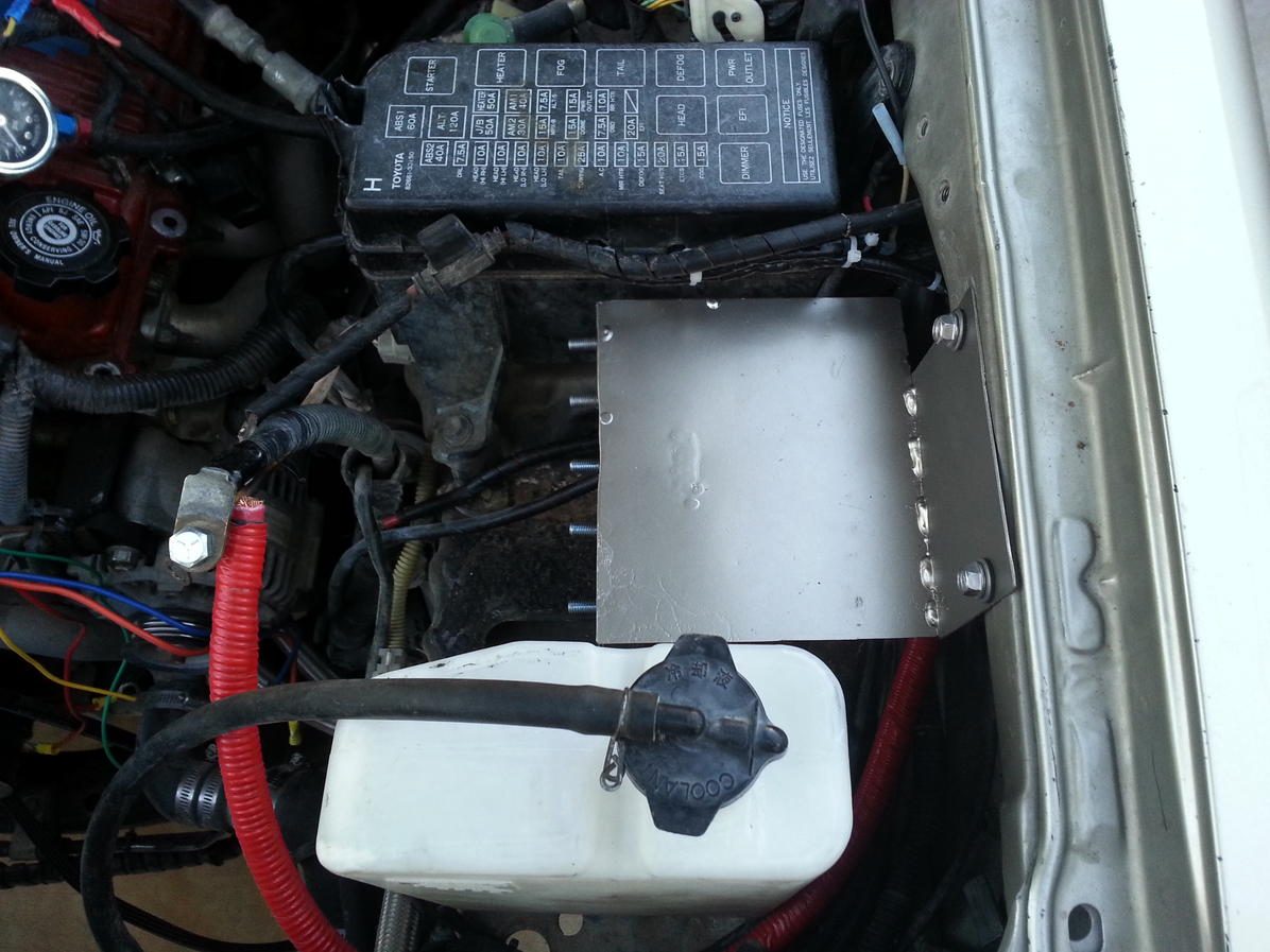

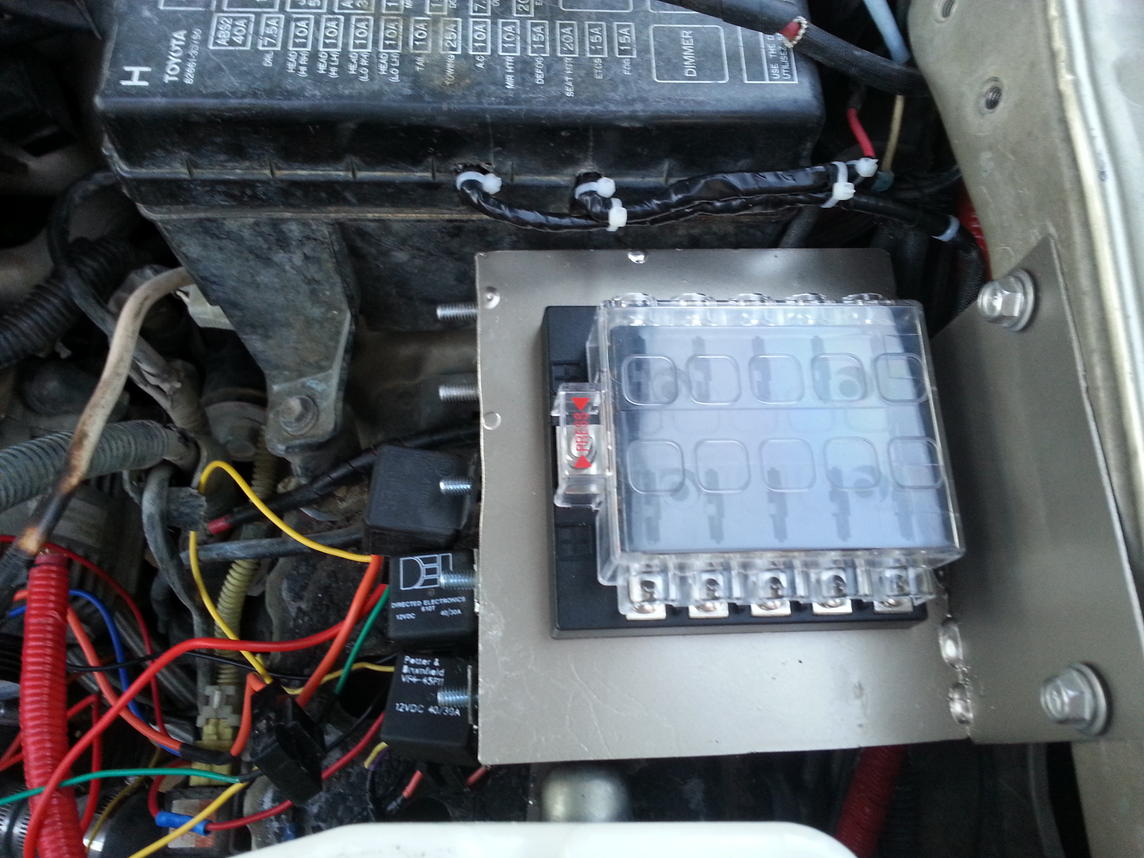

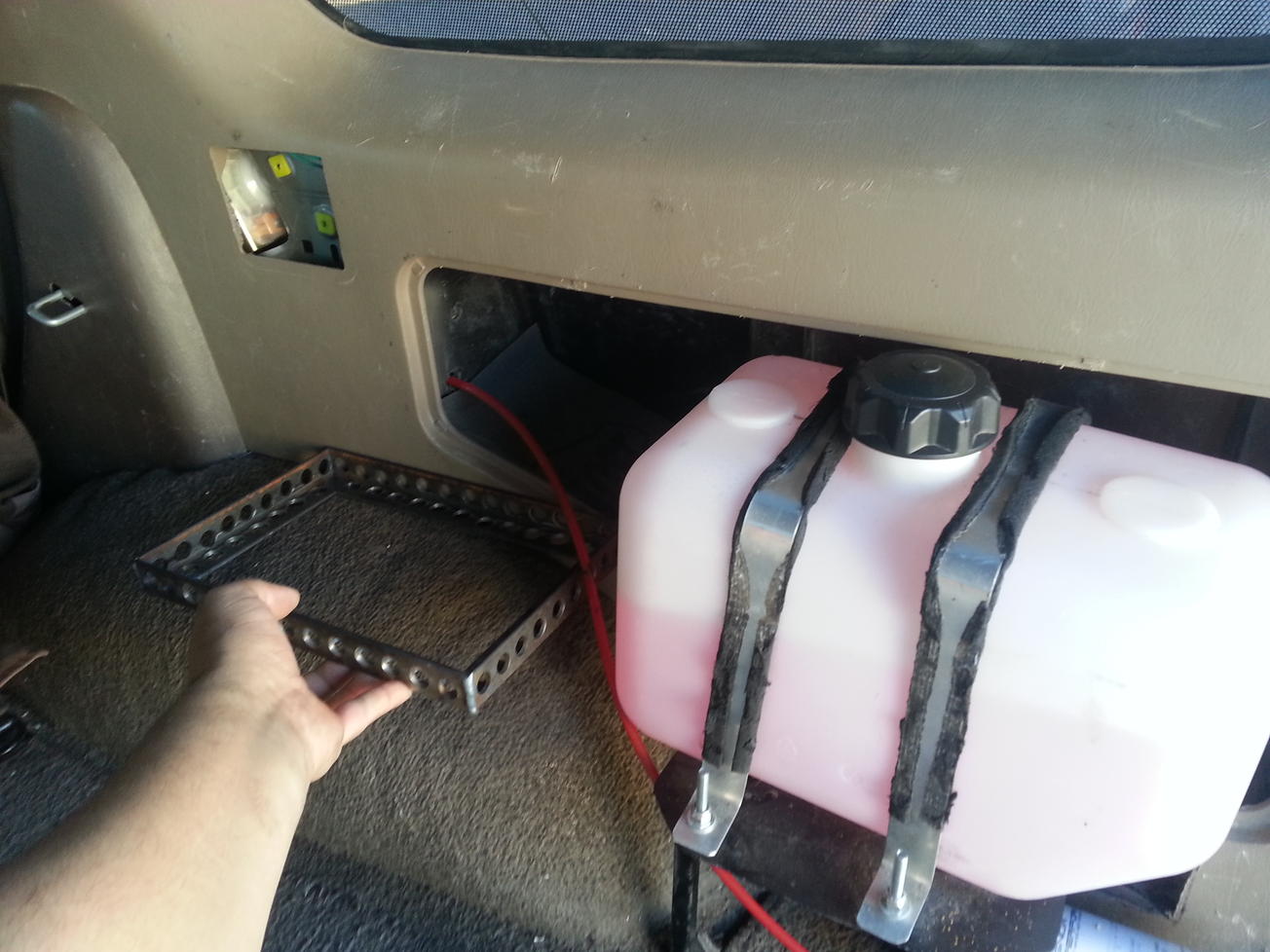

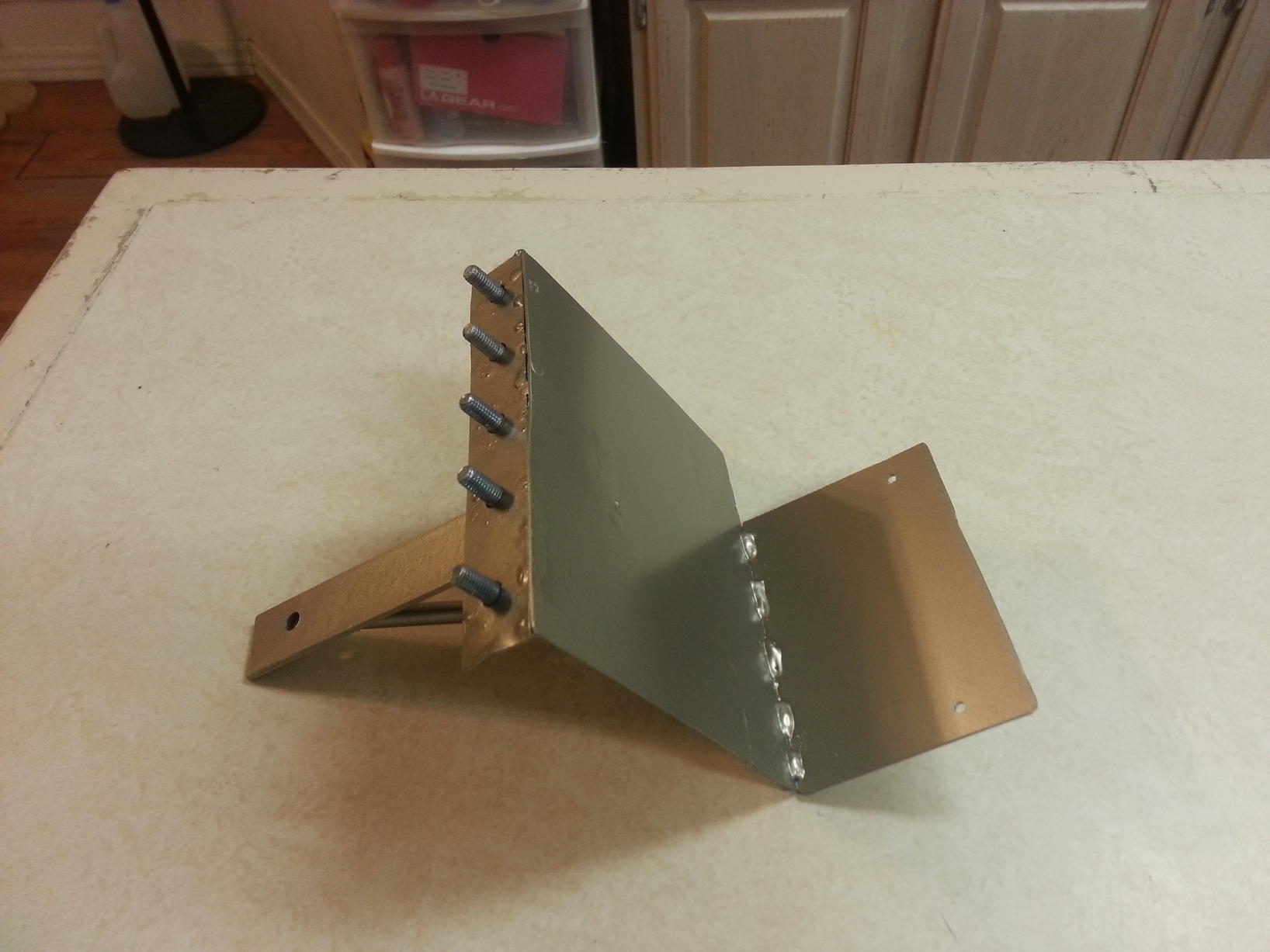

My a tray to hold my new fuze box and all my relays also mounted the overflow bottle. Now that the battery is in the back I used to this spot to clean up all the wiring and relays. I will post some pics when the wiring is done im also working on a mounting post for the positive terminal since the battery is in the back now.

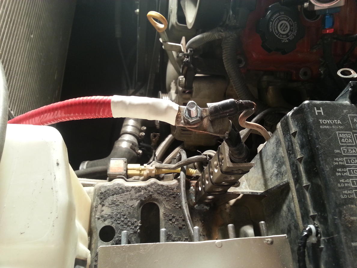

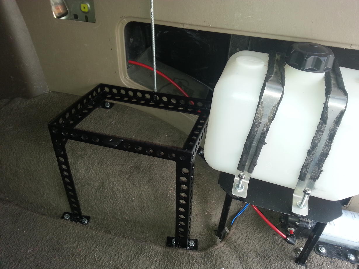

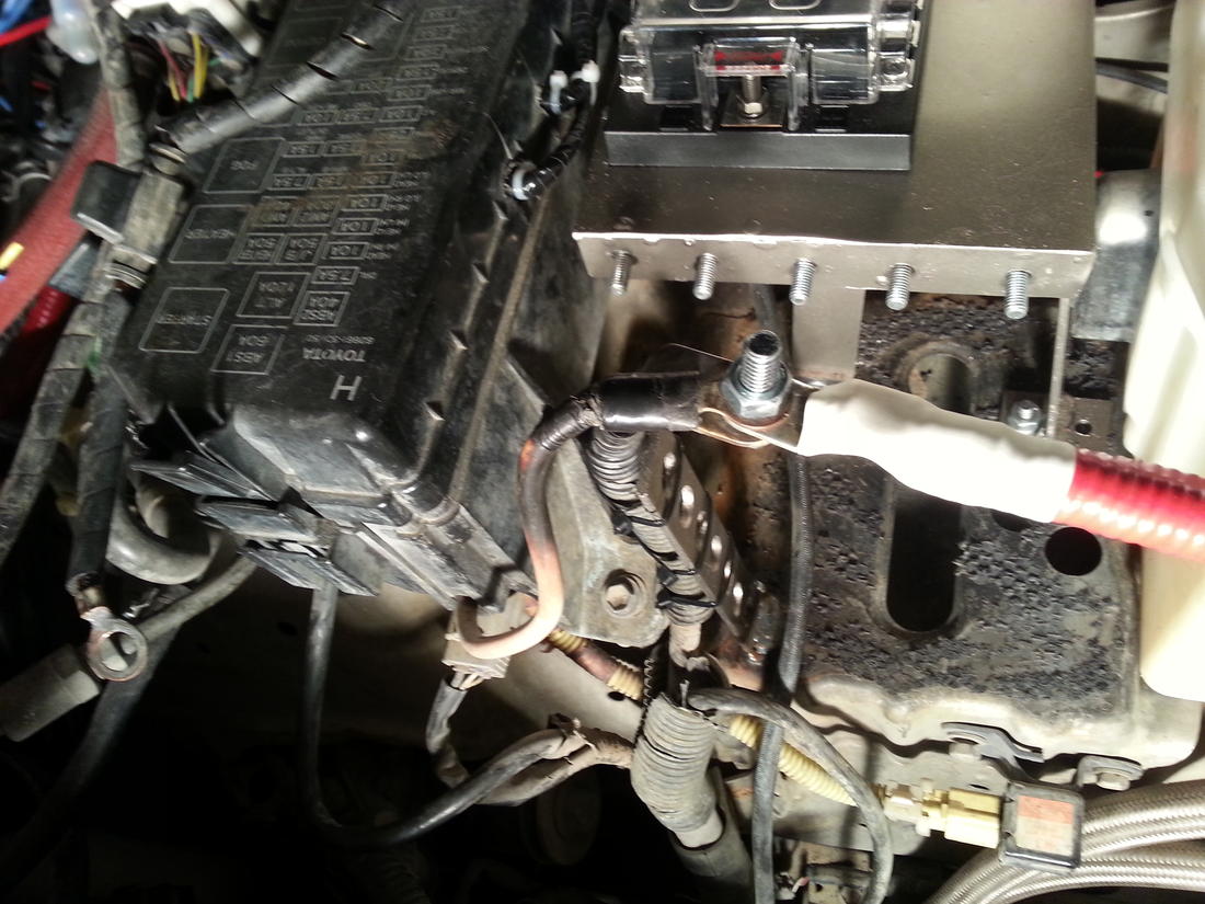

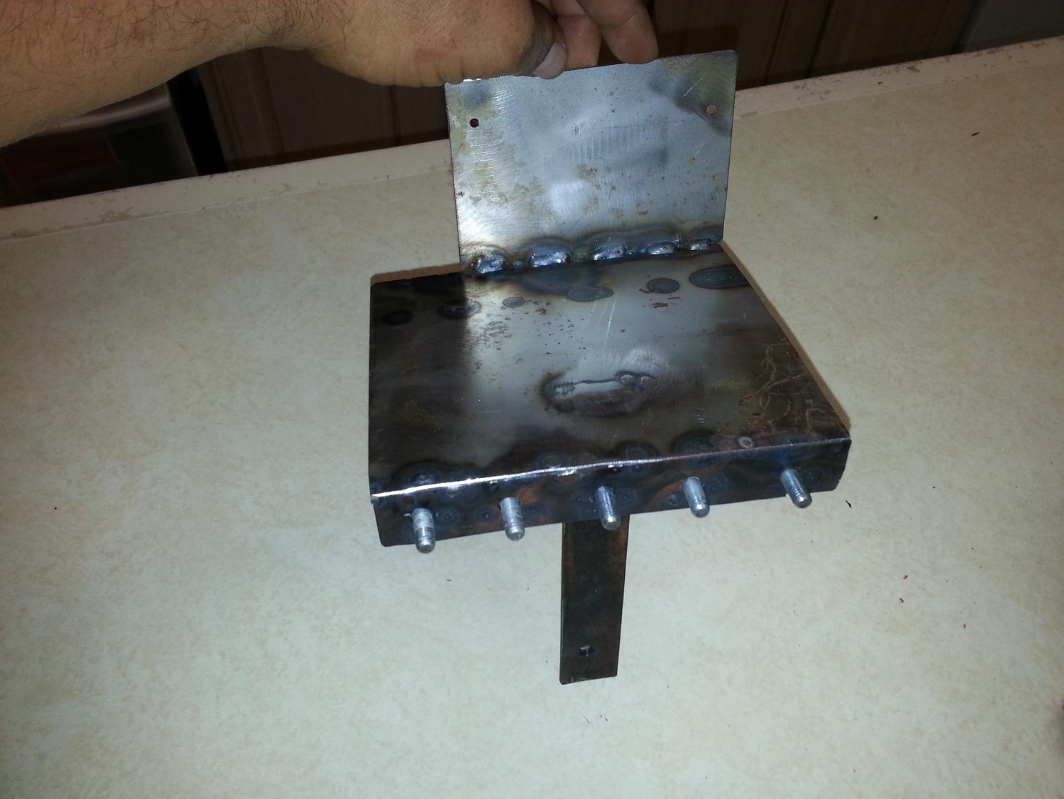

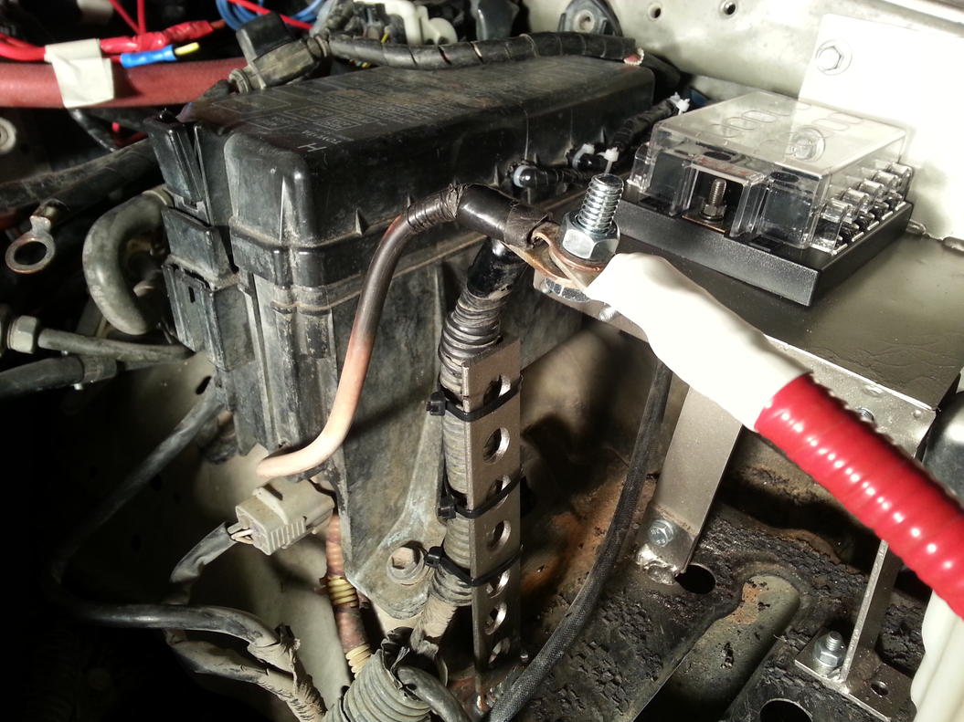

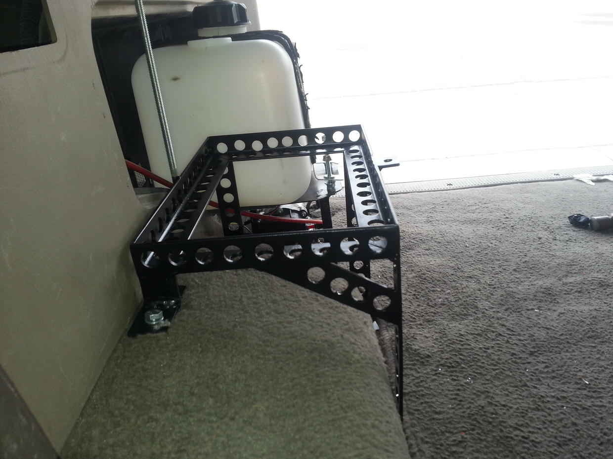

Finished my positive battery terminal mount I mounted it pretty much in the stock location where the battery was. Now I can tap into that positive terminal later on if I add some more fans or lights. Also been working on the second battery relocation tray its almost done. I just need to finish bolting it to the floor then il weld everything up grind down the welds and its ready for paint. I should be done by tomorrow night.

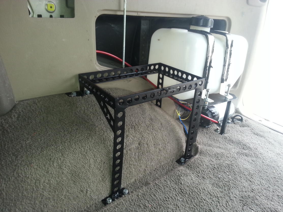

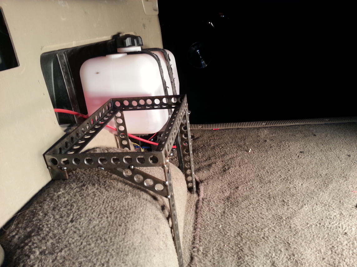

Got the second battery tray finished painted and bolted in just waiting to purchase my second battery. Im going to hook up the second battery to the main battery threw a saleniod to isolate the second when the truck is off.
