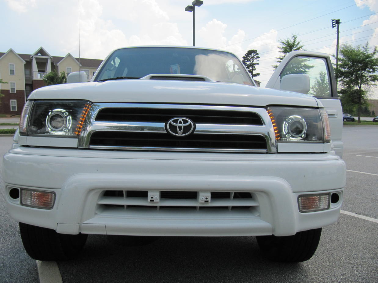

So these headlights should be done on thursday hopefully. still waiting for those amber LED strips to come in. after that i'll take more pictures of the final product and light output pictures

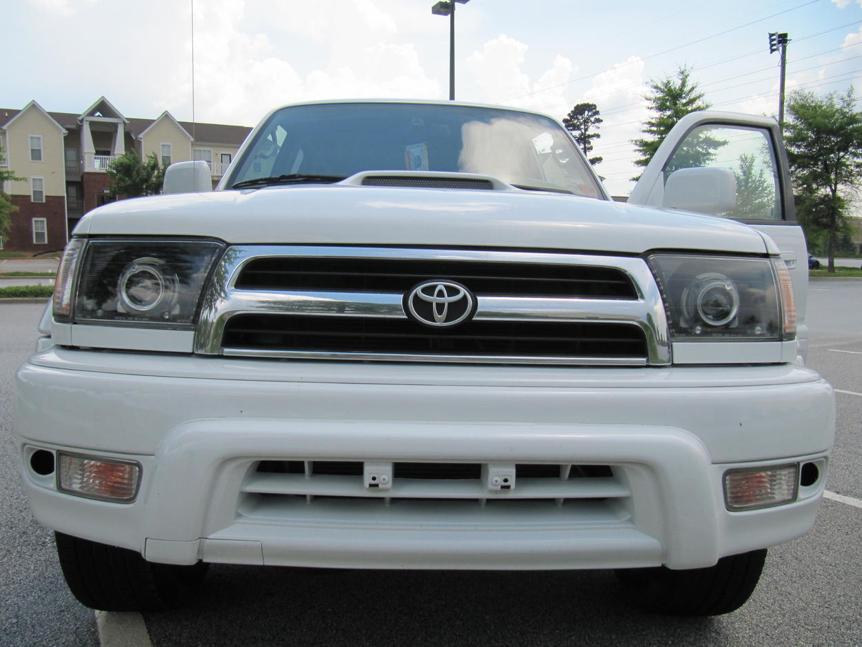

Got the headlights together, and they look good, i ran into a problem though how do you wired the H/L shield into the car? and whenever i turn the high beams on the lights turn off. i'm sure someone know how to fix this. but here is a picture of them mounted. (inspired by GottaBeTRD and MTD) I'll take light output of least the lows once it gets dark out

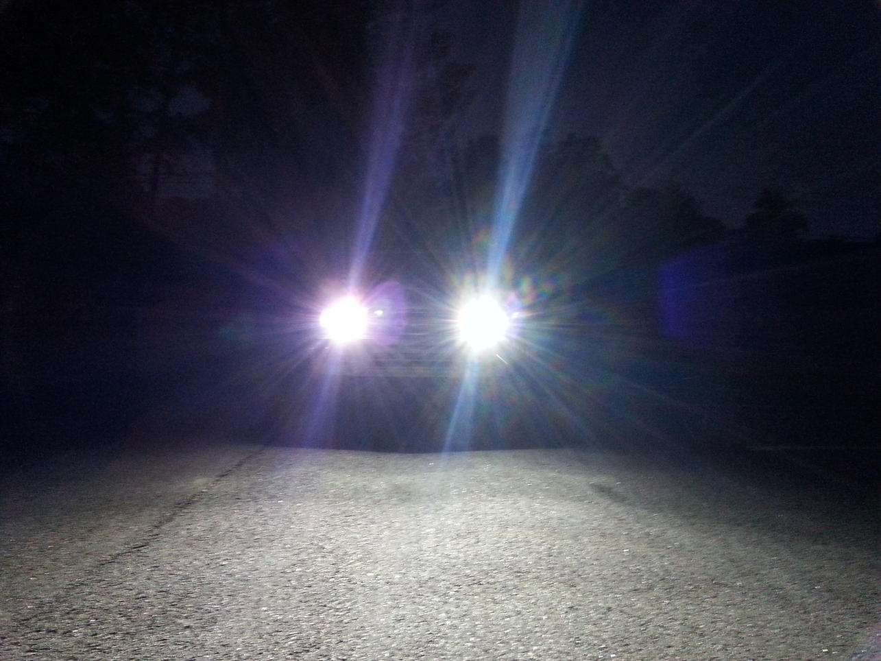

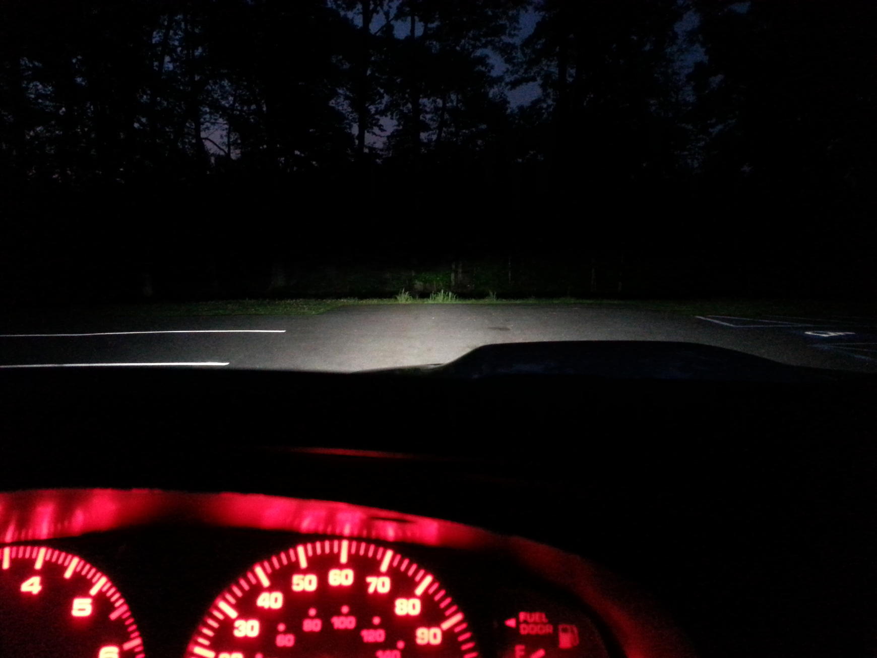

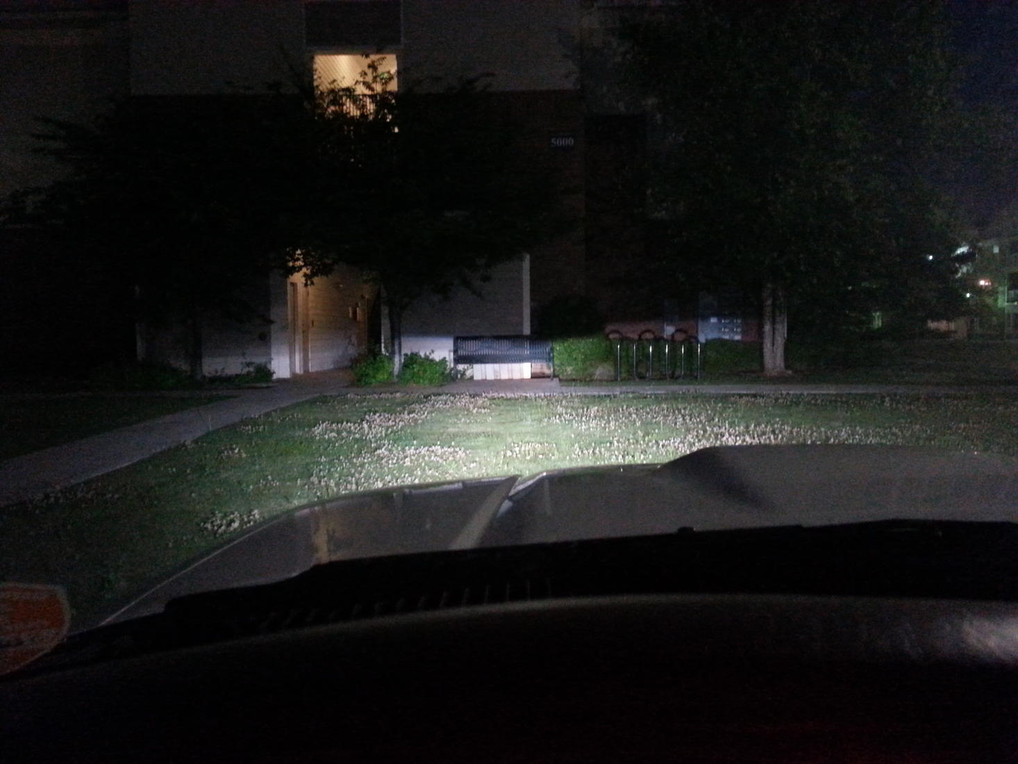

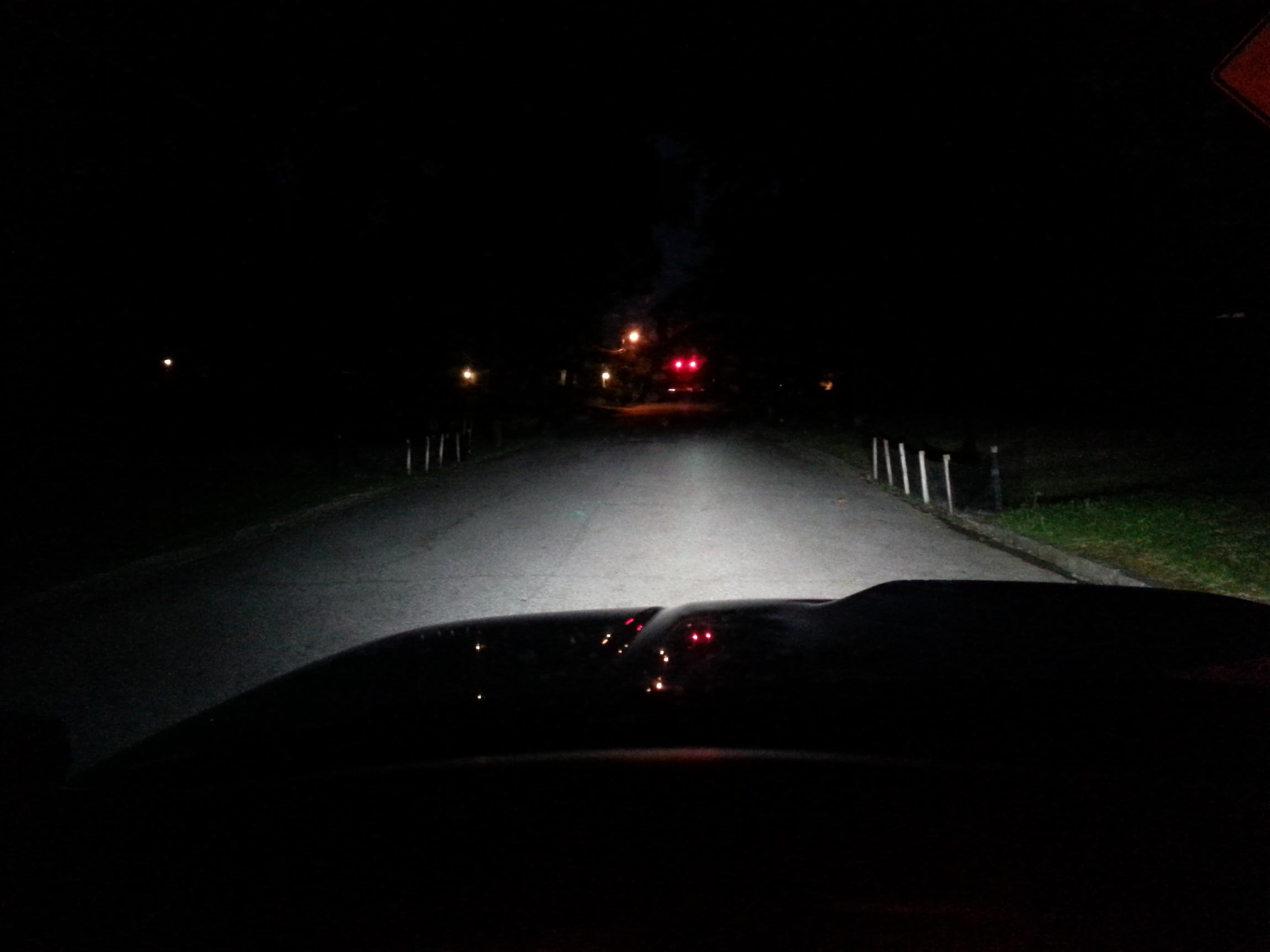

Lows only

disregard my PM response. Those look great man! And to all those bashing crappy ballasts... never mind I've probably already jinxed myself lol. I honestly still run my Apexicone ballasts i got from DDM a couple years ago. I'll for sure upgrade when i do my second set but for now, they get the job done.
Correct me if I'm wrong but i think the stand alone harness is what a PnP hi/lo kit comes with right? it has the little box attached to it? anyway they look great man. did you end up using those little brackets?

if you are talking about the brackets for the led strip then yes i did end up using them. worked out great, thank you for the compliment. your headlight conversion gave me the motivation to do mine. i'm gonna to go to TRS and get that harness tomorrow. since i live about 25 minutes away
