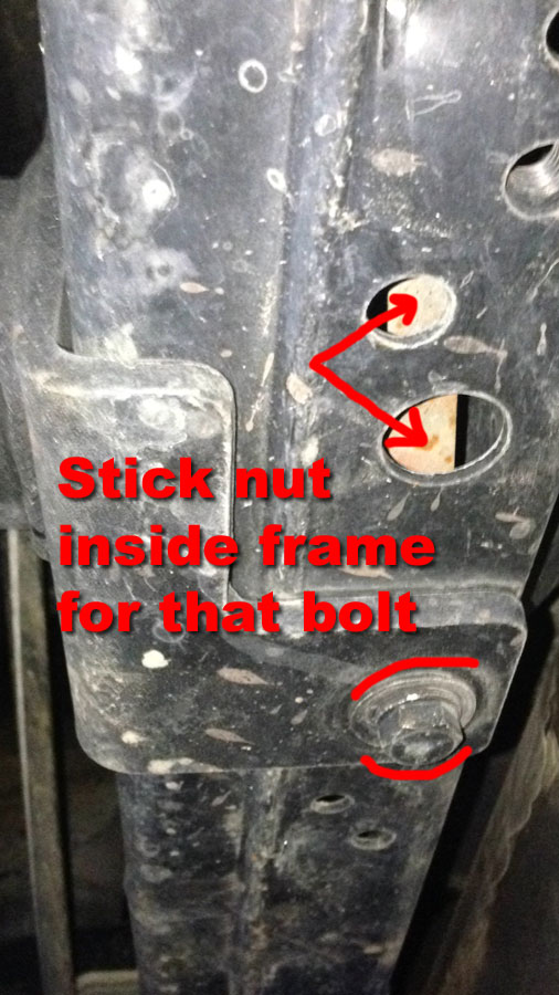

Working on these sliders right now, and let me tell you this is painful, and stick nuts are hard to install. I am going to have to grind them down to fit. Anyone have some good feedback? Thanks!

Do you have any ideas for the stick nuts?

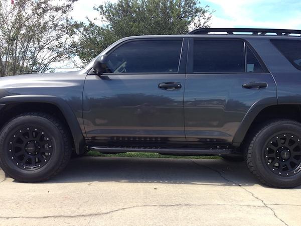

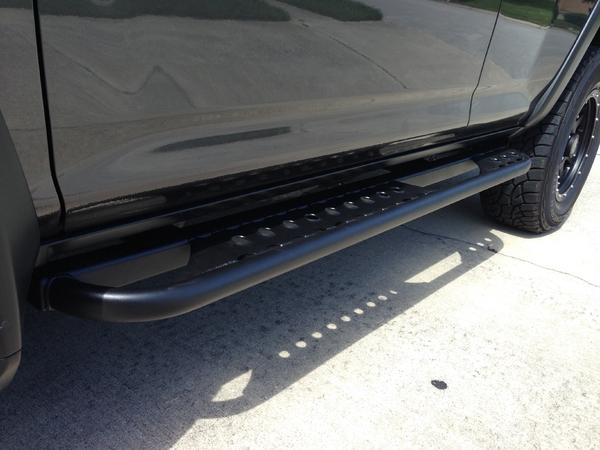

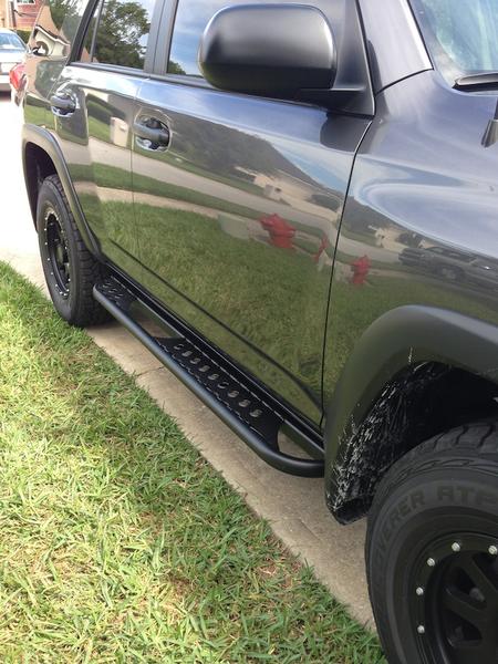

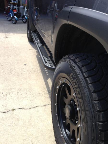

Finished install a few hours ago. The worst to install was the driver side because of lines and having to unbolt 4 gas tank bolts. The strap is a pain to get back together and like others have said ensure you don't have a full tank. Will post pics later tonight.
Pics as promised!
I see your done. Looks good! Sorry I didn't get this earlier, I was installing my new coil-overs :naughty:
If you hadn't gotten an answer by now, the stick nuts are to be used where there isn't any factory threads weld to the box frame.
So you have a hole in the slider and the frame and no threads in the frame to hold the bolt. Pop off a frame plug (black plastic plug either round about the size of a silver dollar or round edge rectangle) closest to the hole that needs a nut, bend the stick nut slightly so when you insert it into the frame it will rest along the inside wall. This makes it easier to see and thread the bolt. You can mark it after you have found the length you need and trim it or just fold it over.
