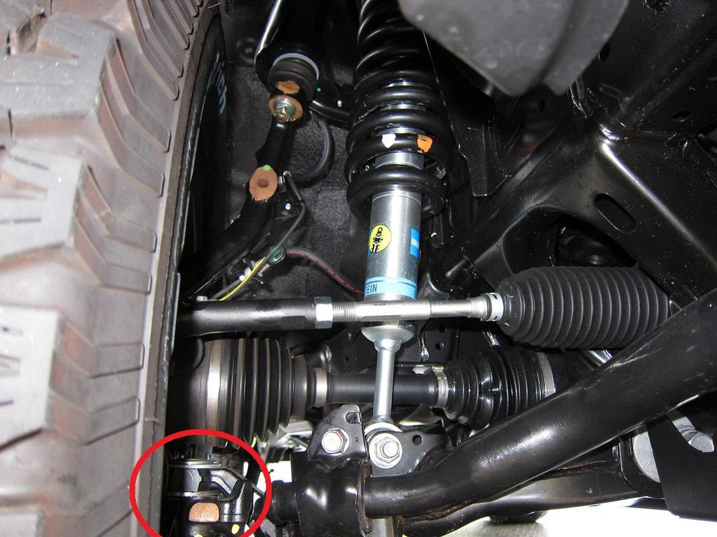

Here's some pics of the LCA's to show what were talking about.
C214446E01.png~original
And they are saying cam bolt #31 is missing on the pass. side because I can see the front one in your pic?
gview.png~original
What I think probably happened is the first alignment guy forgot to tighten the LCA cam bolts and the dealer missed it. What threw us off is you saying the dealer checked the alignment which obviously they didn't as the manual clearly states a torque of 129 ft/lbs on those bolts after loosening them up for an alignment.You would think that would be the first thing they checked! How much is the dealer charging for their incompetence? Should be no more then a alignment cost and then you get your money back from the first incompetent alignment guy. Your KDSS isn't and wasn't the problem and should be fine.

Glad you posted this pic - I've been looking for a diagram from the 4Runner. To answer your question - I have no idea how two separate alignments techs could have forgotten to torque down these bolts. I'm hoping that once this thing is aligned and tightened down, everything will be right. Still don't understand the TRAC light situation, unless the alignment just drifted so out of spec that it triggered it - which is something that Toyota denied could happen. I'm assuming that the car won't let you zero out the pitch/yaw with a wildly misaligned vehicle, which is why they were locked out from recalibrating the TRAC system. If it ends up being that stupid, then I'll be relieved. I guess it makes sense that the car drove ok before the alignment that caused all hell to break loose. It would also make sense that the car was initially aligned to spec the second time around, but then the steering wheel drifted off-center when it was actually driven.

I agree with Harper7- I don't see how those cam bolts could fall out. Maybe for some reason during their install, the original shop loosened these bolts that connect the LCA lower ball joint attachment to the upright knuckle (one is out the other is being removed in the pic). they normally wouldn't loosen these, but they did have difficulties with the KDSS, so who knows? These bolts need to be installed with locktite to prevent loosening, and aren't normally checked during an alignment, which could explain how every alignment tech missed it. The original shop should have rechecked EVERY suspension bolt as soon as they were done IMO... I can see one of these bolts falling out easily. Whaddayou guys think?

I think you might have it there. I talked only briefly to the dealer b/c I was busy at work all day, but I'm fairly certain he mentioned that it was the LCA attachment to the knuckle, which would be bolt 160 in harper7's diagram. Thoughts on what a loose bolt here would do?

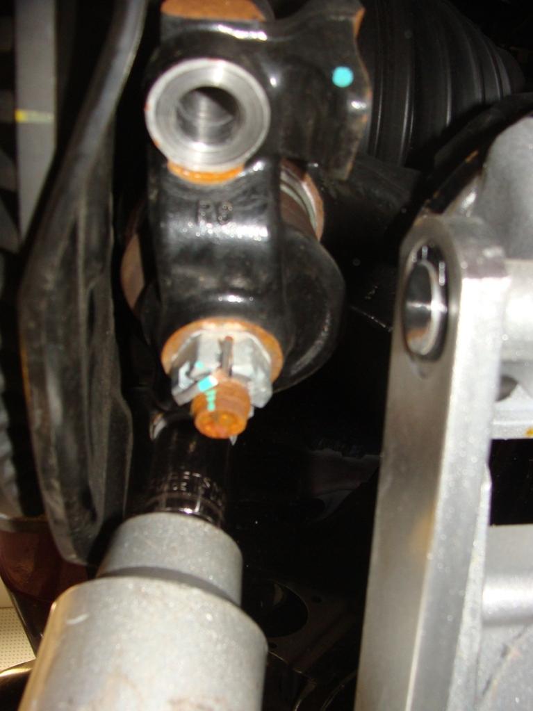

OK- I went back and looked at your pics and this doesn't look right to me on the pass side. I think that lower bolt is out in this pic. If only the shot were an inch lower! Compare it to the drivers side... I think that's it. If it is indeed the case, you may have a damaged CV joint now (or worse), make sure you engage 4wd to check it out. BTW- the 160 in the diagram is the bolts torque spec, not an ID. I hope this didn't cause any more damage to your drivetrain, if the other bolt had fallen out it would have been a catastrophic failure; Very dangerous. I would be PISSED! Good luck with getting reimbursed for this ( that's what i would demand)!!
Looked through my pics and found this one of the passenger side. It appears to me that the same bolt seen on the driver's side pic is missing.
Resulting in the R front wheel looking like this on full lock
And you are correct - this would have been a catastrophic failure. The dealer mentioned this. The CV boot looks a bit crumpled on that side - hope this is nothing more involved, but all bets are off now.
