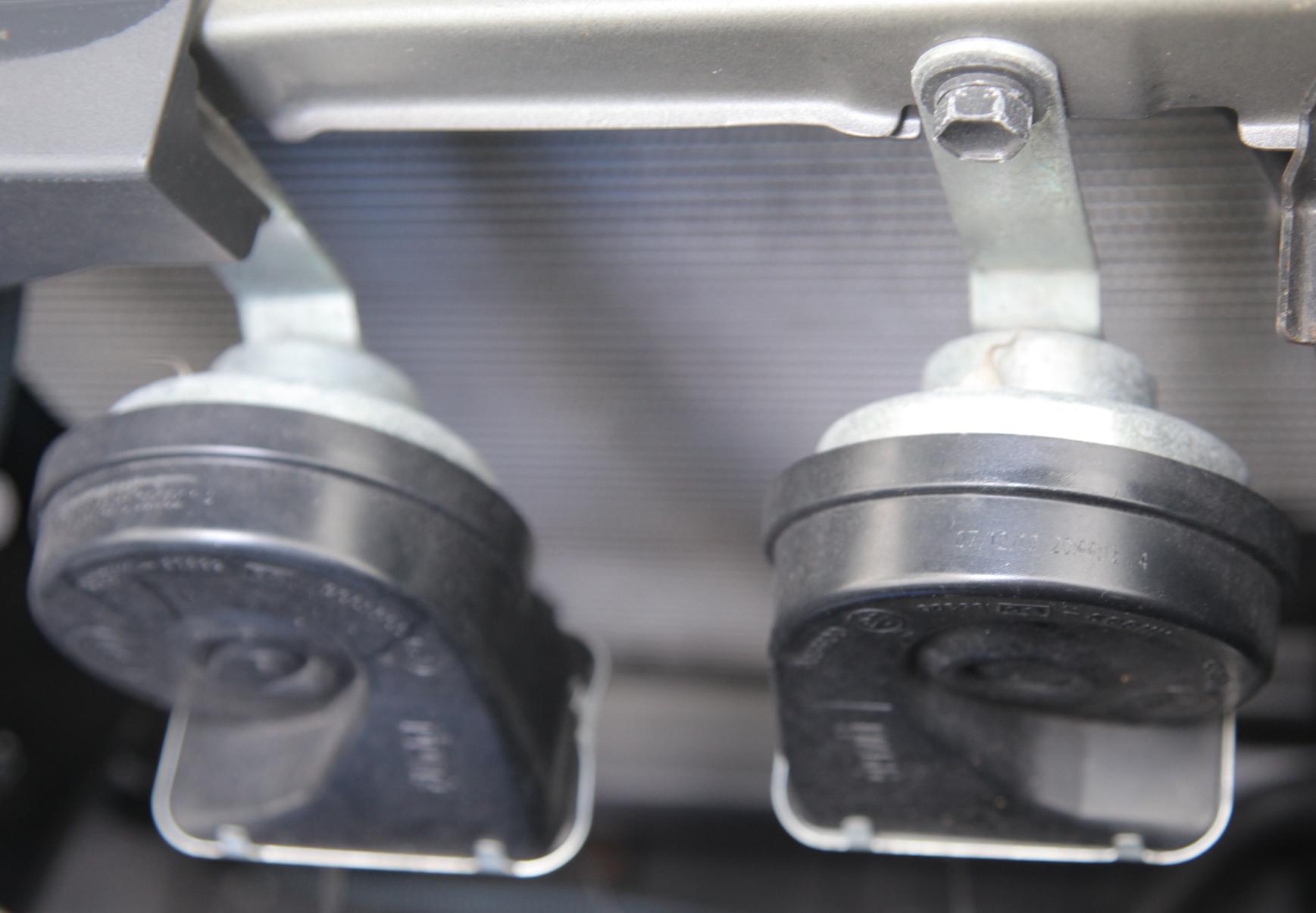

This hopefully will help with a swap out of the Fiamm horns a few other guys have used here.
Overall this a simple, inexpensive fix to an annoying problem.

One picture shows all the parts laid out on the floor.

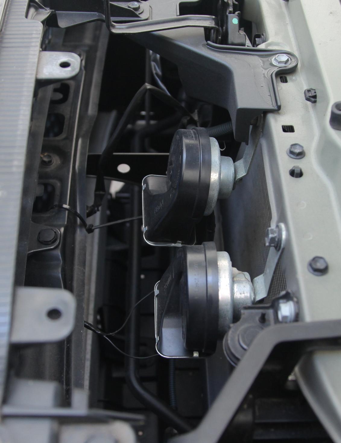

I used the bracket in the middle (directly under the hood latch 8"-10")to hold the horns, there was a hole already in the bracket which worked great, the original location would not fit two horns together.
Next I wired the the two horns, test fit the brackets, insureing the horns were pointed at about a 45 degree angle to the ground...don't want any water collecting in there.
I took a rat tail file and made sure the bracket and screw had a good groundMetal to metal). Installed a 3/8" bolt with washers, and tightend the whole mess down. I touched it up with a coat of clear spray.
Snapped the hot lead for the original horn onto the new blade connector, gave a wrap of electrical tape for protection, tested (worked!!....dont know how in the hell that happened....) and istalled the cowling back on.
One note..the clips seem a little tender, when I re-installed them I grabbed them by the outer edges and pushed gently down until the center button popped back up...then I kind of remolded them wih my fingers, popped them back in the holes, and pushed the center down till it locked....peice of cake.

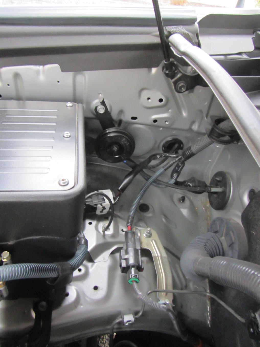

...but I found 3 horns in my '10 Limited.
I found 2 horns side by side in front of the radiator and a 3rd horn (at least it looks like a horn) next to the air filter box. I had to move this horn when I installed my aFe CAI.
Does anyone else have 3 horns, or have a horn near their air filter? The aFe instructions indicated that if there is a horn there, then you'll need to move it.

There was another threaded hole just down a little. need to reverse the bracket and install at a bit of angle.
Hope this helps.

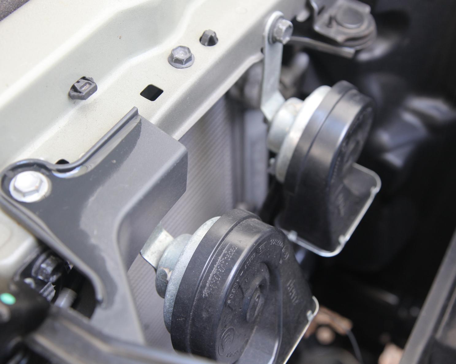

Thank you to ALL.... I got my horns finally installed. I got EL Grande from Amazon as well and made my wires in to "Y" type with "quick connect" to connect both horns to original connector. I also removed hood latch plastic cover and installed one horn and installed another horn at previous location as stated in tread. Very easy and it took me about totol 30mins to prepare wiring, take the cover out and to reconnect and to final check. I have TE and only have one horn but both horns are getting very good attention from the traffic. Thank you all. Love the sound of my horns now!!!
I owe you guys some pictures of FIAMM EL Grande horns installed in my 2010 TE. It was indeed very ez to follow and install. I installed them sometimes ago in Sept of 2010 and no one can ignore me on NY's "always congested" traffic. :driving: Happy Holidays, y'all...
