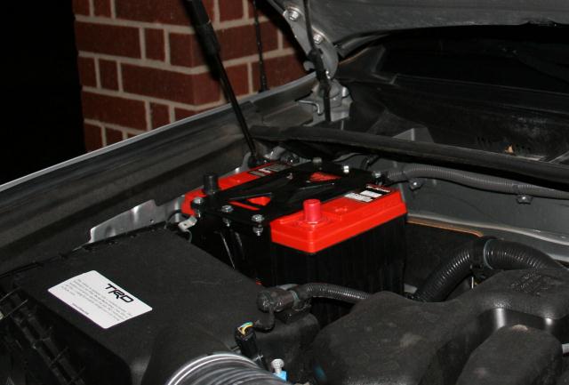

it's a start
I got the second one stuck in there:
I will start a new thread, maybe, in a couple of weeks.
