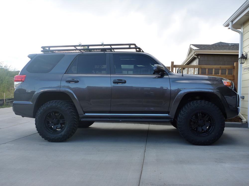

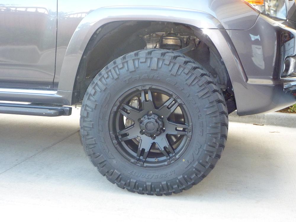

I want to thank snow&surf for finding these bad boys and putting them on his truck. I saw them and fell in love. I was already in the process of downsizing wheel size and saw these and knew they were the ones.
The wheels are Ultra Gauntlets 17X9 with a -12mm offset.
The tires are Nitto Trail Grapplers 295/70R17.

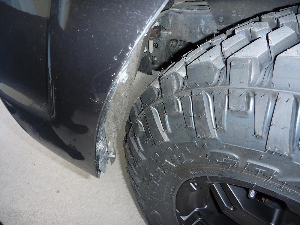

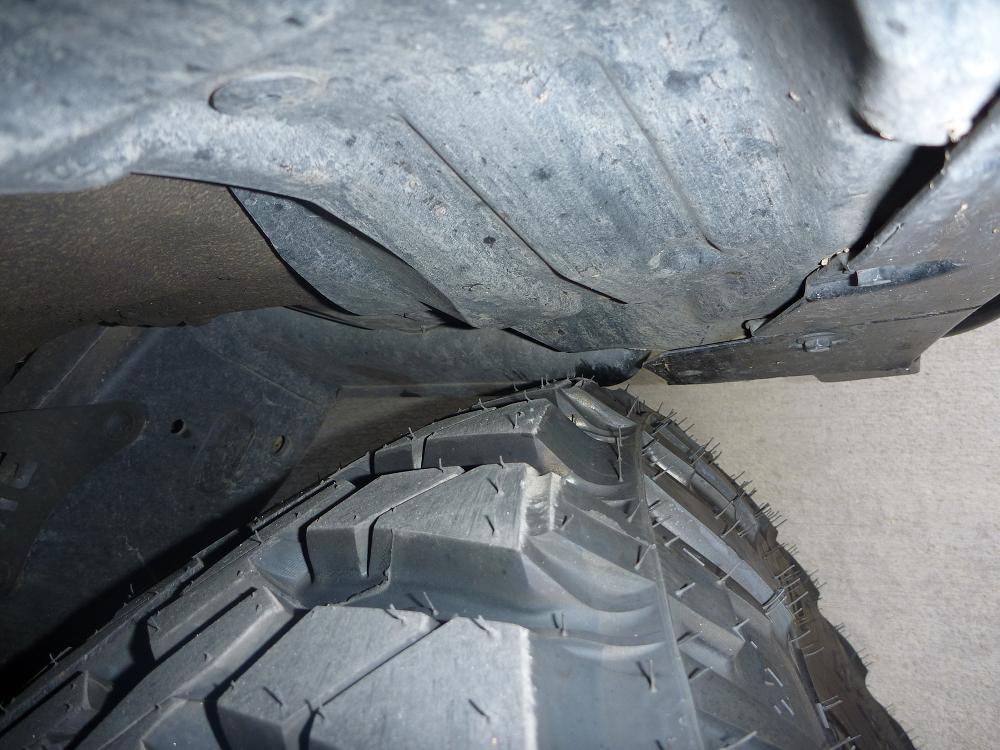

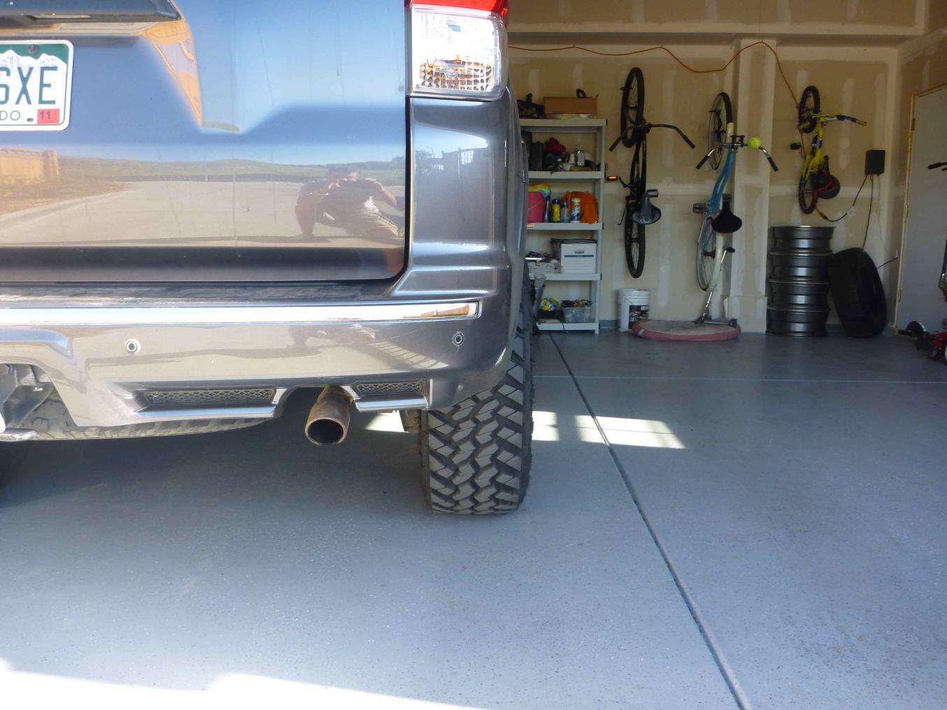

These puppies are big, much bigger than my old 33's. If you look in the rear clearance pic you will see I am hitting the body mount. I think this may need to be modified, exactly like the body chop that you do on FJ's. Not a big deal since I have already done it in order to get 35's on my old FJ.
I ordered Icon remote res. CO's and Camburg UCA's which should be here soon. There is a chance that by getting a little more lift in front I can get away with not doing the body mount chop. Only time will tell.
After having these on a couple days I am definitly going to love the new UCA's. The tires are just much bigger and heavier than my old rims and tires and the UCA's should do a better job controlling them.
Anyways keep you guys posted on the lift install. Just wanted to share some pics.

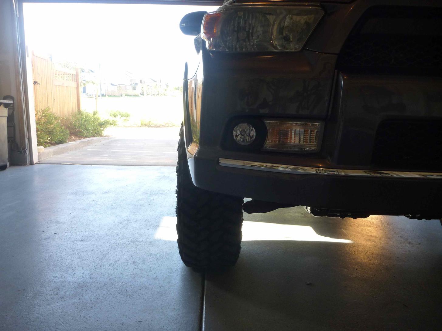

PS- Don't know if you can tell from the pic but took about 3 inches off the front bumper! I think it looks better, solved some rubbing issues and I dont really care about it because that ugly thing is coming off as soon as I decide between Demello or ARB.

Finally someone who loves this wheel/tire setup as much as I do!!!! :party:
Looks mean as hell BFLAN! Your truck will not only perform well off-road, but it will turn heads and get compliments everywhere you go! Believe me, I know!!!!!!!

Love it, dude. That looks absolutely awesome - I love how they looked on Snow&Surf's ride and I love the 17s look too.

I'm going back and forth between the ATX Artillery's and the Gauntlets. As much as I like to burn a new trail, those wheels look too good.
Can't wait to see what they look like on a black runner.
Great job, looks awesome.

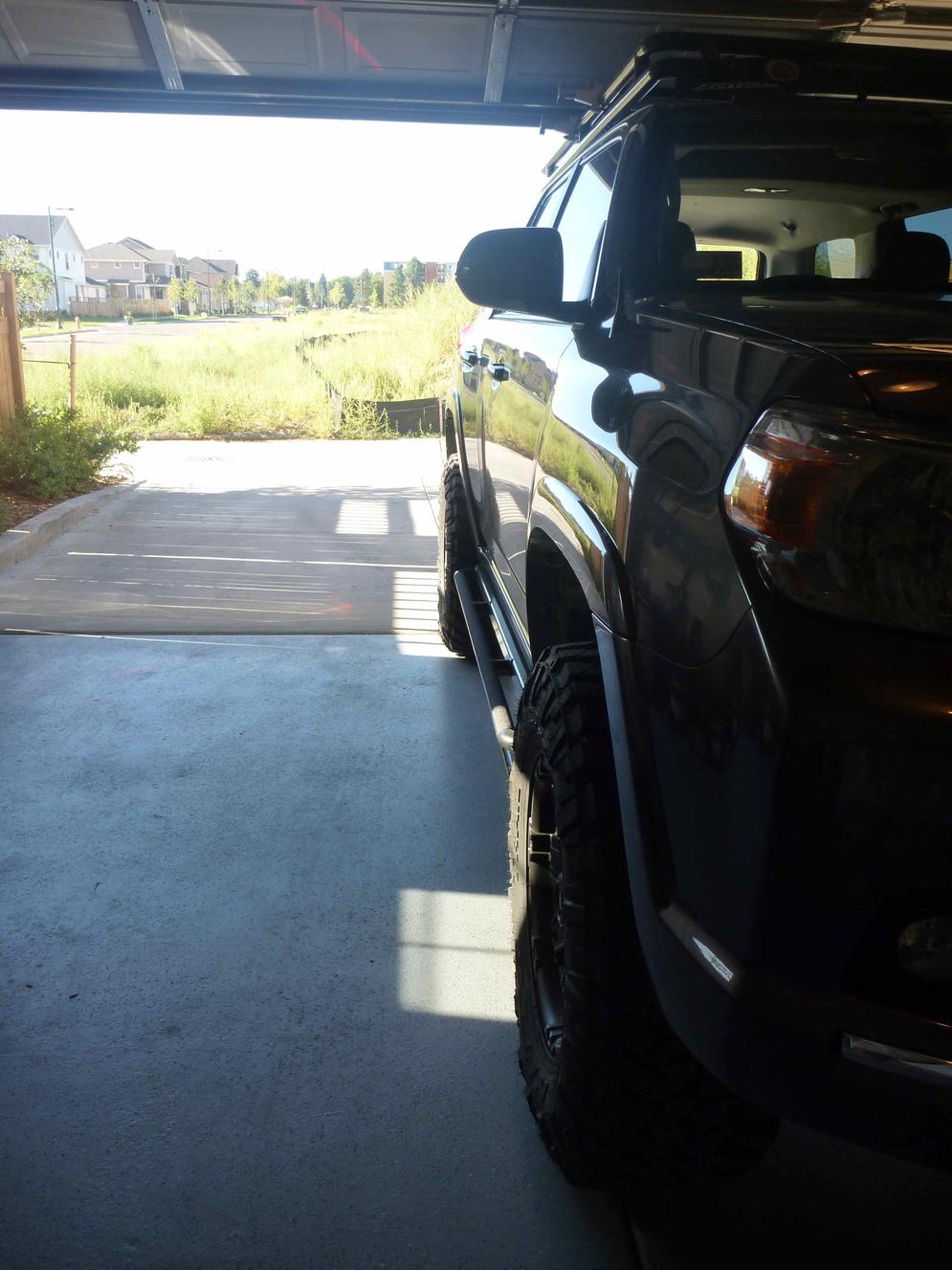

BFLAN, any chance we can get a shot from the front / rear of the truck? I'm interested to see how far they stick out. Thanks!
Ask and you shall receive :)

Are you gonna chop that body mount at all? It looks like it will tear your tire up over time, plus thats just when the wheel isnt stuffed at all.
edit, I see you already have it covered. they look tight, once you get rid of that spacer it'll be all that much better!

Bflan those tires look sick man i got the exact same ones(Nitto Trail Grapplers 295/70/17) order but i putting them on stock rims do you think i will have to do any cuttin on my 2010 Trail Edition 3" Toytec Coilover lift
Thanks.
Yes definitly! I chopped the body mount today, just made me feel better having it out of the way, a lot more room behind the tire now. I also took alot out of the front. I had trimmed for my last set of tires and had to trim again for these. However, the front clearance wont be an issue if you get a new front bumper. You can make it work, just think about it twice and cut once :)
@ cgill00 - BFLAN is right, you will need to trim the fender liner. my grapplers are 33" and I needed to trim about 3" of liner almost all the way across the fender to stop the rubbing with the wheel are full lock. both yours and BFLAN's are 33.5" so there's no way around it. in regards to the body mount, my tires have about 1/4" clearance at full wheel lock so no chop was required, while BFLAN's pics showed rubbing. something to think about.
and the size of the grapplers is no joke, they are true to Nitto's spec sheet. pics do these tires no justice!
BFLAN, do you mean that you just took that spoiler off the bottom of the front bumper? Or did you actually chop higher than that? Can you post pics of that? I really want to improve my approach angle without doing the Harper7 TE mod...but not sure about chopping in that area...would like to see...thanks! Like those sliders too! BTW, Your truck looks NASTY!
