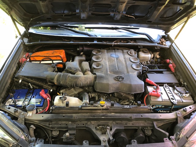

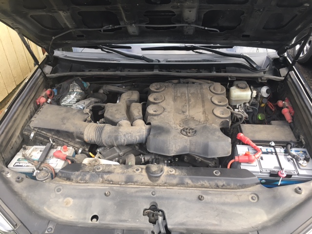

One more picture of the whole thing completed.
http://layton.org/t4r_org/img_b0722.jpg
I just need to put the air damn back in place and I'm good to go!!
I now have plenty of juice with a group 31M main battery and a group 65M.
103 Ah and 1150 CCA for the 31M
74 Ah and 930 CCA for the 65M - made by Northstar X2 Power
A small upgrade from the group 34M that I had installed
60 Ah and 850 CCA
Next time instead of getting in a hurry and buying from batteries plus I will order another 65M direct from Northstar. My OCD with the colors not matching might get the best of me...

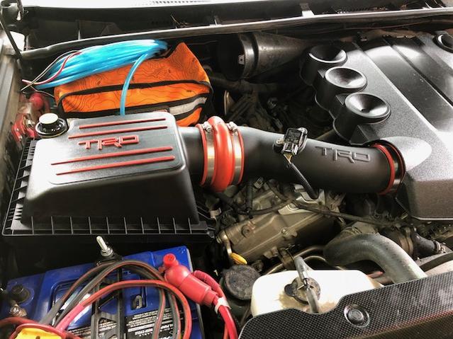

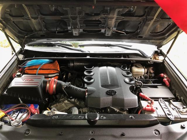

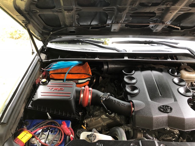

Decided to pull the trigger on this, purely on the looks aspect. I've been reading all the other install threads and just decided I like the way it looked enough to justify the cost.
I installed it today 4th of July because the wife and her honey-do list was getting out of hand. I figure what better way to celebrate the fact that my T4R just rolled over 100,000 miles than to install this. The nations birthday we can celebrate tonight and the honey-do list, well let's face it, it will always be there and will never be done.
A few things:
1) Your 4Runner already has the exact same type of CAI as we are installing. Intake air is sourced from:
EXACTLY THE SAME HOLE IN THE ENGINE BAY TO THE FENDER WELL as you are using now.
2) I did it purely for looks as stated above (I can afford it!)
3) Perhaps a little better MPG's will be a bonus
4) Perhaps a little better clearance for my second battery (65M) would be a bonus (:mad:negative on this, it's the same clearance)
5) I don't care about the possible extra HP or extra noise.
6) Read the other install threads and videos firsts. If you read thru them all you won't even need the instructions.
7) If you are going to do this, DO NOT buy the kit for $400+, order the parts separate and save yourself $150+ (yes, that is what I did) Conicelli Toyota of Conshohock | Genuine OEM Toyota Parts Use code (EBAY10) or (SHIP20) or (WELCOMEBACK10) for a discount.
Below are the part numbers you'll need.
  • PTR03-35090-AA
  • PTR03-35090-AF
  • PTR03-35090-AC
  • PTR03-89100-AA
  • PTR03-89100-AB
  • PTR03-34071
8) Silicone lube spray is for wimps, you don't need it.
9) If this takes you more than 2 hours to install, I suggest a career change, perhaps maybe even some night school. I was done in less the 1.5 hours and that included cleanup, washing and ArmorAll'ing all the other plastic parts under the hood so they looked as good as the TRD CAI did. This is an easy install.
10) I did fill the little hole in the side of the lower air box with the plastic plug from Lowes, because it was simple to do.
11) I DID NOT fill the elongated hole in the bottom of the lower air box with anything. Let it breath a little 1/4" opening of supposedly warmer air...who f'ing cares?
12) If you are worried about extra noise don't be. I can barely tell the difference. (IT DOESN'T HAVE A FRIGHTENING ROAR, as others have stated)
12) I have no whistle as others have stated in other threads.
13) It does feel a bit more responsive on the pedal.
14) I'm using the stock size 4runner K&N oiled filter...but we will see
15) It did not die on me on the first startup after install as others noted.
One last note, it looks better in pics than it does in person. I'll update this post after a few tanks full of gas and report back on mileage in a couple months.
**Update**
7/11/18
- I've had it installed for a week now. It is louder than my initial reaction of barely telling the difference. Not a deal breaker, no one else has mentioned it so I think I'm just listening for it right now. Bottom line is if had come this way from the factory, I probably wouldn't even be thinking about it right now. It's just that after 100k you kind of get used to how things sound. It's different now. I'm sure I will get used to it.

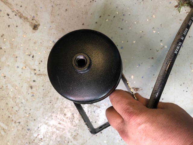

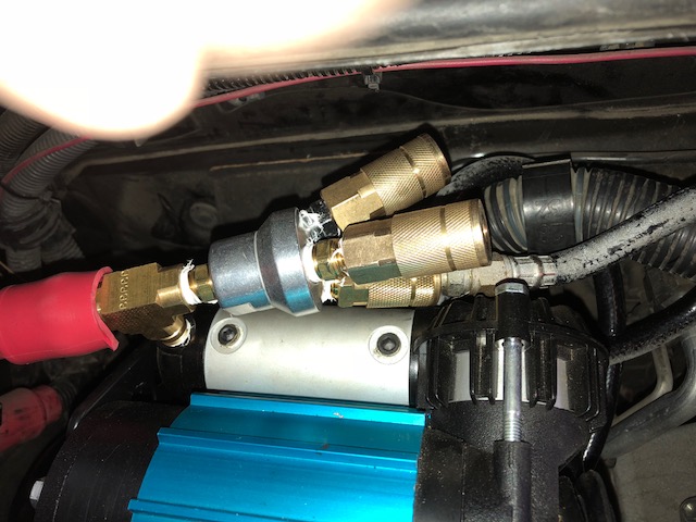

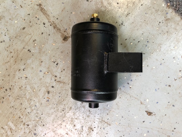

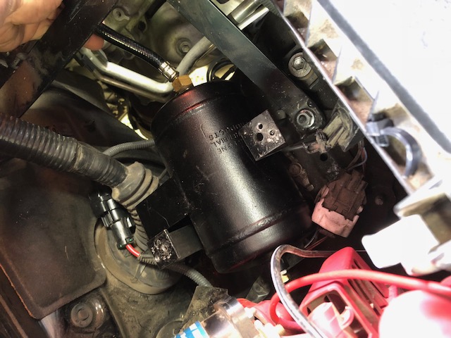

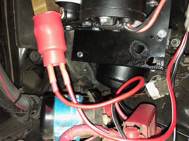

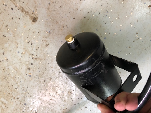

ARB Compressor Install Update
After running my compressor install for a year, I decided I needed to make an update. It worked great the way it was, but I decided I needed to add a small tank and the pressure shut off switch. If you missed my original install check here
So I bought this tank from amazon
I pulled the compressor and made a test fit underneath. It fit just fine after I removed the wire harness bracket underneath. I simple removed the bracket and rerouted the wires with a zip tie so they didn't require the bracket. The created enough space below the compressor that I could fit the tank.
For now I just zip tied the tank down to get everything in place an test it for a bit. I moved the power switch then promptly broke it so I need to get another one ordered and installed before this is complete.
I added the pressure switch into the harness and for now will just use the quick connect to power it off and on.
I added a few air hose fittings on the compressor and attached the tank directly to one of them. The air hose is too long, but it was the shortest one I had on hand. Until I get the replacement power switch it's fine. Once the switch shows up and a shorter hose, I will swap them out.
Now I have a small buffer of airtank and no pop-off valve. Once the tank reaches 100 lbs the cutoff switch kills the power to the compressor. When the pressure falls below 70 it kicks back on.
It all fits nice and neat under the bag just like before and you would never know I had a small tank under there.

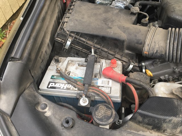

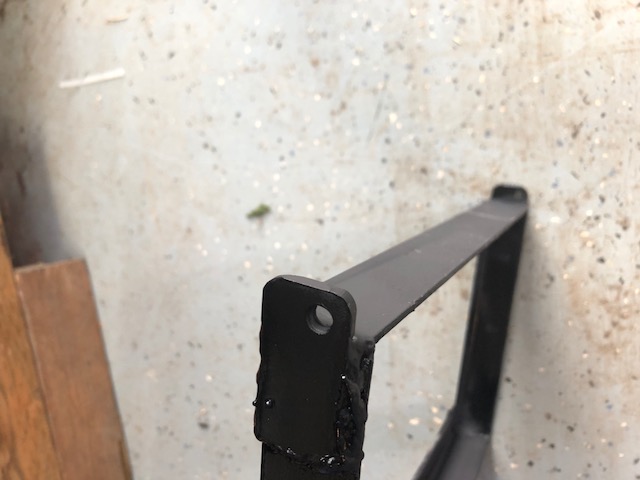

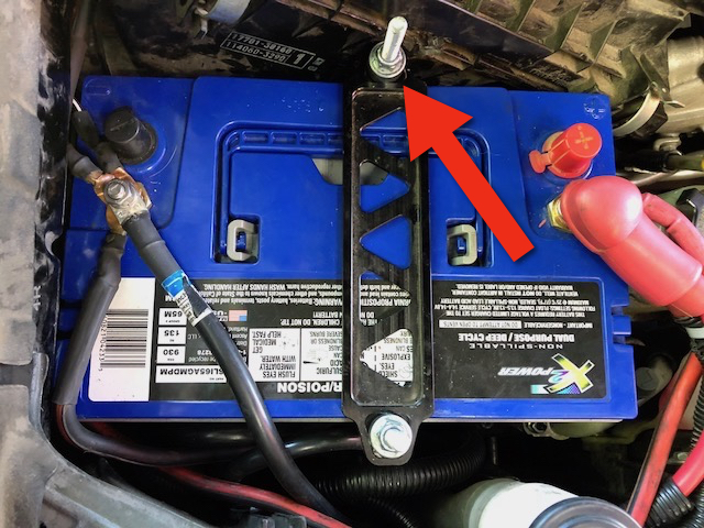

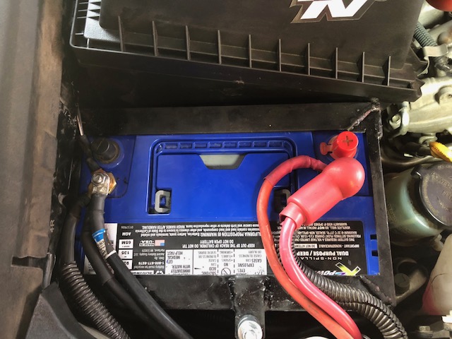

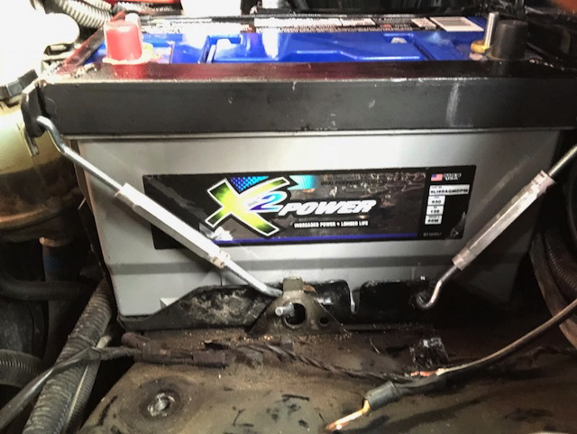

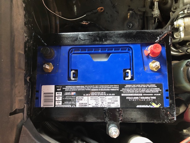

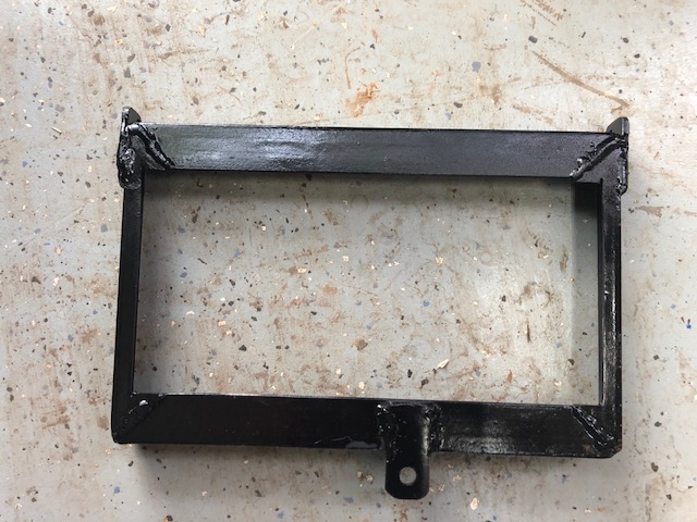

Custom Group 65m Battery Tie Down
A while back I installed a new second battery. I replaced the group 35m with a bigger group 65m battery. You can see the details here --> Dual Battery Upgrade
It's a pretty tight fit and I wasn't really happy with the battery tie down situation. You can't really see it very well, but if you look at the RED arrow in these two pictures, you can see where the problem is. The new battery is pretty big and the airbox is crowded up next to it. The tie down sticks out about an inch from the edge of the battery.
It jams into the side of the airbox and actually deforms the box because it's so tight. This happens with both the standard factory airbox and the TRD CAI. One of the reasons I installed the TRD CAI box was to see if I could gain some more clearance space in this area. (The answer is NO, they are the same basic size)
After looking a multiple battery boxes and tie downs and finding nothing that will hold a group 65m I decided I needed to make my own custom tie down and a custom way to tighten it in place.
I fired up the welder and the cutoff saw and whipped up a bracket to hold my 65m down. I added a couple of tabs to attach my bolts and turnbuckles to. I'll spare you all the in progress pics and just show the finished product. The welds aren't perfect but not bad for a weekend welder.....
This custom bracket form fits down on the 65m battery. I actually have to install it on the battery before I lower the battery into the engine bay, because once the battery is sitting in place there is very little wiggle room.
Then I installed the turnbuckles I picked up from the local hardware store and tightened them down. The airbox actually tapers away from the battery below the lid, the battery also tapers away from the airbox, so these turnbuckles being down low aren't even touching the airbox. It's only above the height of the battery where the traditional tie down bolt would be is where the conflict is.
Here's the finished look, now the airbox is flush along the length of the battery and not deformed. I cranked down the turnbuckles and the front bolt tight and this battery isn't going anywhere.
A couple of minor negatives still:
To remove the battery, I have to pull the airbox. (completely remove it)
The bracket for the turnbuckle on the engine side still hits the airbox. Since taking the pics I cut the upper half off leaving just enough for the turnbuckle to grab. It's better, but if I ever decide to remake this bracket I will drop that tab down another inch to get more clearance.
Still 100% better than before with no deformed airbox or rubbing.

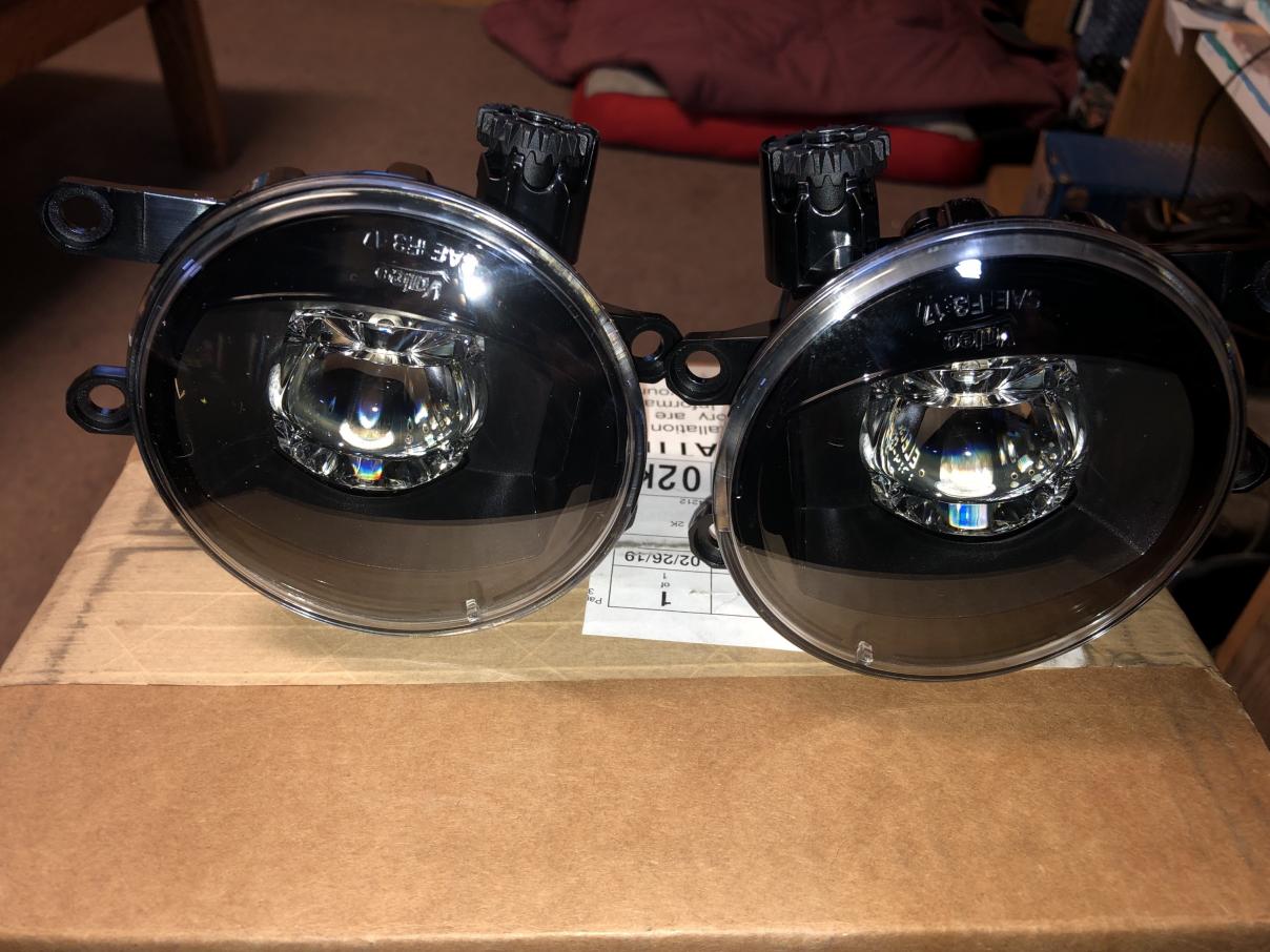

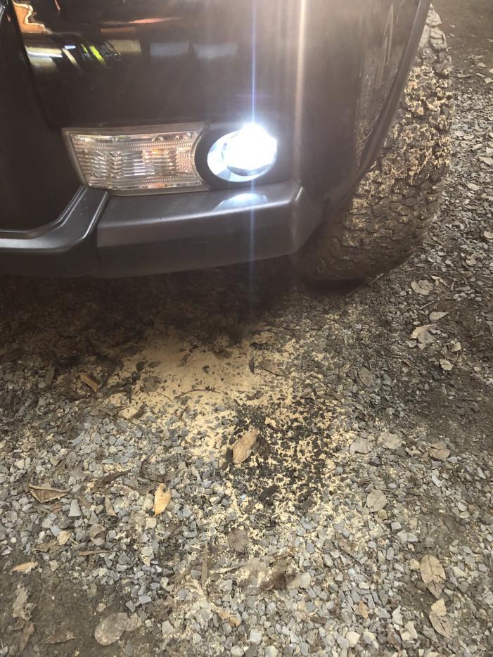

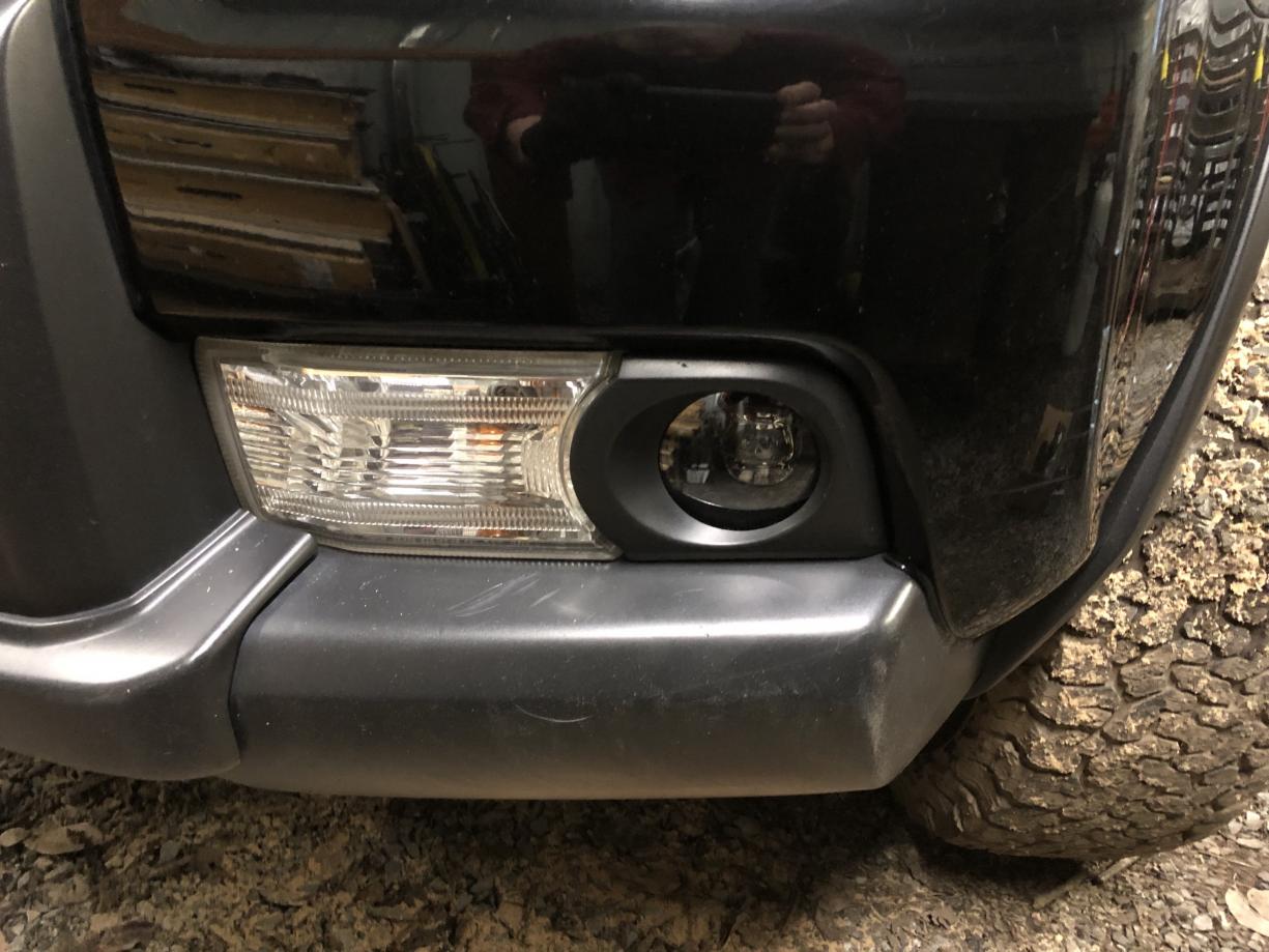

Toyota OEM LED fog lights
I'm installing these shortly - More Pics to come

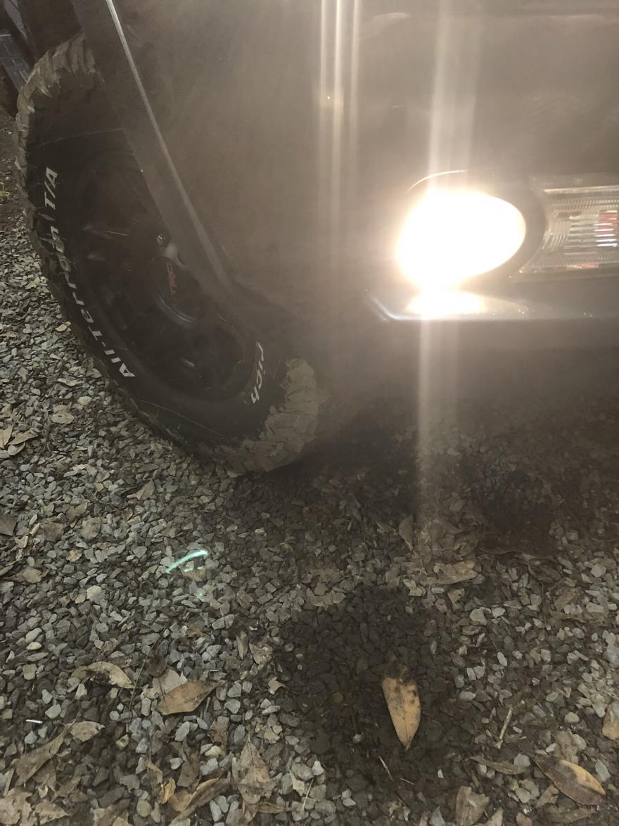

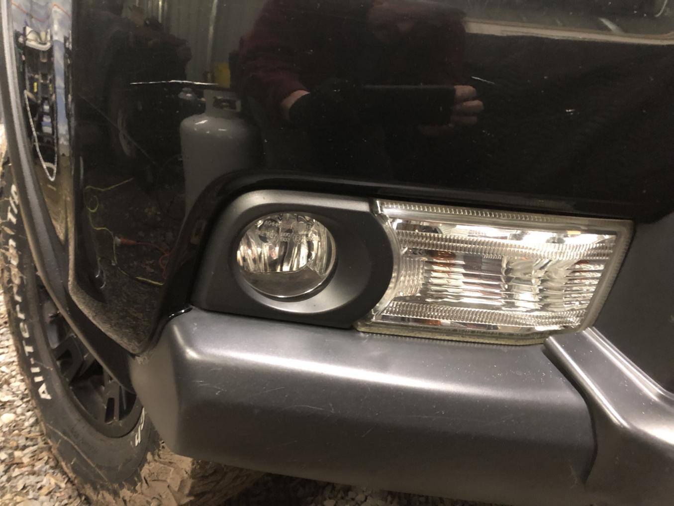

Toyota OEM LED fog lights - Part 2
I can confirm that these will fit a 2011 Trail. (Not perfect fit but they fit close enough)
Probably the same for all 2010-2012 models before the snout change.
I can confirm that this can also be done WITHOUT removing any part of the fender liner, reaching up from underneath.
I can confirm total install time of 30 minutes or less which includes taking 12 before/after/comparison pictures.

Tools needed one (1) short Phillips Head screw driver. These are held in place with 1, yes ONE 3/4" long Phillips screw on the outside edge.
The 2 tabs on the inner edge tuck into the bumper plastics.
They are made very similar to the original fog housings, but just a tad different angle, so you might need to wedge them in a little bit to get them in place.
Front glass doesn't fit as close to bumper plastics due to the slightly different angle, but no one will notice but you.........

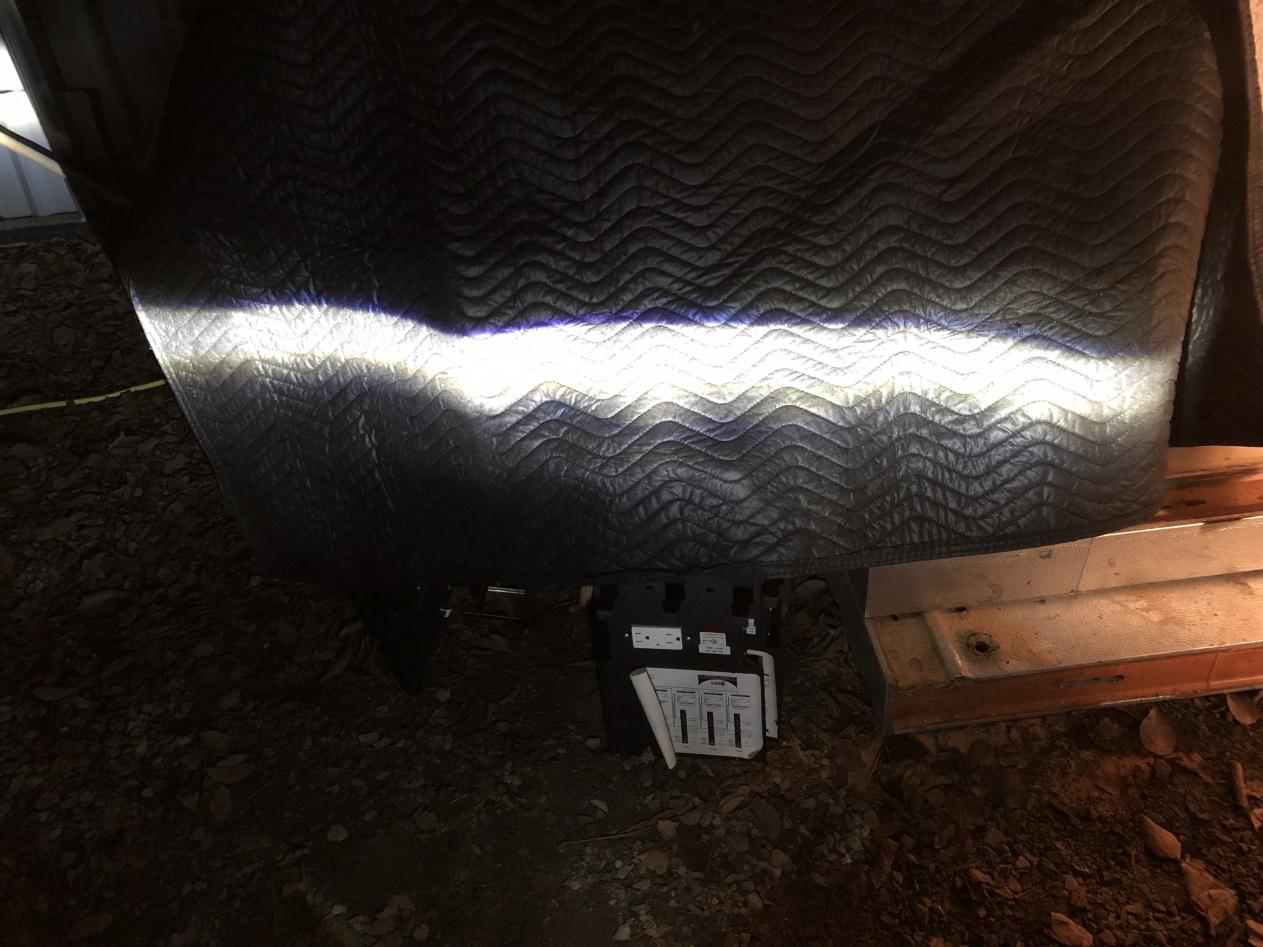

Here you go! First 2 pics are the drivers side with the new fog light installed. The black blanket is about 5 feet away.
The second 2 pics are the original fogs on the passenger side.
You can see the difference in color and spread pattern for sure. The adjustment screw on the new fogs only moves the line up and down it does not spread the pattern. I left it as shipped but will change the angle if needed. It was pretty close to the same height as the passenger side so I might be good to go.
Here's a couple of comparison shots. Drivers side installed, passenger is the original
