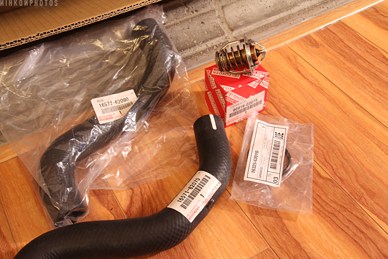

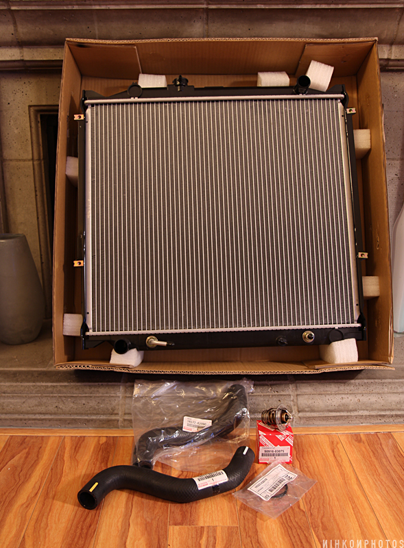

I had picked up a new radiator quite a while ago. It's been another one of those parts that has just been taking up room in my garage as I lag on installing it. lol!
Well, I finally ordered the rest of the parts to go along with the new radiator installation. New parts from Toyota include: upper and lower hoses, thermostat, water inlet gasket, and radiator cap (new new Denso radiator didn't come with a cap.)

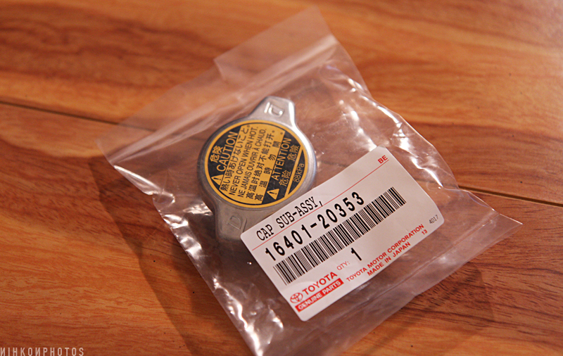

I forgot to include it in the "group shot", but here is the new radiator cap:

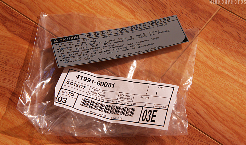

While I was making my order with Toyota, I decided to also get the diff. lock decal that's on the driver side door card. My current one is faded pretty badly.
Of course, none of these parts are installed yet. lol

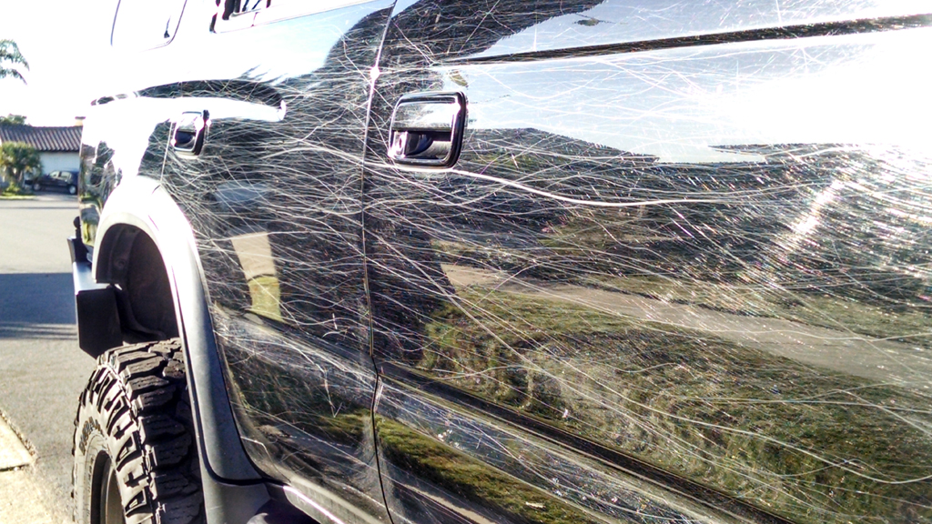

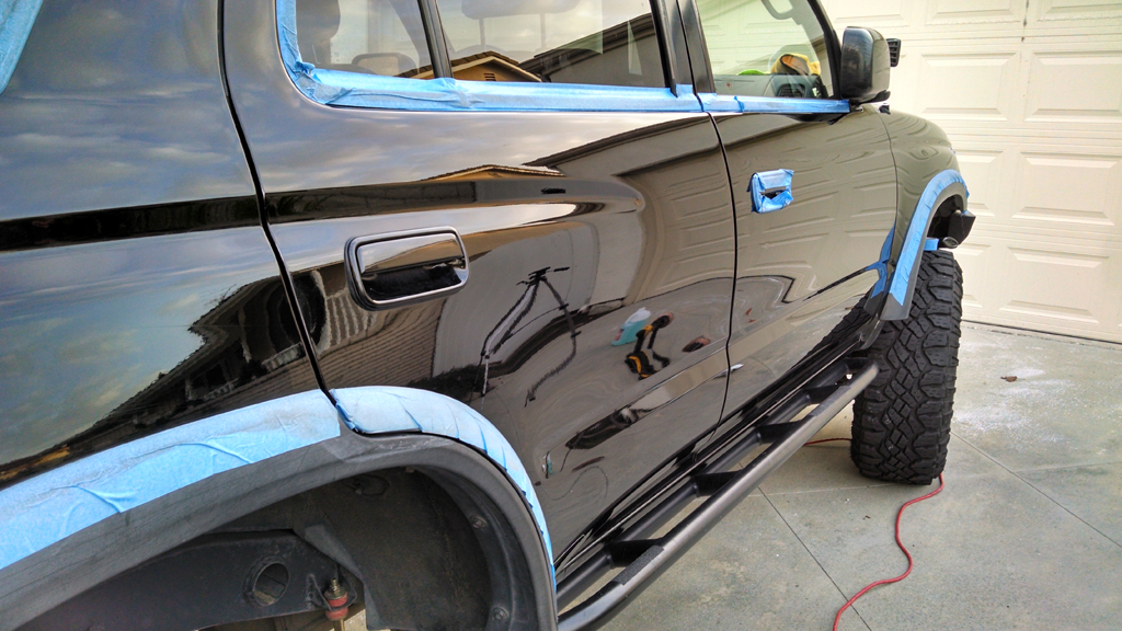

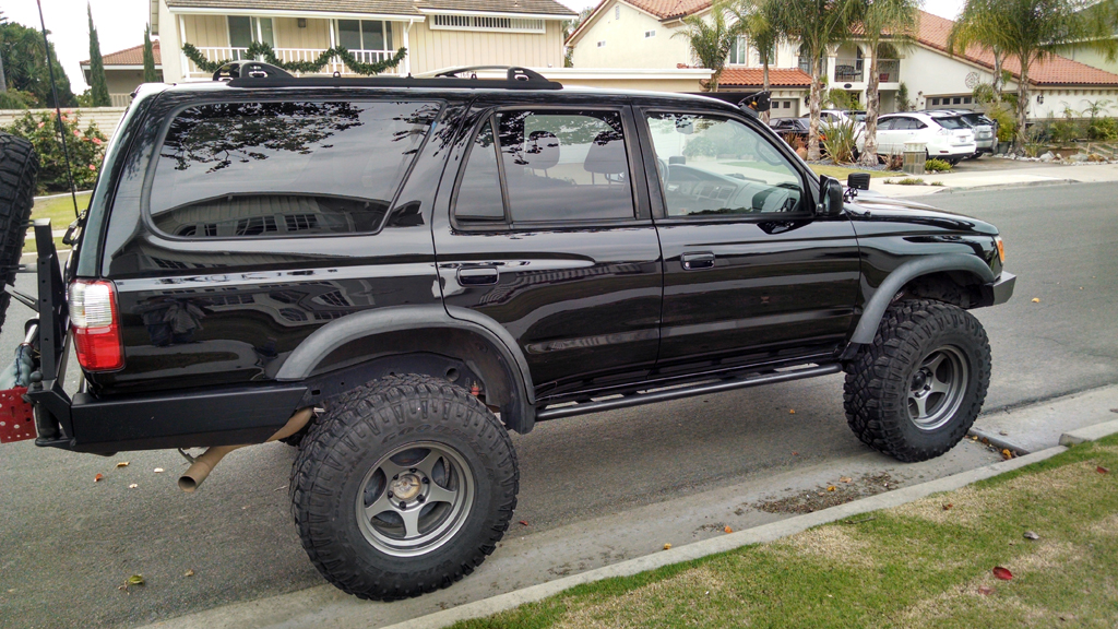

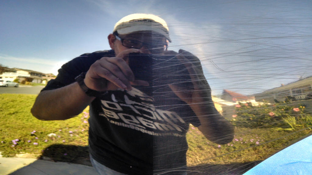

If you guys remember, I had some pretty gnarly pinstriping. A good friend of mine has gotten into automotive detailing, and he put some elbow grease into one side of my truck.
Here is the before:

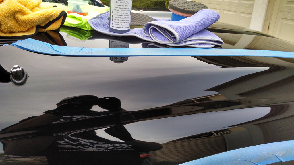

And here are a few photos from during and after he worked his magic:
I gotta say, I'm pretty stoked at how it turned out. You can still see some light scratches. But it looks 100 times better than it did before. And it's soooo smooth. The only drawback now is that when we go wheeling, I get nasty comments from him on the walkies when I rub against shrubs or when I get too close to rocks. lol!

geez thats a killer job on the detail. I really should do that to my truck haha.
trail also looks like a blast! I could go for some mud, all we have up here is snow!
You've got a super clean truck! I love black 4Runners. I'm amazed at how many scratches he was able to get out, it's a night and day difference. Looks like you guys had a good time at the trail. Was the only damage to that Tacoma the tire popping off the bead? In that picture it looks like he should have more damage than that...

Loving the ODL front bumper! Also, thanks for putting up pictures of all the OEM parts like the diff lock decals and all that. I've been planning to buy all of these "it's all in the small details" parts. :D

These 4Runners , at least in black came with a good amount of clear coat. I assume he used a combination of a buffer, Ultimate Compound and then Wax.

Get the parts while you can dude. Who knows how long this stuff will be available. Getting oem parts for my 23 year old CRX is a pain in the ass!
Here's my buddy's rundown of what he did to with my truck so far:
Lil_Gravey said:
After receiving a fairly "clean" truck, next up were the following steps:
Detailing is done one section at a time (i.e., a door, followed by another door, fender, etc)
- Rinseless wash - One section at a time to ensure a clean surface.
-- Products:
---- Optimum No Rinse (ONR) diluted as per instructions for rinseless wash
---- Microfiber (MF) towels (good ones) for washing and others for drying
- Clay bar treatment - to remove any above surface contaminants
-- Products:
---- Have used mainly the SmartWax clay bar (blue in color). There are cheaper alternatives
---- ONR diluted for acting as a clay bar lubricant.
---- MF towels to ensure a dry surface
- Compound step - To remove the paint defects (scratches and such). # of passes depends on the panel being worked
-- Products:
---- Portercable (PC) Dual Action (DA) polisher
---- Hexlogic Orange pad (medium -heavy cut foam pad)
---- Meguiar's M105 Compound
---- MF towels to wipe of residue as you move along
- Polish step - To further enhance the surface, and to remove any marring left by the compound step
-- Products:
---- PC DA
---- Hexlogic White pad (heavy polish foam pad)
---- Meguair's M205 Polish
---- MF towels
---- NOTE: This polish step was skipped due to the nature of the off road vehicle being worked on. Knowing it was going to be getting scratched again, it was decided to focus on removing the lighter scratches, reducing the deeper scratches, and then moving on to the glazing step)
- Glaze Step: To add some "filler" for the some of the scratches left behind. This improves the look of the surface
-- Products:
---- PC DA
---- Hexlogic Blue pad (glaze foam pad)
---- Poorboys World Black Hole
---- MF towels (better than what is used in prior steps)
- Wax Step - This provides some protection from the elements. Helps with making washing easier too
-- Products:
---- Foam applicator pad. (yellow foam, MF pad, whatever will lay down the coat of wax evenly without scratching)
---- Poorboys World Liquid Blue Natty
---- MF Towels (even better/softer)
No special tricks. Just some patience and decent technique. No rotary tool used (well, in some smaller spots I use the Meguiar's DA Power System attached to a drill. This is sort of a "forced rotation" DA system)

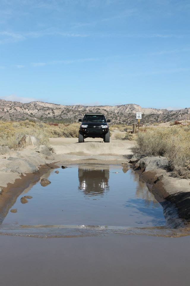

Here are a couple photos from the same trail (Cleghorn), but back in September.....when it was much warmer, and much less muddy.
