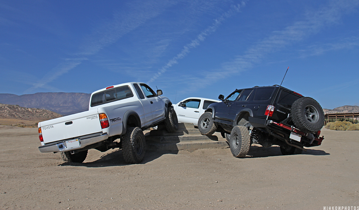

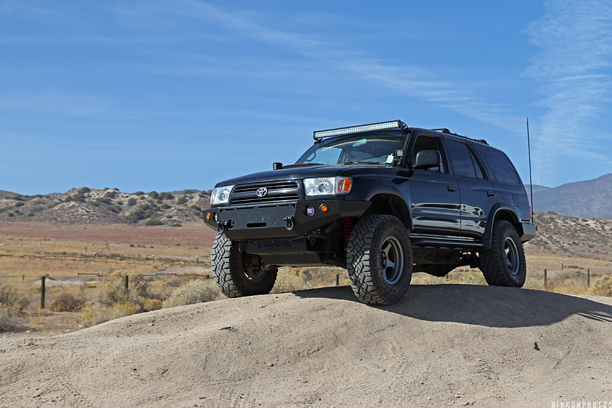

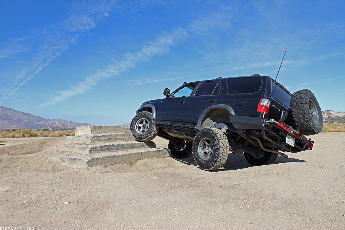

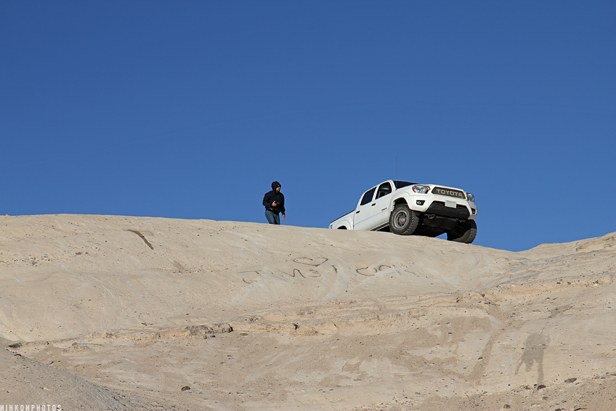

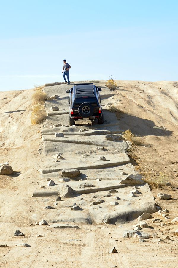

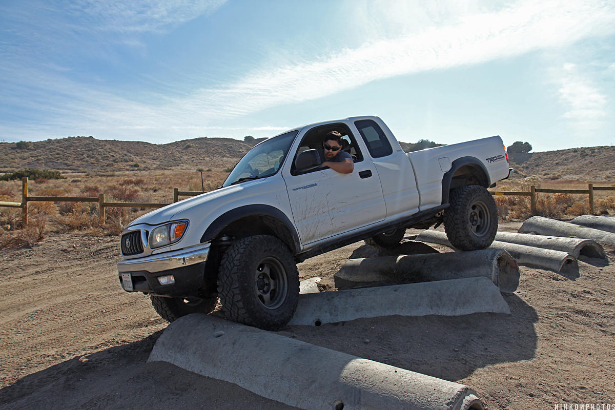

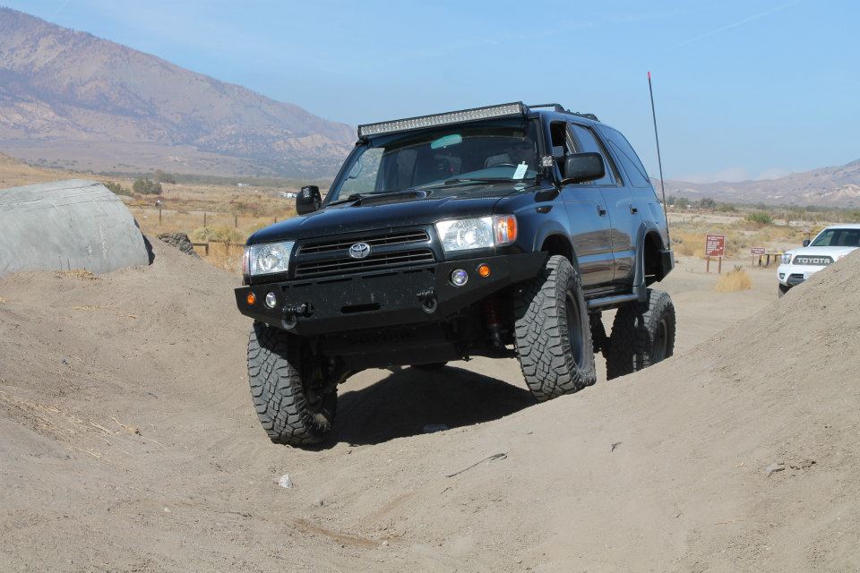

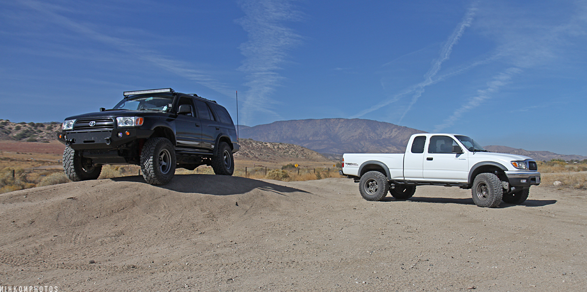

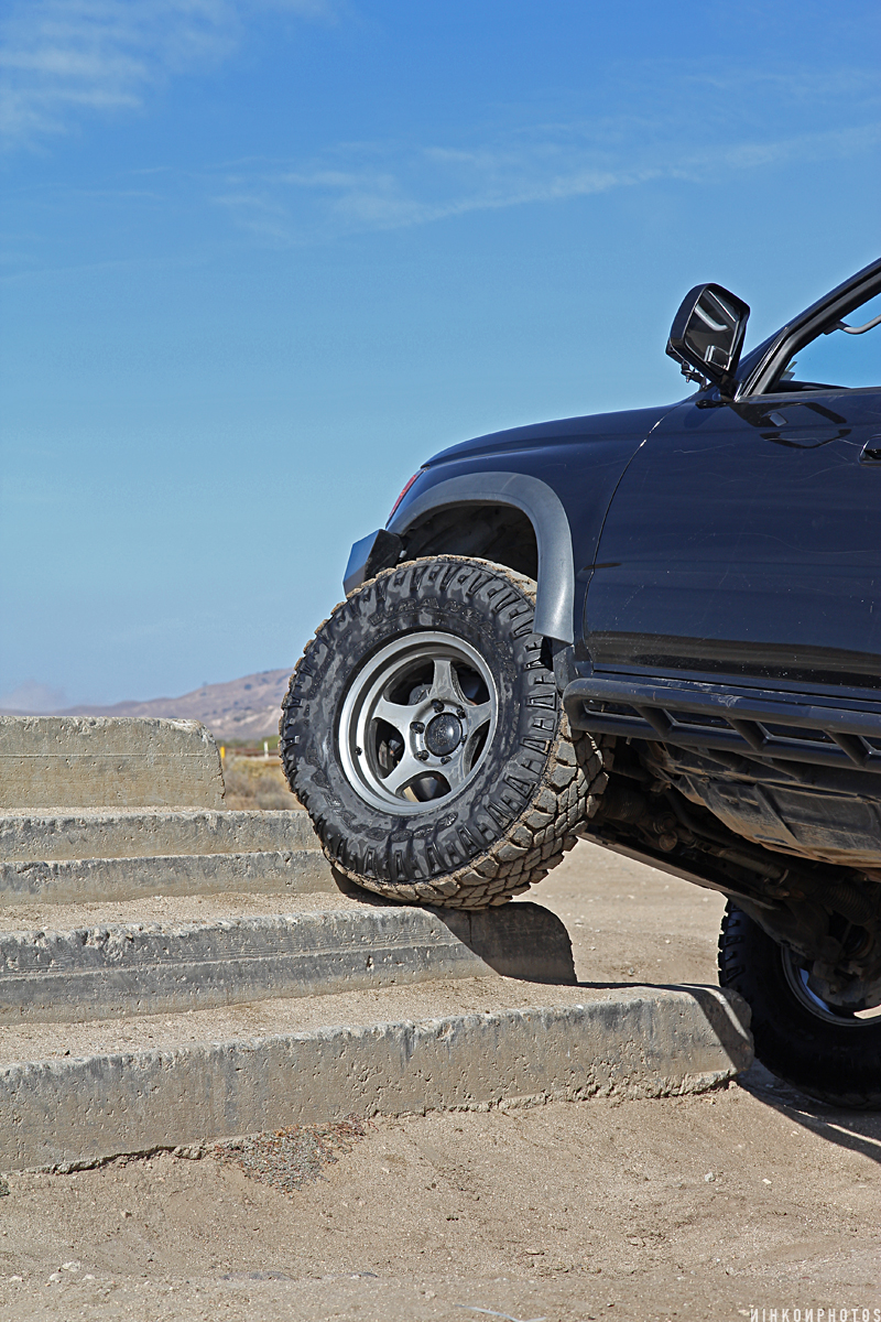

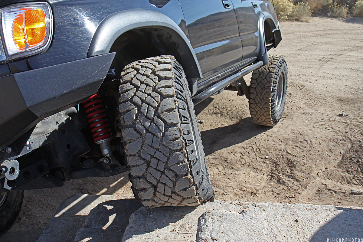

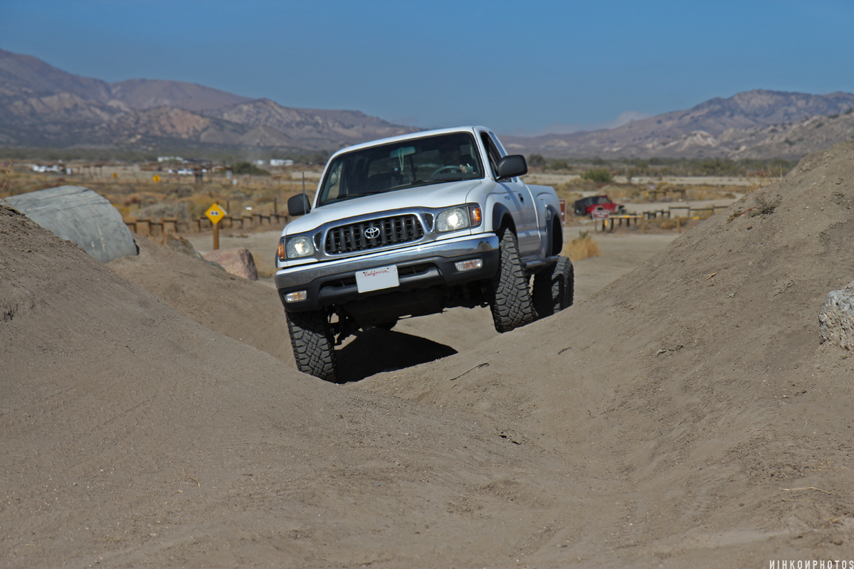

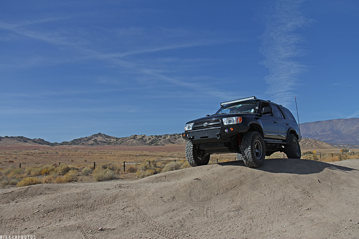

Here are some more offroading photos from this past year....
These were from back in November, at Hungry Valley SRVA in Gorman, CA:
Thanks!
Other than popping the bead on the tire, the Tacoma also went home with a few scratches along the side of the truck that was against the dirt, along with a bit of a dent in the rocker panel and lose front fender flare/much guard. Nothing too bad considering what he got himself into.

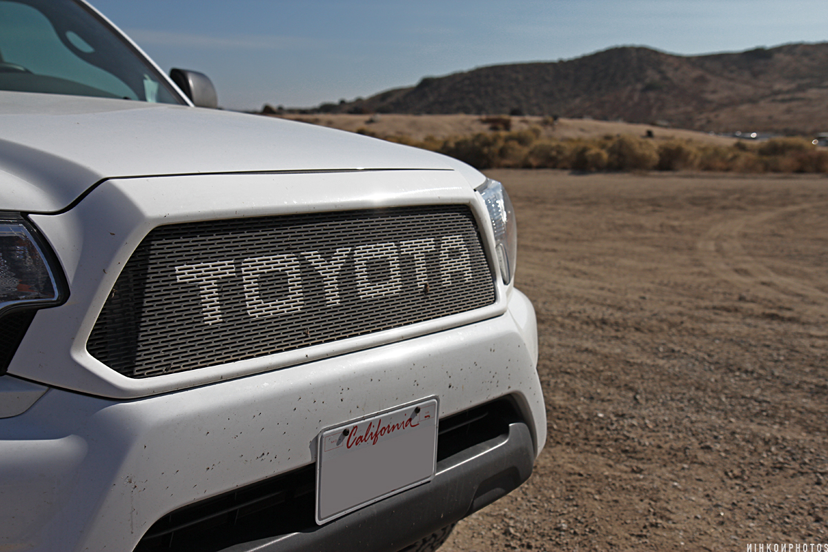

I'd vote for keeping it black and stealthy. The ones on the Tacoma above area actually white. They really stand out in real life.
Yeah I think I am gonna paint them black as well. I didn't realize until that last set of pictures that the ones on the Tacoma are actually painted on, not metal letters like mine will be. I want them to show up already... I've been waiting since October for them to come in...
Your truck is so awesome! I love that you actually go out and use it too. There are some really good pictures that you took there. You've got me looking for a black sport hood now and black bumpers if possible too haha. I love the all black look on these.
lol I was the same way. When my buddy first showed me pics of the grill letter on his Tacoma, I also assumed they were the metal ones that you're getting. It kinda took me by surprise when I saw them in real life and realized they were painted on. Yours should look killer in all black. Subtle.

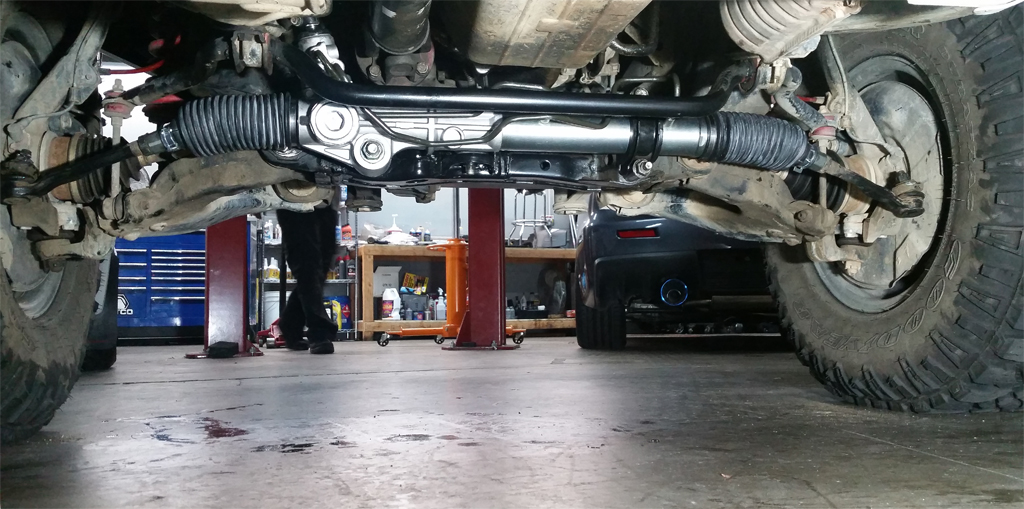

I've had a nasty vibration/shaking from the front end that's been getting worse over the past couple of months. I did some diagnosing recently and found out that my steering rack was toast. So I ordered a new one from Safari. My brother and I installed that a few days ago, and it did not resolve the issue. The steering definitely feels better now though! lol
I also rotated my tires front to back. No change. One of the outer tie rod ends is leaking a little, but it's still solid. The wheel bearings feel solid when trying to shake the wheels vertically. My next step is to exchange my Napa axles for new ones to see if that helps.

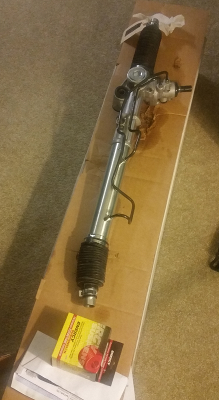

Here are a couple pictures of the Safari steering rack:
This is after un-boxing. I also picked up the Energy Suspension busteering rack bushing set.
You'll notice the indented plug, indicating that they utilize the "updated" steering rack guide.
And here is the rack after my brother and I installed it:
The installation went pretty smooth. I had read tons of threads about it before doing it. I was worried that I'd run into troubles with removing the high-pressure line. It seems that many people have had issues with it, and some have had to go so far as to cut the line off and replace it. But after removing all the other bolts and disconnecting the outer tie rod ends, we had a bit more room to get the 17mm line wrench in there and get that sucker loose.
Beyond that, it was straight forward. For bleeding of the ATF fluid, we left the outer tie rod end off at first....this allowed us to fill the reservoir and turn the steering wheel left/right to bleed it without having to lift the front wheels off the ground. (We actually did the entire job with the truck on the ground on all 4 wheels.) After bleeding, we installed my old outer tie rod ends, which were still in decent shape (though, the driver side is leaking a little, and will need to be replaced eventually.)
We discovered that we didn't get the new rack quite centered before installing it. We had used the method were you manually turn it all the way to one side, then count the turns the other way....then center it from there. Once everything was buttoned up, it was an easy fix by simply rotating the rag joint a spline or 2. Now my steering feels great! :D

If you don't mind me asking, how much was the steering rack and where did you order from? How did you diagnose that it was your steering rack as well and not the tie rods or another part?
Mine has about 167k miles on it and needs tie rod ends, but I was wondering if it might just be worth it to replace the whole rack since they come with inner tie rod ends. I think the rack is still in good shape though so I don't know if that makes sense to do so... I've got a little play in the steering, but I'm pretty certain that is the slip joint in the steering column...
