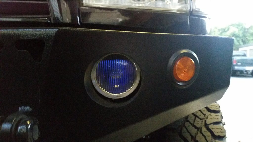

I mentioned up above about how my PIAA 510's also didn't fit in the Outdoor Logic bumper with the covers on. I finally got a picture of how they're mounted without the cover. You can see that because of the position of the mounting tab on the bumper, the PIAA's sit a little high in the hole. And I even had to pull them back as far as I could. They definitely don't sit nicely inside like your VX-F55's.

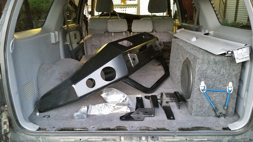

I haven't had time to install my new Shrockworks bumper yet, but I did finally take a picture of it at least! lol Here is it, sitting in the back of my truck, with all of the mounting brackets and hardware:

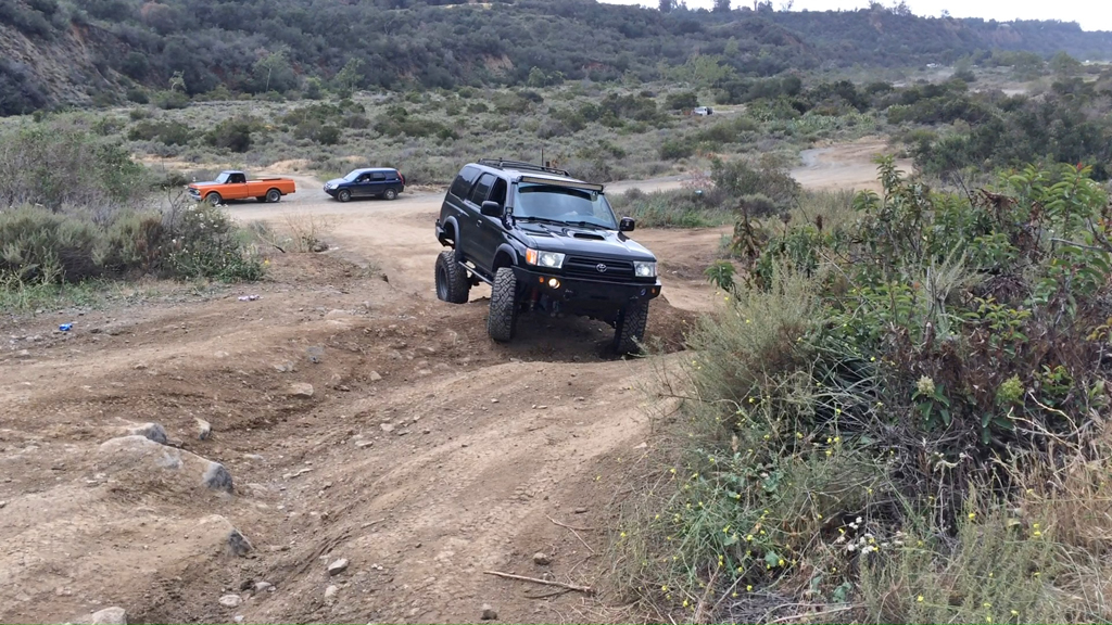

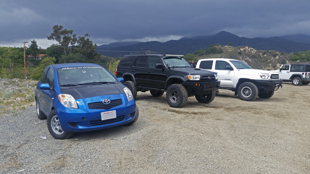

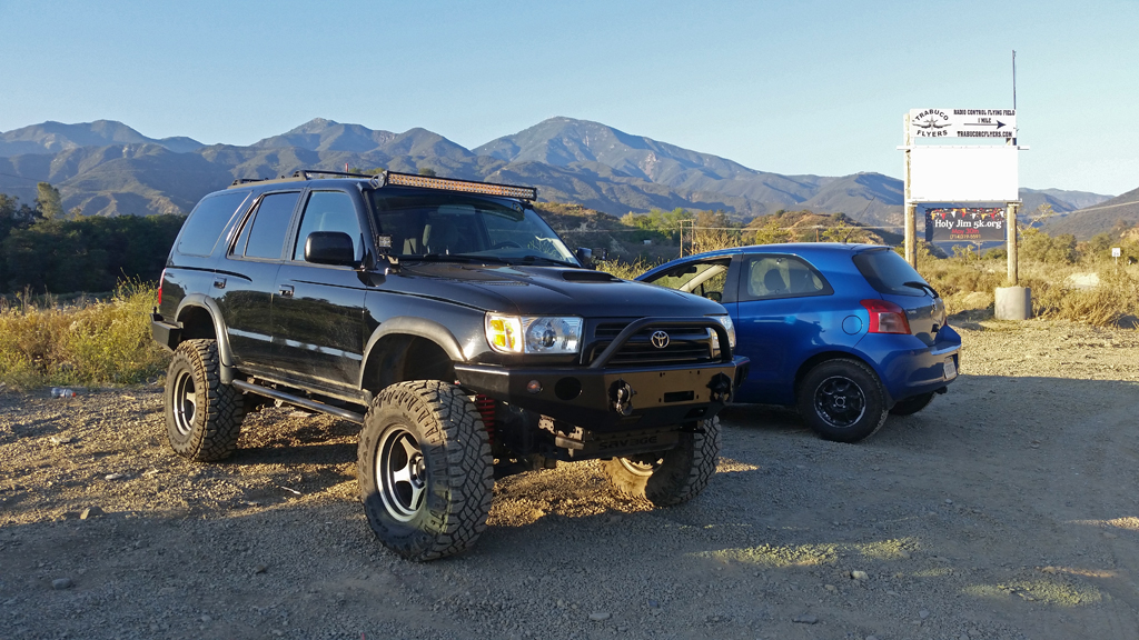

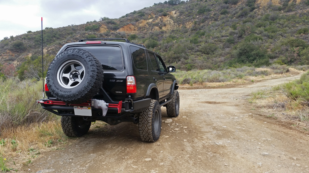

Since it's been so long since I've updated this thread, I'll start out with a few pics from a recent offroading trip. It wasn't anything difficult. Just an excuse to get out in the dirt. It was really just a "test" trip for my buddy, who is trying to make his Yaris a little bit trail worthy. So far he just has All Terrains on it, but he's thinking about the possibilities of doing a small lift on it. It didn't do as well as he had hoped out there though....so the fate of his offroad Yaris is up in the air right now.

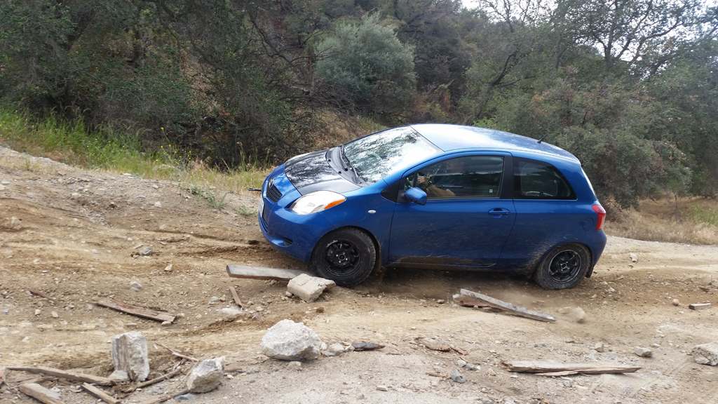

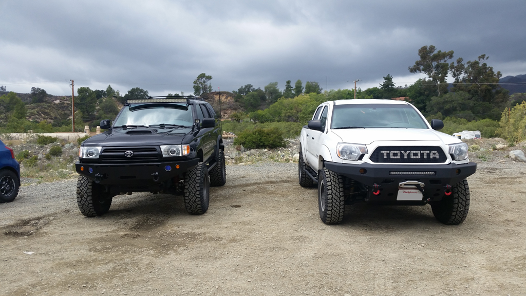

Also, our buddy joined us in his 2nd gen Tacoma.
On to the pics:
And these are just a couple screen caps from a quick video:
(and yes, I did have a fog light out that day. :( )

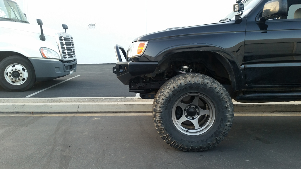

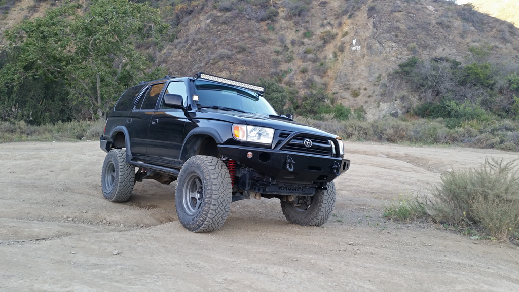

I had mentioned a little earlier in the thread that I had recently installed my 1.5" body lift from member [MENTION=14772]shootmymime[/MENTION]. You can see the results from that in the previous photos. You'll notice a 1.5" gap at the rear bumper. The Outdoor Logic bumper actually had a second set of holes that accommodate a 1" body lift. So I was able to tighten up the front gap a little bit.

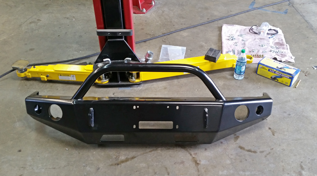

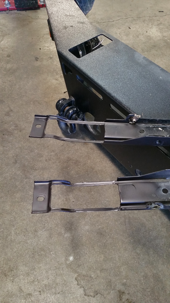

I also mentioned on the last page that I recently picked up a Schrockworks from bumper, as part of their groupbuy that they did at the end of last year. It showed up a couple months ago, but I haven't had the time to install it....so I've been driving around with it in the back of my 4Runner this whole time! lol

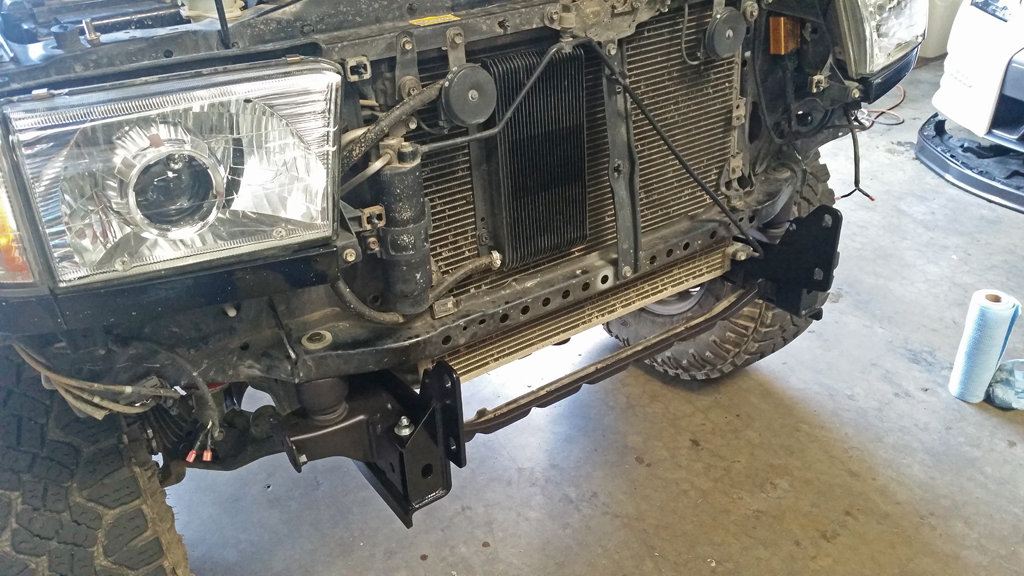

Anyway...I finally had time to install it a couple weekends ago. It was a little bit of an ordeal, since the brackets didn't play nicely with my radiator. There are 2 sizeable brackets that mount to the inner side of the frame rails. They are intended to slide between the radiator and the frame rail. But for some reason there just wasn't enough room. So I had to do a bit of cutting.
Here is the bumper, waiting patiently to be mounted:
Here are the brackets, bolted up to the frame rails (You can also notice the front body lift "pucks" in this photo):
So the cutting that I had to do was mostly to the mounting brackets on either end of the radiator. The "slot" that I cut out allows the bumper brackets to slide past. I had to cut it the way I did in order to retain the lower portion that bolts to the radiator and keeps it from flopping around.
And I had to take a corresponding notch out of the lower portion of the fins on the ends of the radiator:

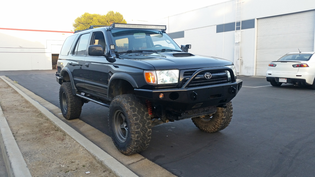

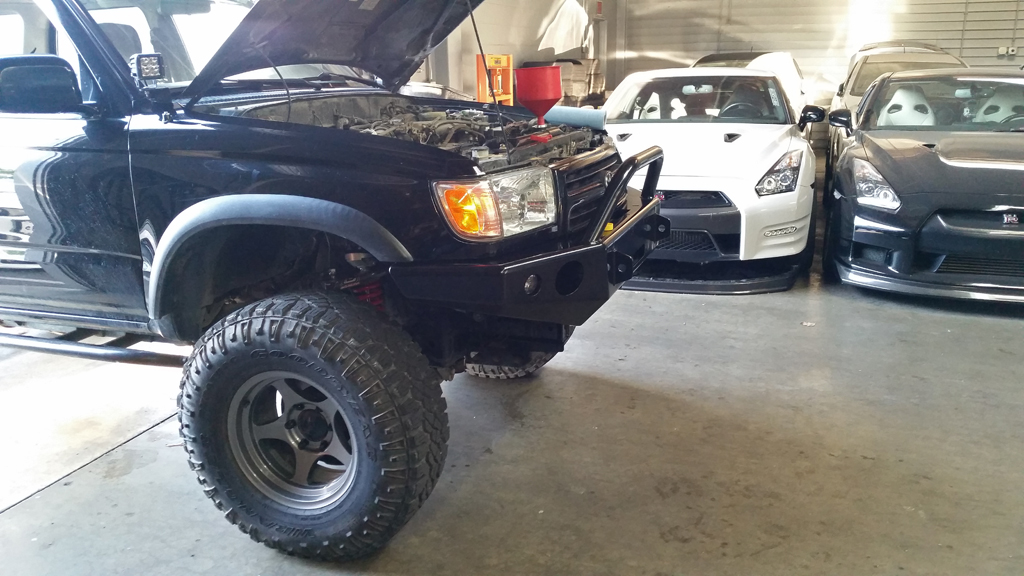

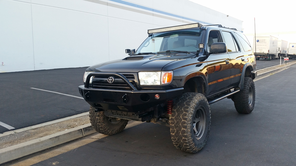

Here is the bumper mounted, and bleeding the cooling system after reinstalling the radiator:
And a few "mounted" pictures (I haven't reinstalled my PIAA fog lights yet though) (also, you'll notice that my lower skid plate is not mounted. It's off for doing an oil change and some other maintenance):

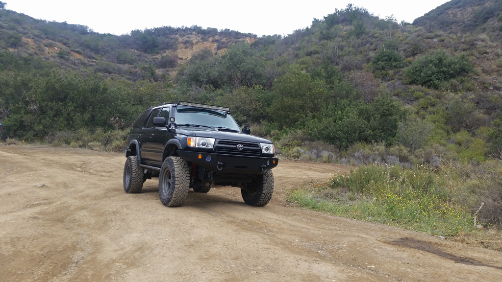

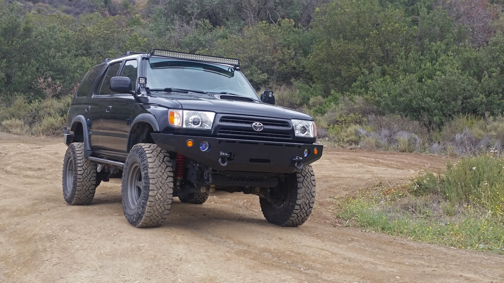

And lastly, a couple pics with the new bumper out in the dirt:

Im sure you can imagine, but it's not very practical vehicle to try to offroad with. It's more of a "prove them wrong" kinda project. lol
I can tell you it was fun to witness out on the trail though! I was helping spot, and people would drive by, window down, and I'd hear "holy shit, it's a Yaris!"...and then their truck backed up, parked, and watched. lol
Another person stops, "Holy shit, that Yaris has AT's!" Good stuff!
