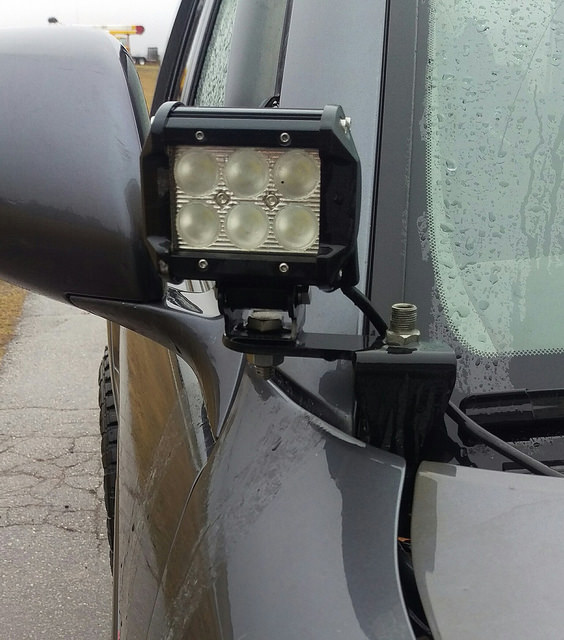

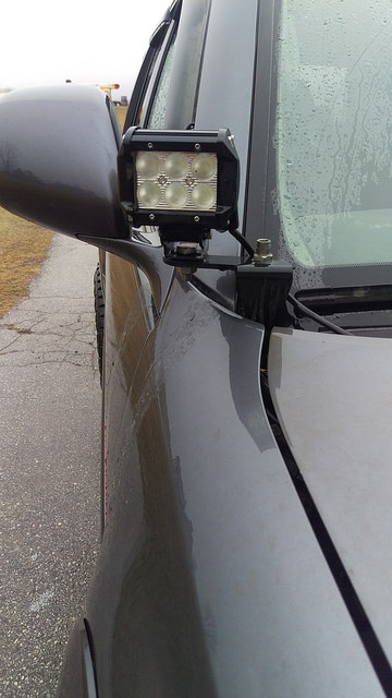

Take a pic of the brackets on the passenger side. It will definitely be close
ya I'm pretty sure that's a no. But, I could always figure out a way to move it I guess. A little customization.. lol
Yeah i'd have to agree with the both of you that that's a definite NO lol but you could probably modify that bracket to work with a snorkel by the looks of it. It looks like you might be able to get away with cutting off the bracket that the light is mounted on so it would be out of the way of the snorkel and then just re mount the light in a different position like the actual mount itself or just weld another little tab towards the front to mount the light on. But the bracket itself might be in the way...
Definite no!
Yeah i'd have to agree with the both of you that that's a definite NO lol but you could probably modify that bracket to work with a snorkel by the looks of it. Just from looking at those pics it looks like you could cut off the bracket that the light is mounted on so it would be out of the way of the snorkel and then just re mount the light in a different position like the actual mount itself or just weld another little tab towards the front to mount the light on...
Ya, I was thinking about what you said Nyc. Cut off the part that hangs over and move my light over to where I drilled the hole for my Off-road flag. Find a new spot for the flag and Viola! lol. I need a snorkel more than a light really. I have sucked up water and stalled out a couple times now, which isn't good. I am always afraid when I come to any water puddles that I am going to suck it up and ruin my motor. For $70 its worth every penny to me!
