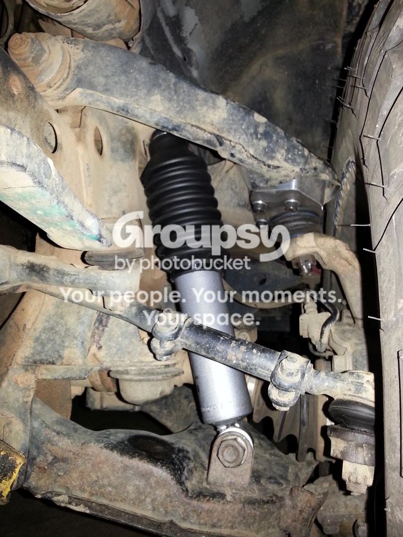

I just got some 1.5" ball joint spacers for the front of my 93, im going to need new/longer shocks up front, what do you guys recommend?
You should be be fine, I ran spacers and stock shocks for a while. The key is whether the shocks limit your downtravel - if they do, you'll break 'em. Put the spacers on and measure your droop, then unbolt the shock and measure your droop again. If the numbers are the same you're good to go.
If you do go with new shocks, OME Nitrochargers are great for a street truck that sees lots of dirt, and they're designed for 1.5" - 2.5" of lift.
Perfect. Just what I needed to know. Both of my stock shocks broke when I tried to take the top nut off, guess they were a little seized up and I hulked on them a little too hard. Looks like I'll be ordering some OME Nitrochargers soon! Any specific part number for my application?
Here's the ARB 4Runner application guide http://www.arbusa.com/uploads/PDF/accessorizeYourRig/toyota4Runner.pdf. If I'm reading that right the part number is 60072, but I'd call ToyTec or another reputable retailer and confirm that before you order.
Yes, that is the correct part number from the research I've done. That is an expensive shock! I honestly can't afford something that expensive right now, I just need to get this money pit back on the road. After some more research I've come up with a couple other options, and this Pro-Comp shock appears to be a good value and it has an 18" extended length, with an 11" compressed length. What do you think about it?

Ok. I noticed some of the reviews were saying that they made for a stiff ride. Just need to find a Gabriel or Monroe that's 15"+ extended length...
Here ya go, I'm not sure if you've looked at Summit Racings' website yet but they seem to have a pretty good selection, and quite a bit come in the size you want. I'm actually looking for shocks for the same lift/application and ran across this

Right on! Thanks for the help. That's actually where I came across the ProComps!
I don't know if you've ordered any shocks yet but my Runner had the Gabriel Ultra's on it when I bought it and I couldn't be happier. Awesome ride and stiff but not too stiff in the trails. Just ordered a new set for the rear, the front ones are still good at the moment (knock on wood).

That's what I ended up ordering! lol At full droop they are only 3/8" too short, and only losing 3/8" of travel doesn't really bother me... Also, I'm sure I could gain back that 3/8" with a couple washers on top of the shock.
