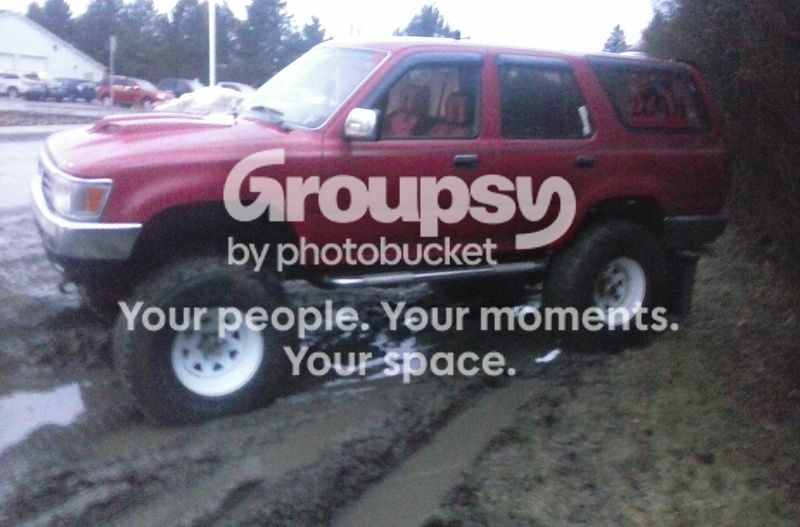

1st gen with 2015 OEM SR5 rims

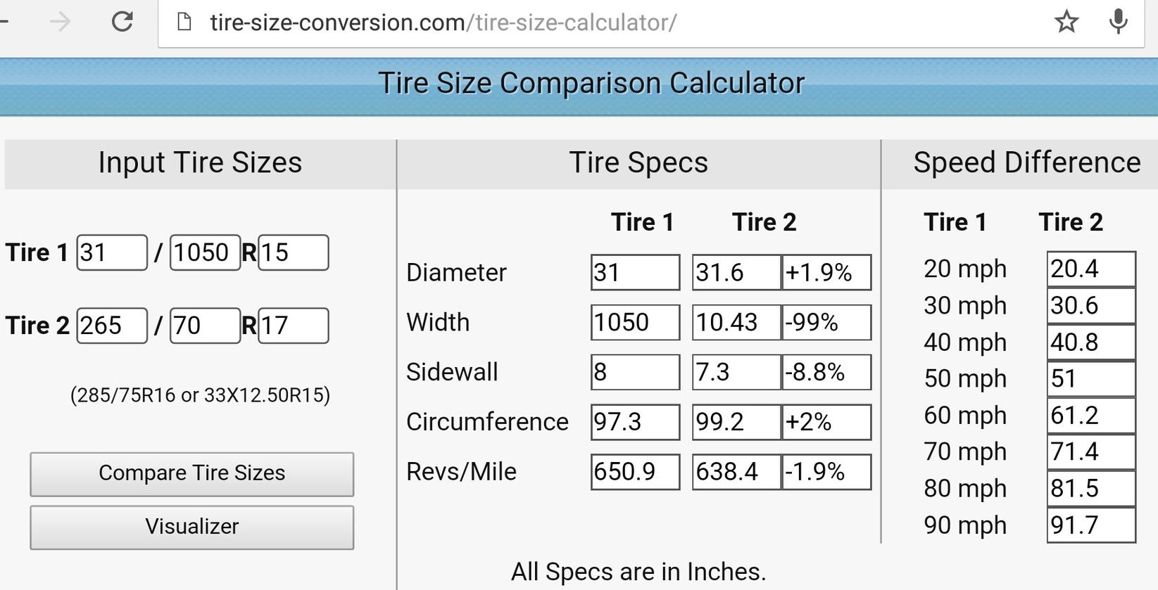

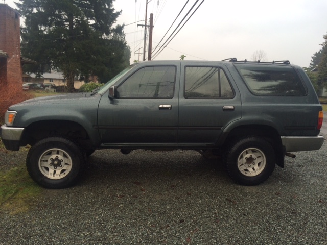

Trying to get my new to me 4Runner back to stock. After lots of research, hopefully accurate, I ended up agreeing with the info out there stating solid front axles have 3.5" backspacing, and independent front suspension all have 4.5" backspacing. So looked up a few pics of similar ideas, picked up a set of used rims with about 300miles on them from a '15 4Runner SR5, and put on the closest tire size to match stock.
Verified diff gearing, 456 in rear and 488 in front (another project) and found I should have 31x1050xR15 tires. With the new rims going from 15"x7" to 17"x7", I found a tire calculator and got a real close match with 265/70/R17.
What a difference the new tires and rims make! On road handling is far superior then the rims and tires that came on the 4Runner when I got it (15" x7" w/3.5"bs&225/75/R15). Feels like a modern SUV compared to old setup.

Love the factory rims. I was looking at this type of upgrade for my 92 and now you've sold me on that style of rim.
Well done.

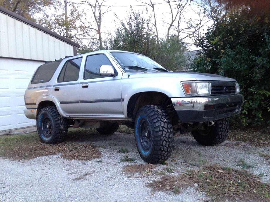

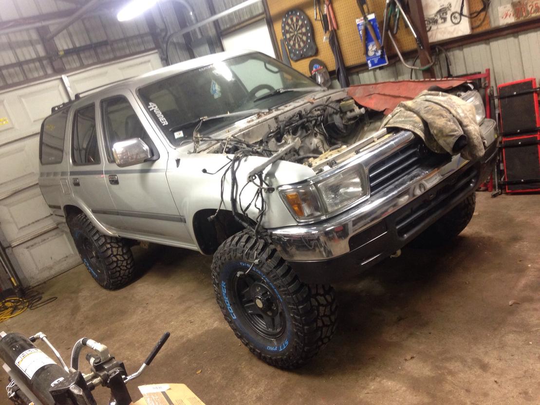

My '92 Runner with stock height and a new set of 32x11.50R15 Cooper Discoverer STT Pro's (the front is raised about an inch or two, rebuilding the engine currently)

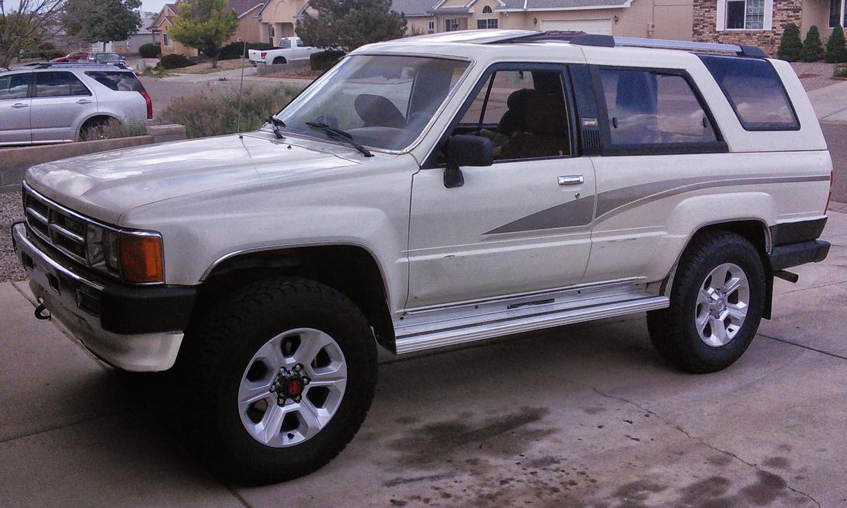

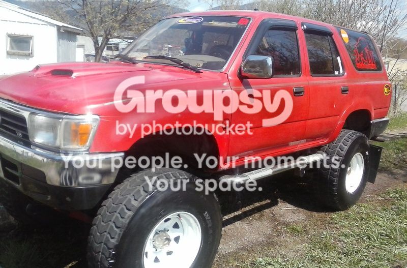

Ok, this seems like the right place to post this.
Time for wheels and tires on the '92, stock ride height, with new moog springs in the rear. The picture (assuming I can upload it correctly) is as it sits now on stock wheels and 30x9.5 BFG at's. I'm looking at American Racing AR767 15X7, ZERO offset. Which should give me 3.5" backspacing, right? Please correct me if not. That should give me about an extra inch inside I think... I would like to go with 32x11.5's, but I dont think my 5spd and 4.3 gears would like them very much, so unless you all change my mind, it will be 31x10.5's. The big question, is this the right wheel, or should I look for something closer to a stock backspace?
