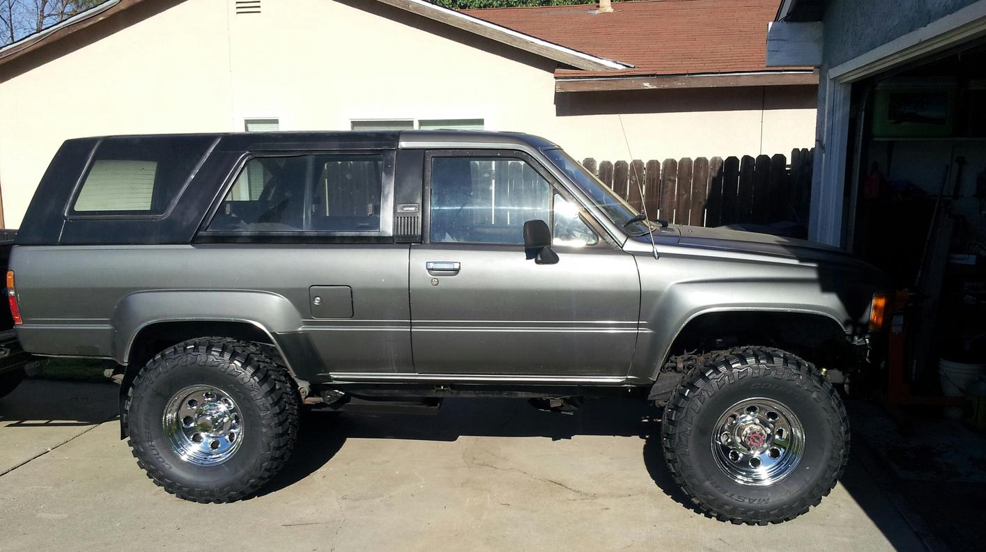

Time for wheels and tires on the '92, stock ride height, with new moog springs in the rear. The picture (assuming I can upload it correctly) is as it sits now on stock wheels and 30x9.5 BFG at's. I'm looking at American Racing AR767 15X7, ZERO offset. Which should give me 3.5" backspacing, right? Please correct me if not. That should give me about an extra inch inside I think... I would like to go with 32x11.5's, but I dont think my 5spd and 4.3 gears would like them very much, so unless you all change my mind, it will be 31x10.5's. The big question, is this the right wheel, or should I look for something closer to a stock backspace?
You SHOULD be fine getting 32's (correct me if I'm wrong), my runner has either 4.56's or 4.88's, not really sure but either way it doesn't hurt it a bit. Mine came stock with 31x10.50's and it looked pretty decent, you can look at my pictures and judge for yourself tho to determine if that's the look you want. And with the backspacing, factory offset will allow the 32's just fine with no rubbing so that's up to you

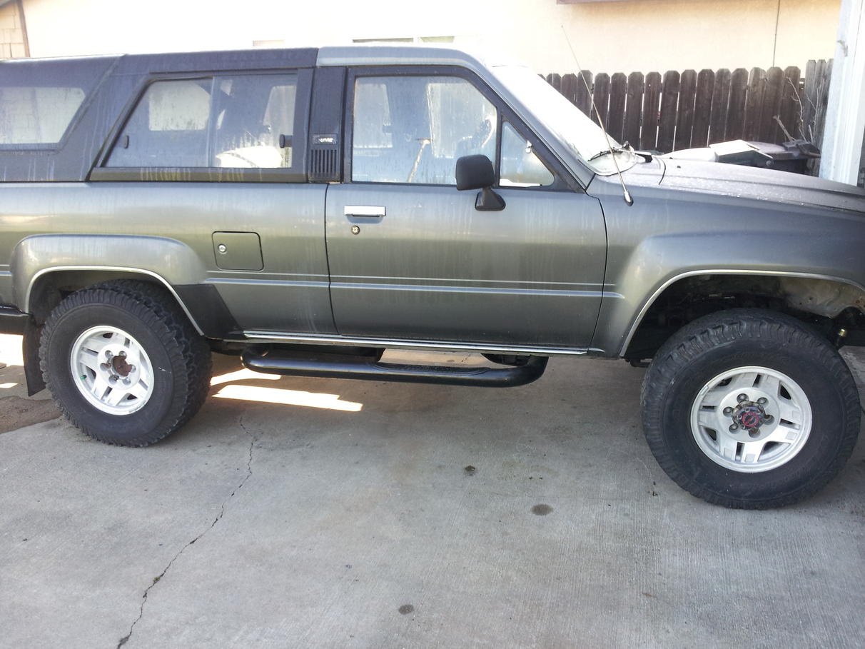

Mine is currently on stock suspension with 31's. OME 2" is on its way. Decided to go 33x10.5 KM2's. So stoked!!!
Should look rad. Love the 10.5s. You upping gears?
Thanks man! No, not regearing ATM since I just forked out over a grand for the kit alone lol. Will do it probably a year later depending on how I feel about the highway commute since it's my DD.

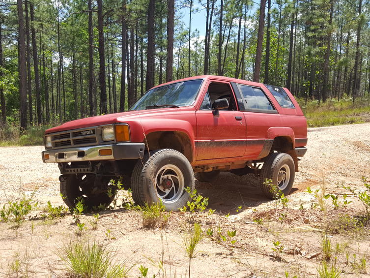

As of right now only 2" body lift (for the 3.4) and sitting on 33 12.50s.
Gonna wait for the solid axle and try for some 35s
Before, stock 31 10.50
After, 2" bl 33 12.50 and little hammer love on the pinch weld haha. No rubbing

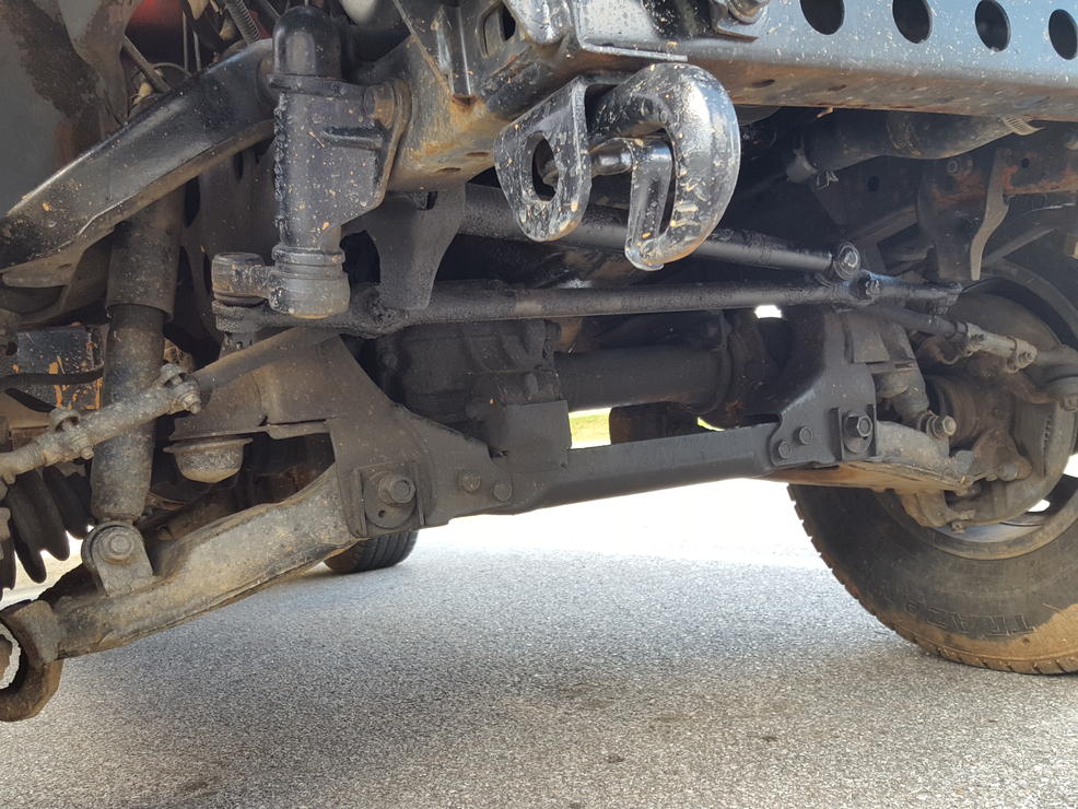

Curious about this 4runner I got earlier this week. It's an 88 1st gen, 22re 5 speed, and I was told it sits on a rough country 2" lift. It's currently on 31x10.50r15's. I attached a picture of the front suspension for reference...
So every time I hit the speed bumps (even super slow) in my neighborhood, it absolutely wrecks my world. It almost seems as if my front suspension lacks any travel and is rigid, bouncing really badly. I used to have a 100 series land cruiser that I lifted by simply cranking the torsion bars, and I remember I had to re-index my torsion bars afterward to allow for up/down travel. Could these be wound too tight and need that? Or could it just be the old bushings/shocks/full suspension? Trying to keep my budget to a minimum on this rig, but any advice as to what would make the ride at least slightly better and allow for some flex would be much appreciated!

From my understanding, RC doesn't make 2" lift kit, only 4". And from the provided photo, looks like it's on BJ spacers, considering the angle of the CV joints and all, which could give you about that height of lift.
If I were you, I'd replace the shocks (look like they're stock ones) with the longer travel ones and probably get the diff-drop spacers to get the CV's angle back, or close, to stock. A pair of bigger, stouter torsion bars (OME) wouldn't hurt either.

Ahh thank you very much! There does seem to be a spacer of sorts on the joint. And I definitely intend on getting new shocks as soon as possible, these seem shot. Any of yall have any suggestions on affordable shocks? or a length of shock/an idea of a vehicle I could snag a set off at the Pick n Pull?

I wouldn't buy used shocks from a yard, save your dough for new ones. You could remove an old shock and measure it fully extended. Then buy one 2"-3" longer. Some shocks will specify if they are for a slight lift or standard height. I don't exactly remember but a couple may be Rancho and Bilstein.

Great idea, thank you! Found a few possibilities all for pretty cheap, so definitely ordering a set within a few weeks.
